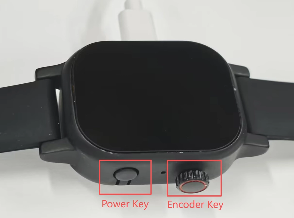

In this lesson, you will learn how to read the onboard BOOT button and print press, single-click, double-click, and long-press events through the serial port. Power and Reset button events are not printed in this lesson: the Reset button resets the program; a single click of the Power button turns the display on or off, while a long press shuts down the device. The encoder button will be covered in the encoder lesson.

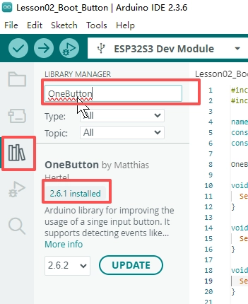

  • Additional library: OneButton. This project uses version 2.6.1.
How to add the library files:
3. Arduino IDE Instructions

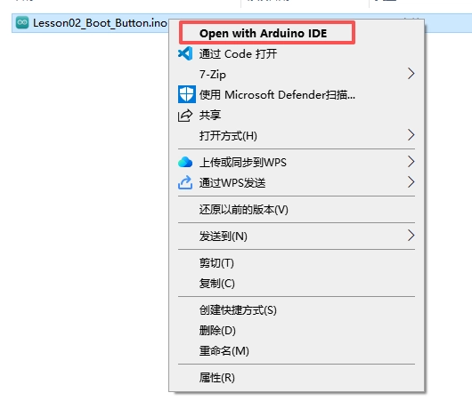

  1. Open Lesson02_Boot_Button.ino in the Arduino IDE. lesson_1

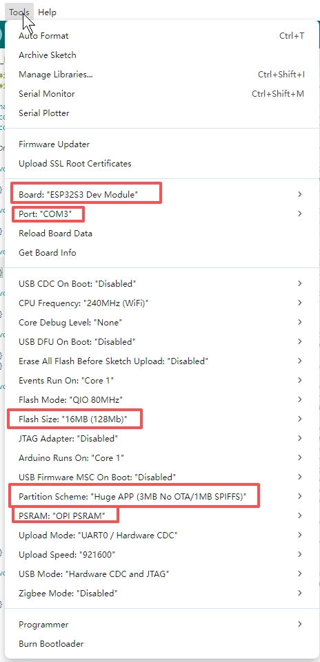

  2. Confirm that the board, Flash, PSRAM, and partition scheme settings are exactly the same as in Lesson01. lesson_2
  3. Confirm that the OneButton library is installed or that the shared libraries folder exists. lesson_3

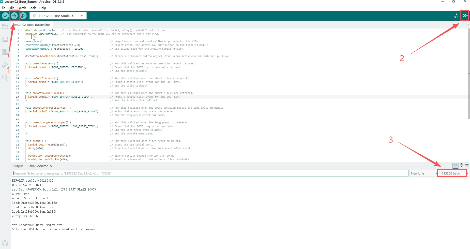

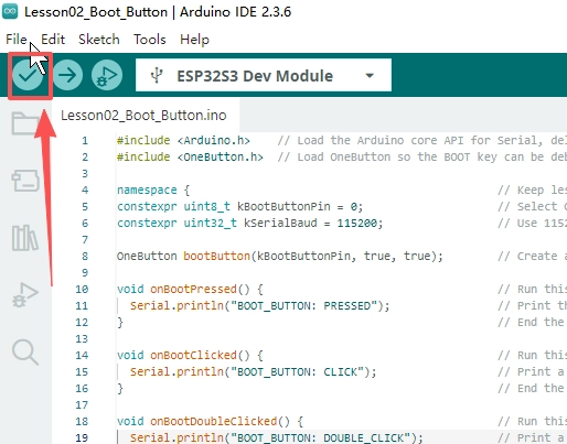

  4. Select the actual serial port and click Verify to compile. (Connect the hardware using a USB data cable.) lesson_4

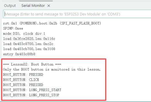

  5. Click Upload to flash the program, then open Serial Monitor and set the baud rate to 115200. lesson_5
  6. Press the BOOT button and observe the event messages in the serial output. lesson_6

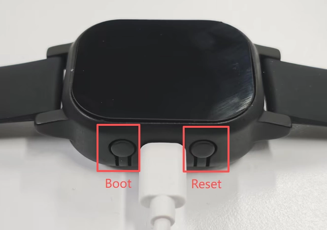

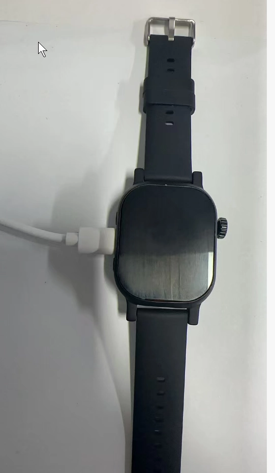

  1. Connect the development board to the computer using a USB data cable, and keep Serial Monitor open.
lesson_7
  1. Briefly press the BOOT button and check whether the BOOT button event is printed in the serial output.
lesson_8
  1. Quickly press the BOOT button twice in succession and observe the double-click event.
  2. Press and hold the BOOT button for approximately 1 second or longer, and observe the long-press start and long-press end events.
  3. Do not operate the Reset or Power buttons in this lesson. Reset resets the program; a single click of Power turns the display on or off, while a long press shuts down the device.
