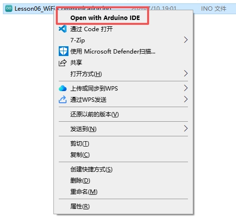

  1. Open Lesson06_WiFi_Communication.ino in the Arduino IDE. lesson_1

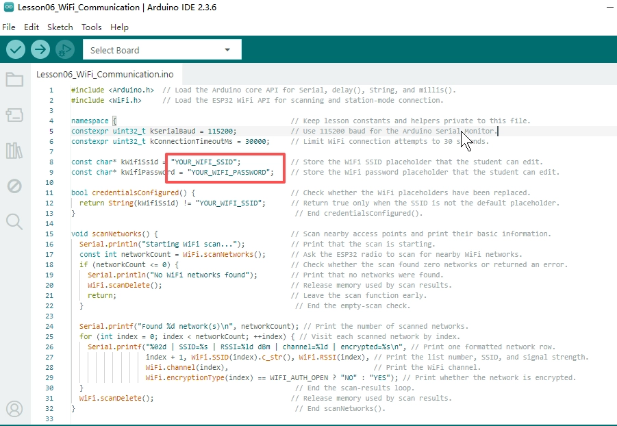

  2. If you need to connect to a router, replace YOUR_WIFI_SSID and YOUR_WIFI_PASSWORD with the actual WiFi information. lesson_2

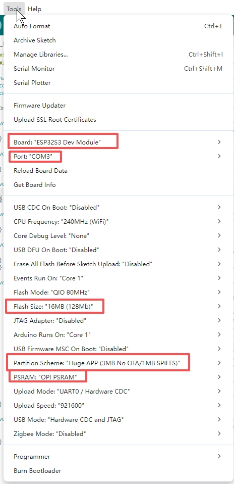

  3. Confirm that the board settings match those in Lesson01. lesson_3

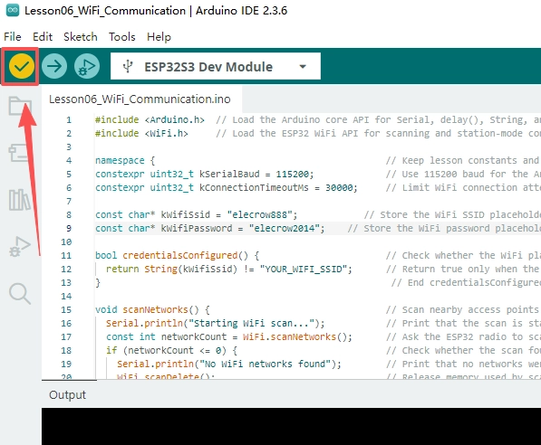

  4. Click Verify to compile the program. lesson_4

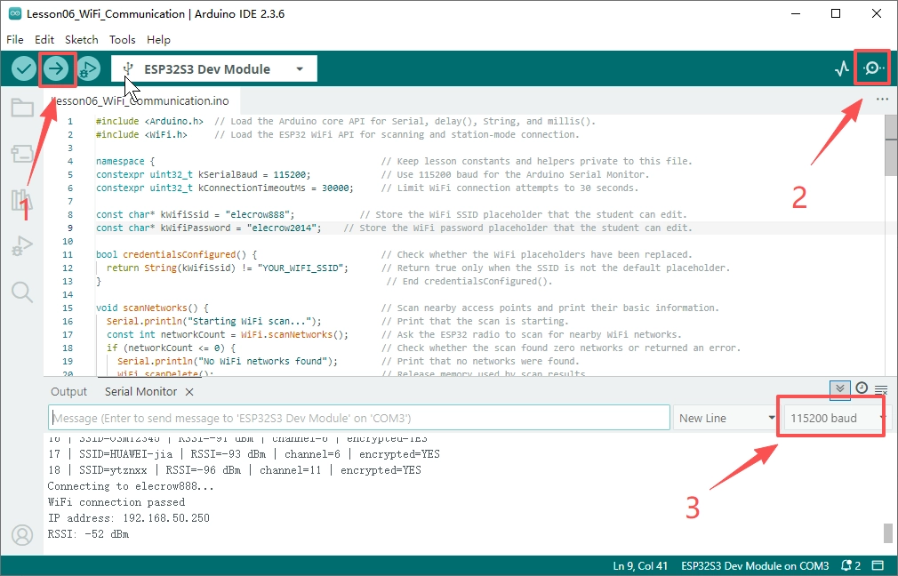

  5. Click Upload to flash the program, open the Serial Monitor, and select a baud rate of 115200. lesson_5

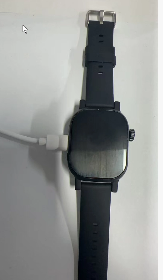

  1. Connect a USB data cable and place the device where WiFi coverage is available.
lesson_6

  3. Open the Serial Monitor and observe the list of nearby WiFi networks, signal strength, channel, and encryption status.
  4. If the connection fails, confirm that the router is using 2.4 GHz WiFi, and check whether the account and password are correct.
