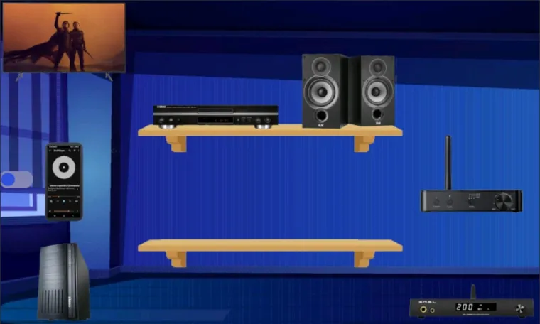

The solution appeared when I spotted a smart touchscreen. To program it, I had to learn how to use the LVGL library and the Squarelie Studio wysiwyg editor. So I enhanced my switch with an ability to send full connection status and to receive direct commands via WiFi, and then I designed a very easy-to-use graphical interface, using real photos of my audio devices. I only needed an idea for the graphic design, and I came up with an idea to show both pairs of the currently connected devices as two shelves, on which the selected devices are placed or taken away by clicking on their photos. Finally my wife likes this new interface.
