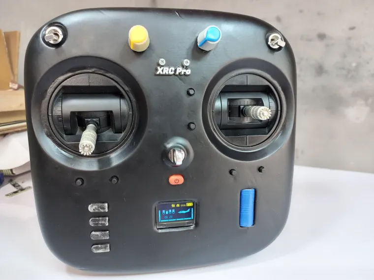

The XRC PRO is an advanced, open-source RC transmitter and receiver system designed to offer professional-level performance in a compact and customizable package. Built around the STM32F103C8T6 microcontroller and the NRF24L01 wireless transceiver module, the XRC PRO provides precise, real-time control for various RC applications like drones, cars, and boats. With a compact design, robust functionality, and user-friendly interface, the XRC PRO is an ideal tool for both hobbyists and professionals.
Key features
     Feature                                                          Description
OLED Display Displays real-time signal strength, settings, battery percentage, and control data.
Trim Buttons & Rotary Encoder Fine-tune controls and navigate through menus effortlessly for enhanced usability.
Multi-Menus Intuitive menu system for adjusting channel settings, polarity, and output modes.
PPM & SBUS Outputs Offers versatile output options to support various RC receivers for expanded functionality.
NRF24L01 Power Control Adjustable signal strength settings for short and long-range control.
Stick Calibration Real-time calibration of sticks with visual feedback on the OLED display for precise adjustments.
Compact Receivers Two efficient options for 8-channel PWM+PPM and PPM+SBUS outputs, designed for optimal performance.
Throttle Mode Choose between left or right throttle hand mode for personalized control preferences.
PC Simulator Compatibility Utilize the PPM output for playing simulators on a computer, with the option to toggle PPM output on/off.
Express ELRS Integration Utilize PPM output with an ELRS adapter for compatibility with various ELRS modules.
Buzzer On/Off Mode Easily toggle the buzzer on or off for audio feedback during operations.
Adjustable Setting Unit Customize the unit of measurement for settings (e.g., degrees, percentages) according to user preference.
Battery Voltage Calibration Calibrate battery voltage display to reflect accurate percentage readings for better monitoring.
Reset to Default Settings Quickly restore all settings to default through a simple menu option for ease of use.

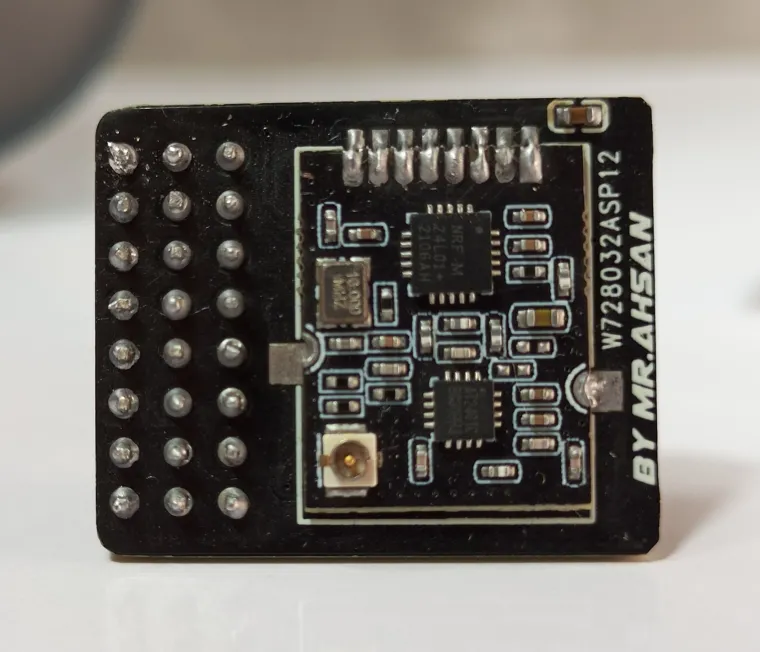

Wireless Module NRF24L01 GT24 Mini:
• 2.4 GHz ISM band
• High data rate up to 2 Mbps
• Supports multiple data pipes

2 NRF24L01 GT24 Mini Wireless Transceiver Module 1 Click to Buy

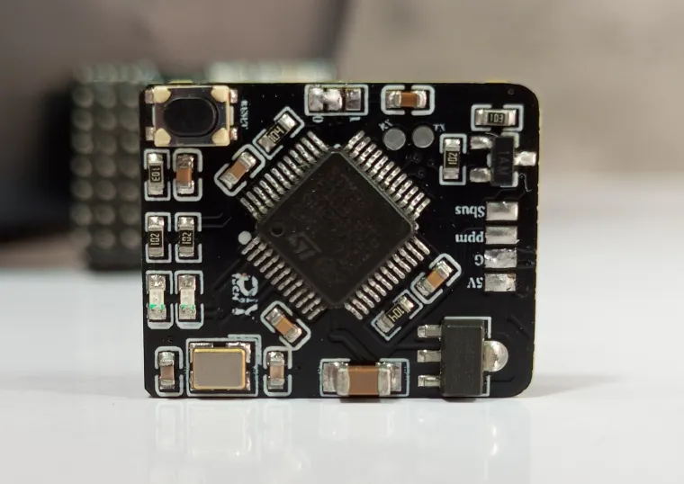

Receciver PCBs

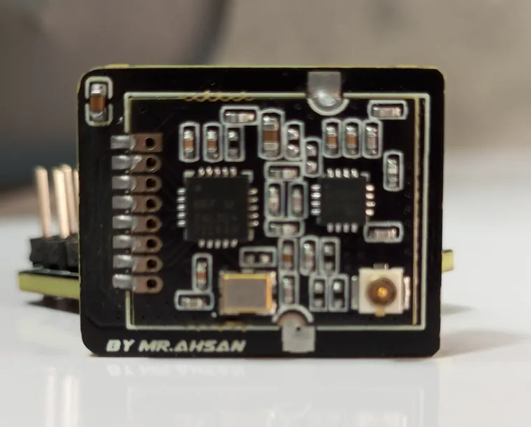

8-channel PWM+PPM Receiver PCB
The 8-channel receiver supports both PWM and PPM outputs. It is based on the NRF24L01 and STM32F103C8T6 for signal decoding and generation.

Signal Decoding Decodes signals from the NRF24L01 transceiver using the SPI interface for reliable data communication.
8 PWM Output Pins Provides 8 PWM output pins for controlling multiple servos, enhancing RC model functionality.
PPM Output Pin PPM output pin designed for connecting to flight controllers or other compatible devices.

PPM+SBUS Receiver PCB
The PPM+SBUS receiver is another compact design focused on supporting more advanced control protocols. It also features the STM32F103C8T6 for signal processing and output.

Rceiver(PWM+PPM)
Receiver(PPM+SBUS)
