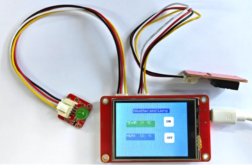

The example tutorial is an environmental monitoring project, demonstrate how to create a UI and use a DHT20 sensor to obtain the environment temperature and humidity and display it on the screen; and how to control the LED on and off by the buttons on the screen.
In this tutorial, we will show you how to design the UI with SquareLine Studio, and show you how to upload the code with Thonny IDE.

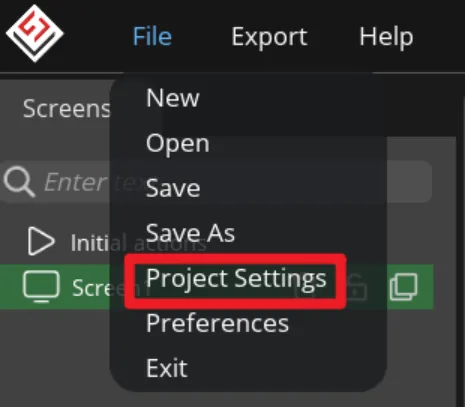

Open the SquareLine Studio and create a project. Select "Desktop"->"Micropython for Unix and other platform".
Set the name of the project, set the screen resolution to 320*240, set the color depth to 16bit, and keep other default settings. After setting, click CREATE to create the project.

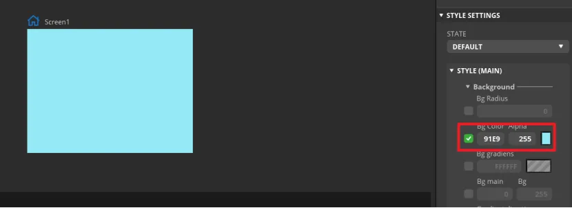

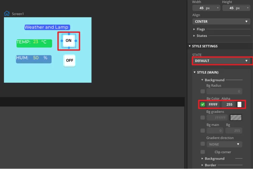

Add background.
Find "Inspector"->"STYLE SETTING", click to expand "STYLE(MAIN)", then click the 1st "Background". Check the "Bg ColorAlpha" and set the backgroud color.

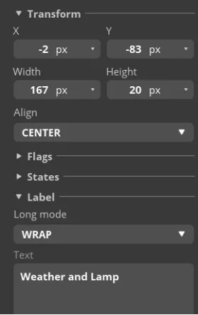

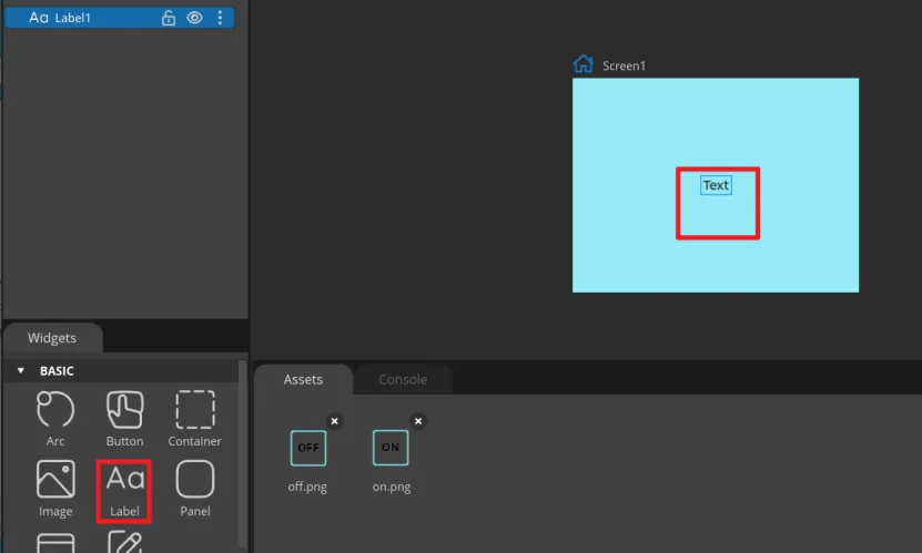

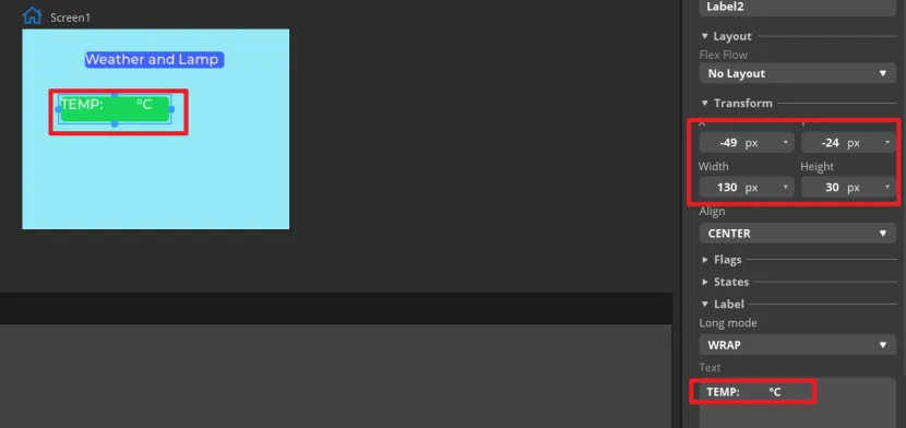

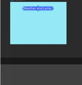

Add Label widget
The content, position and size of the label can be adjusted by dragging the mouse. You can also directly enter numbers in the Inspector→LABEL→Transform to adjust. You can set the font color and other attributes in STYLE SETTING→STYLE(MAIN).
Modify the text of Label1 as the title of the screen.

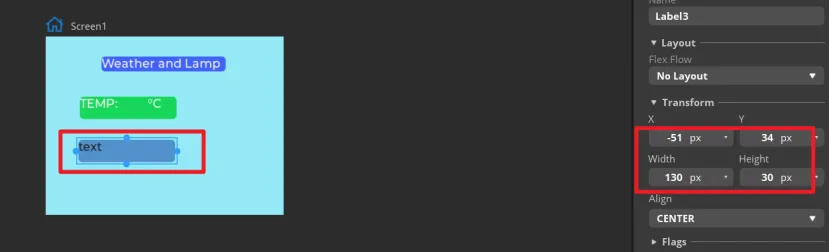

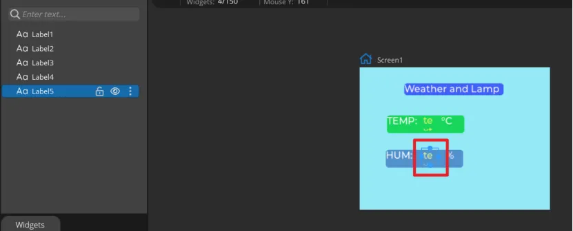

Add Label2 and Label3 as labels for temperature and humidity in the same way.

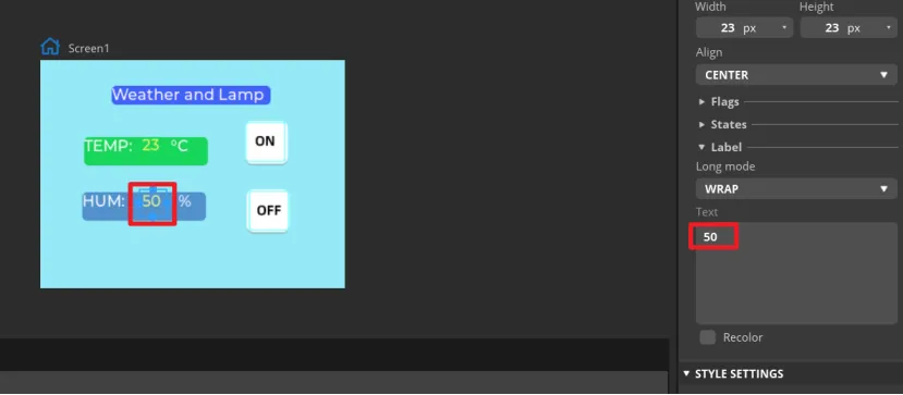

Add Label4 and Label5 to display the values of temperature and humidity
After all Labels are added, you can set the default display value of the Label.

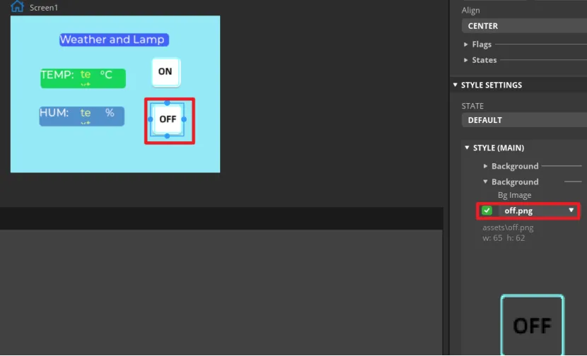

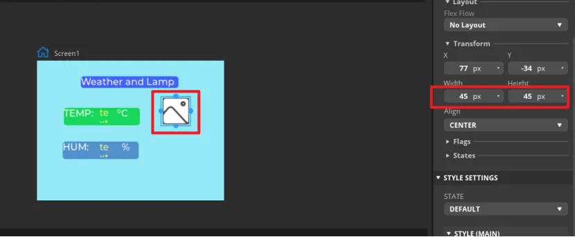

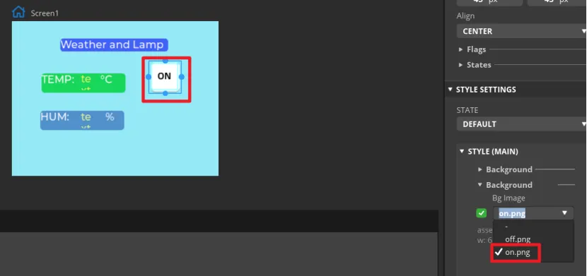

If you there are no pictures available, please click "ADD FILE TO ASSETS" to add custom images or icons in the "Assets" area.
Please click
to download the custom images for the button.

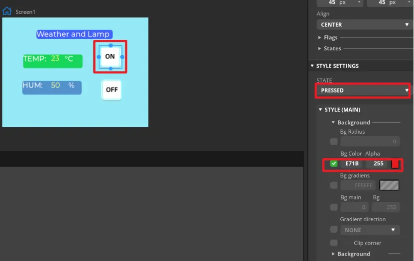

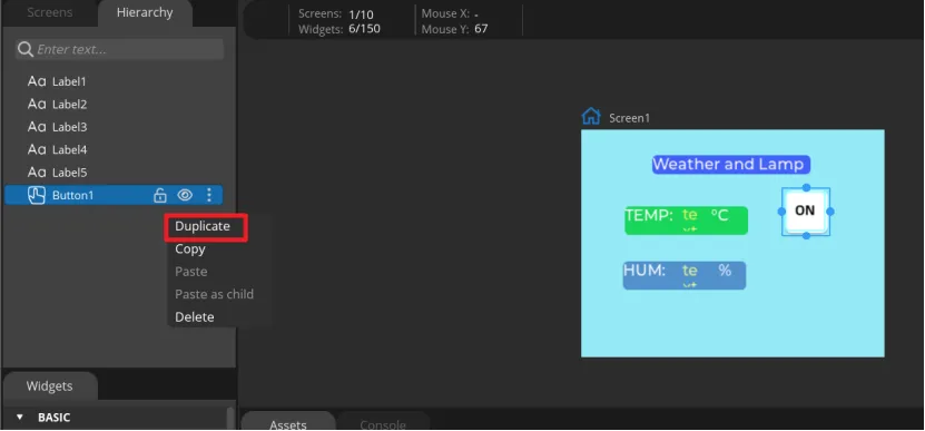

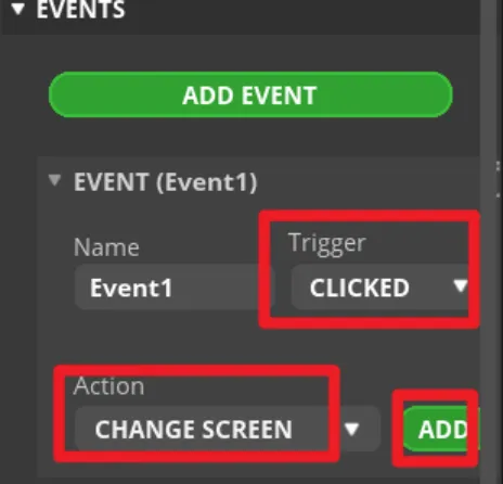

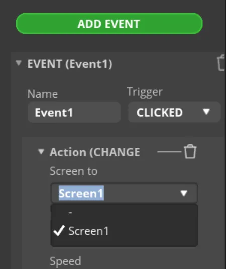

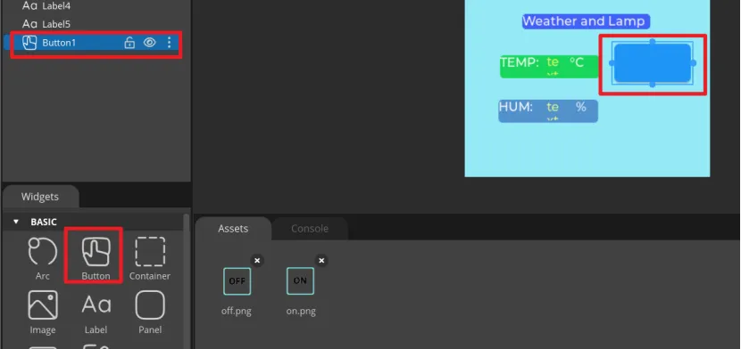

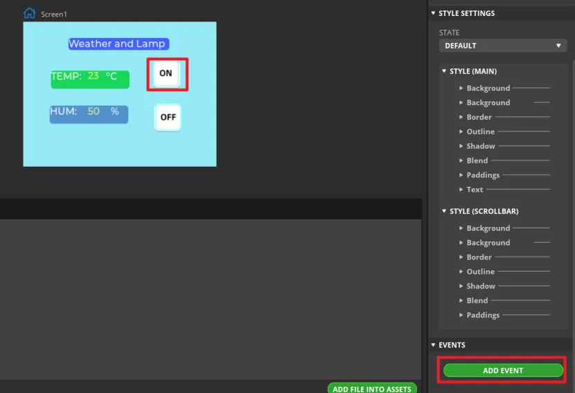

Add events to buttons.

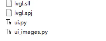

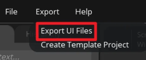

Export UI files.
Then click "APPLY CHANGES".
The UI file export is completed. Next we're going to learn about the main program and learn how to upload the code to the board with Thonny IDE.

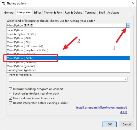

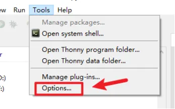

Open Thonny IDE and click "Tools"->"Options"->"Interpreter".
Select "MicroPython(ESP32)" for interpreter.
Select the corresponding serial port(or Try to detect port automatically).

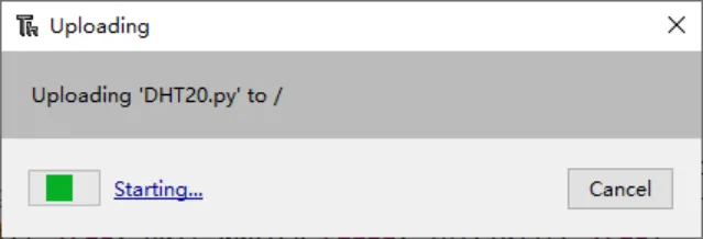

Click the icon with 3 lines, and click "select local MicroPython image...".Select the "lv_micropython.v1.19.1-ili9341-xpt2046.bin" and install.
Waiting for downloading...

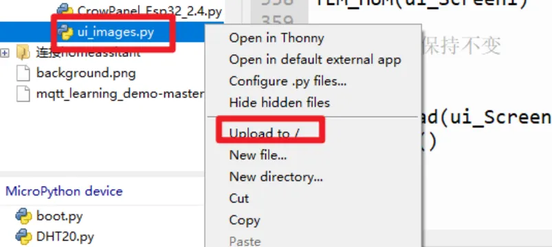

Please click to download the code file and libraries.

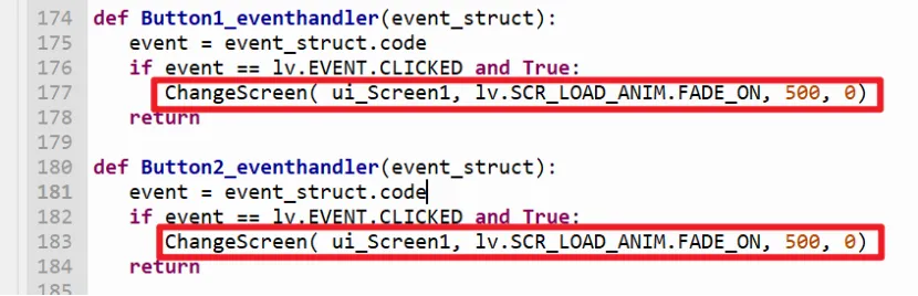

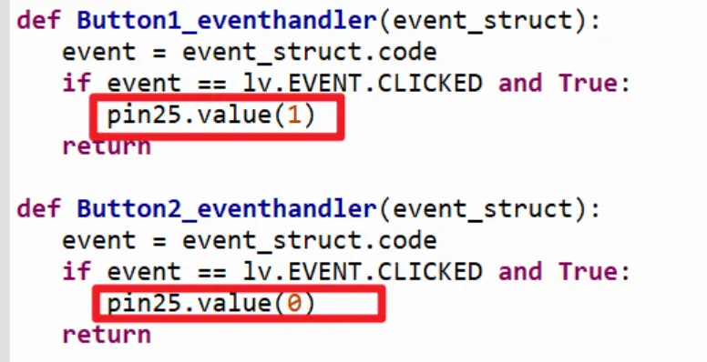

def Button1_eventhandler(event_struct):
event = event_struct.code
if event == lv.EVENT.CLICKED and True:
pin25.value(1)
return
def Button2_eventhandler(event_struct):
pin25.value(0)
return

ui_Label5 = lv.label(ui_Screen1)
ui_Label5.set_text("50")
ui_Label5.set_width(23)
ui_Label5.set_height(23)
ui_Label5.set_x(-42)
ui_Label5.set_y(30)
ui_Label5.set_align( lv.ALIGN.CENTER)
ui_Label5.set_style_text_color(lv.color_hex(0xE1F492), lv.PART.MAIN | lv.STATE.DEFAULT )
ui_Label5.set_style_text_opa(255, lv.PART.MAIN| lv.STATE.DEFAULT )
ui_Label5.set_style_text_font( lv.font_montserrat_16, lv.PART.MAIN | lv.STATE.DEFAULT )
ui_Button1 = lv.btn(ui_Screen1)
ui_Button1.set_width(45)
ui_Button1.set_height(45)
ui_Button1.set_x(77)
ui_Button1.set_y(-34)
ui_Button1.set_align( lv.ALIGN.CENTER)
SetFlag(ui_Button1, lv.obj.FLAG.SCROLLABLE, False)
SetFlag(ui_Button1, lv.obj.FLAG.SCROLL_ON_FOCUS, True)
ui_Button1.set_style_bg_color(lv.color_hex(0xFFFFFF), lv.PART.MAIN | lv.STATE.DEFAULT )
ui_Button1.set_style_bg_opa(255, lv.PART.MAIN| lv.STATE.DEFAULT )
ui_Button1.set_style_bg_img_src( ui_images.ui_img_on_webp, lv.PART.MAIN | lv.STATE.DEFAULT )
ui_Button1.set_style_bg_color(lv.color_hex(0xE71B1B), lv.PART.MAIN | lv.STATE.PRESSED )
ui_Button1.set_style_bg_opa(255, lv.PART.MAIN| lv.STATE.PRESSED )
ui_Button1.add_event_cb(Button1_eventhandler, lv.EVENT.ALL, None)
ui_Button2 = lv.btn(ui_Screen1)
ui_Button2.set_width(45)
ui_Button2.set_height(45)
ui_Button2.set_x(79)
ui_Button2.set_y(38)
ui_Button2.set_align( lv.ALIGN.CENTER)
SetFlag(ui_Button2, lv.obj.FLAG.SCROLLABLE, False)
SetFlag(ui_Button2, lv.obj.FLAG.SCROLL_ON_FOCUS, True)
ui_Button2.set_style_bg_color(lv.color_hex(0xFFFFFF), lv.PART.MAIN | lv.STATE.DEFAULT )
ui_Button2.set_style_bg_opa(255, lv.PART.MAIN| lv.STATE.DEFAULT )
ui_Button2.set_style_bg_img_src( ui_images.ui_img_off_webp, lv.PART.MAIN | lv.STATE.DEFAULT )
ui_Button2.set_style_bg_color(lv.color_hex(0xBAB3B3), lv.PART.MAIN | lv.STATE.PRESSED )
ui_Button2.set_style_bg_opa(255, lv.PART.MAIN| lv.STATE.PRESSED )
ui_Button2.add_event_cb(Button2_eventhandler, lv.EVENT.ALL, None)

UI display code¶
This part copies the code of ui.py generated by Squareline Studio. We need to modify the part that control the button.
From
to
Temperature and humidity display¶
Define a class named TEM_HUM to display temperature and humidity information in the LVGL GUI.
sensor.read_dht20()
class TEM_HUM():
def __init__(self, ui_Screen1):
# Read the temperature and humidity values of the DHT20 sensor
global Tem, Hum
Tem = sensor.dht20_temperature()
Hum = sensor.dht20_humidity()
# Update the temperature and humidity display on the UI interface
ui_Label4.set_text(f"{round(Tem)} °C") # Update temperature
ui_Label5.set_text(f"{round(Hum)} %") # Update humidity
Create a function to display and update temperature and humidity.
# Make sure the TEM_HUM class is instantiated in the program and ui_Screen1 is passed as a parameter
def update_temperature_humidity():
global Tem, Hum
sensor.read_dht20() # Make sure read_dht20() is called to update the sensor data
ui_Label4.set_text(f"{round(Tem)}")
ui_Label5.set_text(f"{round(Hum)}")
Main Loop¶
Define the main loop function main_loop to continuously update the temperature and humidity display on the UI interface.
def main_loop():
while True:
time.sleep(1) # Pause for 10 seconds and then update again
TEM_HUM(ui_Screen1)
lv.scr_load(ui_Screen1)
main_loop()
Upload the code¶

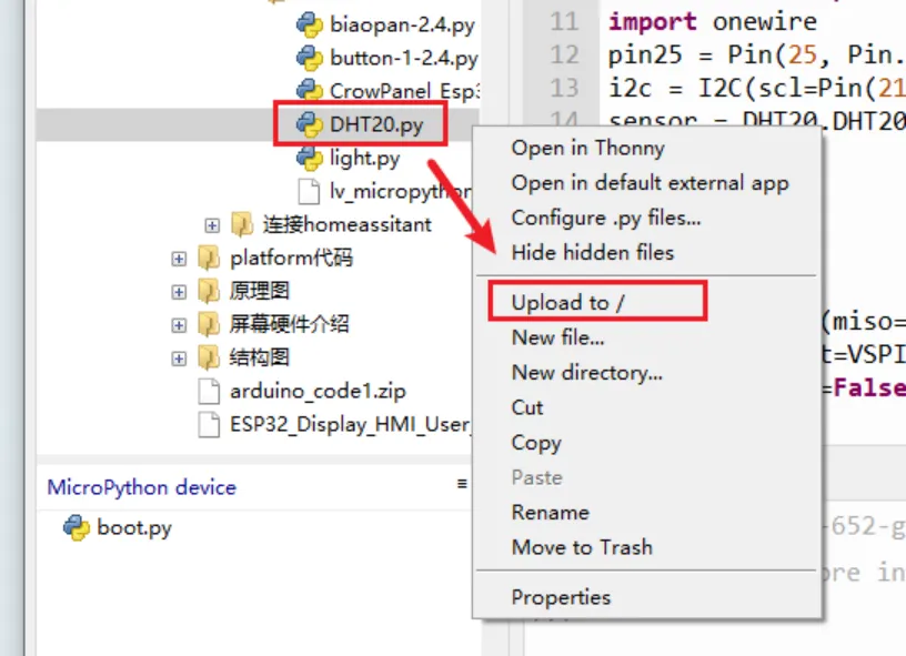

Upload the libraries¶

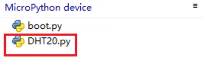

DHT20
In the upper left corner of the thonny, enter the path where DHT20.py is located, right-click DHR20.py, and click Upload to/
Waiting for uploading
The DHT20.py will be added to the MicroPython device column.
ui_image.py
In the upper left corner of the thonny, enter the path where ui_image.py is located, right-click ui_image.py, and click Upload to/
ui_image.py is added to MicroPython device successfully.

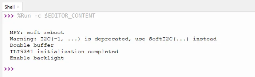

Upload the code¶
Click the "run" icon.
Successfully uploaded.

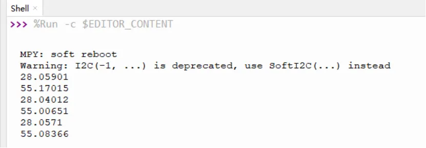

Example 3 Obtain temperature and humidity value¶
Plug DHT20 module to the IIC port. Add DHT20.py to the device(check the method in "Upload the libraries" section.) and upload the code below, the value of temperature and humidity will be printed.
import time
import DHT20
from machine import I2C, Pin
i2c = I2C(scl=Pin(21), sda=Pin(22))
sensor = DHT20.DHT20(i2c)
while True:
sensor.read_dht20()
print(sensor.dht20_temperature())
print(sensor.dht20_humidity())
time.sleep_ms(4000)

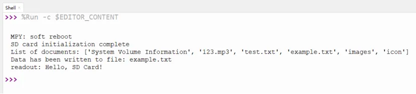

Example 6 Initialize SD card¶
Upload the following code to ESP32 HMI
import machine
import os
import sdcard
import uos
# SD Card Initialization
def init_sd():
# Creating SPI Objects
spi = machine.SPI(2, baudrate=1000000, polarity=0, phase=0, sck=machine.Pin(18), mosi=machine.Pin(23), miso=machine.Pin(19))
cs = machine.Pin(5, machine.Pin.OUT)
sd = sdcard.SDCard(spi, cs)
vfs = uos.VfsFat(sd)
uos.mount(vfs, "/sd")
print("SD card initialization complete")
print("List of documents:", os.listdir("/sd"))
# write to a file
def write_file(filename, data):
with open("/sd/" + filename, "w") as file:
file.write(data)
print("Data has been written to file:", filename)
# Read file
def read_file(filename):
with open("/sd/" + filename, "r") as file:
data = file.read()
print("readout:", data)
return data
# Example: Initialize SD card and read/write files
def main():
init_sd()
filename = "example.txt"
data = "Hello, SD Card!"
read_file(filename)
if __name__ == "__main__":
main()
Running result:
