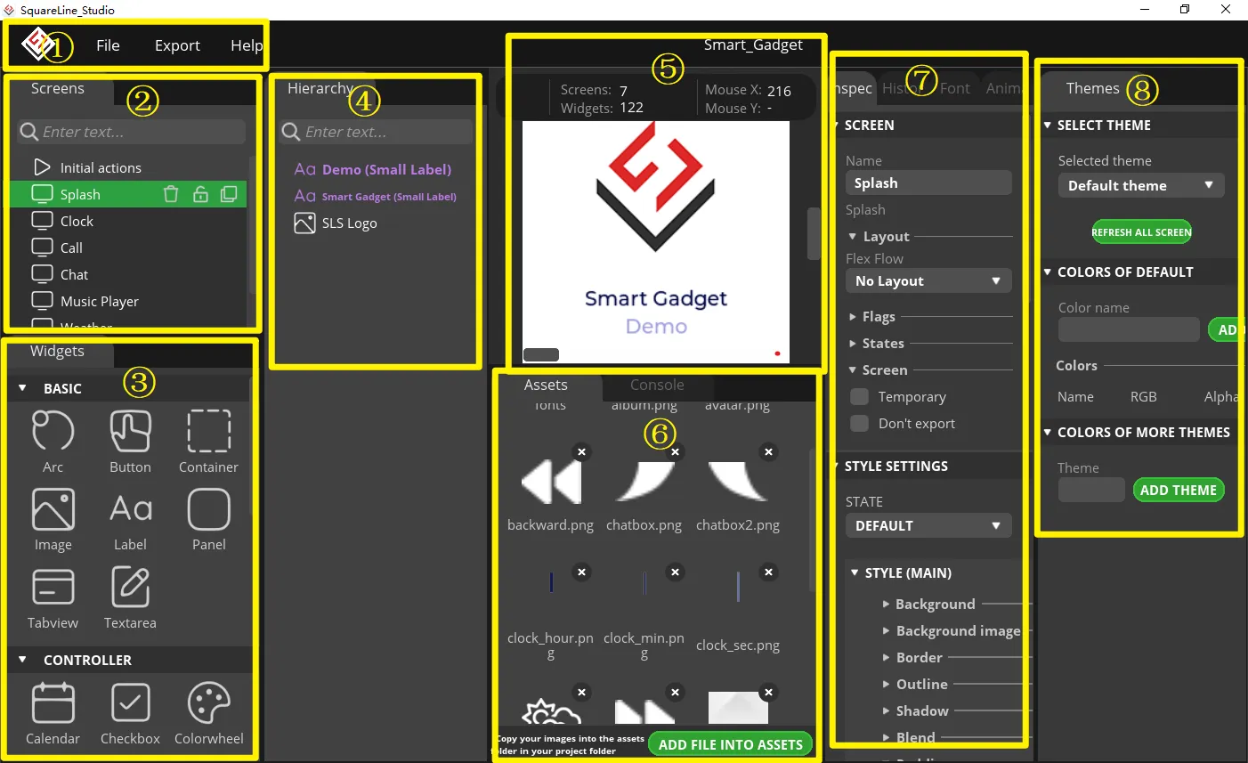

2.2 Software Function Introduction
Open the software
10
11
12
13
Note: Please select the corresponding resolution and color depth according to the screen specifications.
14
②Screen bar, the project screen will be listed here.
③Widget area, all widgets are here and can be selected and used according to project needs.
④Hierarchy area, it will show every widget used in each screen.
⑤This area shows the actual display effect, you can adjust the widgets or screen here.
⑥Material column, the added materials are displayed here.
⑦Setting bar, where you can make basic settings for each part, including the basic attributes and trigger operations of the part.
⑧Theme bar, different themes can be set.

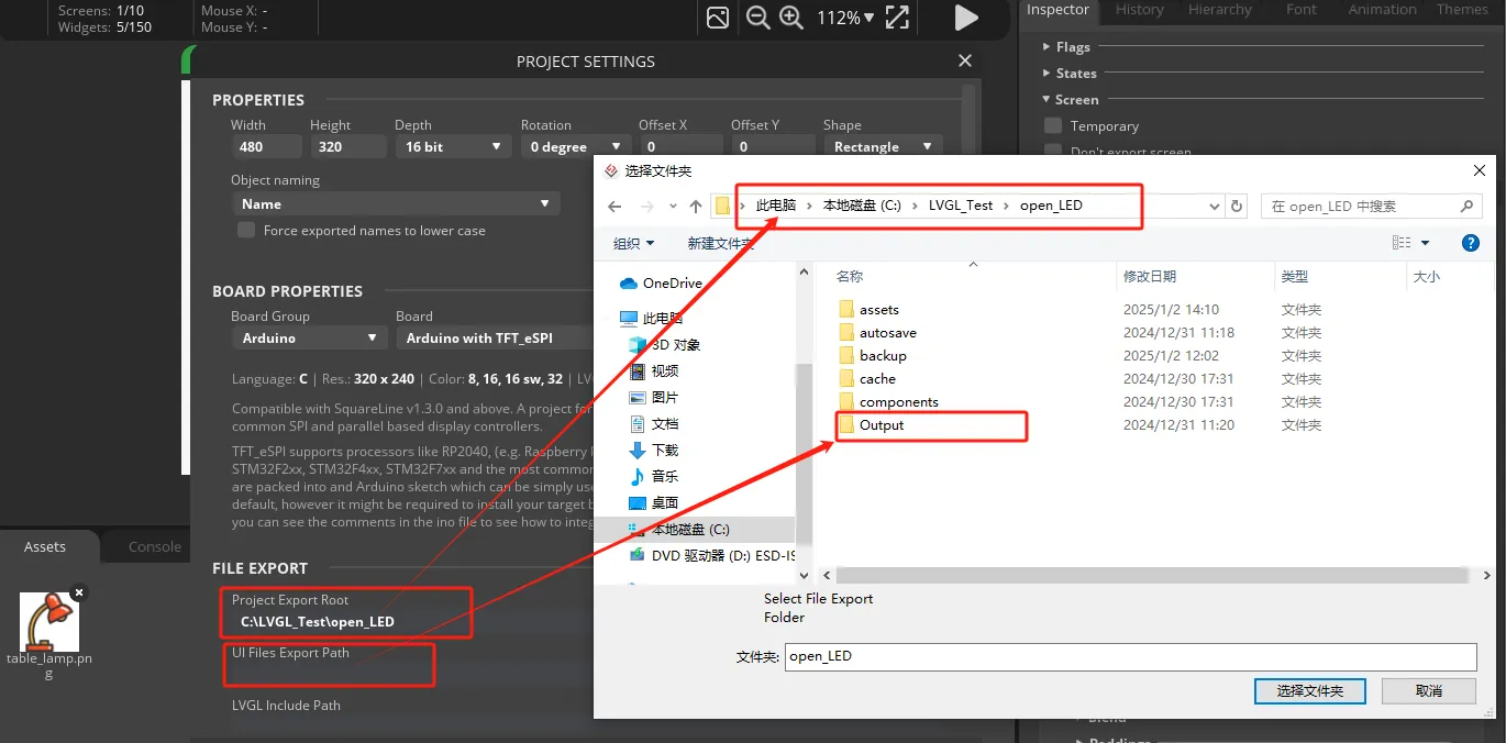

5 UI interface design completed, exporting UI files for easy use in subsequent code
Click on Project Setting
40
Set export path
41
42
Complete the setup and export file
43

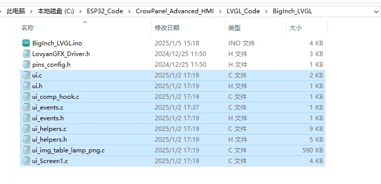

Copy and paste the exported code into the code folder we need to open
44
45
Then double-click BigInch_LVGL.ino and open it using Arduino IDE

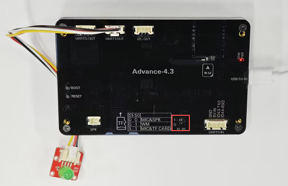

6 Connect the light bulb and add code to control the light bulb to turn on and off
Connect the light bulb at the UART1 interface
46
Observing the schematic diagram of this size, it is known that the pin for UART1 to control the light bulb to turn on and off is 19
47
48
A large-sized screen requires setting 19 pins as the output mode.
(Due to the fact that pin 19 in the circuit of large-sized products controls both the wireless module and the UART1 interface, it is necessary to switch the mode to 0 1)

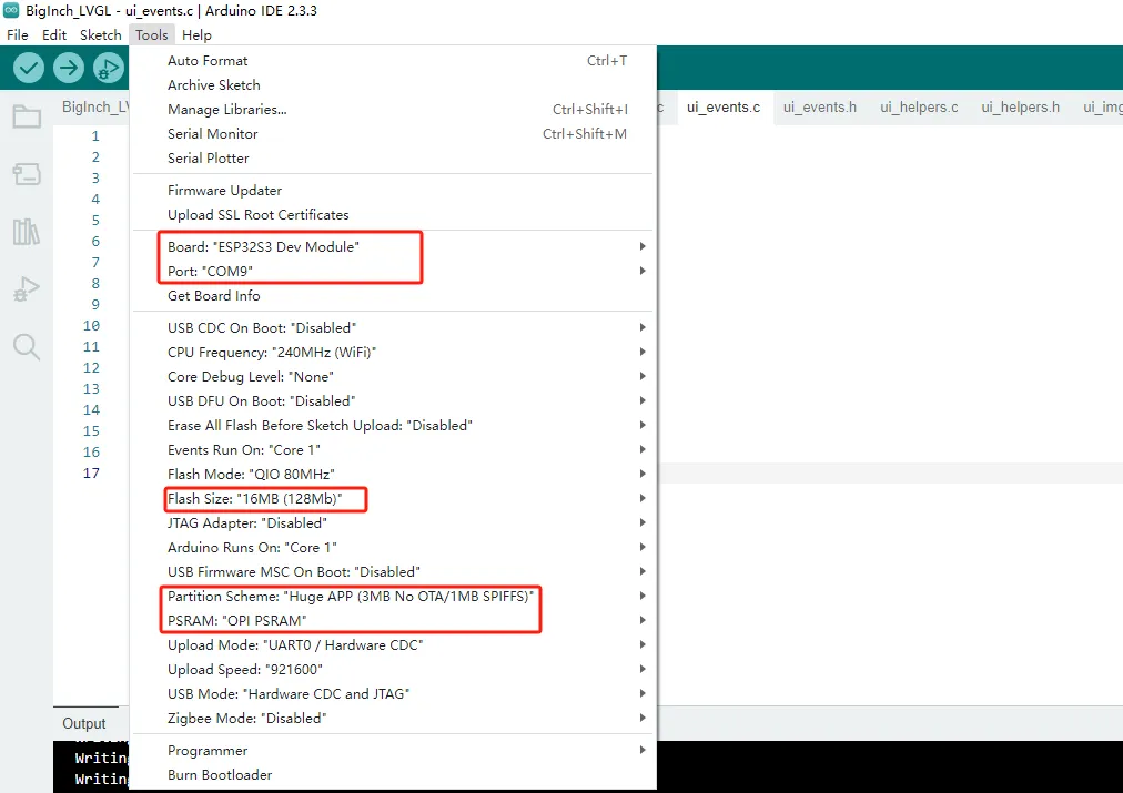

7 Configure the code running environment and upload the code
(!! Before uploading the code, please use different library files according to the size you are using. You can review the content of Lesson 2)
(For large-sized screens of 4.3-inch, 5.0-inch, and 7.0-inch, be sure to switch the mode to 0 1 state before uploading the code, because the pins of UART1 and W-M mode are both used in 0 1 mode, so that you can use the pins of UART1)
51
52

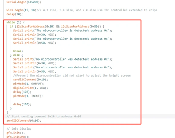

In terms of hardware, we use a microcontroller (STC8H1K28) to control the screen backlight and the mute function of the speaker.
advance-1.2-new
(However, there are other function interfaces that need to be written in the specific code, and you can refer to the complete code provided later.)
Explanation:
  • 0x30 is the I2C address of the microcontroller (STC8H1K28).
  • 0x5D is the I2C address of the touch IC (GT911).
  • sendI2CCommand(0x10) means sending the 0x10 command to the microcontroller (0x30) to instruct the microcontroller to set the screen brightness to maximum.
(For 0x10 mentioned above, you can replace it with the following values:
  • 0x05: Turn off the screen
  • 0x06 to 0x10: The screen brightness will gradually increase to the maximum)
To set a different brightness level, you must first send 0x10 to turn on the screen, and then send another value to adjust the brightness.
