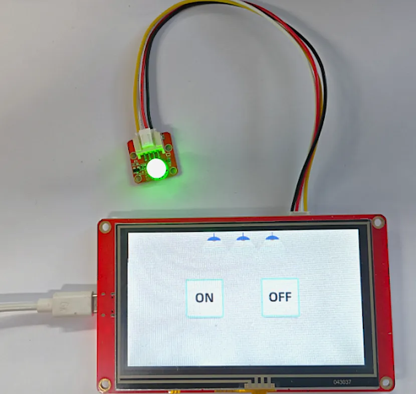

The example tutorial demonstrate how to create a UI and how to control the LED on and off by the buttons on the screen.
In this tutorial, we will show you how to design the UI with SquareLine Studio, and show you how to upload the code with Thonny IDE.

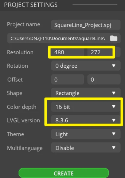

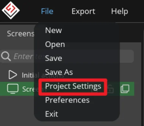

  1. Open the SquareLine Studio and create a project. Select "Desktop"->"Micropython for Unix and other platform".
    SLS-UI-1

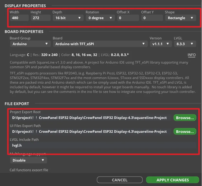

  2. Set the name of the project, set the screen resolution to 480*272, set the color depth to 16bit, and keep other default settings. After setting, click CREATE to create the project.
    SLS-UI-2

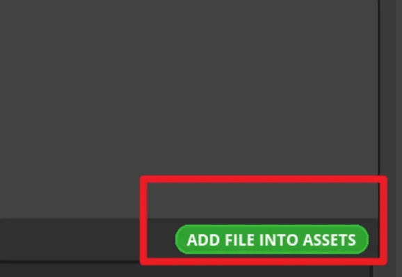

  4. In the "Assets" area, click "ADD FILE TO ASSETS" to add custom images or icons.
    SLS-UI-3-1

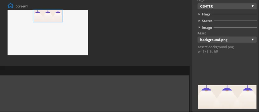

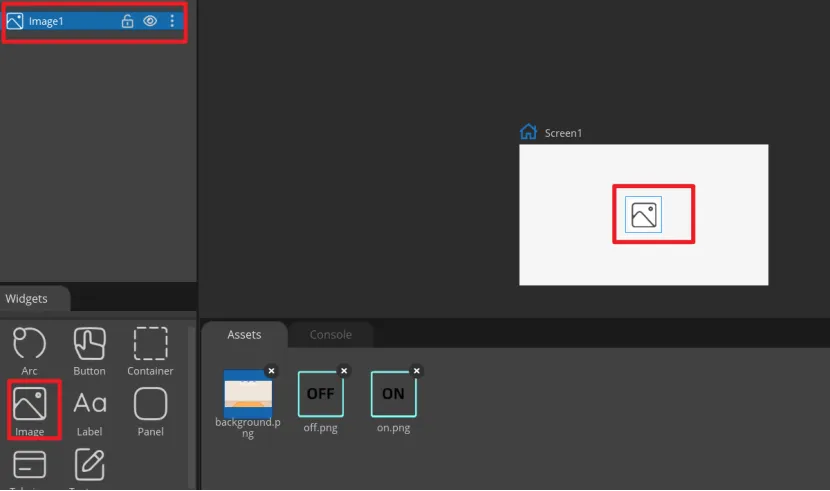

  5. Add background.

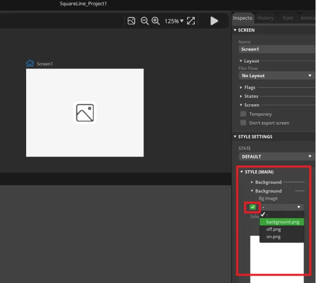

    Click "Image" to add the image widgets.
    SLS-UI-4

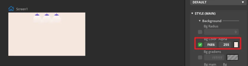

    Find "Inspector"->"STYLE SETTING", click to expand "STYLE(MAIN)", then click the 2nd "Background". Check the "Bg Image" and select a background picture.
    SLS-UI-5
    Adjust the position of the image.
    SLS-UI-6
    Note: Because it requires a large amount of memory when running in Thonny IDE, the UI background resolution of this tutorial is small and not full screen, so it is necessary to modify the background to the same color as the image.
    SLS-UI-7

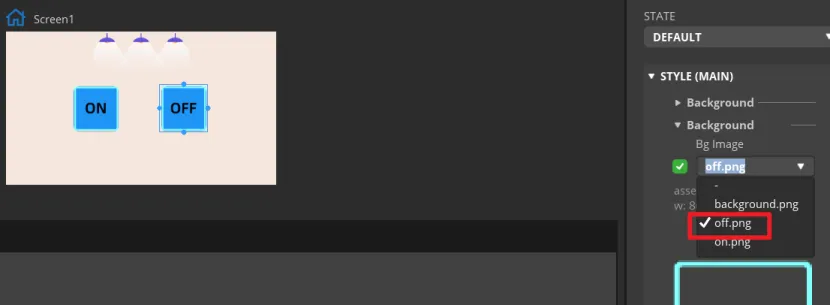

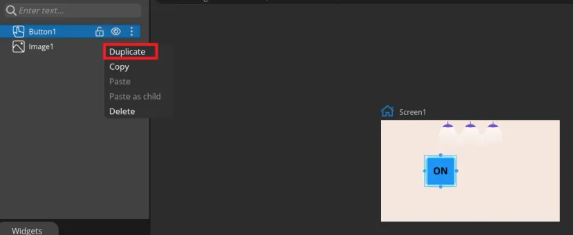

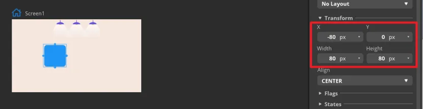

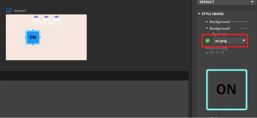

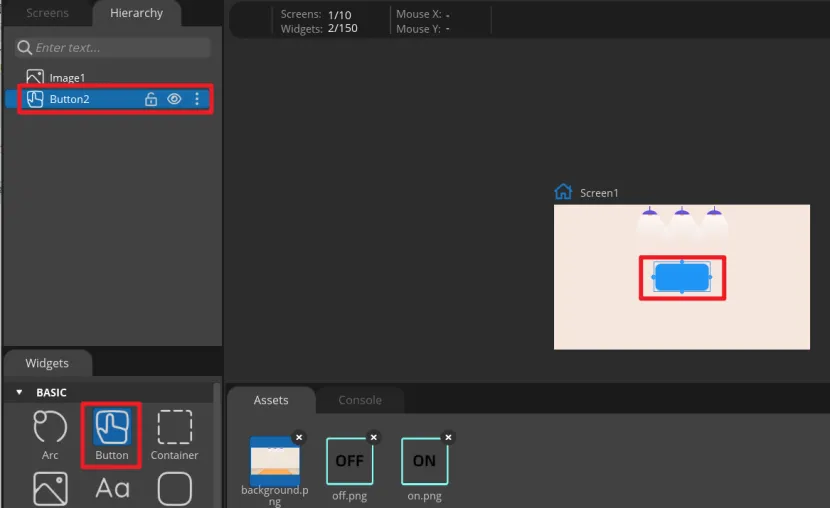

  6. Add Button widget to control the LED.
    SLS-UI-8
    SLS-UI-9
    SLS-UI-10

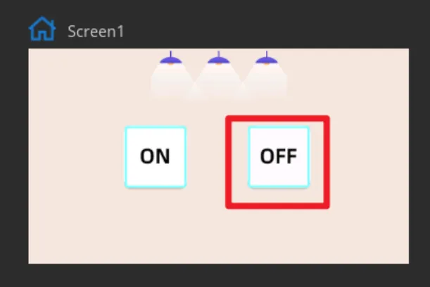

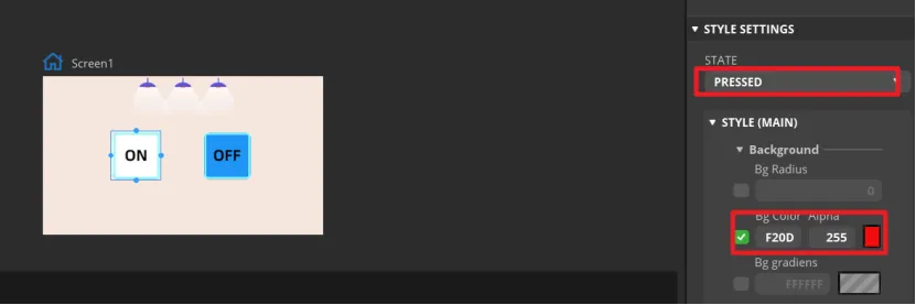

    Add a Button2 for "OFF".
    SLS-UI-11
    SLS-UI-12
    SLS-UI-13
    SLS-UI-14

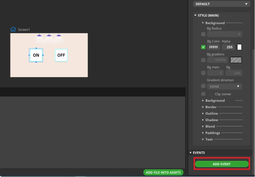

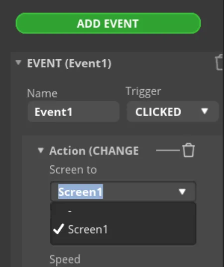

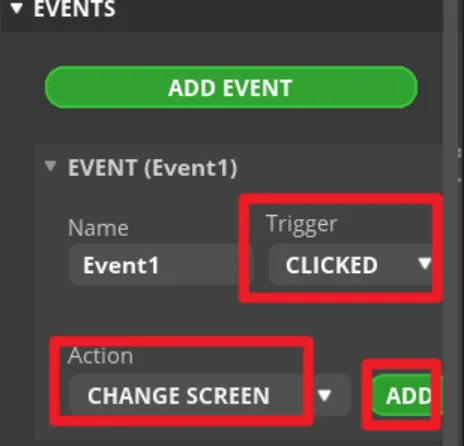

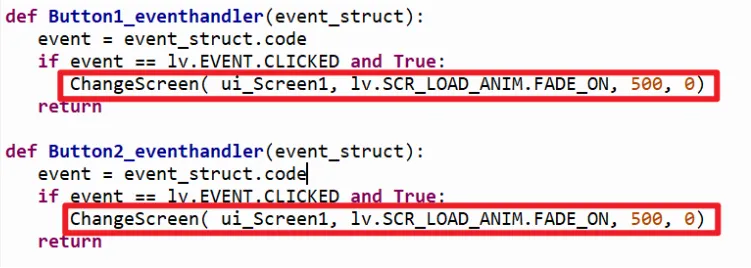

  7. Add events to buttons.
    SLS-UI-15
    SLS-UI-16
    SLS-UI-17
    SLS-UI-18

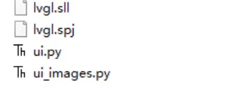

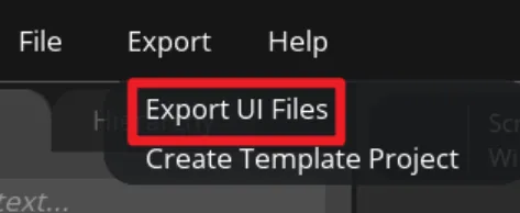

  8. Export UI files.
    SLS-UI-19
    Then click "APPLY CHANGES".
    SLS-UI-20
    SLS-UI-21
    SLS-UI-22
The UI file export is completed. Next we're going to learn about the main program and learn how to upload the code to the board with Thonny IDE.

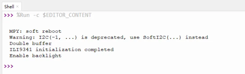

Upload firmware
  1. Connect the CrowPanel ESP32 HMI with your computer.

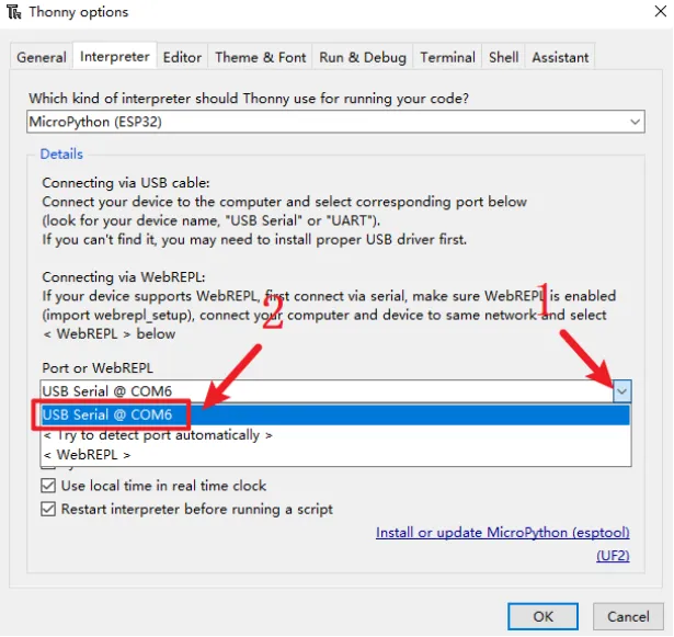

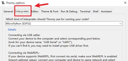

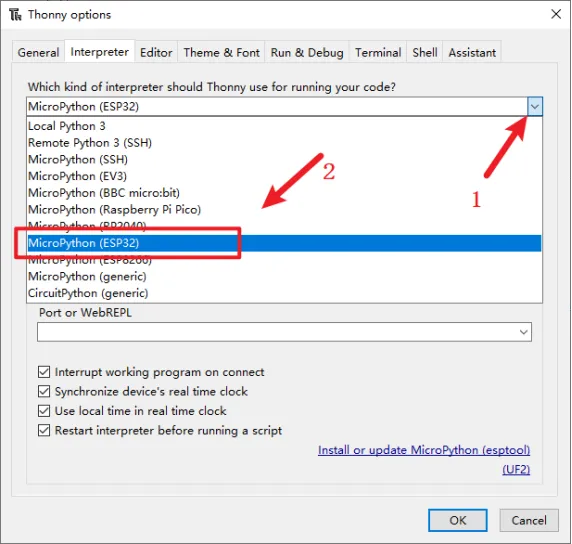

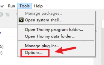

  2. Open Thonny IDE and click "Tools"->"Options"->"Interpreter".
  3. Select "MicroPython(ESP32)" for interpreter.
  4. Select the corresponding serial port(or Try to detect port automatically).
  5. Click "Install or update MicroPython (esptool)"
  6. Click the icon with 3 lines, and click "select local MicroPython image...".Select the "firmware-4.3-A.bin" and install.
    Please click download to download the bin file.
  7. Waiting for downloading...

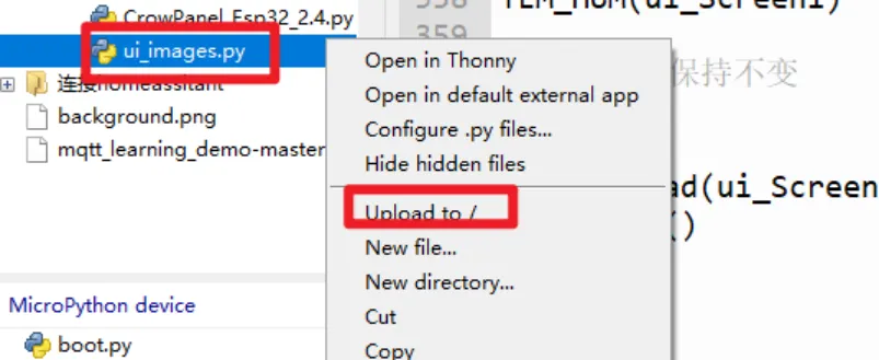

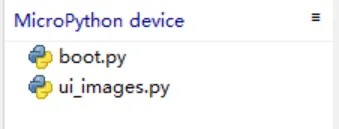

Edit the code
Please click download to download the code file and libraries.

def Button1_eventhandler(event_struct):
   event = event_struct.code
   if event == lv.EVENT.CLICKED and True:
      pin38.value(1)
   return
def Button2_eventhandler(event_struct):
      pin38.value(0)
   return

UI code
This part copies the code of ui.py generated by Squareline Studio. We need to modify the part that control the button.
Modify from
button-1
to
      pin38.value(1)
   return
      pin38.value(0)
   return
Upload the code
Upload the libraries
ui_image.py
  1. In the upper left corner of the thonny, enter the path where ui_image.py is located, right-click ui_image.py, and click Upload to/
  2. ui_image.py is added to MicroPython device successfully.
Upload the code
Click the "run" icon.
Successfully uploaded.

Example 1 Turn on/off the LED in a loop
Connect an LED module to the D port(pin38) of ESP32 4.3'' HMI, and upload the following code. The LED will turn on and off in a loop.
#Make by Elecrow
#Web:www.elecrow.com
import time
from machine import Pin
pin38 = Pin(38, Pin.OUT)
while True:
    pin38.value(1)
    time.sleep(0.5)
    pin38.value(0)
    time.sleep(0.5)
