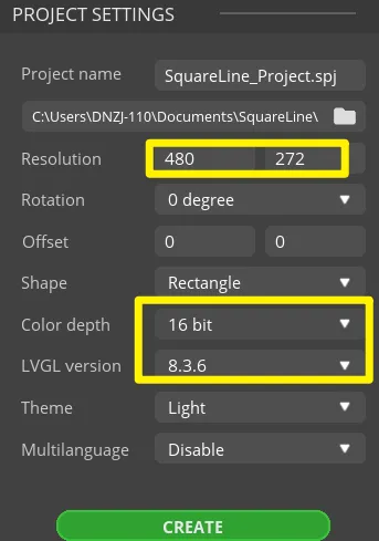

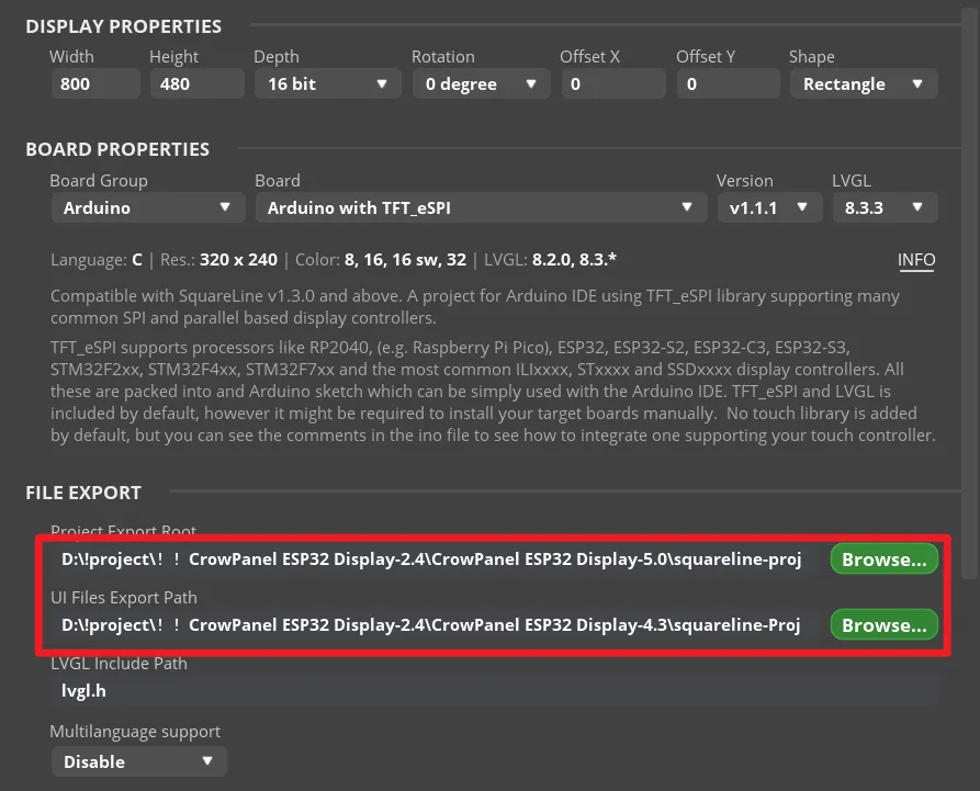

  2. Set the name of the project, set the screen resolution to 480*272, set the color depth to 16bit, and keep other default settings. After setting, click CREATE to create the project.
    SLS-UI-2

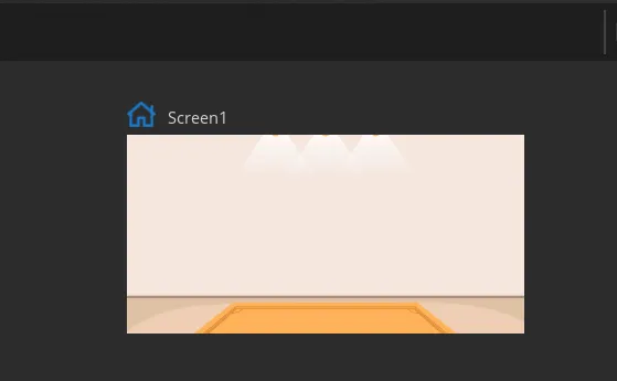

  5. Add background.
    SLS-UI-5
    SLS-UI-6

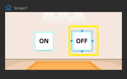

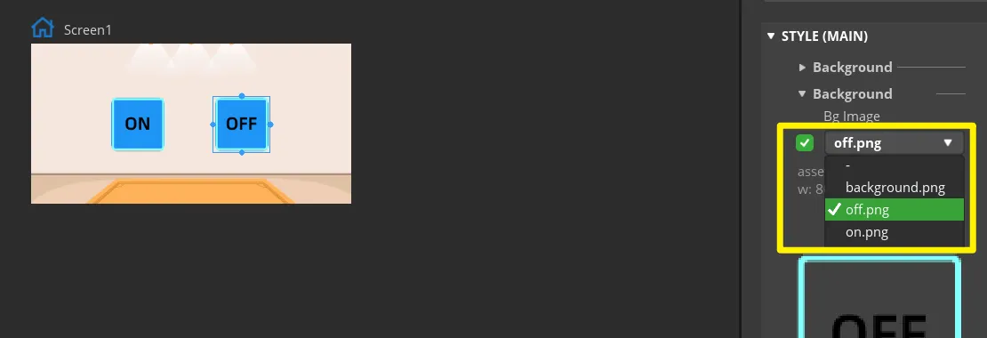

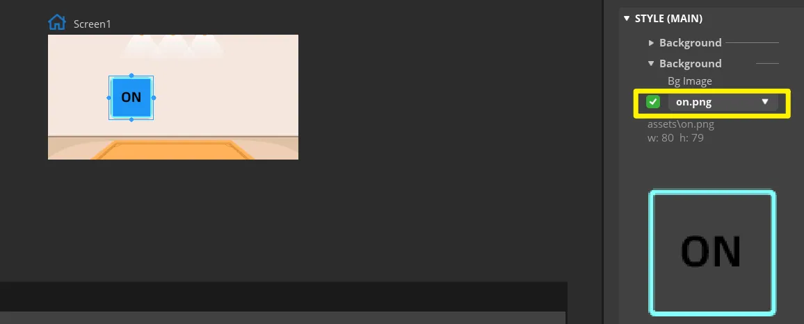

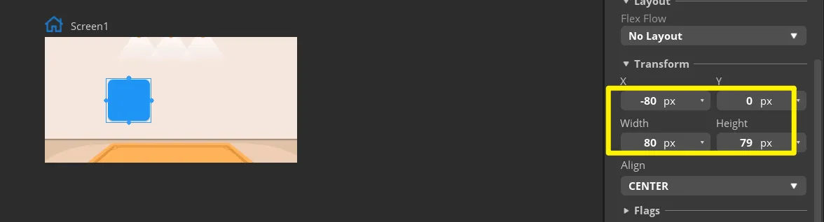

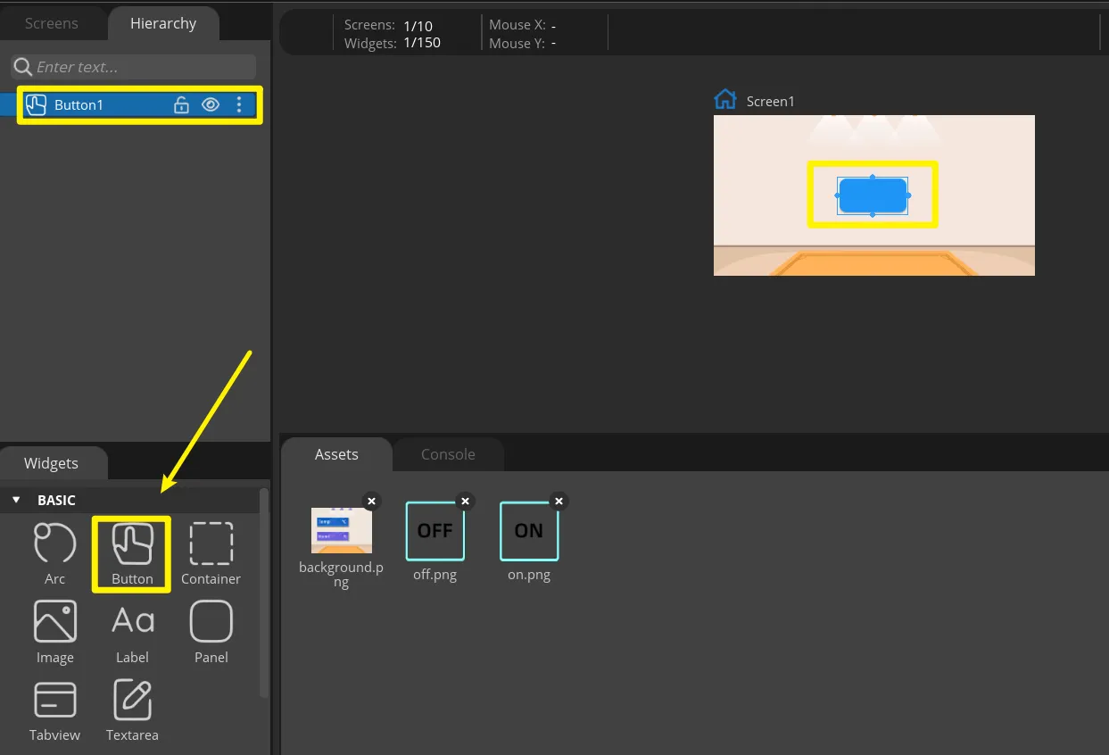

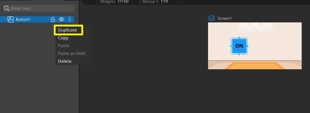

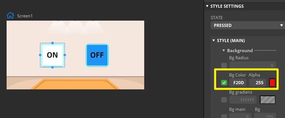

  6. Add Button widget to control the LED.
    SLS-UI-12
    SLS-UI-13
    SLS-UI-14
    SLS-UI-16
    SLS-UI-17
    SLS-UI-20
    SLS-UI-19

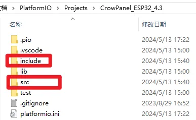

Create a new project
  1. Place the esp32-s3-devkitc-1-myboard.json to the directory in the following picture:

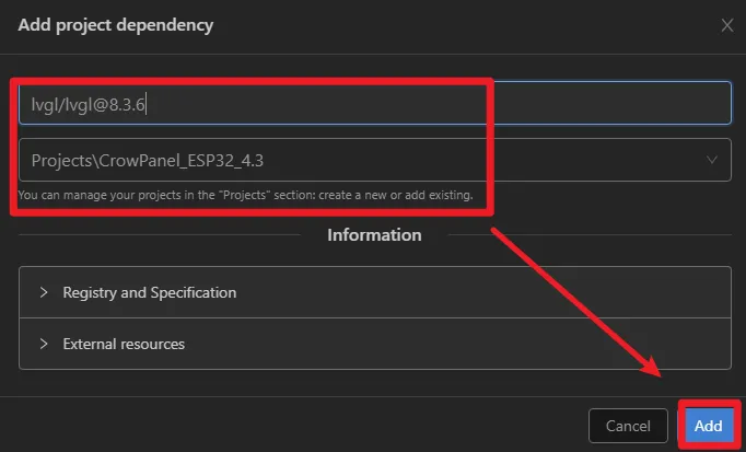

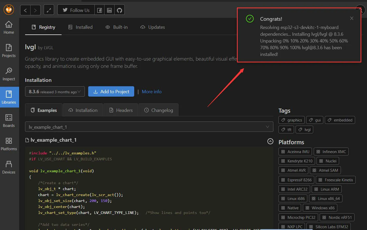

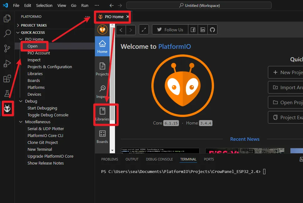

Add Libraries
  1. Click the PlatformIO icon, click QUIK ACCESS 'Open', then click 'Libraries'.
    PIO-6

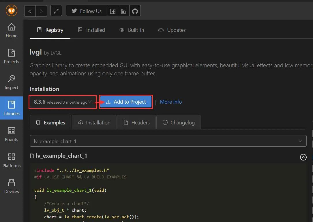

  2. Search for LVGL, and add it to the project.
    PIO-7
    PIO-8
    PIO-9
    PIO-10

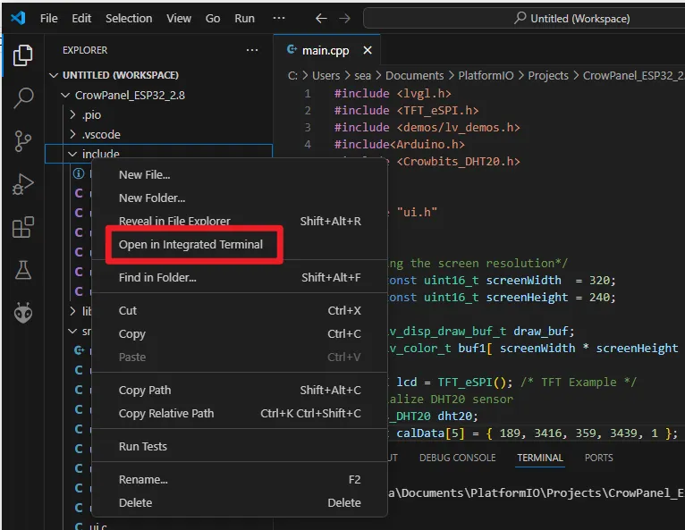

    After adding, right click on lvgl and select "Open in Integrated Terminal"
    PIO-17
    Copy the "demos" and "examples" folders to "src" folder
    PIO-18

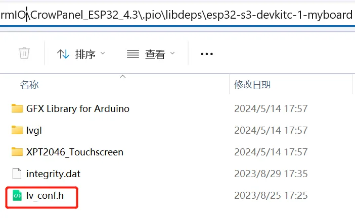

    Place the lv_conf.h we provide to the path: .pio\libdeps\esp32-s3-devkitc-1-myboard in the project folder.
    PIO-19
    Please click download to download the lv_conf.h file.

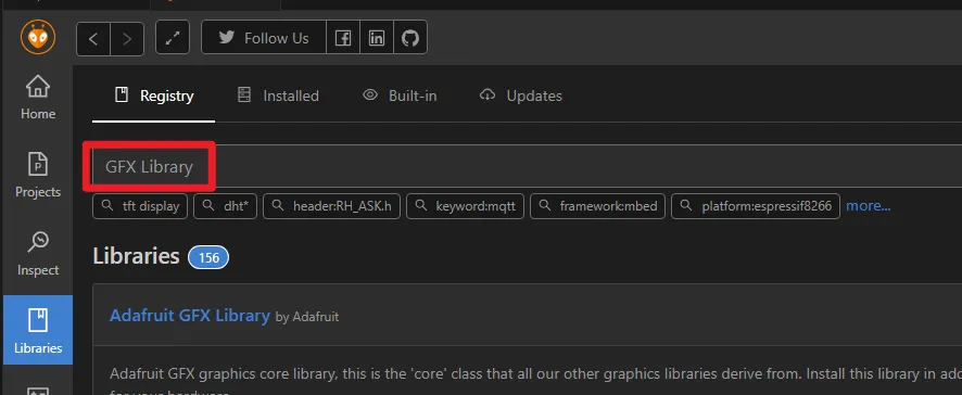

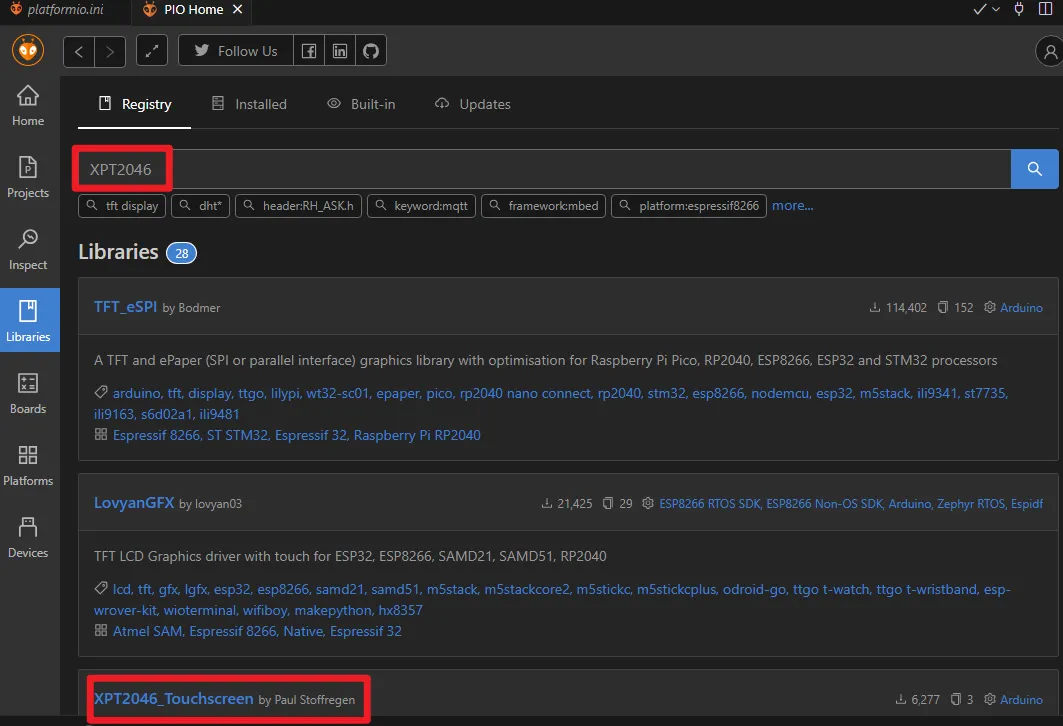

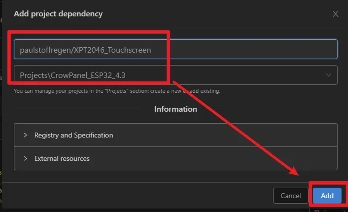

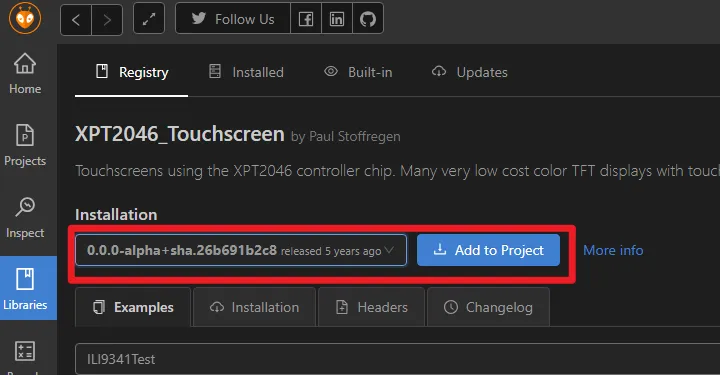

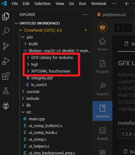

  3. Add XPT2046
    PIO-11

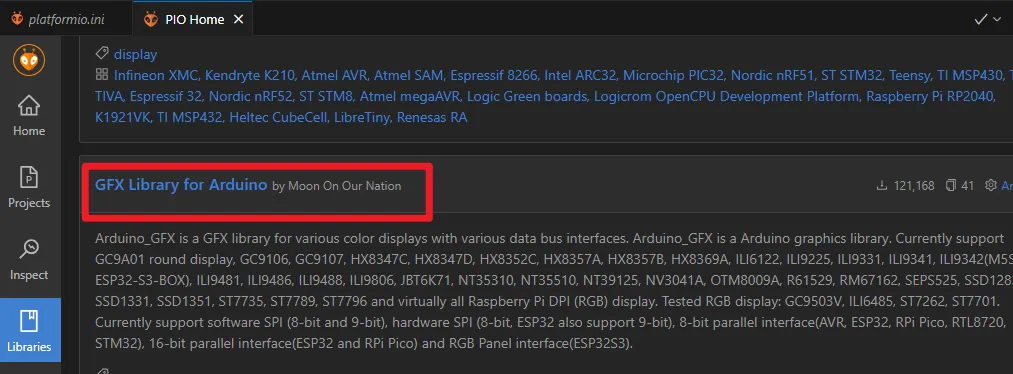

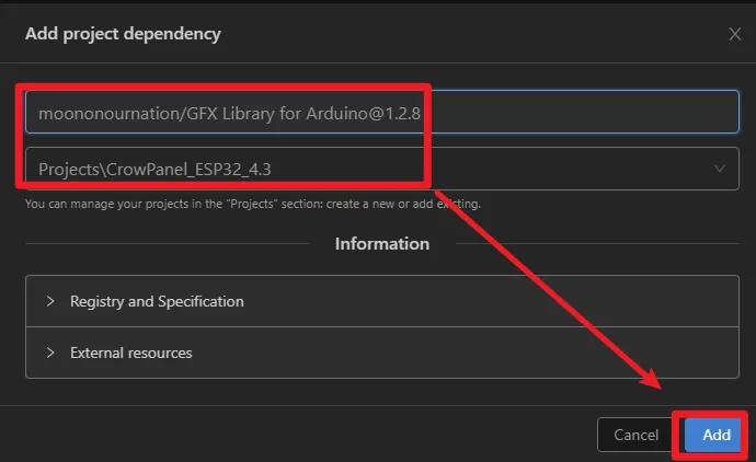

  4. Add GFX Library for Arduino
  5. We can see that the library has been added successfully!

The .c file in the UI file should be placed in the /scr folder of the project file, and the .h files should be placed in the /include folder.
PIO-34
PIO-35

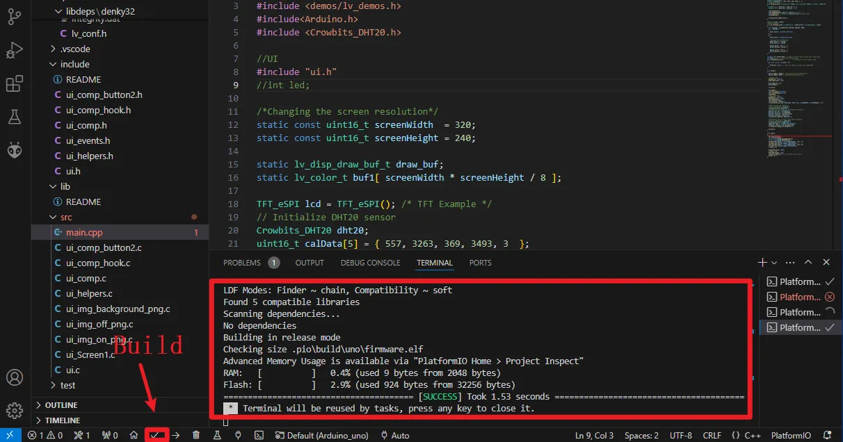

  1. Compile the program.
    Upload-code-1

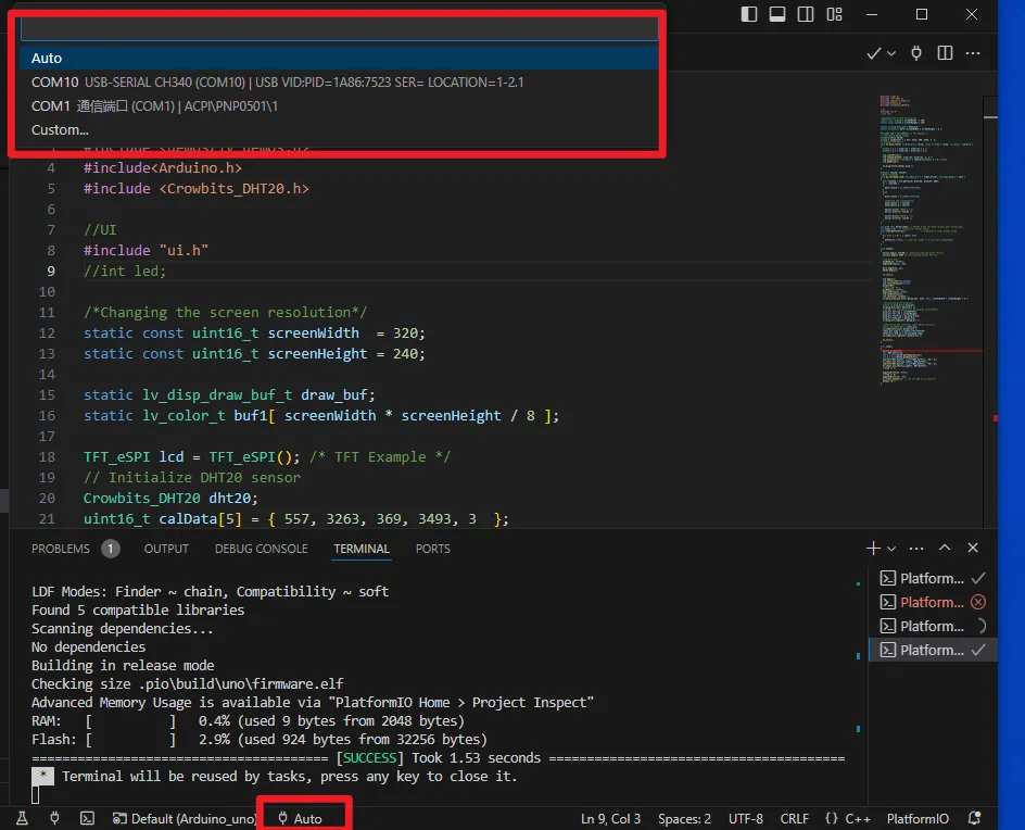

  2. Select the serial port and upload the code.
    Here we select Auto. The software will automatically select the corresponding serial port for program download. If the automatically selected serial port is incorrect, you can manually select the correct serial port.
    Upload-code-2
  3. Click the upload button to up the program to the board.
    Upload-code-3

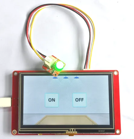

  4. The program will run on the board!
    CrowPanel-ESP32-4-3inch-demo
