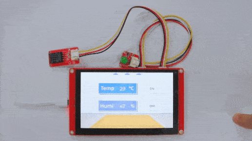

The example is an environmental monitoring project, using a DHT20 sensor to obtain the environment temperature and humidity and display it on the screen; and control the LED on and off by the buttons on the screen.
In this tutorial, we will show you how to design the UI with SquareLine Studio, and show you how to build a project on PlatformIO.

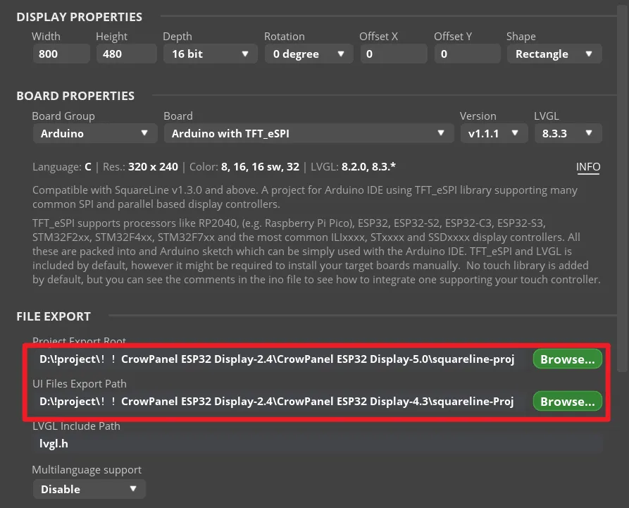

Open the SquareLine Studio and create a project. Select "Arduino"->"Arduino with TFT_eSPI".
Note:

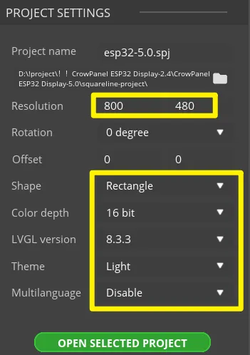

Set the name of the project, set the screen resolution to 800*480, set the color depth to 16bit, and keep other default settings. After setting, click CREATE to create the project.

Export UI files.
Then click "APPLY CHANGES".

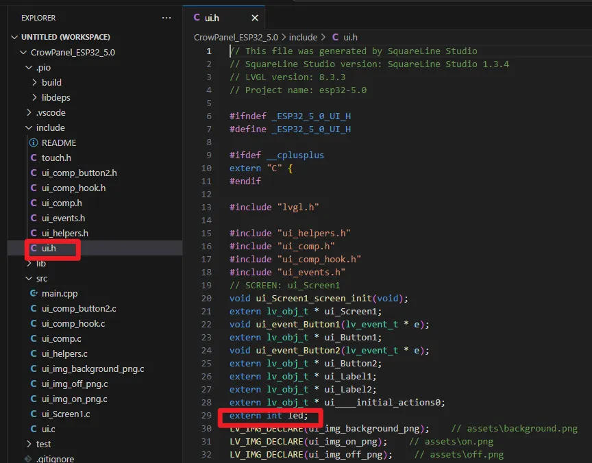

First, define a ‘extern int led;' in the ui.h file to store the status of the LED. The value of this variable is judged to control the on and off of the LED.
- When button 1 (ON button) is pressed, set the LED value to 1.
- When button 2 (OFF button) is pressed, set the LED value to 0.

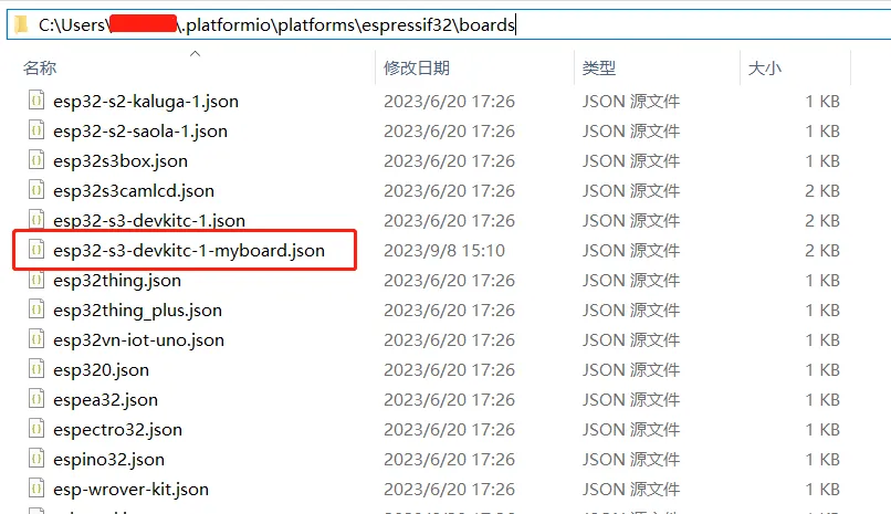

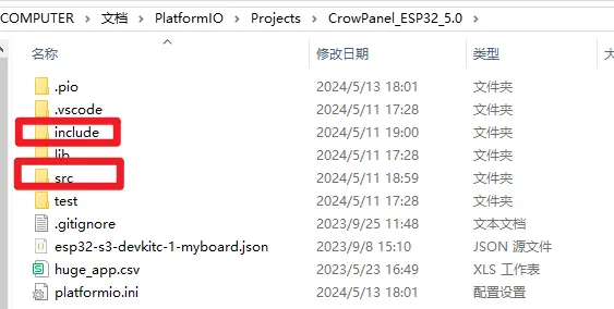

Place the esp32-s3-devkitc-1-myboard.json to the directory in the following picture:
Please click
to download the esp32-s3-devkitc-1-myboard.json.

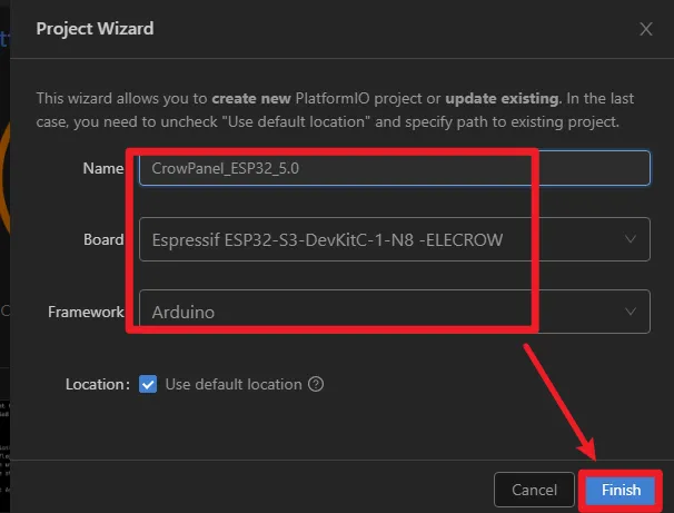

Open Visual Studio Code, click the PlatformIO icon, click QUIK ACCESS 'Open', then click '+New Project'.
Add a project name "CrowPanel_ESP32_5.0". Select "Espressif ESP32-S3-DevKitC-1-N8 -ELECROW" for the board and Arduino for the framework.

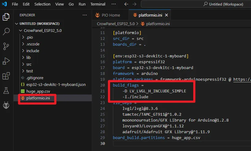

Add the following code to the platformio.ini file

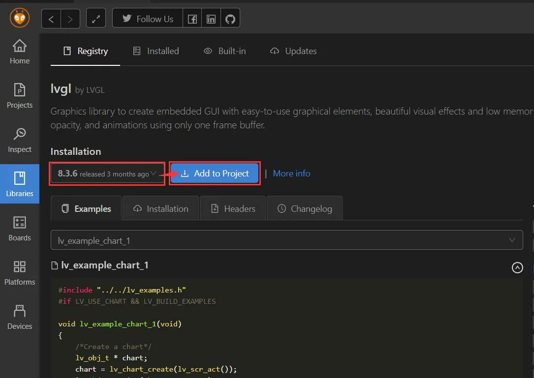

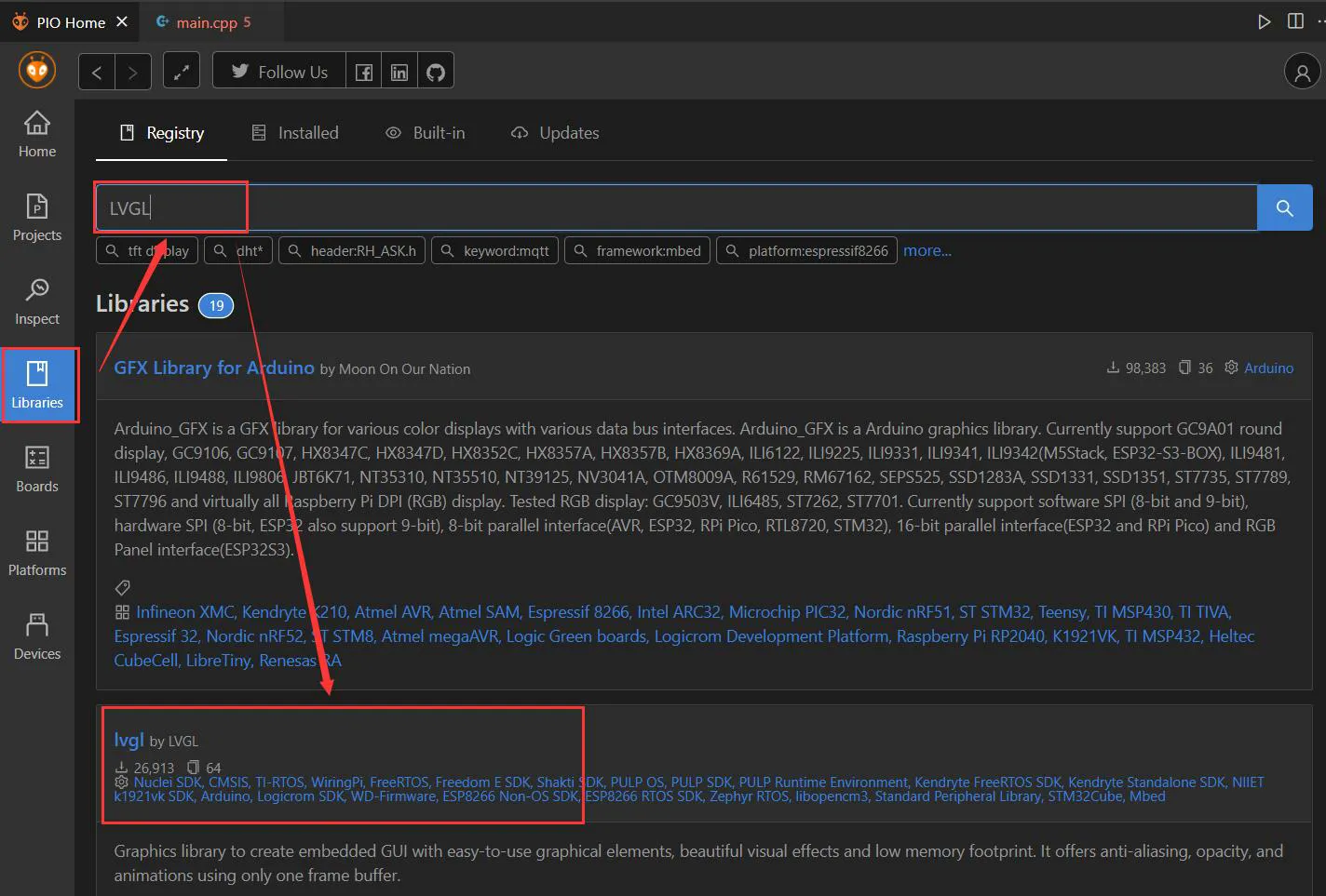

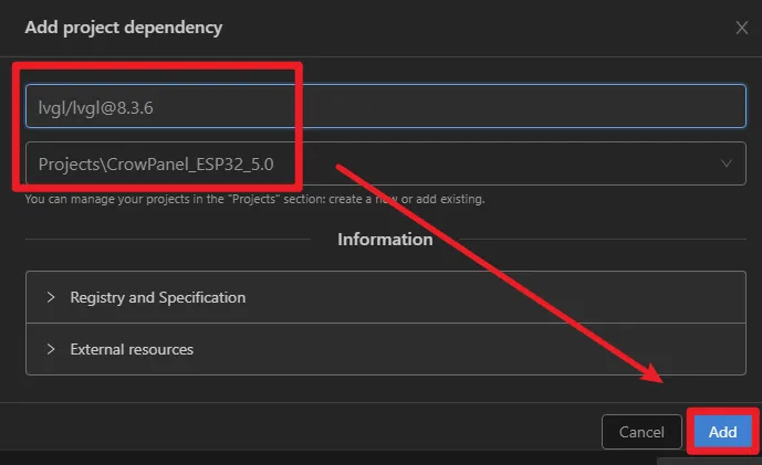

Click the PlatformIO icon, click QUIK ACCESS 'Open', then click 'Libraries'.
Search for LVGL, and add it to the project.

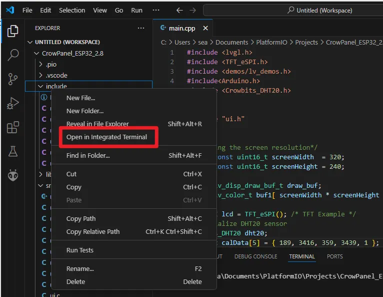

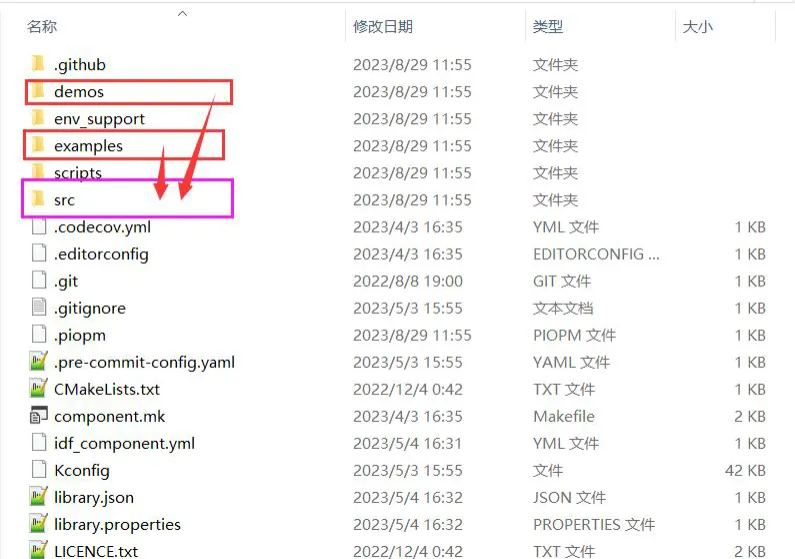

After adding, right click on lvgl and select "Open in Integrated Terminal"
Copy the "demos" and "examples" folders to "src" folder

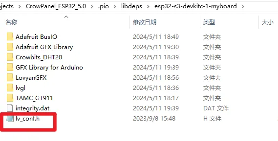

Place the lv_conf.h we provide to the path: .pio\libdeps\esp32-s3-devkitc-1-myboard in the project folder.

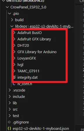

Add Adafruit_GFX

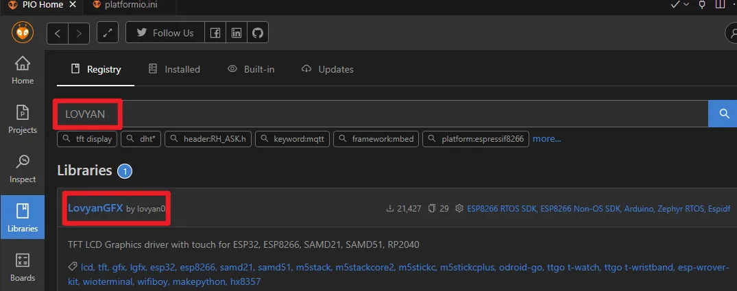

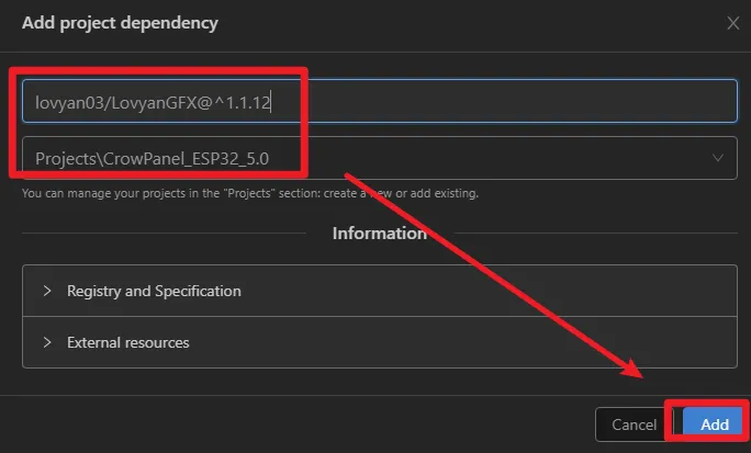

Add LovyanGFX library

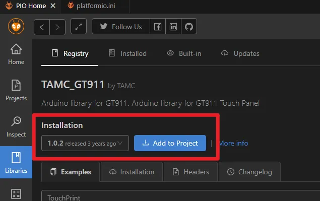

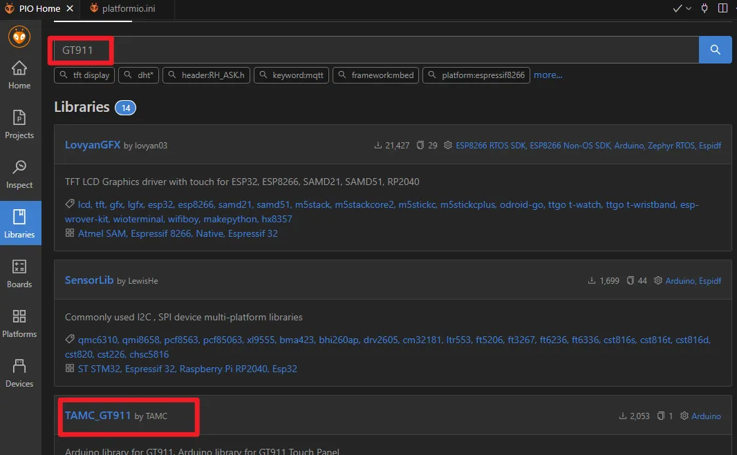

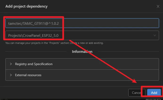

Add GT911

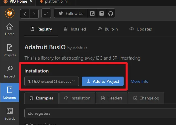

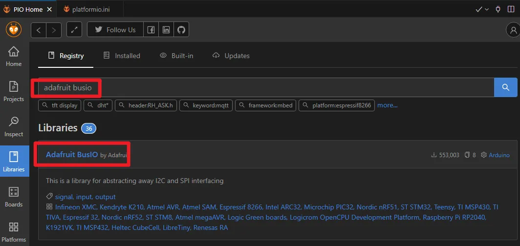

Add Adafruit_Busio
We can see that the library has been added successfully!

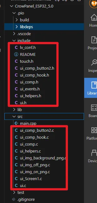

We need to add the UI file (generated from SquareLine Studio) to the PlatformIO project.
The .c file in the UI file should be placed in the /scr folder of the project file, and the .h files should be placed in the /include folder.

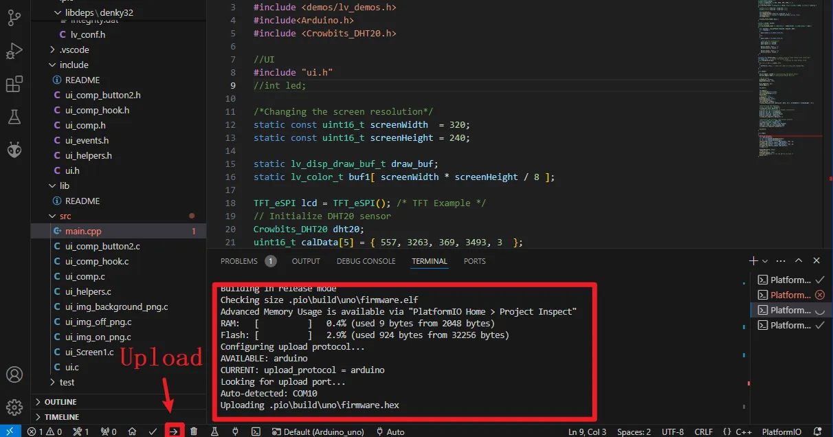

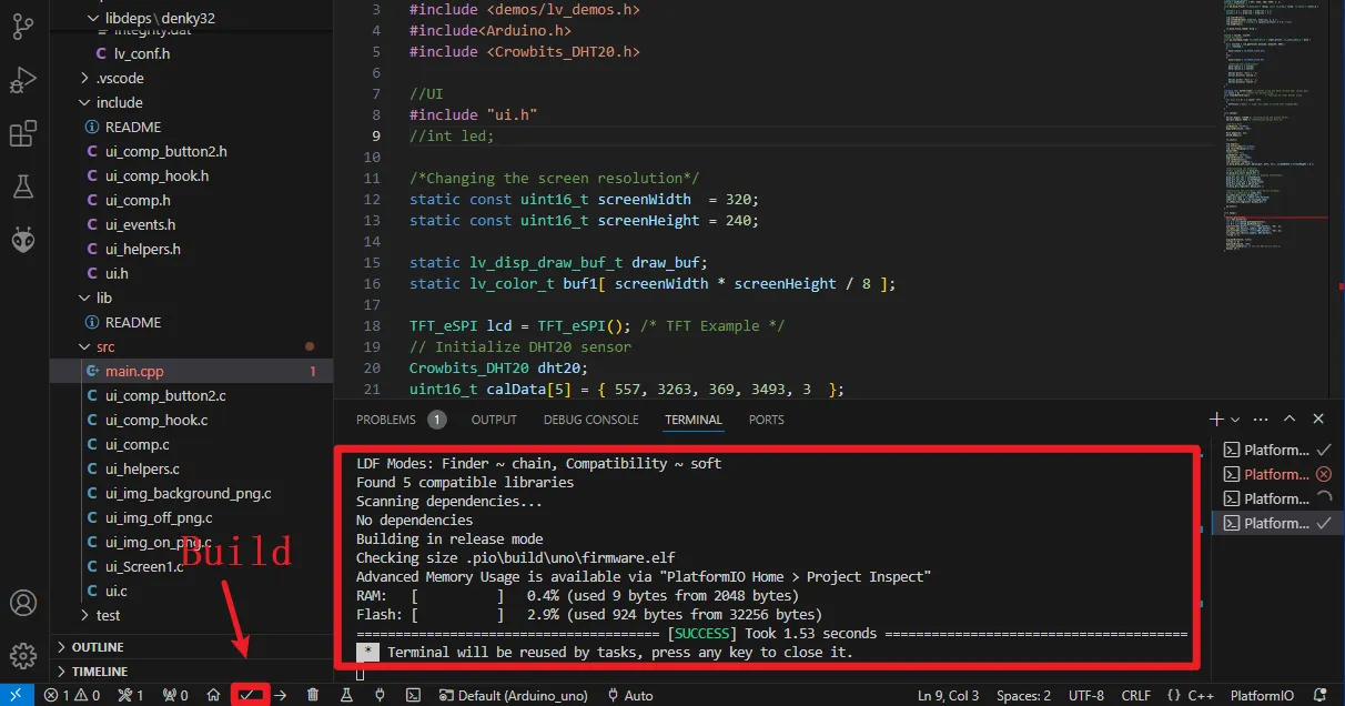

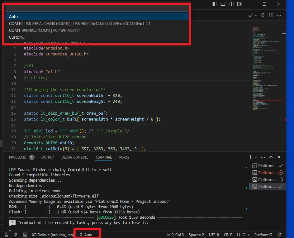

Compile the program.
Select the serial port and upload the code.
Here we select Auto. The software will automatically select the corresponding serial port for program download. If the automatically selected serial port is incorrect, you can manually select the correct serial port.
Click the upload button to up the program to the board.
The program will run on the board!
