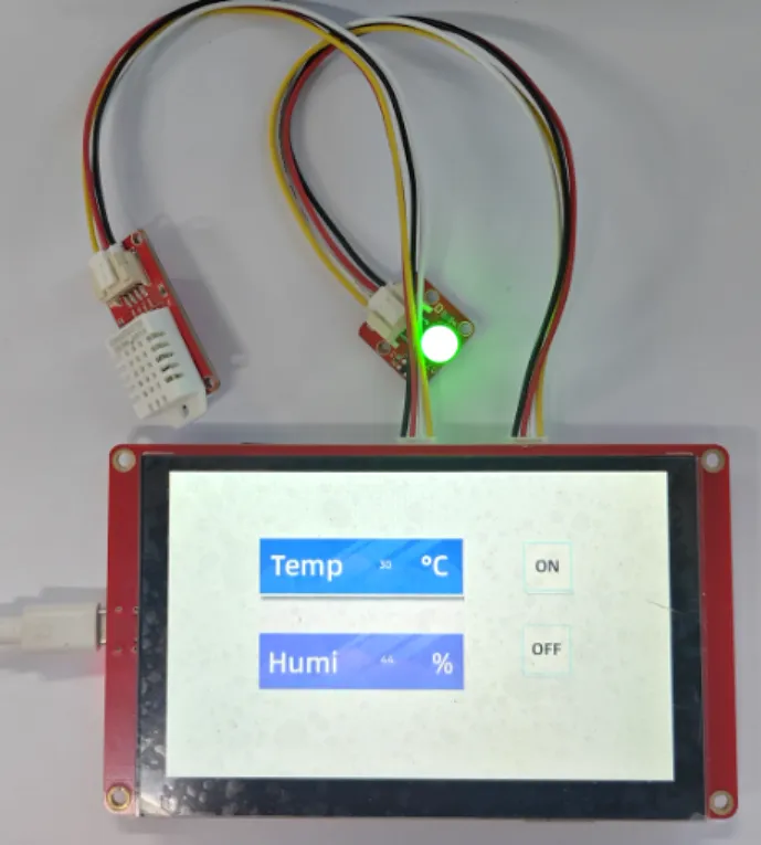

he example tutorial is an environmental monitoring project, demonstrate how to create a UI and use a sensor to obtain the environment temperature and humidity and display it on the screen; and how to control the LED on and off by the buttons on the screen.
In this tutorial, we will show you how to design the UI with SquareLine Studio, and show you how to upload the code with Thonny IDE.

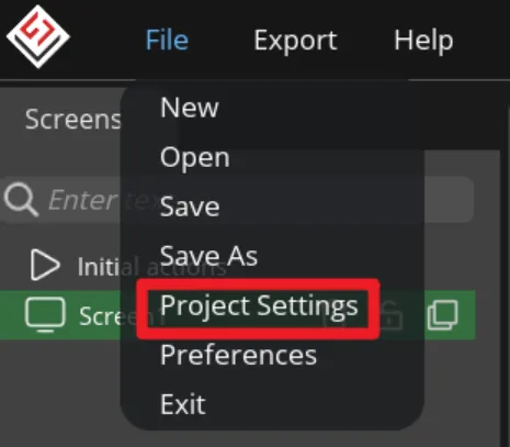

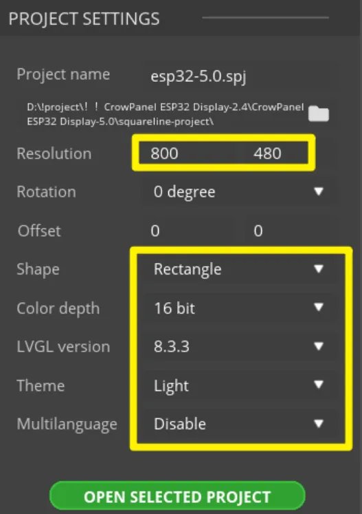

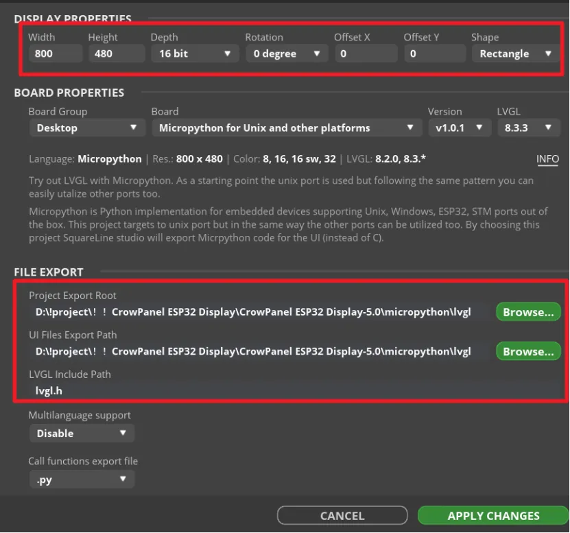

Open the SquareLine Studio and create a project. Select "Desktop"->"Micropython for Unix and other platform".
Set the name of the project, set the screen resolution to 800*480, set the color depth to 16bit, and keep other default settings. After setting, click CREATE to create the project.

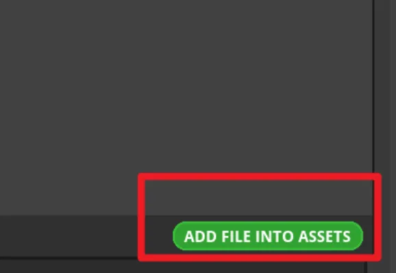

Please click
to download the custom images used in this tutorial.

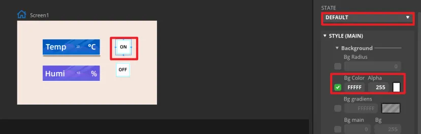

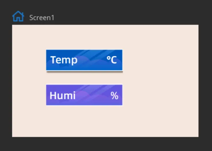

Add background.

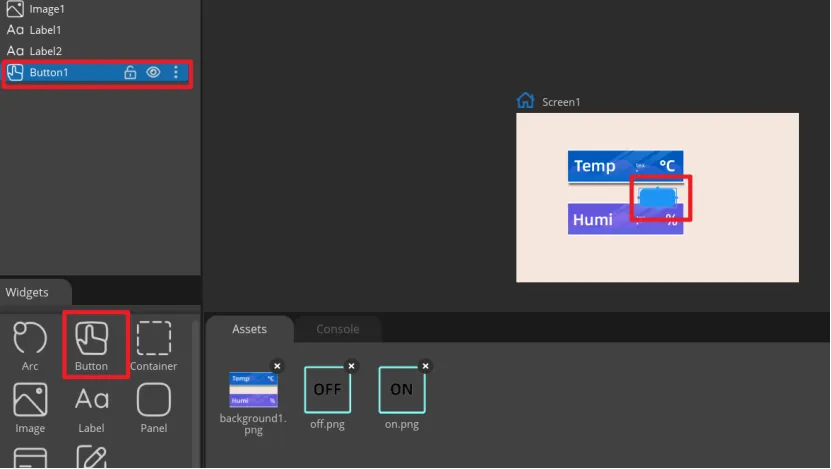

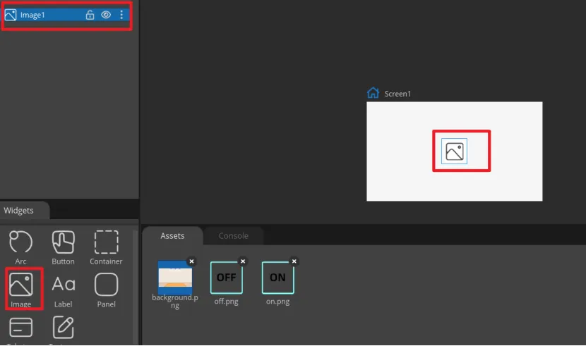

Click "Image" to add the image widgets.

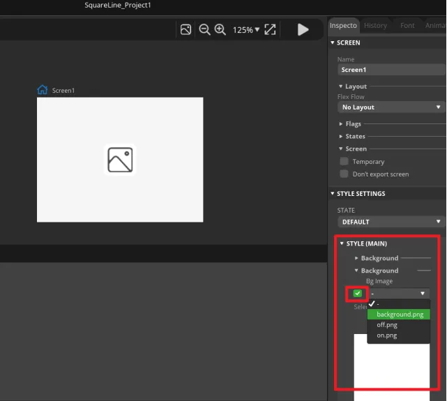

Find "Inspector"->"STYLE SETTING", click to expand "STYLE(MAIN)", then click the 2nd "Background". Check the "Bg Image" and select a background picture.

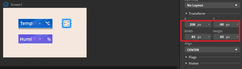

Adjust the position of the image.
Note: Because it requires a large amount of memory when running in Thonny IDE, the UI background resolution of this tutorial is small and not full screen, so it is necessary to modify the background to the same color as the image.

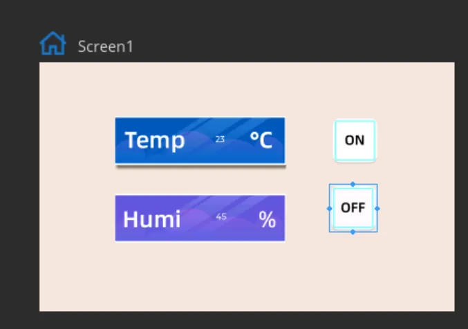

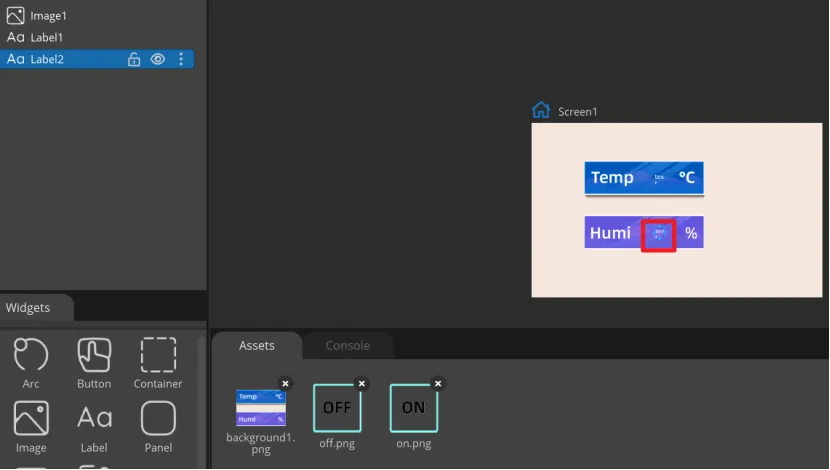

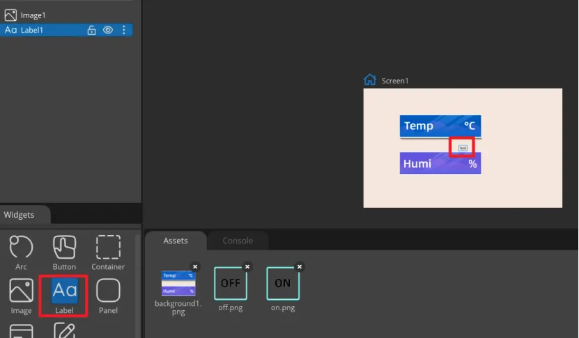

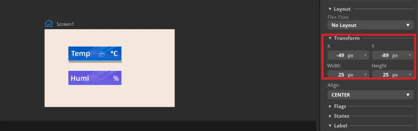

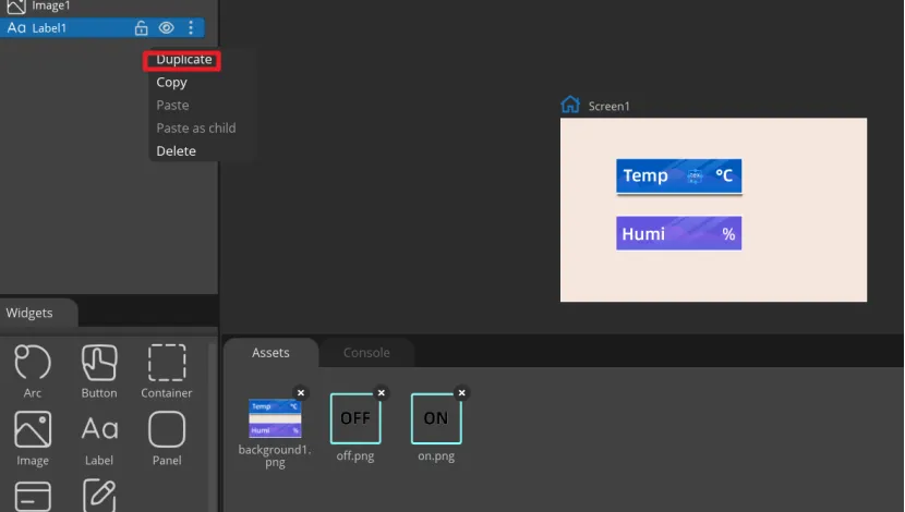

Add Label widget to show temperature and humidity value
The content, position and size of the label can be adjusted by dragging the mouse. You can also directly enter numbers in the Inspector→LABEL→Transform to adjust. You can set the font color and other attributes in STYLE SETTING→STYLE(MAIN).
You can set the color and other attributes of the font in STYLE SETTING ->STYLE (MAIN).

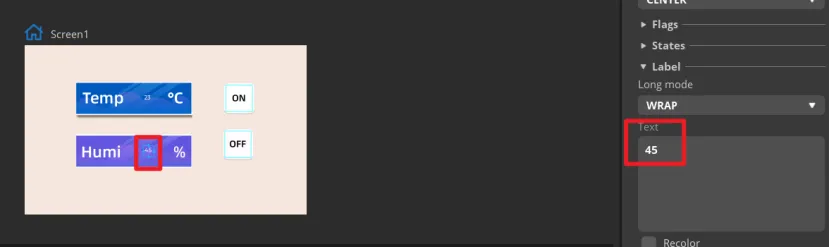

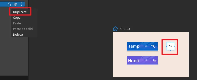

Duplicate a Label2 to show humidity value.
Adjust the position.
You can change the text of the label to set a default value.

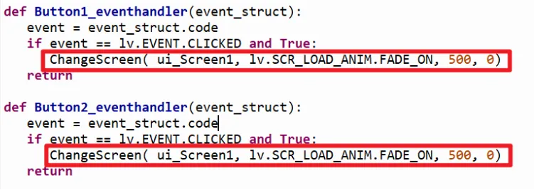

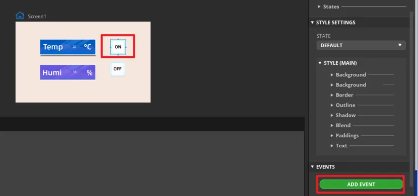

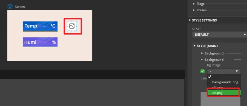

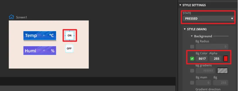

Duplicate a Button2 for "OFF".

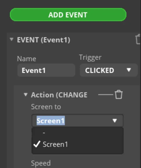

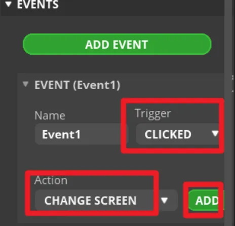

Add events to buttons.

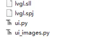

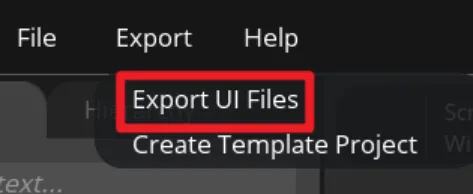

Export UI files.
Then click "APPLY CHANGES".
The UI file export is completed. Next we're going to learn about the main program and learn how to upload the code to the board with Thonny IDE.

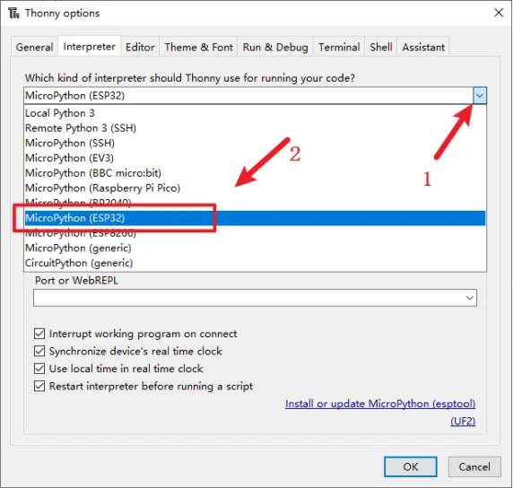

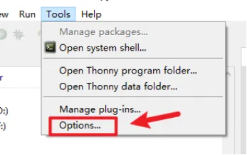

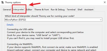

Open Thonny IDE and click "Tools"->"Options"->"Interpreter".
Select "MicroPython(ESP32)" for interpreter.

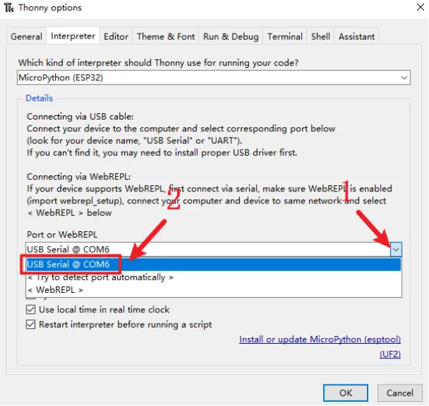

Select the corresponding serial port(or Try to detect port automatically).

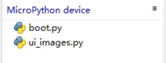

Click the icon with 3 lines, and click "select local MicroPython image...".Select the "firmware-5.0-A.bin" and install.
Waiting for downloading...

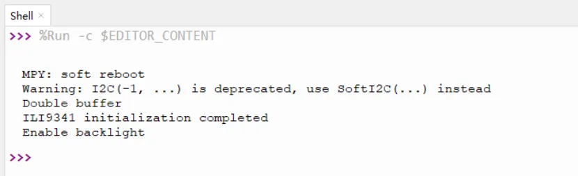

Edit the code¶

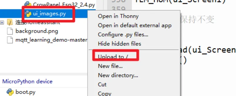

Please click to download the code file and libraries.
#Make by Elecrow
#Web:www.elecrow.com
import lvgl as lv
import lv_utils
import tft_config
import time
import fs_driver
import gt911
from machine import Pin, I2C
import dht
import ui_images
WIDTH = 800
HEIGHT = 480
# tft drvier
tft = tft_config.config()
pin38 = Pin(38, Pin.OUT)
pin38.value(0)
# touch drvier
i2c = I2C(1, scl=Pin(20), sda=Pin(19), freq=400000)
sensor = dht.DHT22(Pin(44))
tp = gt911.GT911(i2c, width=800, height=480)
tp.set_rotation(tp.ROTATION_INVERTED)
lv.init()
if not lv_utils.event_loop.is_running():
event_loop=lv_utils.event_loop()
print(event_loop.is_running())

ui_Label2 = lv.label(ui_Screen1)
ui_Label2.set_text("45")
ui_Label2.set_width(25) # 1
ui_Label2.set_height(25) # 1
ui_Label2.set_x(-48)
ui_Label2.set_y(60)
ui_Label2.set_align( lv.ALIGN.CENTER)
ui_Label2.set_style_text_color(lv.color_hex(0xFDFBFB), lv.PART.MAIN | lv.STATE.DEFAULT )
ui_Label2.set_style_text_opa(255, lv.PART.MAIN| lv.STATE.DEFAULT )
ui_Label2.set_style_text_font( lv.font_montserrat_16, lv.PART.MAIN | lv.STATE.DEFAULT )

pin38 = Pin(38, Pin.OUT)# Set GPIO pin 38 to output mode
pin38.value(0)
#Initialize DHT22 temperature and humidity sensor
sensor = dht.DHT22(Pin(44)) # Create a DHT22 object and specify the GPIO pin to connect to

This part copies the code of ui.py generated by Squareline Studio. We need to modify the part that control the button.
Modify from
to
def Button1_eventhandler(event_struct):
event = event_struct.code
if event == lv.EVENT.CLICKED and True:
pin38.value(1)
return
def Button2_eventhandler(event_struct):
pin38.value(0)
return
TEM_HUM class¶
Define a class called TEM_HUM to initialize and periodically update the temperature and humidity display on the user interface.
class TEM_HUM():
def __init__(self, ui_Screen1):
global tem, hum # Here we use global variables tem and hum to store the temperature and humidity values of the sensor
tem = sensor.temperature()
hum = sensor.humidity()
# Update the temperature and humidity display on the UI interface, and use the round function to round the value to an integer
ui_Label1.set_text(f"{round(tem)}") # Update the temperature display to Celsius
ui_Label2.set_text(f"{round(hum)}") # Update the humidity display to percentage
# Instantiate the TEM_HUM class and pass in the UI interface object ui_Screen1
TEM_HUM(ui_Screen1)
# Load the UI interface to the screen
lv.scr_load(ui_Screen1)
# Main loop, continuously detect sensors and update UI interface
while True:
try:
time.sleep(0.02) # Short delay to reduce CPU usage
sensor.measure() # Trigger sensor to measure
temp = sensor.temperature()
#temp_f = temp * (9/5) + 32.0 # convert temperature to Fahrenheit, currently not used
print('Temperature: %3.1f C' %temp)
#print('Temperature: %3.1f F' %temp_f)
print('Humidity: %3.1f %%' %hum)
ui_Label1.set_text(f"{round(temp)}") # Update temperature display
ui_Label2.set_text(f"{round(hum)}") # Update humidity display
except OSError as e:
print('Failed to read sensor.') # If an error occurs when reading the sensor, print the error message
Upload the code¶
Upload the libraries¶
ui_image.py
In the upper left corner of the thonny, enter the path where ui_image.py is located, right-click ui_image.py, and click Upload to/
ui_image.py is added to MicroPython device successfully.
Upload the code¶
Click the "run" icon.
Successfully uploaded.

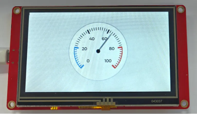

Example 3 Show dial plate on the screen¶
Upload the following code to the module, there will be a dial plate show on the screen.

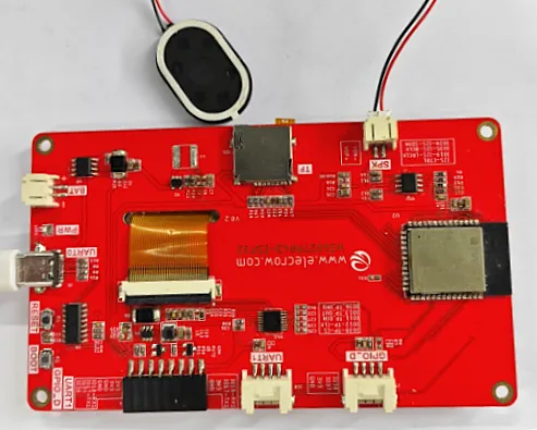

Connect a speaker to the ESP32 HMI. Upload the following code.
