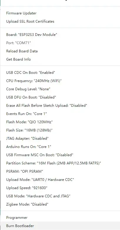

Get Started with Arduino IDE¶
The download settings are as follows:
Here are the configuration parameters:
Port: Select the serial port to which the ESP32 development board is connected. Usually, it is automatically detected.
USB CDC On Boot: Enable switch for USB virtual serial port (USB-Serial-JTAG mode) output. Select "Enabled" to enable the serial port function, or "Disabled" to disable it. If your development board does not have a USB-to-serial function, it is recommended to enable this feature.
Note: USB virtual serial port is only supported on Windows 10 and later.
CPU Frequency: CPU clock frequency. Options: 240MHz (WiFi), 160MHz (WiFi), 80MHz (WiFi), 40MHz, 20MHz, 10MHz. Generally, higher frequency consumes more power. Choose according to your needs. If power consumption is not a concern, select the maximum 240MHz for best performance. Note that 240MHz, 160MHz, and 80MHz ensure normal WiFi and BT operation; other frequencies may not guarantee WiFi/BT functionality, only basic CPU operations.
Core Debug Level: Arduino kernel debug log level, output via serial port. Options: None, Error, Warn, Info, Debug, Verbose.
- None: No debug logs output.
- Error: Only error-level logs.
- Warn: Only warning and above.
- Info: Only info and above.
- Debug: Only debug and above.
- Verbose: All kernel debug logs.
Generally, you don’t need to pay attention to kernel debug logs unless developing kernel-related features. So select "None".
USB DFU On Boot: Configure whether to upgrade device firmware via USB during boot. Select "Enabled" (requires "USB-OTG" mode) or "Disabled" to turn off.
Erase All Flash Before Sketch Upload: Configure whether to fully erase the entire Flash before uploading code. Options: Disabled, Enabled. Select "Disabled" to avoid full erasure (faster upload and longer Flash lifespan). Select "Enabled" for full erase (slower upload and reduces Flash lifespan). So choose "Disabled".
Event Runs On: Configure which ESP32 core runs Arduino interrupt events. Options: Core0, Core1. Choose according to your needs. Default is Core1.
This can be the same as or different from ArduinoRunsOn. Same core reduces power consumption; different cores improve program efficiency.
Flash Mode: Communication mode and frequency of the Flash mounted on the ESP32. Options: QIO 80MHz, QIO 120MHz, DIO 80MHz, OPI 80MHz.
- QIO: uses 4 SPI data lines for Flash write/read.
- DIO: uses 2 SPI data lines.
- OPI: uses 8 SPI data lines.
Choose based on actual Flash connection. Here we use 4 lines, so select "QIO".
Flash Size: Capacity of the Flash mounted on the ESP32. Options: 4MB (32Mb), 8MB (64Mb), 16MB (128Mb), 32MB (256Mb). Choose according to actual capacity. Here the Flash is 16MB, so select "16MB (32Mb)".
JTAG Adapter: Configure JTAG adapter. Options: Disabled, integrated USB JTAG, FTDI Adapter, ESP USB Bridge. Using JTAG makes debugging easier. Choose as needed. Default is "Disabled".
Arduino Runs On: Configure which ESP32 core runs Arduino Core task code. Options: Core0, Core1. ESP32 has two cores (Core0 and Core1), each can run different tasks. Choose as needed. Default is Core1.
USB Firmware SVC On Boot: Configure another USB firmware upgrade method. When enabled, a removable storage drive appears on your computer, and you can drag firmware directly to it for upgrade. Select "Enabled" (requires "USB-OTG" mode) or "Disabled".
Partition Scheme: Flash space partitioning method on the ESP32. Arduino IDE provides dozens of schemes. Here, with 16MB Flash, generally choose "16MB flash (2MB APP/12.5MB FATFS)". If your project has many files and the compiled binary is large, you can choose "16MB flash (3MB APP/9.9MB FATFS)".
PSRAM: Configure external PSRAM on the ESP32. Options: Disabled, QSPI PSRAM, OPI PSRAM. Some ESP32 boards have external PSRAM for memory expansion; select accordingly. If only internal SRAM is present, select "Disabled". Here the ESP32 has 8-line PSRAM, so choose "OPI PSRAM".
Upload Mode: Configure code upload interface. Options: UART0/Hardware CDC, USB-OTG CDC (TinyUSB).
- UART0/Hardware CDC: use onboard USB-to-serial or USB virtual serial port to upload code.
- USB-OTG CDC (TinyUSB): use software-emulated USB hardware interface to upload code.
Here we use USB virtual serial port, so select "UART0/Hardware CDC".
Upload Speed: Code upload speed. Options: 51200, 230400, 256000, 115200, 921600. Choose based on the maximum speed supported by the onboard USB-to-serial chip. For example, the CH340C used here supports up to 2Mbps, so select the maximum 921600.
USB Mode: Configure USB interface mode. Options: Hardware CDC and JTAG, USB-OTG (TinyUSB).
- Hardware CDC and JTAG: use USB virtual serial port and JTAG debugging.
- USB-OTG (TinyUSB): use software-emulated USB hardware interface. This mode only needs to be configured when using USB OTG mode.
Note: When using USB Mode, you must connect to the device’s built-in USB interface, not the onboard USB-to-serial port.
Zigbee Mode: Configure Zigbee operation mode. Options: Disabled, Zigbee ZCZR.
- Disabled: turn off Zigbee function.
- Zigbee ZCZR: enable Zigbee function.
Zigbee is not used here, so select "Disabled".
