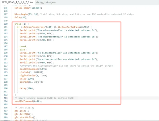

You are currently viewing the 7-inch product of CrowPanel Advance HMI, and the version here is V1.2.
In terms of hardware, we use a microcontroller (STC8H1K28) to control the screen backlight and the mute function of the speaker.
advance
(However, there are other function interfaces that need to be written in the specific code, and you can refer to the complete code provided later.)
Explanation:
Ø 0x30 is the I2C address of the microcontroller (STC8H1K28).
Ø 0x5D is the I2C address of the touch IC (GT911).
Ø sendI2CCommand(0x10) means sending the 0x10 command to the microcontroller (0x30) to instruct the microcontroller to set the screen brightness to maximum.
(For 0x10 mentioned above, you can replace it with the following values:
Ø 0x05: Turn off the screen
Ø 0x06 to 0x10: The screen brightness will gradually increase to the maximum)
Additional notes:
For the function interface sendI2CCommand(0x10), if 0x10 is replaced with the following values, the controlled functions will be different:
Ø sendI2CCommand(0x17): It means sending the 0x17 command to the microcontroller (0x30) to instruct the speaker to turn on.
Ø sendI2CCommand(0x18): It means sending the 0x18 command to the microcontroller (0x30) to instruct the speaker to turn off.
