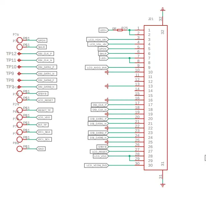

ESP32-P4 7 inch and IPS Display Wiring Pins:
**DSI = Display Serial Interface**is a high-speed, low-power display interface standard defined by the MIPI Alliance, most commonly used in smartphones, tablets, Raspberry Pi devices, and embedded Linux systems.
P4-7-sch-1
DSI Pin connection
DSI_DATAN0--IO40
DSI_DATAN0--IO39
DSI_DATAN0--IO36
DSI_DATAN0--IO35
DSI_CLKN--IO37
DSI_CLKP--IO38
DSI_REXT--IO34

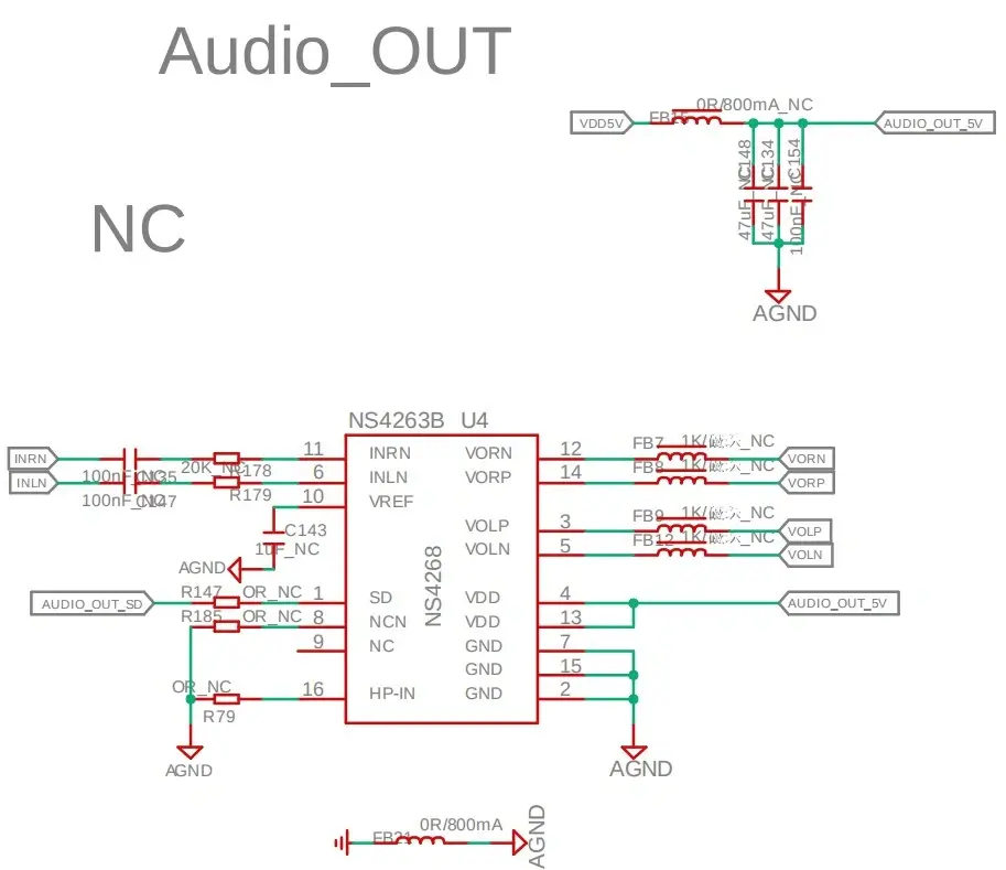

ESP32-P4 and Audio out:
P4-7-sch-4
Pin connection
#define AUDIO_GPIO_LRCLK    21   // GPIO pin number for LRCLK (Left-Right Clock)
#define AUDIO_GPIO_BCLK     22   // GPIO pin number for BCLK (Bit Clock)
#define AUDIO_GPIO_SDATA    23   // GPIO pin number for SDATA (Serial Data)
#define AUDIO_GPIO_CTRL     30   // GPIO pin number for audio amplifier control

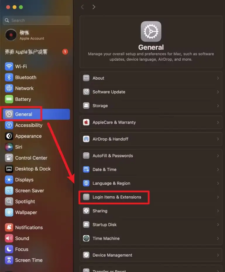

Regarding situations where serial ports remain inaccessible after installing drivers on a Mac, the following settings must be configured on the Mac:
  1. After installing the CH341 serial port driver, navigate to System Preferences.Click Login Items & Extensions.
mac-uart-1

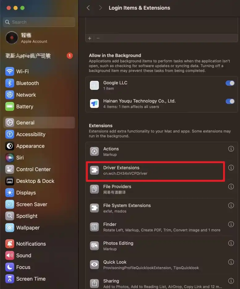

2.Click Driver Extensions.
mac-uart-2

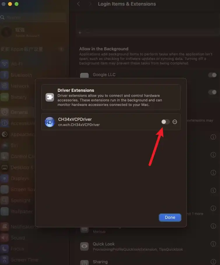

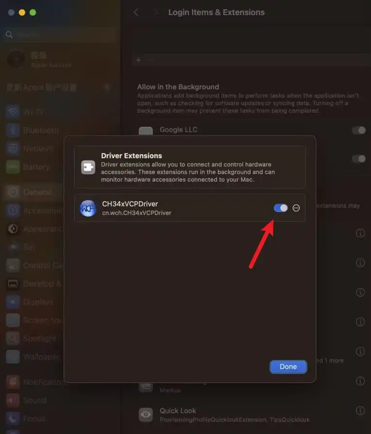

3.Click Open, then click Done to save the settings.
mac-uart-3
mac-uart-4
