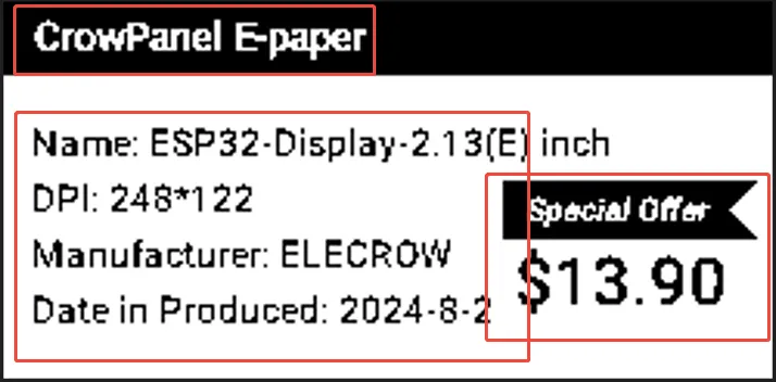

First, let's take a look at the price tag we design in this example, which is divided into three parts(all are images). The top bar is a fixed and unchanging background. On the left is the description, and on the right is the price. The parts we need to update are the description and price.
For the fixed top bar, we can convert it to C array and put them in the code.
For the variable description and price, we need to convert them to bin file and upload them to the board through WiFi.

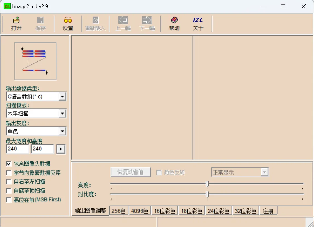

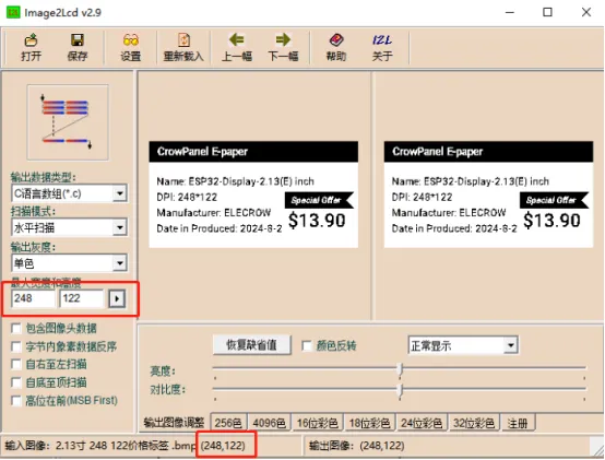

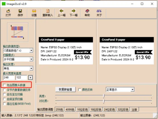

  2. download the image modulo tool Image2Lcd and open it.
    imagelcd

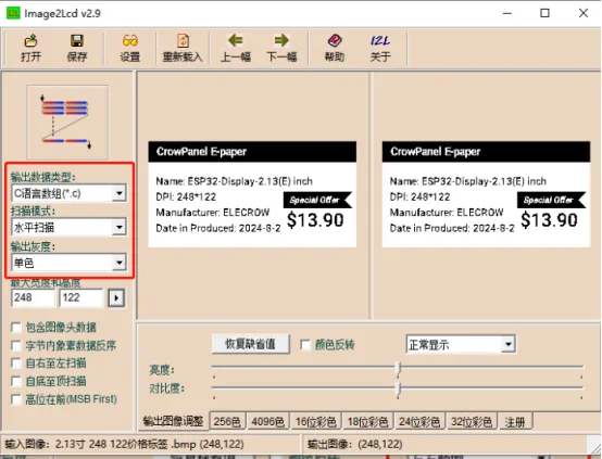

  3. Click open and select top-bar.bmp, convert it to array format.
    • Open file
    • Output date type: C language array by default
    • The biggest width and height: Consistent with the width and height of the image. Note that it must be a multiple of 8, otherwise it cannot be displayed properly
    • Select the output type as a C language array, set the scanning mode to horizontal scan, choose monochrome for the grayscale output, and flip the image horizontally.
    • Do not include the image header data.
    • Save and output

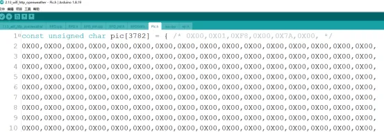

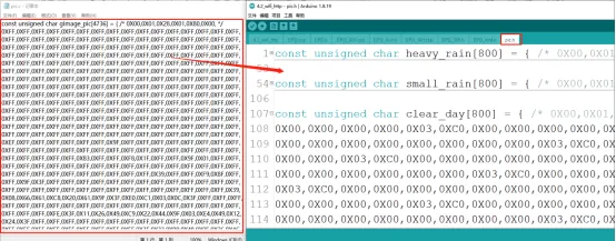

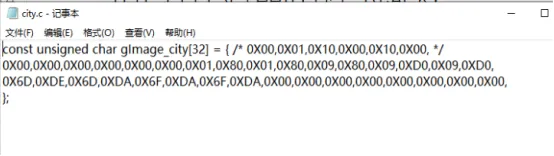

    Generate a ‘.txt’ text file, then copy the C array code into the project that needs to use it.
    image-20250331102727718
    Call the code in your project, and this will allow the image to be displayed on the screen.

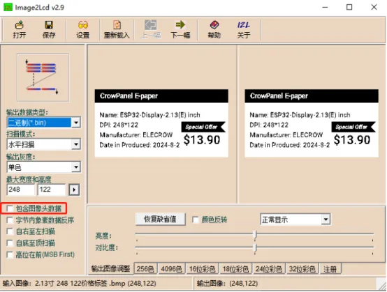

  4. Convert the description pictures and price tag pictures to bin files. These bin files will be used to update prices over WiFi.
    • Open the file
    • The output type select .bin file
    • The width and height should consistent with the width and height of the image. Note that it must be a multiple of 8, otherwise it cannot be displayed properly
    • Select the output type as a Bin file, set the scanning mode to horizontal scanning, and output grayscale as monochrome
    • Save the file

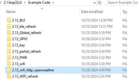

Please click download to download the code file 2.13_WIFI_refresh.zip for this demo.

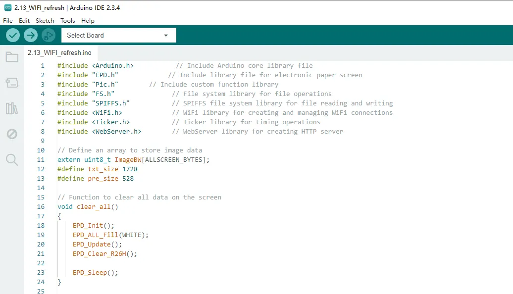

Add necessary libraries
#include <Arduino.h>           // Include Arduino core library file
#include "EPD.h"             // Include library file for electronic paper screen
#include "Pic.h"        // Include custom function library
#include "FS.h"               // File system library for file operations
#include "SPIFFS.h"           // SPIFFS file system library for file reading and writing
#include <WiFi.h>             // WiFi library for creating and managing WiFi connections
#include <Ticker.h>           // Ticker library for timing operations
#include <WebServer.h>        // WebServer library for creating HTTP server
Define the file variable fsUploadFile Used for accessing files, txt_size and pre_size correspond to the size of the BIN file(Exported in the above steps) for the text label and price label to be transmitted. The image resolution requirement is smaller than the screen resolution and both width and height are multiples of 8.
// Define an array to store image data
extern uint8_t ImageBW[ALLSCREEN_BYTES];
#define txt_size 1728
#define pre_size 528
Note: The size here can be defined based on the size of the images to be transmitted later, otherwise it will cause image transfer failure

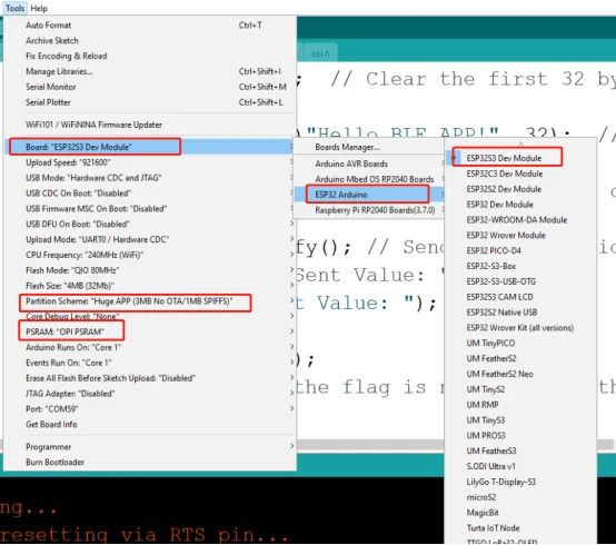

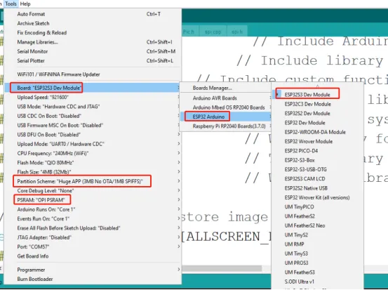

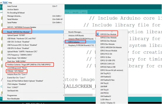

  2. Click "Tools"->"Board"->"esp32"->"ESP32S3 Dev Module", and the "Partition Scheme" select "Huge APP (3MB No OTA/1MB SPIFFS)", "PSRAM" select "OPI PSRAM".
    image-20250331104641279

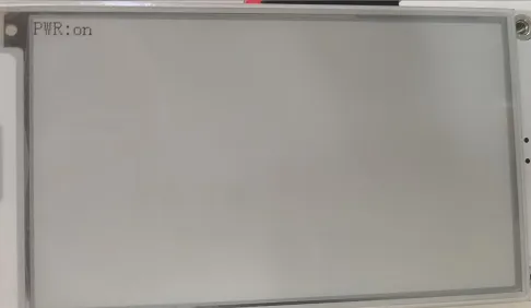

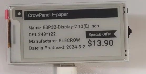

  4. Click "Upload" to upload the code to the board. There will be an image show on the screen.

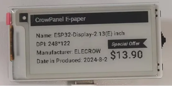

Update the price tag with WiFi

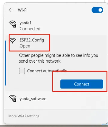

  1. Connect a laptop to the hotspot of the ESP32 E-PAPER display.
  2. Enter the IP address 192.168.4.1 in the browser.
  3. Select the bin file of the picture you need to show, then click submit.
    Note: The size of the images you transfer must be consistent with the size defined in the code, otherwise it will cause image transfer failure
    image-20250331104900873

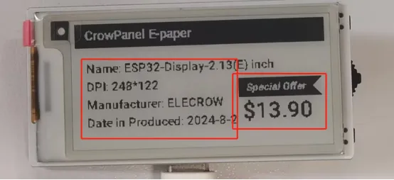

  4. After successful transmission, the price and text will be replaced, and the data will be saved in flash.
    image-20250331105121980

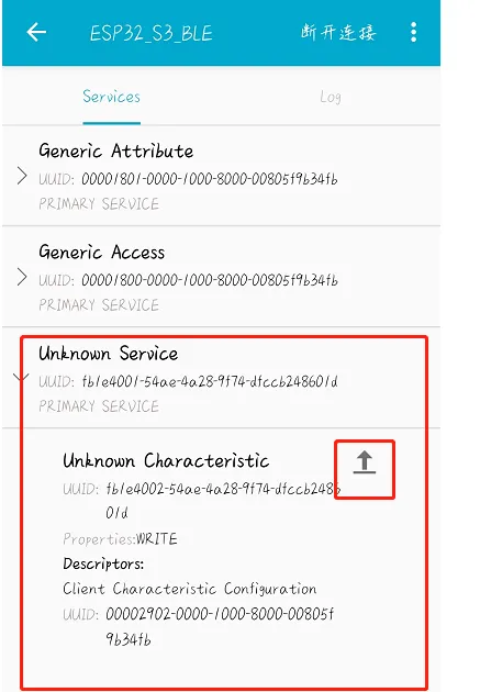

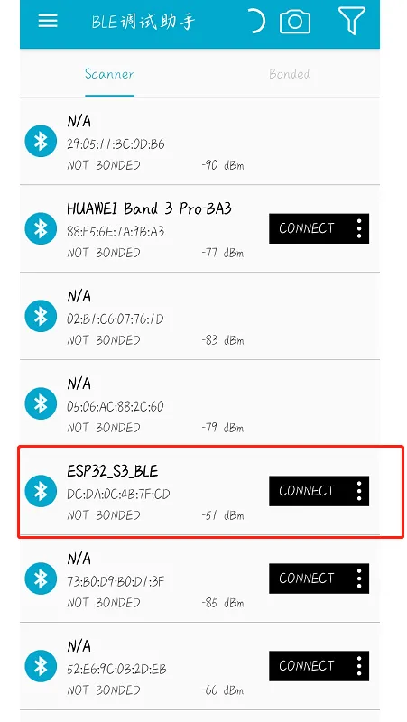

Update via Bluetooth
bt-flow
Convert the image format
The same as the method in the "Update via WiFi".
Code Explanation
Please click download to download the code file 2.13_ble_refresh.zip for this demo.

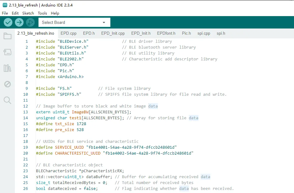

#include "BLEDevice.h"              // BLE driver library
#include "BLEServer.h"              // BLE bluetooth server library
#include "BLEUtils.h"               // BLE utility library
#include "BLE2902.h"                // Characteristic add descriptor library
#include "EPD.h"
#include "Pic.h"
#include "SPIFFS.h"       // SPIFFS file system library for file read and write.
File fsUploadFile;              // File object for uploading files
// Image buffer to store black and white image data
unsigned char test1[ALLSCREEN_BYTES]; // Array for storing file data

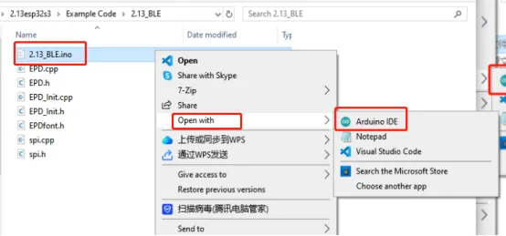

Upload the Code
  1. Double click the 2.13_ble_refresh.ino.
    img_17433907616390
    image-20250331111405492
  3. Connect CorwPanel to the computer, click on "Tool" and select the corresponding "port".
    image-20250331111420909

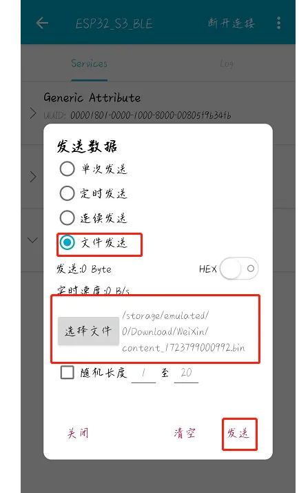

Update the images via bluetooth
  1. Download a BLE debugging assistant to your phone, and connect it your phone to the screen device BLE.
    image-20250331111511797
  2. Upload the bin file(Save the bin file to your phone in advance).
    image-20250331111526678
    image-20250331111553774
  3. After successful transmission, the price and text will be replaced, and the data will be saved in flash.

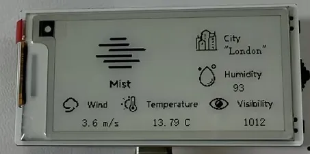

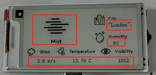

Demo 2 Weather Station
Obtain weather information through OpenWeather and display the information on the CrowPanel.
  1. Project Hardware Used
    ESP32-S3 5.79-inch E-Paper Display.
    image-20250331112241462

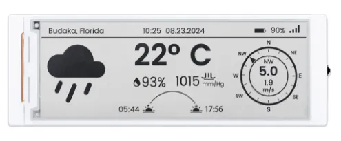

  2. UI Interface
    image-20250331112353044
  3. The UI is composed of 5 parts:
    • Weather information
    • City information
    • Wind speed information
    • Temperature information
    • Visibility information
    • Humidity information

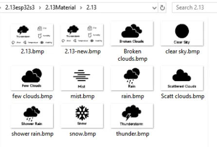

    • downloadthe icons.
    image-20250331112606147
    After converting the UI images into a C file, they can be used in the program for refreshing the display.
    image-20250331112734088
    image-20250331112741838
    The resulting array can be directly copied into the project for use.

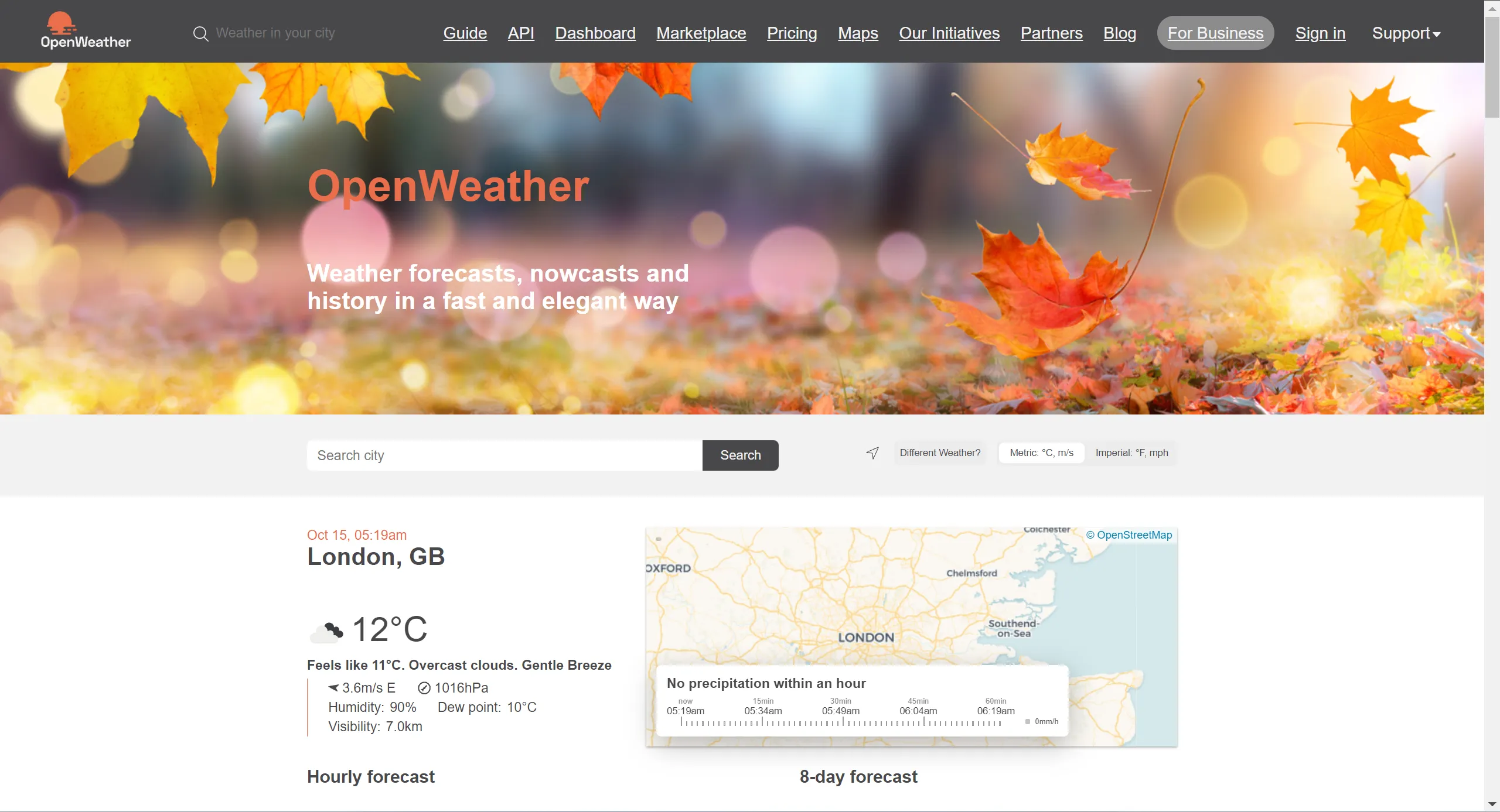

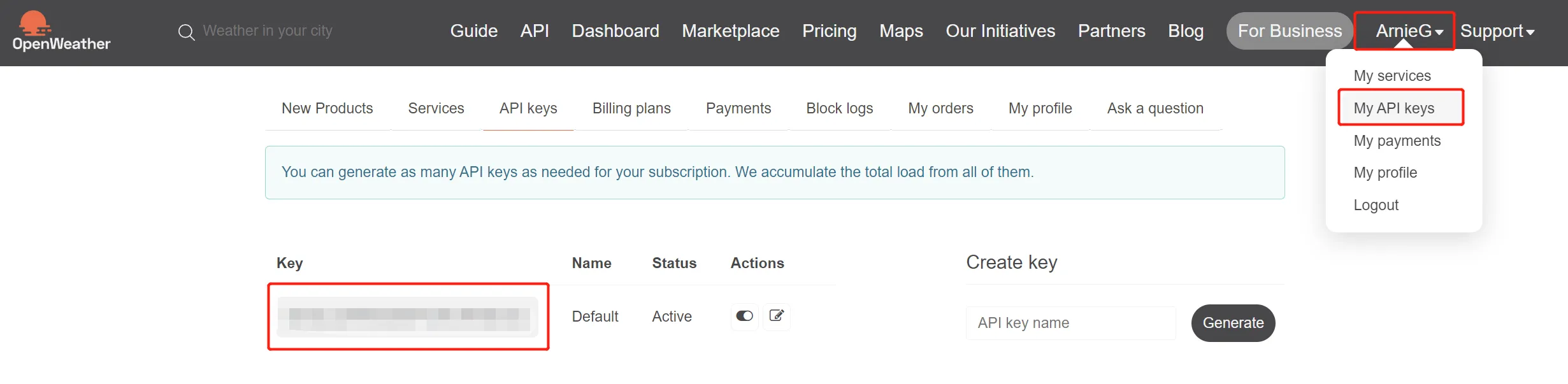

Register an OpenWeather account
  1. Enter https://openweathermap.org/ and click "Sing in" to register an OpenWeather account.
    openweather
  2. Log in your account.
  3. Click your user name -> "My API Keys" to find your API key.
    openweather-api

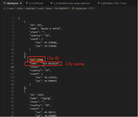

    You can find the city codes at the following link: http://bulk.openweathermap.org/sample/

Please click download to download the code file 2.13_wifi_http_openweather.zip for this demo.

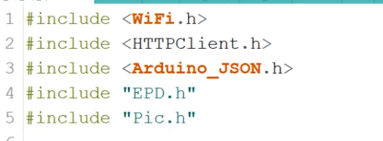

Add libraries
#include <WiFi.h>
#include <HTTPClient.h>
#include <Arduino_JSON.h>
#include "EPD.h"               // Include the EPD library for controlling the e-paper display
#include "pic.h"

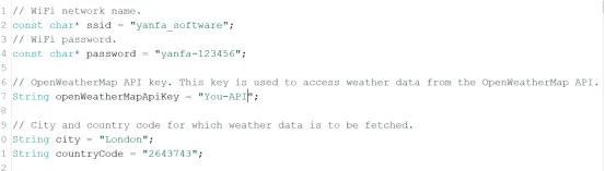

Modify your information
const char* ssid = " ";       // Enter your ssid
const char* password = " ";     // Enter your WiFi password
// OpenWeatherMap API key
String openWeatherMapApiKey = "You-API"; //Enter your API key
// For example: String openWeatherMapApiKey = "bd939aa3d23ff33d3c8f5dd1dd435";
// Replace with city and country code you're in
String city = "London";                    // City Name
String countryCode = "2643743";            // Country Code

Upload the Code
  1. Double click the 2.13_wifi_http_openweather.ino.
    image-20250331114907757

  5. After downloading, the weather information for the city you have selected will be displayed on CrowPanel.
    • Download the example
    image-20250331115406361
    • Obtain the weather of the day through WIFI and update the UI. The UI information will change based on the received data
    image-20250331115452019
    • Display Information Explanation
      1. City information
        image-20250331115619708
      2. Humidity information
        image-20250331115642760
      3. Visibility information
        image-20250331115656283
      4. Temperature information
        image-20250331115709274
      5. Wind information
        image-20250331115726714
      6. Weather information
        image-20250331115744317

Instructions: Open the Example
image-20250331115931558
image-20250331115942359
Select the Flash Configuration
image-20250331120002627
Perform Flashing
image-20250331120026251
Example 1 BLE Example Effect
  1. Select a BLE debugging app to search and connect.
    image-20250331120133011
  2. Display after a successful connection.

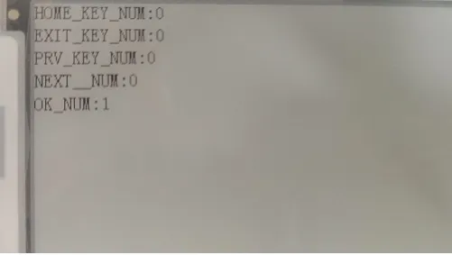

Example 2 Count the times of pressing the keys
The screen displays the number of button presses in real time.
image-20250331120408476

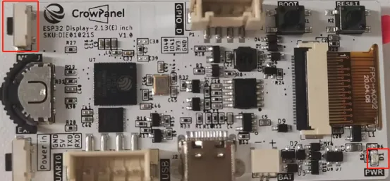

Example 3 Control PWR LED with menu Key
Press the menu button to control the power (pwr) light's on/off state, and display the status on the screen.
image-20250331120511182
image-20250331120517347

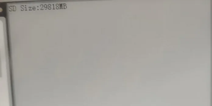

tf-size

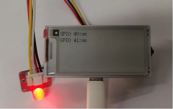

Example 7 GPIO
image-20250331121322885
