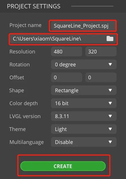

  1. Open the SquareLine Studio and create a project. Select "Elecrow"->"DLC35010R - ESP32 Terminal...-Arduino-IDE".
    SLS-UI-1
  2. Set the name of the project, you can select the folder to save the project. Click CREATE to create the project.

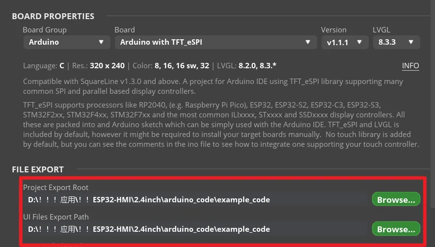

  9. Export UI files.
    SLS-UI-25
    SLS-UI-26
    Then click "APPLY CHANGES".
    SLS-UI-27
    SLS-UI-28
    SLS-UI-29

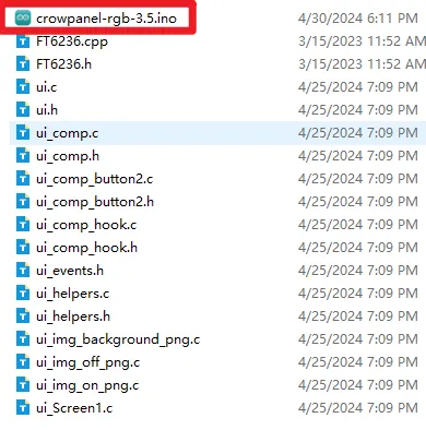

    Please click download to download the main program(and the expert UI is included).
    SLS-UI-30

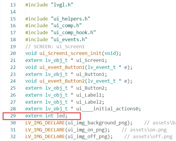

    First, define an extern variable in the ui.h file to store the status of the LED. In the main program, the LED light is controlled to turn on and off by judging the status of this variable.
    extern int led;

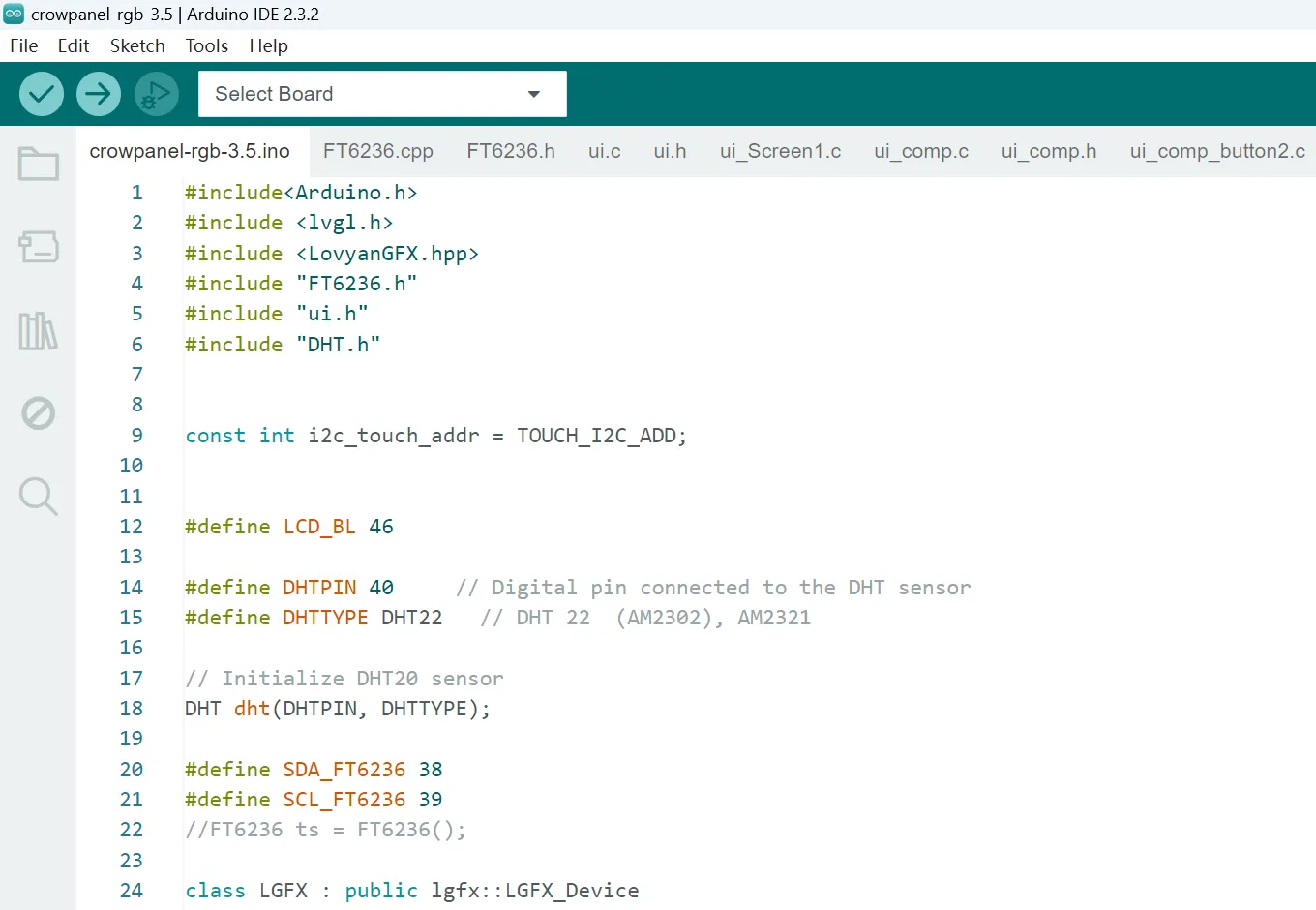

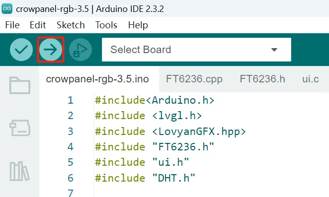

Install Libraries
#include<Arduino.h>
#include <lvgl.h>
#include <LovyanGFX.hpp>
#include "FT6236.h"
#include "ui.h"
#include "DHT.h"
  • #include <Arduino.h>: contains the Arduino core library, providing commonly used functions and data types.
  • #include <LovyanGFX.hpp> : A library for drawing graphics on embedded systems, providing rich graphics functions and APIs.
  • #include "FT6236.h": A library for the FT6236 touch chip to handle touch input.
  • #include "ui.h": is a custom header file that contain UI-related functions or definitions.
  • #include "DHT.h": to read data from the temperature and humidity sensor.
Please click download to download the libraries we modified.

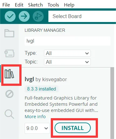

  • If you install the lvgl libraries by Library Manager, you need to copy the demos folder and examples folder and paste them to src folder. And modify the lv_conf_template.h file and rename it to lv_conf.h, and place it in libraries folder.(Please refer to the library provided)

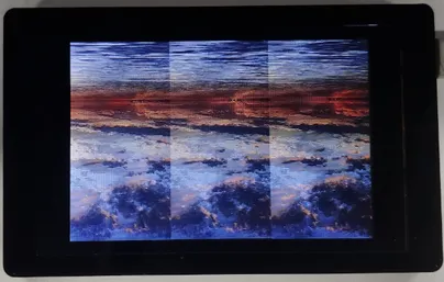

Example 2: Display the pictures from TF card
  • Insert the TF card in to card slot
  • Open and upload the F-photo.ino
  • The pictures will show on the screen

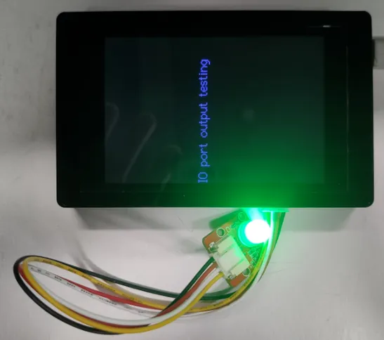

Example 3: LED Blinking
  • Plug the LED into the D port
  • Open and upload the D-D-PortOut.ino
  • The LED will blink alternately
led-blink

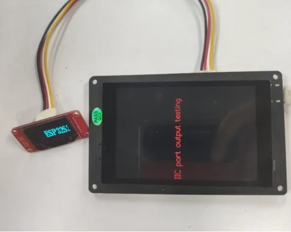

Example 4: I2C communication
  • Plug an OLED screen to the I2C port
  • Open and upload the E-IIC.ino
  • The OLED screen will display the content sent from the ESP terminal
oled-iic

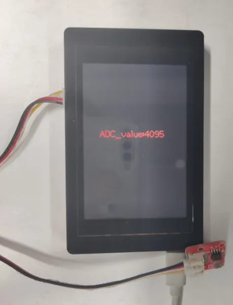

Example 5: Read the external ADC through the A port
  • Plug a sensor into the A port
  • Open and upload A-ADC.ino
  • The value of the sensor will show on the screen
adc
