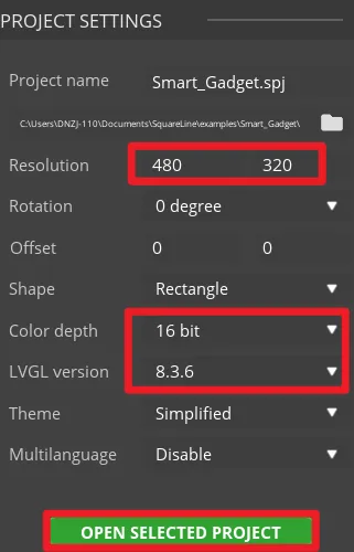

  2. Set the name of the project, set the screen resolution to 480*320, set the color depth to 16bit, and keep other default settings. After setting, click CREATE to create the project.

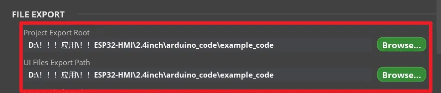

  9. Export UI files.
    SLS-UI-25
    SLS-UI-26
    Then click "APPLY CHANGES".
    SLS-UI-27
    SLS-UI-28
    SLS-UI-29

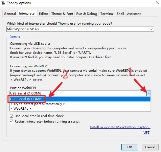

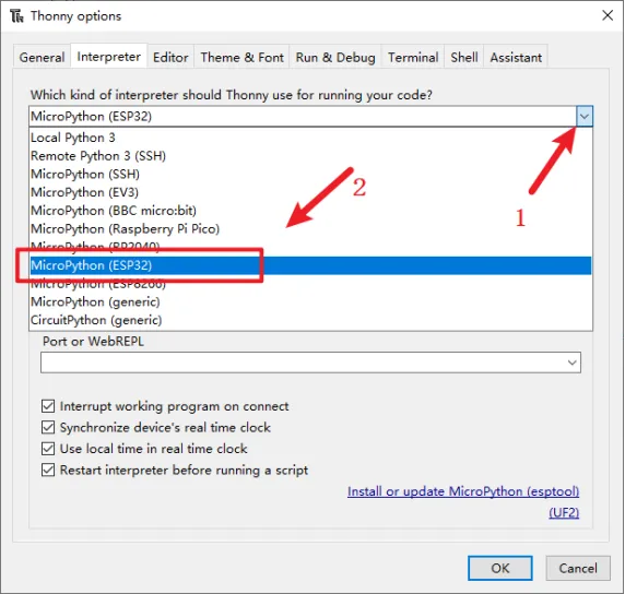

  2. Open Thonny IDE and click "Tools"->"Options"->"Interpreter".
  3. Select "MicroPython(ESP32)" for interpreter.
  4. Select the corresponding serial port(or Try to detect port automatically).

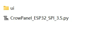

Please click download to download the code file and libraries.
code
code2

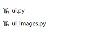

  • The main code is "CrowPanel_ESP32_SPI_3.5.py"
  • The "ui_image.py" is the libraries
  • The ui.by is exported from Squaline Studio and needs to be copied into the main program

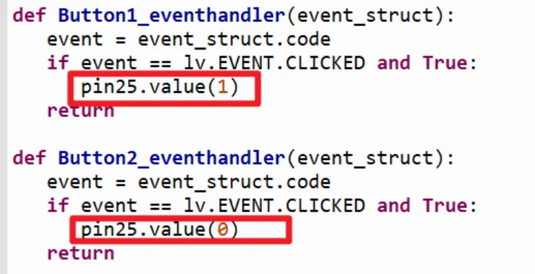

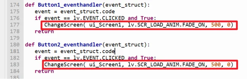

This part copies the code of ui.py generated by Squareline Studio. We need to modify the part that control the button.
From
button-1
to
button-2

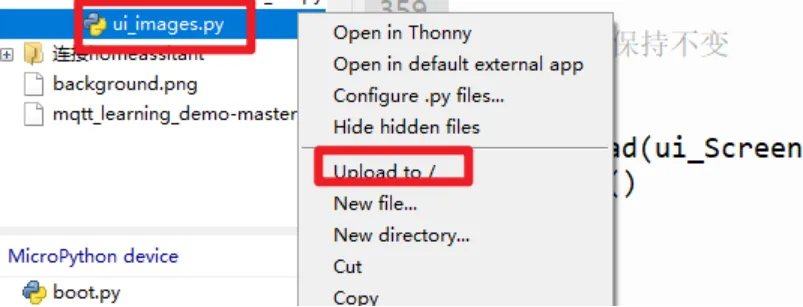

Upload the libraries
ui_image
  1. In the upper left corner of the thonny, enter the path where DHT20.py is located, right-click DHR20.py, and click Upload to/
  2. Waiting for uploading
  3. The ui_image.py will be added to the MicroPython device column.

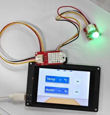

Click the "run" icon to run the main code.
Successfully uploaded.

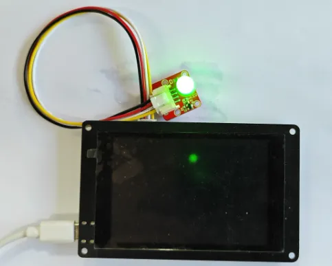

Example 1 LED Blinking
  • Plug the LED module to GPIO-D Port
  • Upload the led.py to board
  • The LED will blink
led-blink

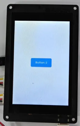

Example 2 Show the button on the screen
  • Upload the button-3.5.py to the board
button-onscreen

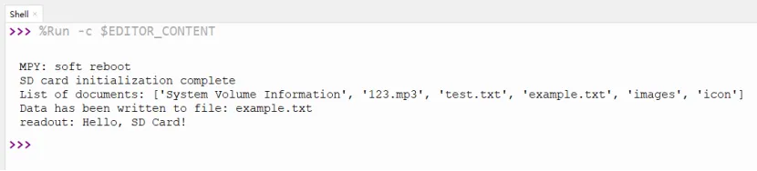

Example 4 Initialize SD card
  • Insert the SD card to the card slot
  • Upload the sd.py
SDCARD
