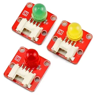

CrowPanel PICO 4.3'' HMI Crowtail-DHT20 Crowtail-LED USB-C Cable 4 Pin Crowtail Cable
4.3 DHT20 led cable 4pin cable

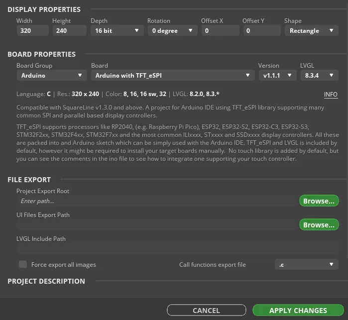

  1. Open the SquareLine Studio and create a project. Select "Arduino"->"Arduino with TFT_eSPI".
    SLS-UI-1
    Note:
    When select the Arduino framwork, there's only one optionĀ "Arduino with TFT_eSPI". By choosing this, the squareline studio will generate a template code suitable for the TFT_eSPI library. However, squareline studio not only supports the TFT_eSPI library, it supports a variety of libraries to suit different hardware and application needs. For example, Adafruit_GFX library, LovyanGFX etc.
  2. Set the name of the project, set the screen resolution to 320*240, set the color depth to 16bit, and keep other default settings. After setting, click CREATE to create the project.
    1.0

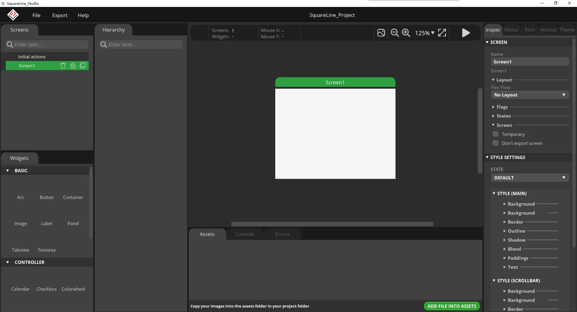

  3. After creation, enter the following interface with a blank background.
    blank

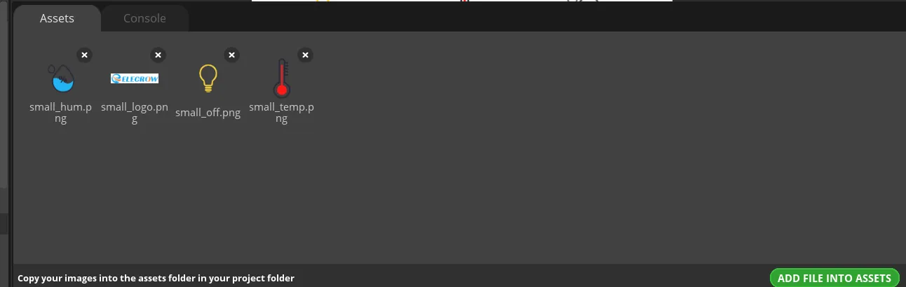

  4. In the "Assets" area, click "ADD FILE TO ASSETS" to add custom images or icons.
    material
    Note:

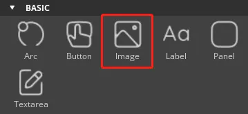

  5. Select "Image" to add icons.
    small_off
    Repeat the above steps to add other icons.

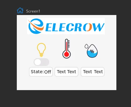

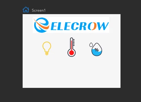

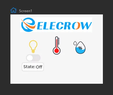

  6. Find "CONTROLLER" and click "switch" , place the switch under small_off.webp
    switch

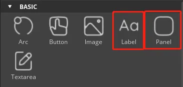

    Then find "BASIC" and click "Panel", and add two "Label" at the "Panel".
    BASIC
    Note the hierarchy.
    panel
  7. Selected the "Label", the contents of the label can be modified in the "Inspector". Modified as shown in the following picture.
    light
    Please add a "Panel" and two "Label" for the remaining two icons.
    all

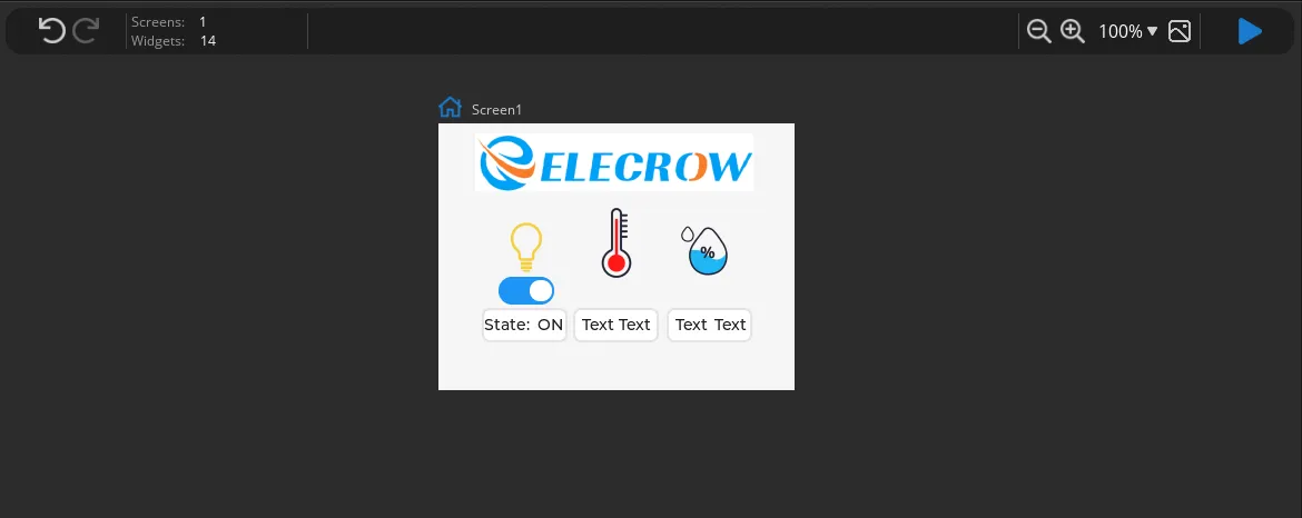

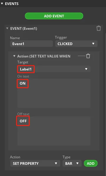

  8. Select the "Switch" we built earlier, and add an event to "Switch". "Inspector"→"EVENTS"→"ADD EVENT"
    event
    state

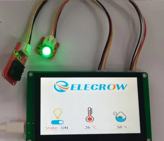

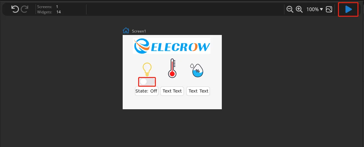

  9. Click the Play button in the upper right corner to check whether the event is added successfully.
    OFF
    ON

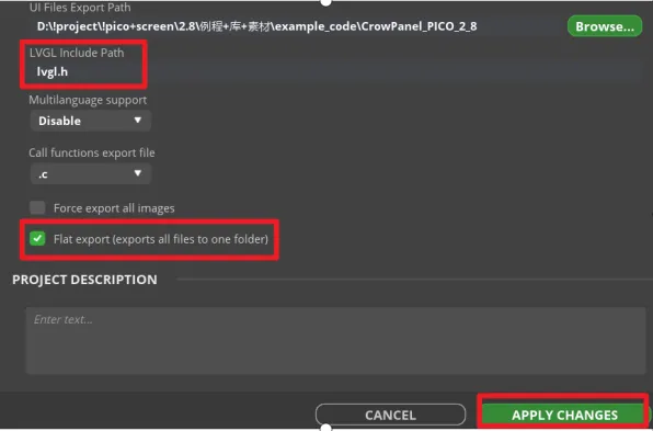

  10. Export UI files.
    SLS-UI-25
    project setting
    Then click "APPLY CHANGES".

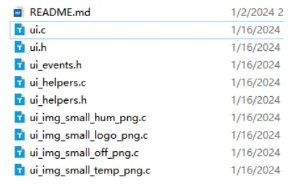

    The following picture is the output UI file
    Export UI
    Please clickdownloadto download the main program(and the expert UI is included).
    UI_Code

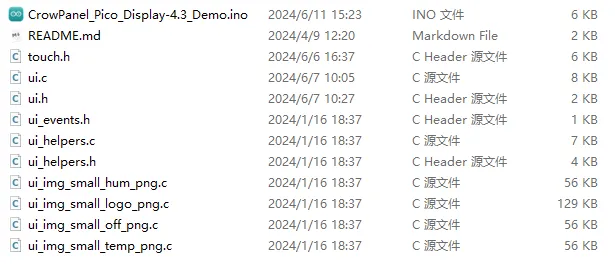

  11. Open the main program. And all the UI file in the same folder will open too.
    main

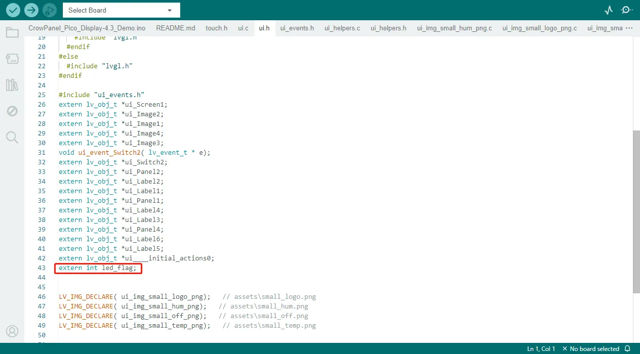

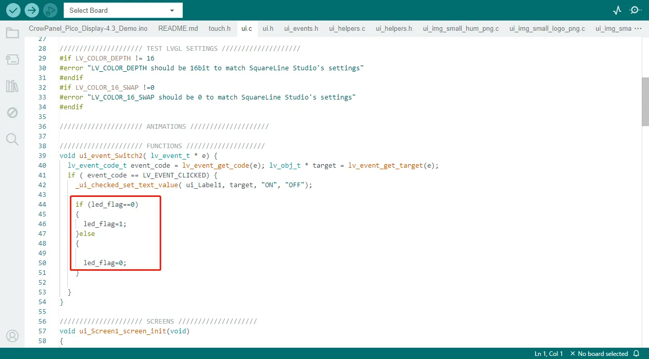

    First, define a variable in the ui.h file to store the status of the LED. In the main program, the LED light is controlled to turn on and off by judging the status of this variable.
    extern int led_flag;
    led_flag
    Then find "FUNCTION" in the ui. c file. Here is the corresponding code generated when we add events in SquareLine.
    function

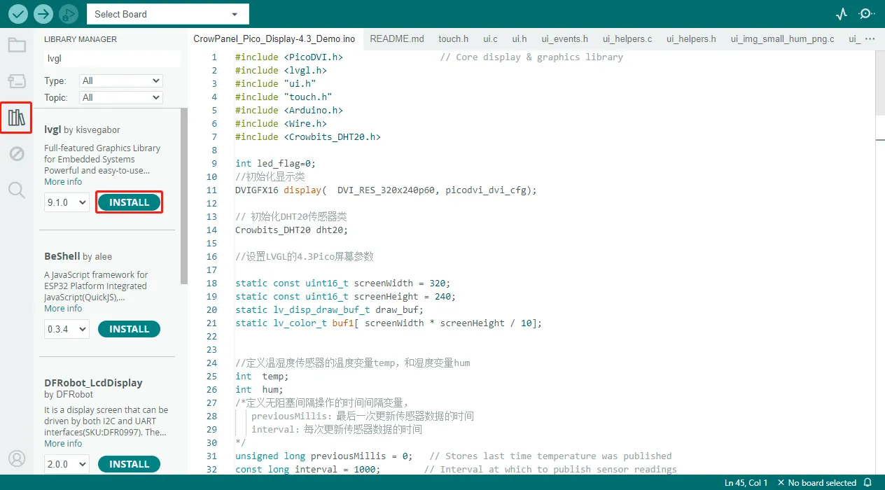

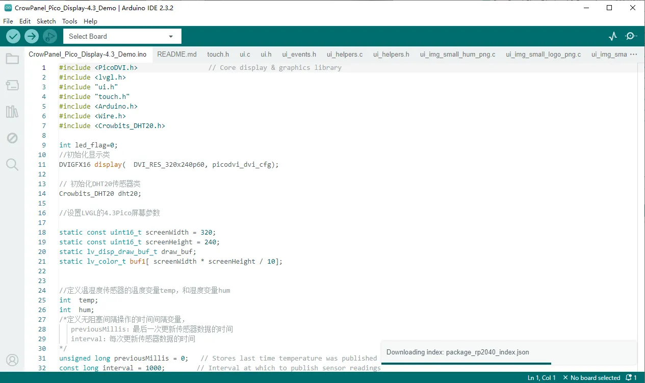

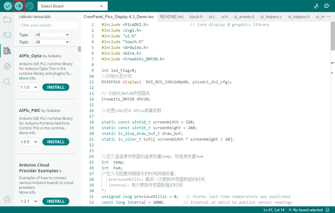

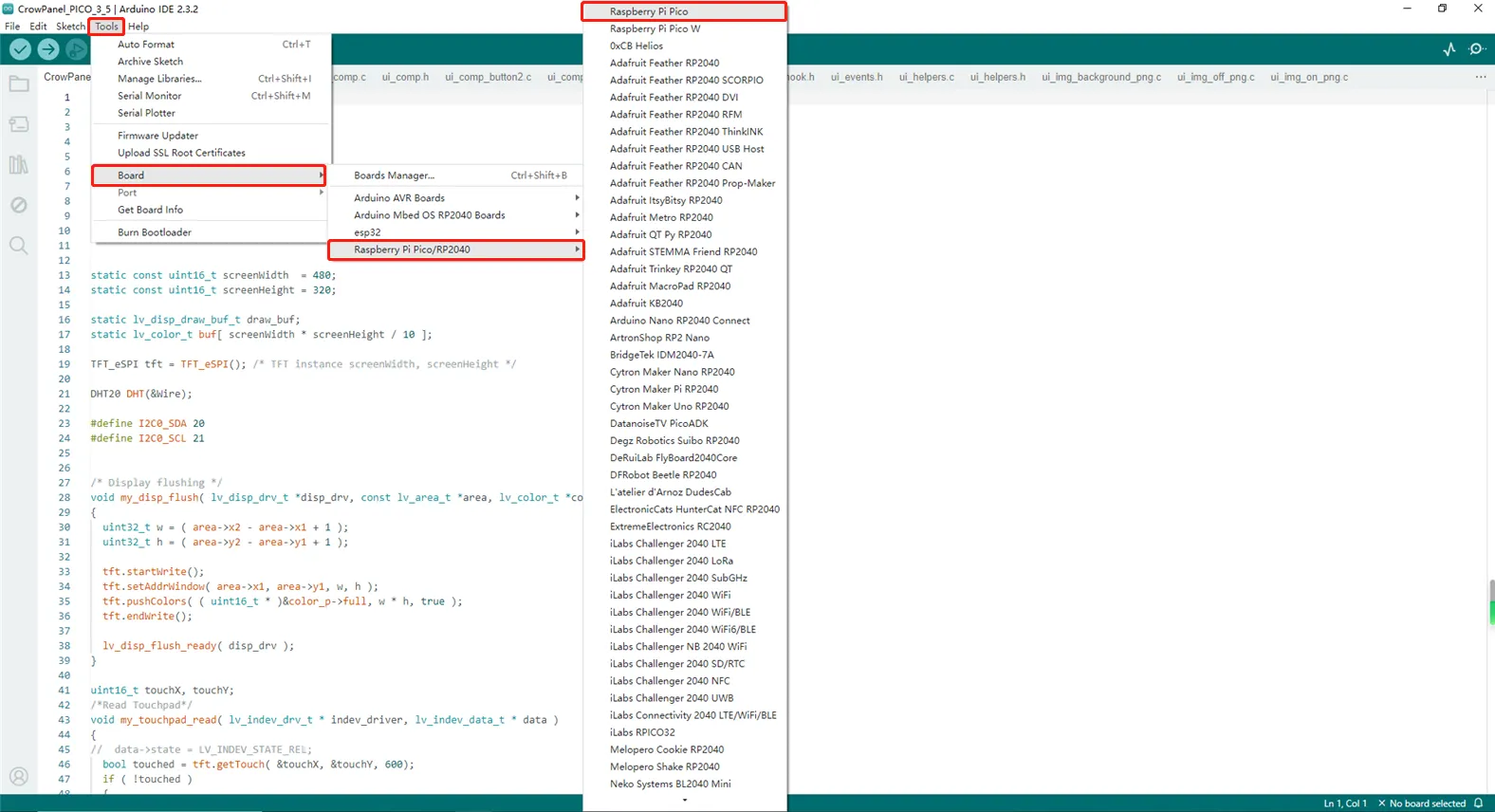

Build the Project with Arduino IDE
Get Started with Arduino IDE
Please click the card below to learn how to install Arduino IDE, and install RP2040 board in the Arduino IDE.
GetStartedWithArduinoIDE
Add Libraries
#include <PicoDVI.h>
#include <lvgl.h>
#include "ui.h"
#include "touch.h"
#include <Arduino.h>
#include <Wire.h>
#include <Crowbits_DHT20.h>
  • #include <Arduino.h>: contains the Arduino core library, providing commonly used functions and data types.
  • #include <lvgl.h> : is library for graphical interfaces, used for display control and drawing.
  • "ui.h": is a custom header file that contain UI-related functions or definitions.
  • #include <Wire.h>: here we use this library for I2C communication.
  • "DHT20.h": to read data from the DHT20 temperature and humidity sensor.
Please clickdownloadto download the libraries we modified.

  • If you install the lvgl libraries by Library Manager, you need to copy the demos folder and examples folder and paste them to src folder. And modify theĀ lv_conf_template.h file and rename it to lv_conf.h, and place it in libraries folder.(Please refer to the library provided)
SLS-UI-38
lvgl
SLS-UI-40

  delay(200);
void loop()
  //According to the button status to determine whether to light
    if (led_flag == 1)
      digitalWrite(ledPin, HIGH);
      lv_obj_add_state(ui_Switch2, LV_STATE_CHECKED);
    else
      digitalWrite(ledPin, LOW);
      lv_obj_clear_state(ui_Switch2, LV_STATE_CHECKED);
//The LVGL timer task function is called to update the status of the UI
  lv_timer_handler();
  delay(10);
      //Get touch sensor data without blocking, if the interval is too short it will cause the program to stall

Upload the Code

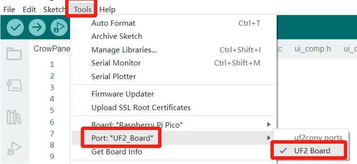

  1. After completing the installation of the RP2040 board according to "Get Started with Arduino IDE" and the installation of the library according to "Add Libraries", open the program and connect the PICO HMI 3.5-inch to the computer via a USB-C cable.
  2. Select Board: click "Tools" -> "Board" -> "Raspberry Pi Pico/RP2040" and select "Raspberry Pi Pico"
    9
  3. Select Port: Please hold the BOOT button and press the RESET button first, and the PICO HMI board will turn into a U disk. Then click "Tools" -> "Port" and select UF2...(Note: you need to press the button every time you need to connect the board with computerĀ  through serial communication.)
    35
  4. Upload the code
    upload
  5. After the program is successfully uploaded, connect the DHT20 sensor to the IIC port and the LED to GPIO_D.
Click the Switch. When the State is ON, the LED is on. When the State is OFF, the LED is off. Temperature and humidity values are monitored in real time.
