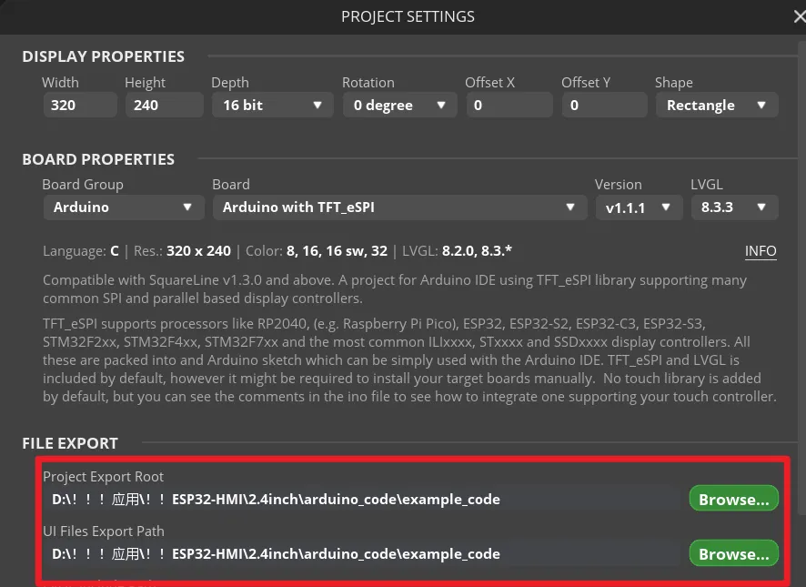

  1. Open the SquareLine Studio and create a project. Select "Arduino"->"Arduino with TFT_eSPI".
    SLS-UI-1
    Note:
    When select the Arduino framwork, there's only one option "Arduino with TFT_eSPI". By choosing this, the squareline studio will generate a template code suitable for the TFT_eSPI library. However, squareline studio not only supports the TFT_eSPI library, it supports a variety of libraries to suit different hardware and application needs. For example, Adafruit_GFX library, LovyanGFX etc.
  2. Set the name of the project, set the screen resolution to 320*240, set the color depth to 16bit, and keep other default settings. After setting, click CREATE to create the project.
    SLS-UI-2

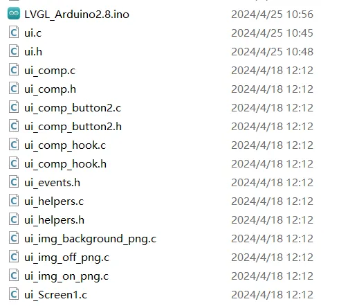

  9. Export UI files.
    SLS-UI-25
    SLS-UI-26
    Then click "APPLY CHANGES".
    SLS-UI-27
    SLS-UI-28
    SLS-UI-29
    Please click download to download the main program(and the expert UI is included).
    SLS-UI-30

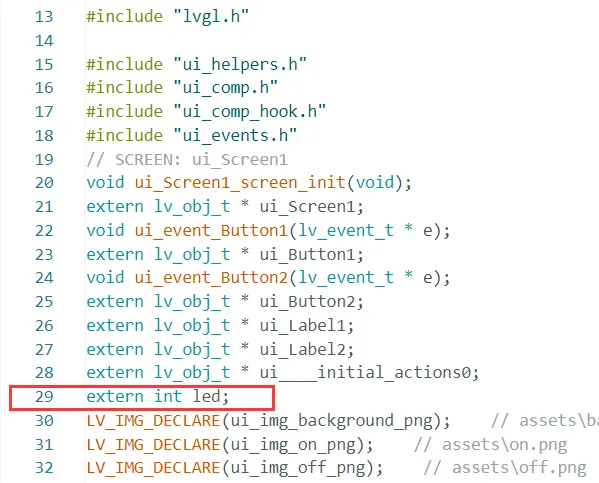

  10. Modify the button event code.
    SLS-UI-31
    First, define an extern variable in the ui.h file to store the status of the LED. In the main program, the LED light is controlled to turn on and off by judging the status of this variable.
    extern int led;
    SLS-UI-41
    SLS-UI-33
    • When button 1 (ON button) is pressed, set the LED value to 1.
    SLS-UI-34
    • When button 2 (OFF button) is pressed, set the LED value to 0.

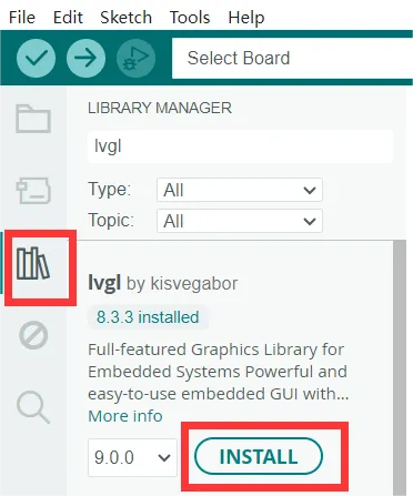

Install Libraries
#include <lvgl.h>
#include <TFT_eSPI.h> //screen driver library
#include <Arduino.h>
#include <Crowbits_DHT20.h> //Temperature and humidity sensor library
//UI
#include "ui.h"
  • #include <Arduino.h>: contains the Arduino core library, providing commonly used functions and data types.
  • #include <lvgl.h> and #include <TFT_eSPI.h>: are libraries for graphical interfaces, used for display control and drawing.
  • #include "ui.h": is a custom header file that contain UI-related functions or definitions.
  • #include <Crowbits_DHT20.h>: to read data from the DHT20 temperature and humidity sensor.
Please click download to download the libraries we modified.

  • If you install the lvgl libraries by Library Manager, you need to copy the demos folder and examples folder and paste them to src folder. And modify the lv_conf_template.h file and rename it to lv_conf.h, and place it in libraries folder.(Please refer to the library provided)
  • If you install the TFT_eSPI libraries by Library Manager, you need to modify User_Setup.h file accordding to the hardware specification.(Please refer to the library provided)

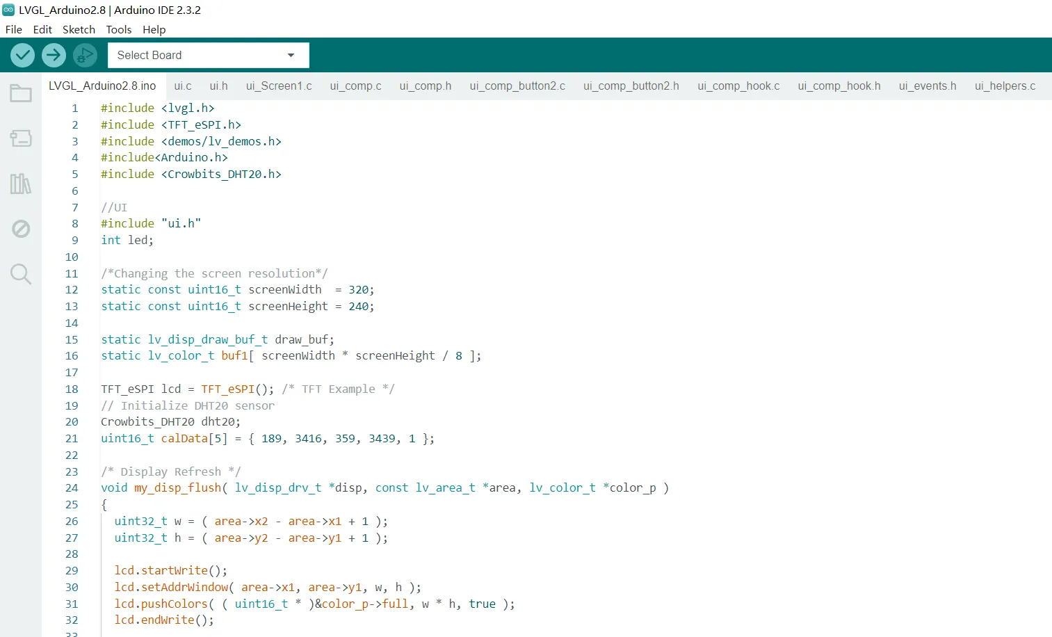

The Complete Code
#include <lvgl.h>
#include <demos/lv_demos.h>
#include<Arduino.h>
//UI
#include "ui.h"
int led;
/*Changing the screen resolution*/
static const uint16_t screenWidth  = 320;
static const uint16_t screenHeight = 240;
static lv_color_t buf1[ screenWidth * screenHeight / 8 ];
TFT_eSPI lcd = TFT_eSPI(); /* TFT Example */
// Initialize DHT20 sensor
Crowbits_DHT20 dht20;
uint16_t calData[5] = { 189, 3416, 359, 3439, 1 };
/* Display Refresh */
void my_disp_flush( lv_disp_drv_t *disp, const lv_area_t *area, lv_color_t *color_p )
  uint32_t w = ( area->x2 - area->x1 + 1 );
  uint32_t h = ( area->y2 - area->y1 + 1 );
  lcd.startWrite();
  lcd.setAddrWindow( area->x1, area->y1, w, h );
  lcd.pushColors( ( uint16_t * )&color_p->full, w * h, true );
  lcd.endWrite();
  lv_disp_flush_ready( disp );
uint16_t touchX, touchY;
/*Read Touchpad*/
  bool touched = lcd.getTouch( &touchX, &touchY, 600);
  if ( !touched )
  else
    /*Setting the coordinates*/
    data->point.x = touchX;
    data->point.y = touchY;
    Serial.print( "Data x " );
    Serial.println( touchX );
    Serial.print( "Data y " );
    Serial.println( touchY );
void setup()
  Serial.begin( 115200 ); /*Initializing the Serial Port*/
  Serial2.begin( 9600 ); /*Initialize Serial Port 2*/
  //IO Port Pins
  pinMode(25, OUTPUT);
  digitalWrite(25, HIGH);
  Wire.begin(22, 21);
  dht20.begin();
  lv_init();
  lcd.begin();
  lcd.fillScreen(TFT_BLACK);
  delay(300);
  lcd.setTouch( calData );
  //Backlight Pins
  pinMode(27, OUTPUT);
  digitalWrite(27, HIGH);
  lcd.setRotation(1);
  lv_disp_draw_buf_init( &draw_buf, buf1, NULL, screenWidth * screenHeight / 8 );
  /*Initializing the display*/
  lv_disp_drv_init( &disp_drv );
  /*Change the following line to display resolution*/
  lv_disp_drv_register( &disp_drv );
  /*Initialize the (virtual) input device driver*/
  lv_indev_drv_init( &indev_drv );
  lv_indev_drv_register( &indev_drv );
  ui_init();
void loop()
  Serial.print(led);
  char DHT_buffer[6];
  int a = (int)dht20.getTemperature();
  int b = (int)dht20.getHumidity();
  if(led == 1)
  if(led == 0)
  digitalWrite(25, LOW);
  delay( 10 );

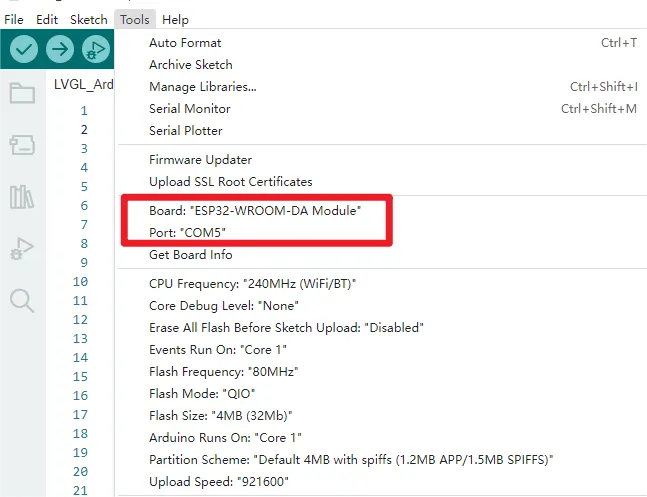

  1. After completing the installation of the ESP32 board according to "Get Started with Arduino IDE" and the installation of the library according to "Install Libraries", open the program and connect the ESP32 HMI 2.8-inch to the computer via a USB-C cable.
  2. Select Board: click "Tools" -> "Board" -> "esp32" and select "ESP32-WROOM-DA Module"(select ESP32 Dev Module also be good)
    select-board

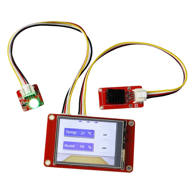

  5. After the program is successfully uploaded, connect the DHT20 sensor to the IIC port and the LED to GPIO_D (IO25), the temperature and humidity values will be displayed on the screen. Click the ON button on the screen and the LED will turn on. Click the OFF button and the LED will turn off.

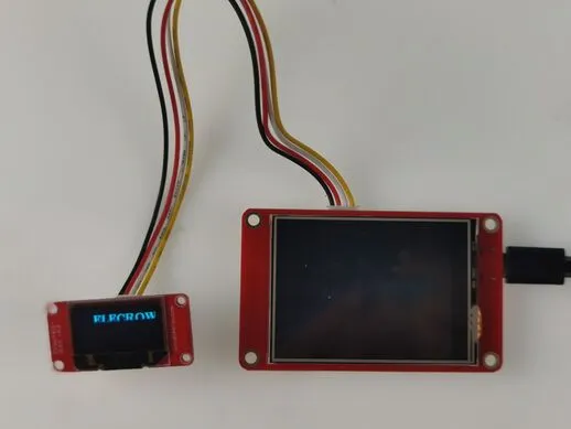

Example2: Control an external OLED screen through I2C.
Connect the OLED screen to IIC port.
Install the U8g2 library(Copy the U8g2 folder in the libraries downloaded above to the .../arduino/libraries directory). Then upload the following code to the board.
#include <U8g2lib.h>
#include <Wire.h>
#define I2C_SDA 22
#define I2C_SCL 21
U8G2_SSD1306_128X64_NONAME_F_SW_I2C u8g2(U8G2_R0, /*clock=*/I2C_SCL, /*data=*/I2C_SDA, /*reset=*/U8X8_PIN_NONE);
void setup() {
  Serial.begin(115200);
  //OLED
  u8g2.begin();
  u8g2.enableUTF8Print();        // enable UTF8 support for the Arduino print() function
  u8g2.setFont(u8g2_font_ncenB14_tr);
  u8g2.setFontDirection(0);
  for (int i = 128; i > -78; i -= 20)
    u8g2.firstPage();
    do {
      u8g2.drawStr(i, 25, "ELECROW");
      delay(2);
    } while ( u8g2.nextPage() );
void loop() {
oled-elecrow

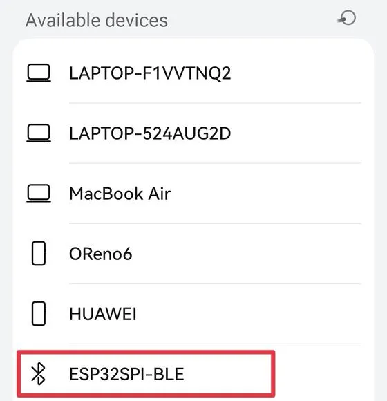

Example6: Initialize the interact communication of Bluetooth
Please check if you have installed the library BLE(Copy the BLE folder in the libraries downloaded above to the .../arduino/libraries directory). Upload the following code to the board, and use the phone to search the Bluetooth device.
#include "BLEDevice.h"              //BLE drive library
#include "BLEServer.h"              //BLE server library
#include "BLEUtils.h"               //BLE Utility library
#include "BLE2902.h"                //Feature Add Descriptor Library
#include <BLECharacteristic.h>      //BLE Feature function library
BLEAdvertising* pAdvertising = NULL;
BLEServer* pServer = NULL;
BLEService *pService = NULL;
BLECharacteristic* pCharacteristic = NULL;
#define bleServerName "ESP32SPI-BLE"  //BLE Server name
#define SERVICE_UUID "6479571c-2e6d-4b34-abe9-c35116712345"  //Server UUID
#define CHARACTERISTIC_UUID "826f072d-f87c-4ae6-a416-6ffdcaa02d73"
bool connected_state = false;   //Create device connection identifier
class MyServerCallbacks: public BLEServerCallbacks  //Create connection and disconnection calling classes
    void onConnect(BLEServer *pServer)//Start connecting function
      connected_state = true;   //Device is connected correctly
    void onDisconnect(BLEServer *pServer)//disconnect function
      connected_state = false;  //Device connection error
void setup() {
  //BLE
  BLEDevice::init(bleServerName);  //Create BLE and set name
  pServer = BLEDevice::createServer();  //Create BLE server
  pServer->setCallbacks(new MyServerCallbacks());  //Set up connection and disconnection calling classes
  pService = pServer->createService(SERVICE_UUID); //Create BLE service
  pCharacteristic = pService->createCharacteristic(  //Create ble feature(Characterristic_UUID)
                      CHARACTERISTIC_UUID,
                      BLECharacteristic::PROPERTY_READ | BLECharacteristic::PROPERTY_WRITE | BLECharacteristic::PROPERTY_NOTIFY);
  pCharacteristic->setValue("ELECROW");
  //start broadcast
  pAdvertising = BLEDevice::getAdvertising();  //A bleadvertising class pointer padvertising is defined, which points to bledevice:: getadvertising()
  pAdvertising->addServiceUUID(SERVICE_UUID);
  pAdvertising->start();  //Start broadcasting
  pService->start();
  //  pAdvertising->stop();  //Stop broadcasting
  //  pService->stop();      //Stop service
void loop() {
BLE

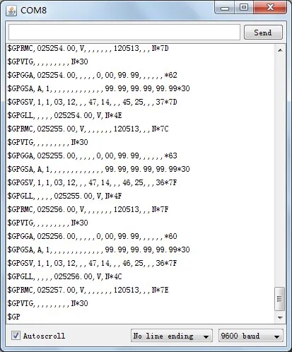

Example8: Connect Crowtail-GPS module via UART to Get Location
//at 9600 bps 8-N-1
#include <SoftwareSerial.h>
SoftwareSerial SoftSerial(6, 7);
unsigned char buffer[256]; // buffer array for data recieve over serial port
int count=0;     // counter for buffer array
void setup()
  SoftSerial.begin(9600);               // the SoftSerial baud rate
  Serial.begin(9600);             // the Serial port of Arduino baud rate.
void loop()
  if (SoftSerial.available())              // if date is comming from softwareserial port ==> data is comming from SoftSerial shield
    while(SoftSerial.available())          // reading data into char array
      buffer[count++]=SoftSerial.read();     // writing data into array
      if(count == 256)break;
    Serial.write(buffer,count);            // if no data transmission ends, write buffer to hardware serial port
    clearBufferArray();              // call clearBufferArray function to clear the storaged data from the array
    count = 0;                       // set counter of while loop to zero
  if (Serial.available())            // if data is available on hardwareserial port ==> data is comming from PC or notebook
    SoftSerial.write(Serial.read());       // write it to the SoftSerial shield
void clearBufferArray()              // function to clear buffer array
  for (int i=0; i<count;i++)
    { buffer[i]=NULL;}                  // clear all index of array with command NULL
GPS
