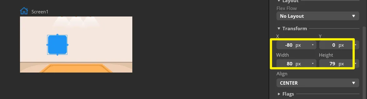

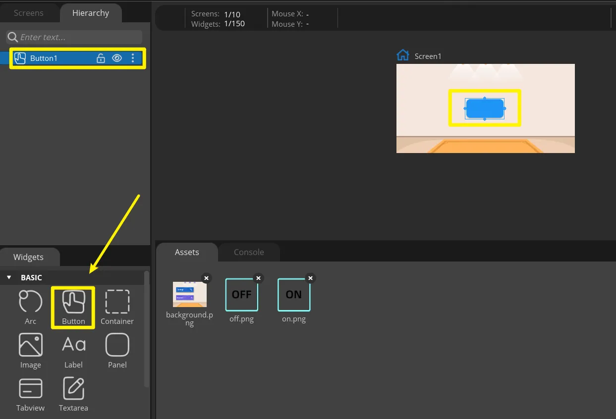

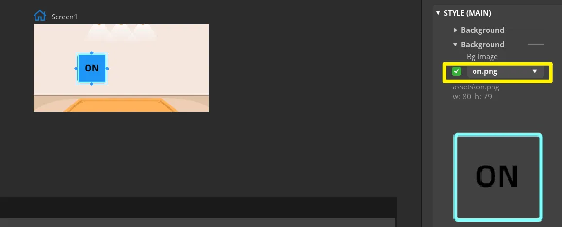

Open the SquareLine Studio and create a project.
A. In the latest version of SLS, select "Elecrow"->"DIS06043H...Arduino-IDE"
B. In the earlier version of SLS, select "Arduino"->"Arduino with TFT_eSPI".
Note:

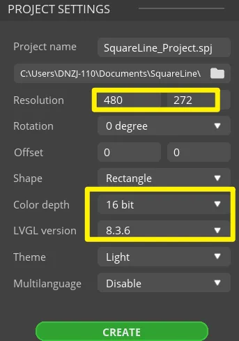

Set the name of the project, set the screen resolution to 480*272, set the color depth to 16bit, and keep other default settings. After setting, click CREATE to create the project.
Please click
to download the custom images used in this tutorial.
Note:
Images only support webp format. The pixels of the image need to be smaller than the pixel size of the screen used in your project. The size of each image should not exceed 100k, preferably within 30k, to provide a smooth display effect.

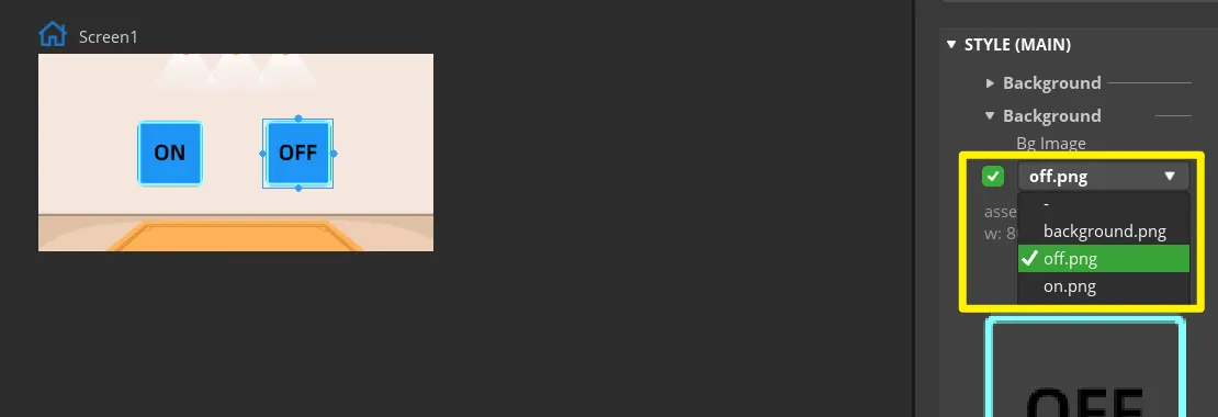

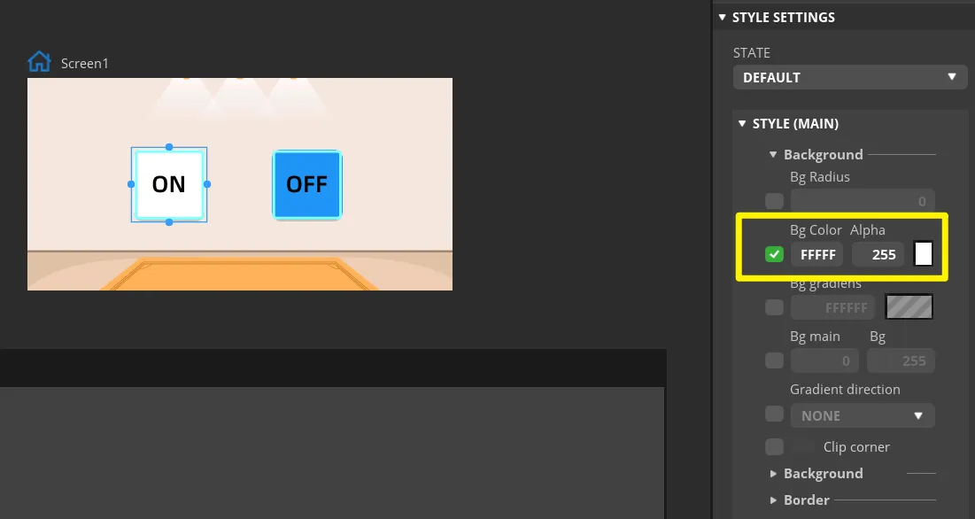

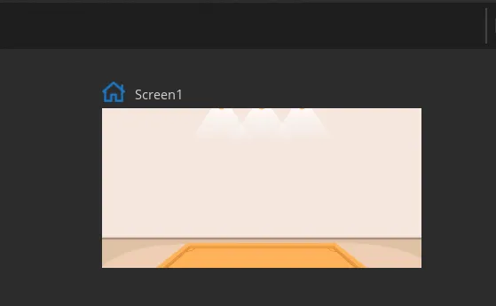

Add background.

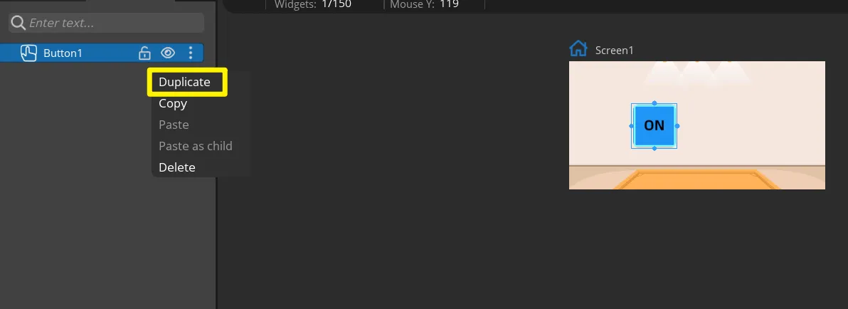

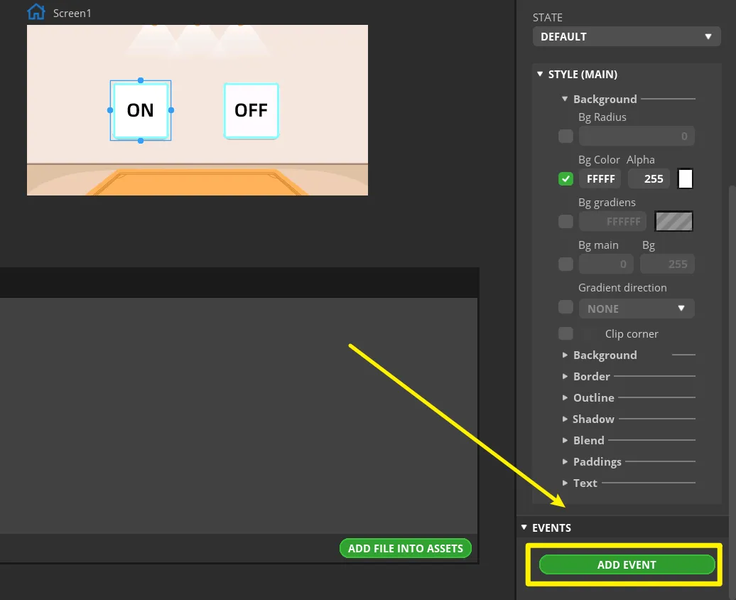

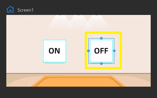

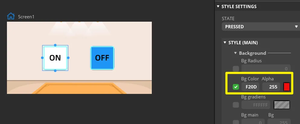

Add events to buttons.

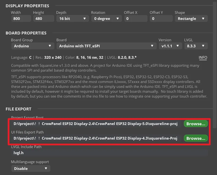

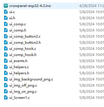

Export UI files.
Then click "APPLY CHANGES".
Please click
to download the main program(and the expert UI is included).
Modify the button event code.
First, define an extern variable in the ui.h file to store the status of the LED. In the main program, the LED light is controlled to turn on and off by judging the status of this variable.

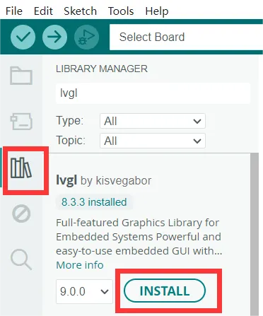

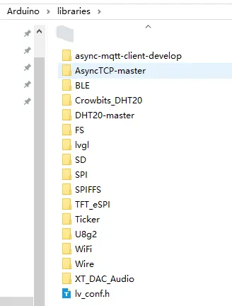

Install Libraries¶

Please click to download the libraries we modified.
Tips:
- If you install the lvgl libraries by Library Manager, you need to copy the demos folder and examples folder and paste them to src folder. And modify the lv_conf_template.h file and rename it to lv_conf.h, and place it in libraries folder.(Please refer to the library provided)

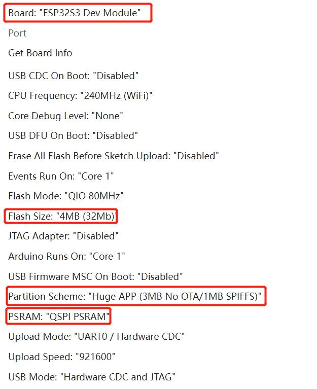

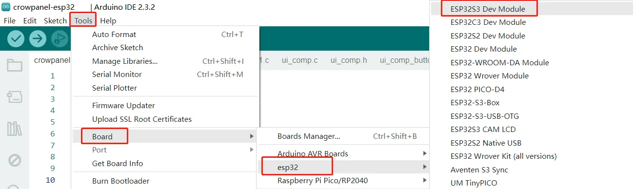

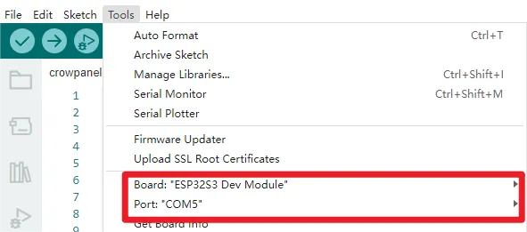

After completing the installation of the ESP32 board according to "Get Started with Arduino IDE" and the installation of the library according to "Install Libraries", open the program and connect the ESP32 HMI 4.3-inch to the computer via a USB-C cable.
Select Board: click "Tools" -> "Board" -> "esp32" and select "ESP32S3 Dev Module"
Board Setting: Under the "Tools" menu, see "Flash Size" select 4MB(32Mb); "Partition scheme" and select "Huge APP(3MB No OTA/1MB SPIFFS)"; "PSRAM" select "QSPI PSRAM"
Select Port
Upload the code: click the "Upload" icon to upload the code.

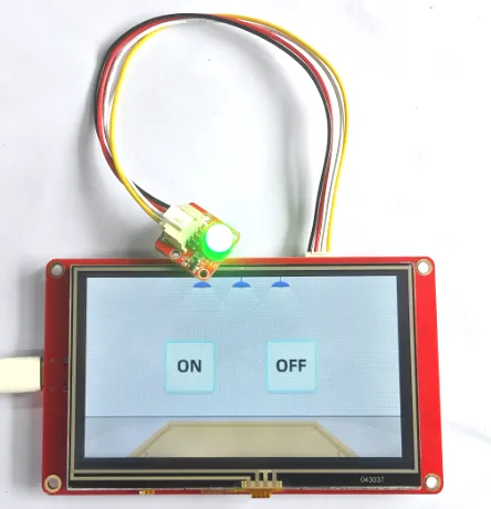

After the program is successfully uploaded, connect the LED to GPIO_D. Click the ON button on the screen and the LED will turn on. Click the OFF button and the LED will turn off.

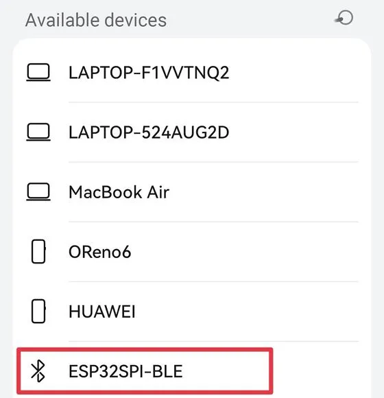

Example5: Initialize the interact communication of Bluetooth¶
Please check if you have installed the library BLE(Copy the BLE folder in the libraries downloaded above to the .../arduino/libraries directory). Upload the following code to the board, and use the phone to search the Bluetooth device.
#include "BLEDevice.h" //BLE drive library
#include "BLEServer.h" //BLE server library
#include "BLEUtils.h" //BLE Utility library
#include "BLE2902.h" //Feature Add Descriptor Library
#include <BLECharacteristic.h> //BLE Feature function library
BLEAdvertising* pAdvertising = NULL;
BLEServer* pServer = NULL;
BLEService *pService = NULL;
BLECharacteristic* pCharacteristic = NULL;
#define bleServerName "ESP32SPI-BLE" //BLE Server name
#define SERVICE_UUID "6479571c-2e6d-4b34-abe9-c35116712345" //Server UUID
#define CHARACTERISTIC_UUID "826f072d-f87c-4ae6-a416-6ffdcaa02d73"
bool connected_state = false; //Create device connection identifier
class MyServerCallbacks: public BLEServerCallbacks //Create connection and disconnection calling classes
void onConnect(BLEServer *pServer)//Start connecting function
connected_state = true; //Device is connected correctly
void onDisconnect(BLEServer *pServer)//disconnect function
connected_state = false; //Device connection error
void setup() {
Serial.begin(115200);
//BLE
BLEDevice::init(bleServerName); //Create BLE and set name
pServer = BLEDevice::createServer(); //Create BLE server
pServer->setCallbacks(new MyServerCallbacks()); //Set up connection and disconnection calling classes
pService = pServer->createService(SERVICE_UUID); //Create BLE service
pCharacteristic = pService->createCharacteristic( //Create ble feature(Characterristic_UUID)
CHARACTERISTIC_UUID,
BLECharacteristic::PROPERTY_READ | BLECharacteristic::PROPERTY_WRITE | BLECharacteristic::PROPERTY_NOTIFY);
pCharacteristic->setValue("ELECROW");
//start broadcast
pAdvertising = BLEDevice::getAdvertising(); //A bleadvertising class pointer padvertising is defined, which points to bledevice:: getadvertising()
pAdvertising->addServiceUUID(SERVICE_UUID);
pAdvertising->start(); //Start broadcasting
pService->start();
// pAdvertising->stop(); //Stop broadcasting
// pService->stop(); //Stop service
void loop() {
Example6: Initialize the WIFI¶
Please check if you have installed the library WiFi(Copy the WiFi folder in the libraries downloaded above to the .../arduino/libraries directory). Upload the following code to the board.
#include <WiFi.h>

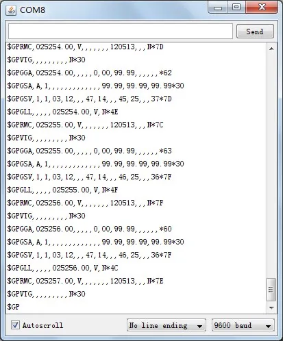

Example7: Connect Crowtail-GPS module via UART to Get Location¶
Connect the Crowtail-GPS to the UART port.
#define SERIAL_BAUD 9600
HardwareSerial cardSerial(1);//Declare the UART1
unsigned char buffer[256]; // buffer array for data recieve over serial port
int count_1 = 0; // counter for buffer array
void clearBufferArray() // function to clear buffer array
for (int i = 0; i < count_1; i++)
buffer[i] = 0; // clear all index of array with command NULL
void setup() {
Serial.begin( 9600 ); /*Initialize the serial port*/
cardSerial.begin(SERIAL_BAUD, SERIAL_8N1, 18, 17);//4.3 /*初Initialize the serial port1*/18-RX\17-TX
void loop() {
if (cardSerial.available()) // if date is comming from softwareserial port ==> data is comming from SoftSerial shield
while (cardSerial.available()) // reading data into char array
buffer[count_1++] = cardSerial.read(); // writing data into array
if (count_1 == 256)break;
Serial.write(buffer, count_1); // if no data transmission ends, write buffer to hardware serial port
clearBufferArray(); // call clearBufferArray function to clear the storaged data from the array
count_1 = 0; // set counter of while loop to zero
if (Serial.available()) // if data is available on hardwareserial port ==> data is comming from PC or notebook
cardSerial.write(Serial.read()); // write it to the SoftSerial shield
