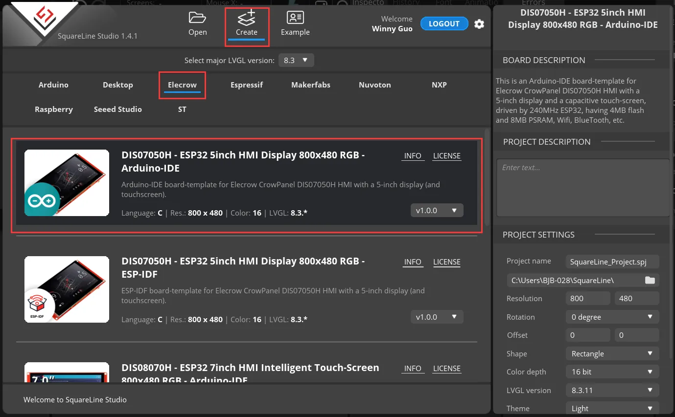

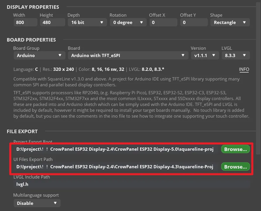

  1. Open the SquareLine Studio and create a project.
    A. In the latest version of SLS, select "Elecrow"->"DIS07050H...Arduino-IDE"
    SLS-UI-1-1
    B. In the earlier version of SLS, select "Arduino"->"Arduino with TFT_eSPI".
    SLS-UI-1
    Note:
    When select the Arduino framwork, there's only one option "Arduino with TFT_eSPI". By choosing this, the squareline studio will generate a template code suitable for the TFT_eSPI library. However, squareline studio not only supports the TFT_eSPI library, it supports a variety of libraries to suit different hardware and application needs. For example, Adafruit_GFX library, LovyanGFX etc.

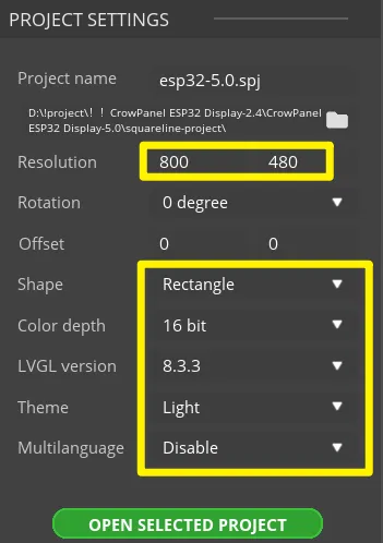

    Set the name of the project, set the screen resolution to 800*480, set the color depth to 16bit, and keep other default settings. After setting, click CREATE to create the project.
    SLS-UI-2

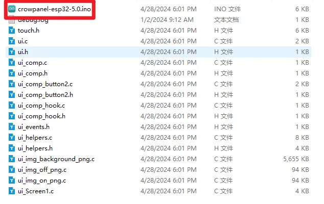

  8. Export UI files.
    SLS-UI-25
    SLS-UI-26
    Then click "APPLY CHANGES".
    SLS-UI-27
    SLS-UI-28
    SLS-UI-29
    Please click download to download the main program(and the expert UI is included).
    SLS-UI-30

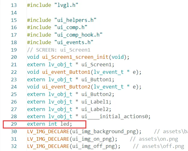

First, define an extern variable in the ui.h file to store the status of the LED. In the main program, the LED light is controlled to turn on and off by judging the status of this variable.
extern int led;

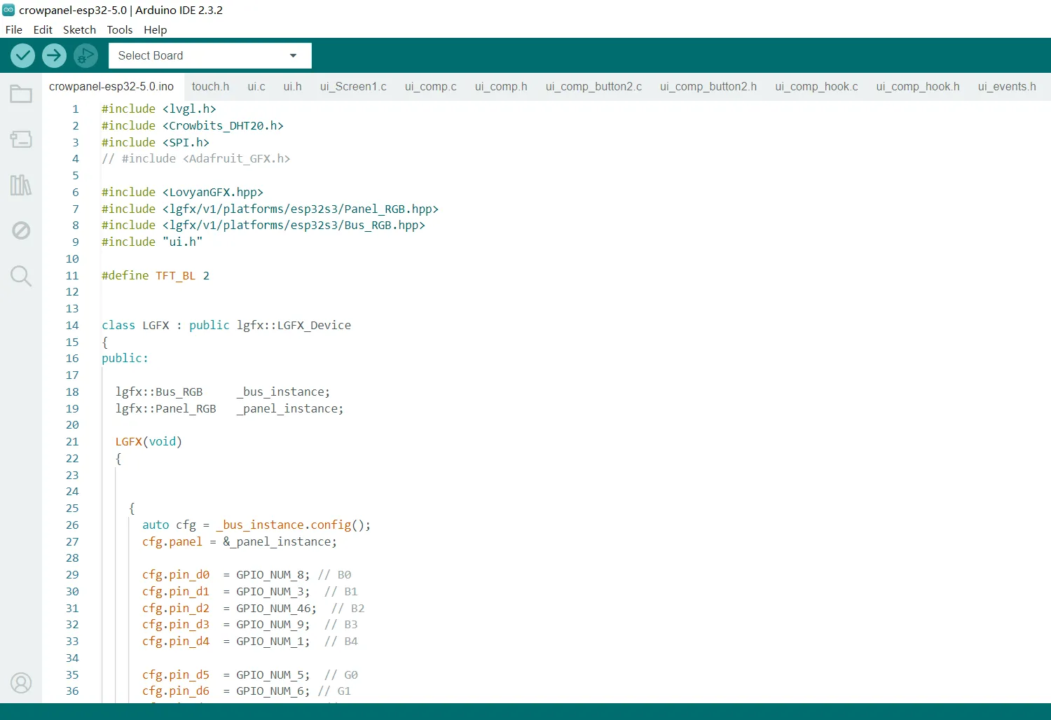

#include <lvgl.h>
#include <Crowbits_DHT20.h>
#include <SPI.h>
#include <Adafruit_GFX.h>
#include <LovyanGFX.hpp>
#include <lgfx/v1/platforms/esp32s3/Panel_RGB.hpp>
#include <lgfx/v1/platforms/esp32s3/Bus_RGB.hpp>
//UI
#include "ui.h"

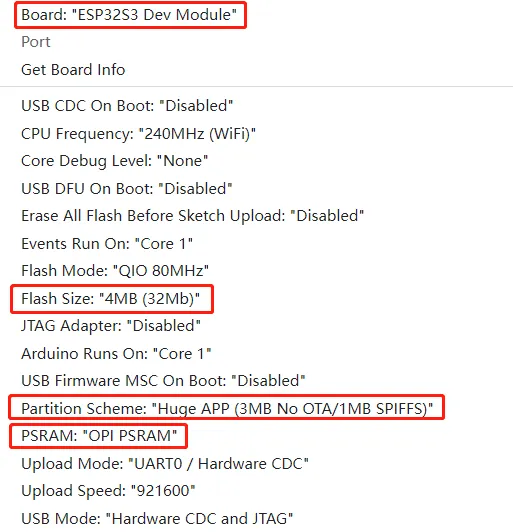

Upload the Code

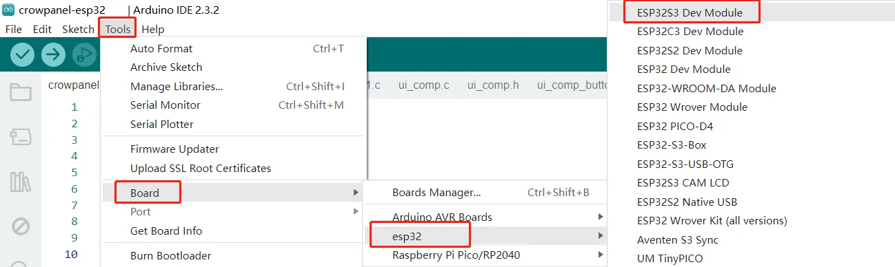

  1. After completing the installation of the ESP32 board according to "Get Started with Arduino IDE" and the installation of the library according to "Install Libraries", open the program and connect the ESP32 HMI 5.0-inch to the computer via a USB-C cable.
  2. Select Board: click "Tools" -> "Board" -> "esp32" and select "ESP32S3 Dev Module"
    select-board

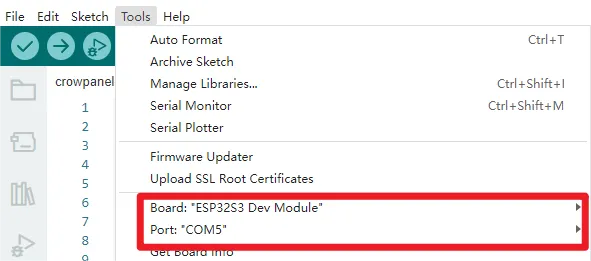

  3. Board Setting: Under the "Tools" menu, see "Flash Size" select 4MB(32Mb); "Partition scheme" and select "Huge APP(3MB No OTA/1MB SPIFFS)"; "PSRAM" select "OPI PSRAM"
    board-setting
  4. Select Port

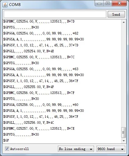

Example7: Connect Crowtail-GPS module via UART to Get Location
Connect the Crowtail-GPS to the UART port.
Upload the following code to the board.
//at 9600 bps 8-N-1
#include <SoftwareSerial.h>
SoftwareSerial SoftSerial(44, 43);
unsigned char buffer[256]; // buffer array for data recieve over serial port
int count=0;     // counter for buffer array
void setup()
  SoftSerial.begin(9600);               // the SoftSerial baud rate
  Serial.begin(9600);             // the Serial port of Arduino baud rate.
void loop()
  if (SoftSerial.available())              // if date is comming from softwareserial port ==> data is comming from SoftSerial shield
    while(SoftSerial.available())          // reading data into char array
      buffer[count++]=SoftSerial.read();     // writing data into array
      if(count == 256)break;
    Serial.write(buffer,count);            // if no data transmission ends, write buffer to hardware serial port
    clearBufferArray();              // call clearBufferArray function to clear the storaged data from the array
    count = 0;                       // set counter of while loop to zero
  if (Serial.available())            // if data is available on hardwareserial port ==> data is comming from PC or notebook
    SoftSerial.write(Serial.read());       // write it to the SoftSerial shield
void clearBufferArray()              // function to clear buffer array
  for (int i=0; i<count;i++)
    { buffer[i]=NULL;}                  // clear all index of array with command NULL
GPS
