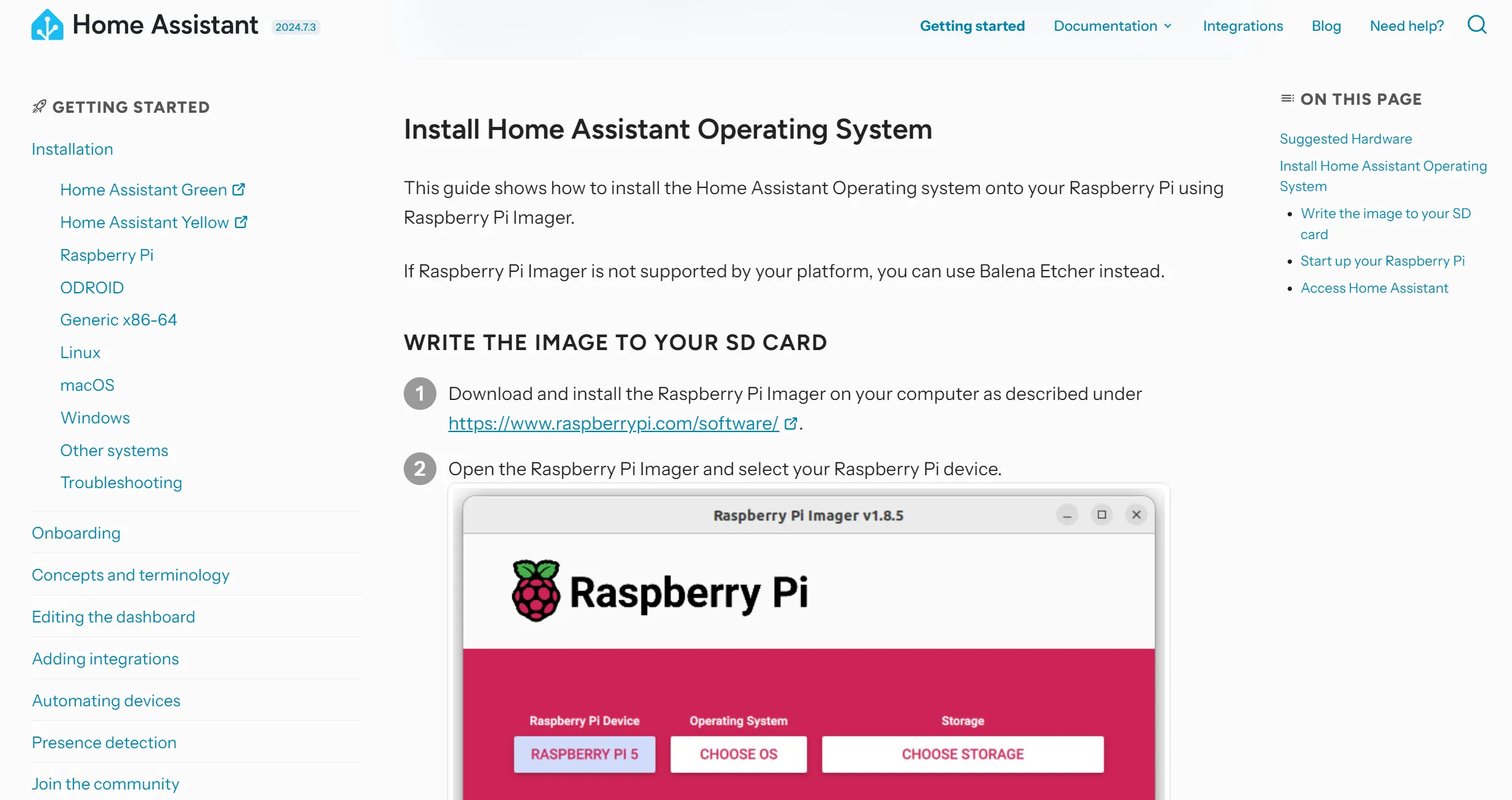

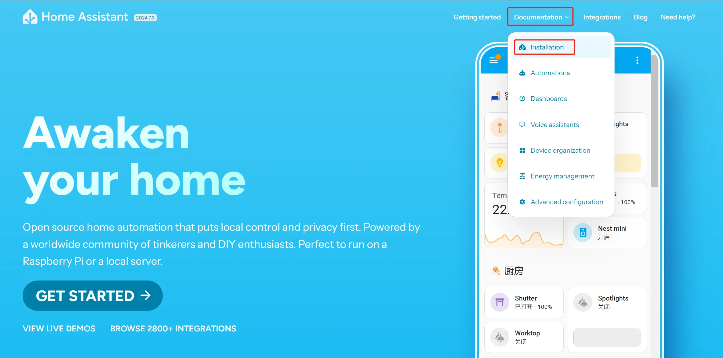

  1. Go to https://www.home-assistant.io/, and click the "Installation" under "Documentation" on the homepage.
    HA-1

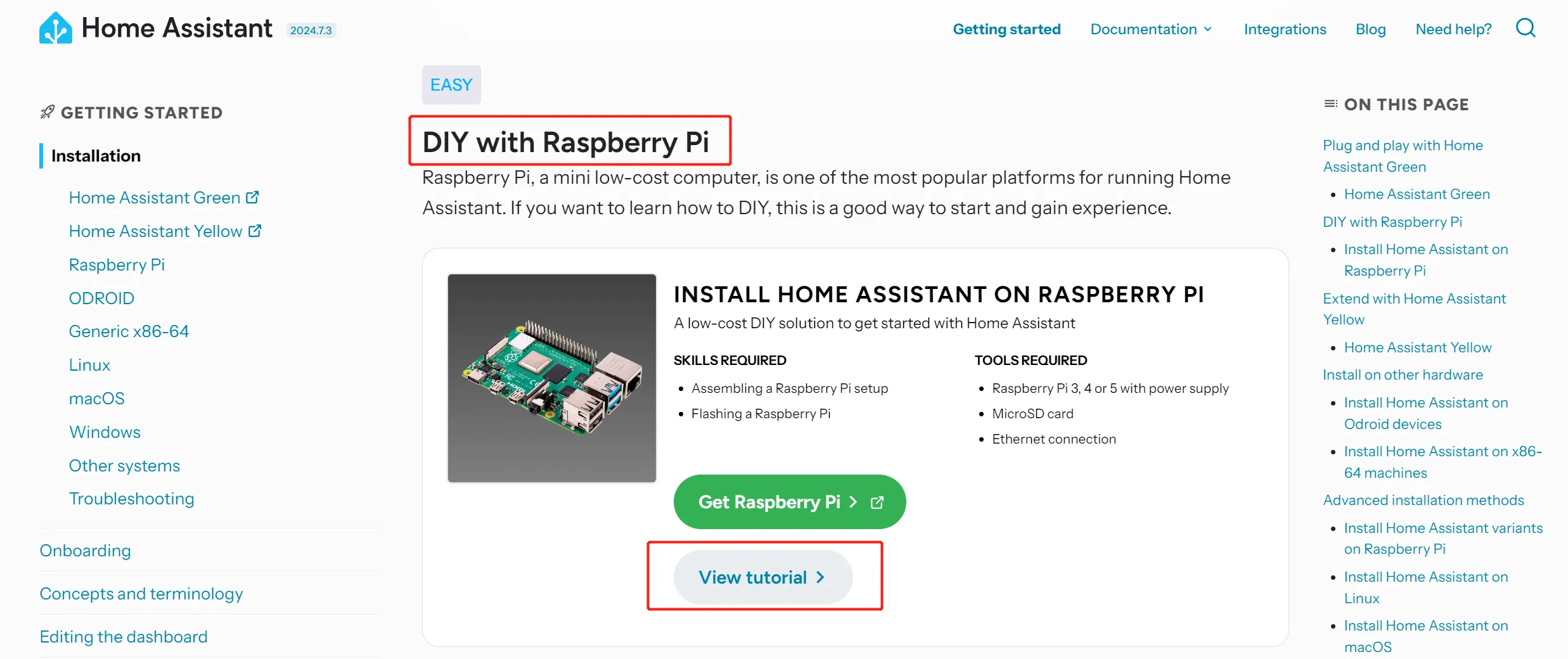

  2. Scroll down to the "DIY with Raspberry Pi" section, and click "View tutorial".
    HA-2
  3. Follow the Home Assistant tutorial to install Operating System.
    HA-3

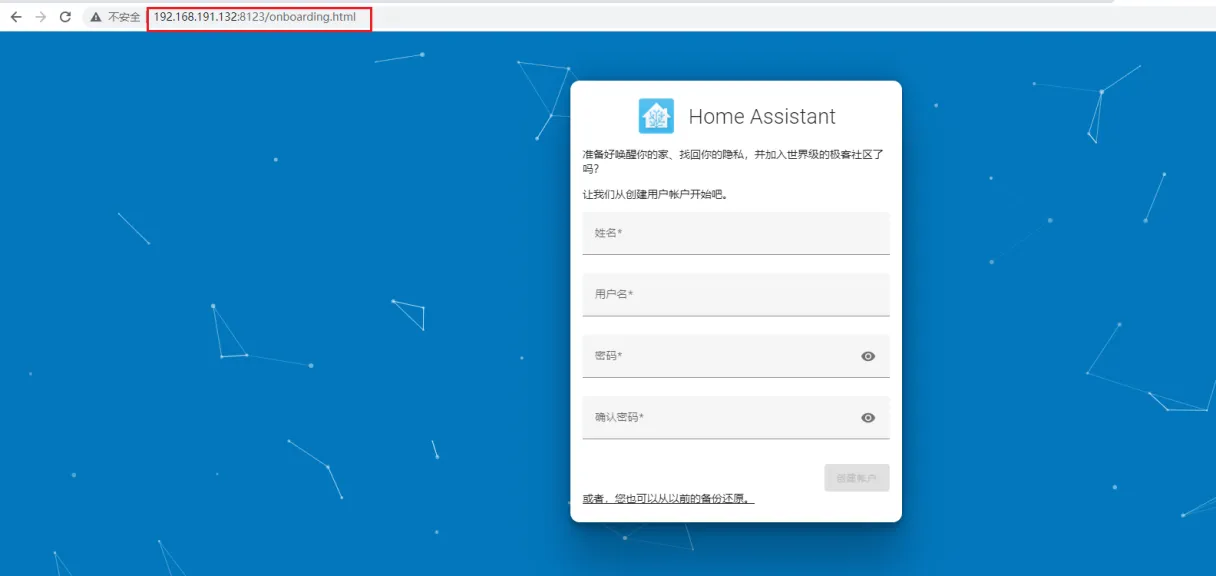

Register for Home Assistant
Within a few minutes after connecting the Raspberry Pi, you will be able to reach your new Home Assistant.
HA-4

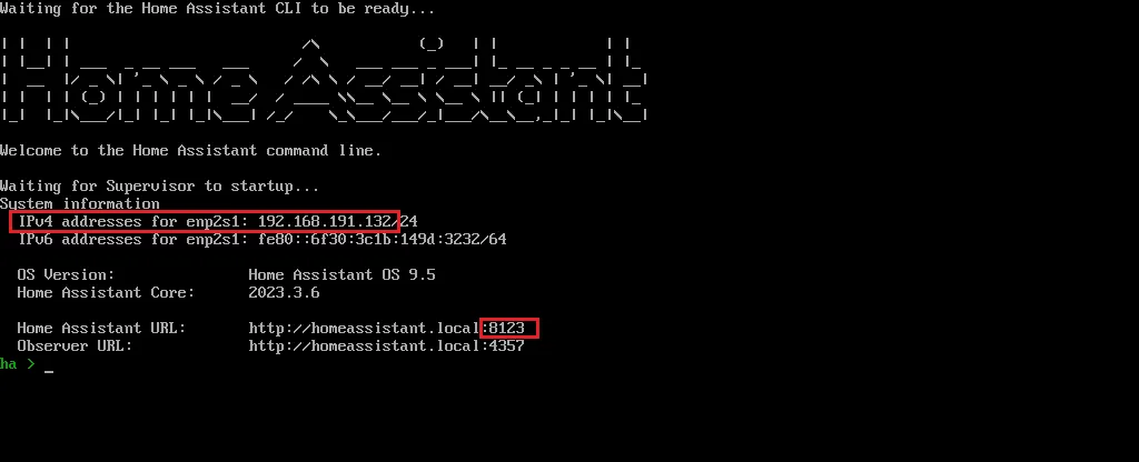

  1. In the browser of your desktop system, enter homeassistant.local:8123.
    HA-5

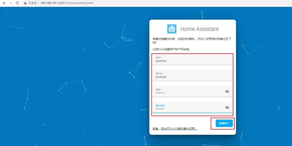

  2. For the first visit, you need to create an account. Fill in the username and password, and create an account.
    HA-6

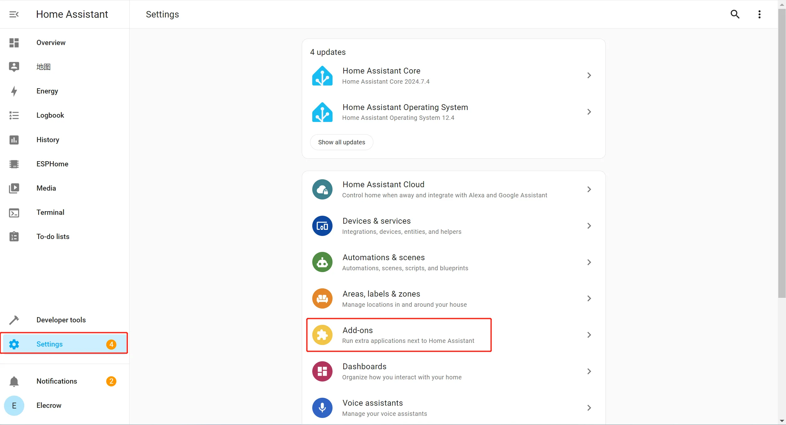

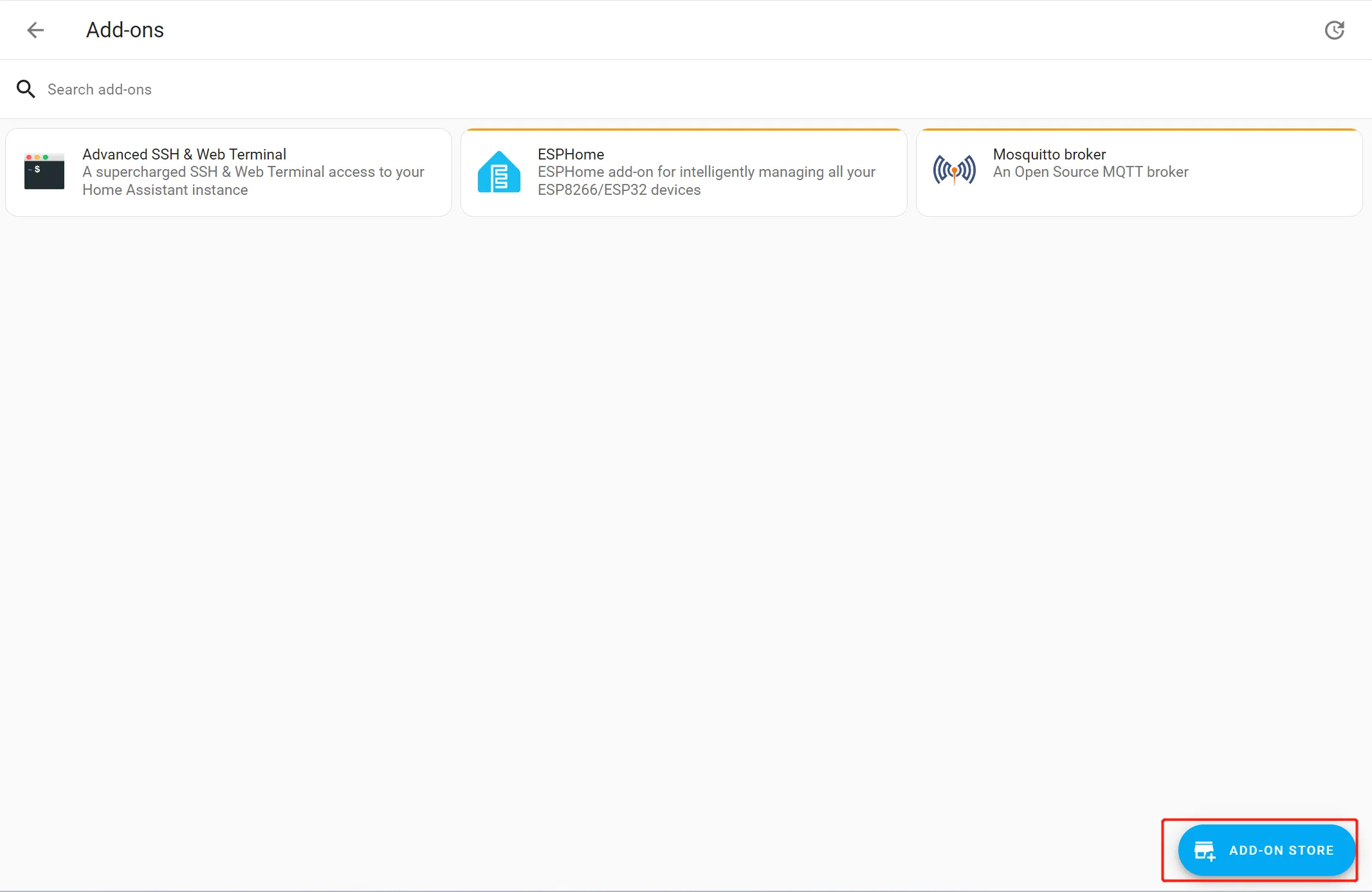

  2. Click "Setting" -> "Add on"
    HA-8

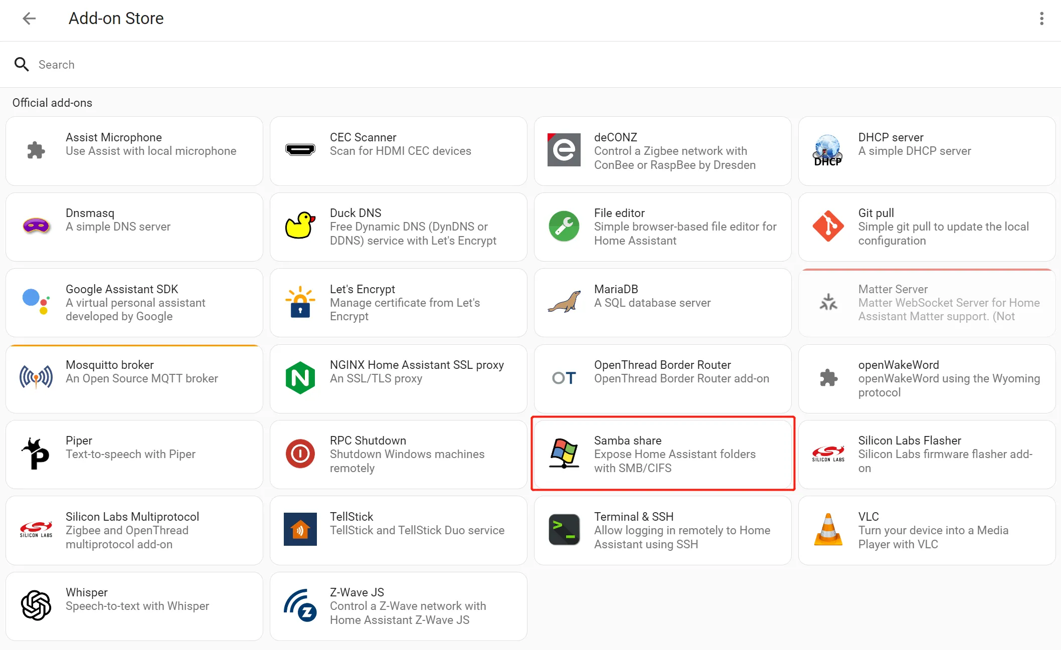

  3. Click ADD-ON STORE
    HA-9
  4. Select "Mosquitto broker" and install

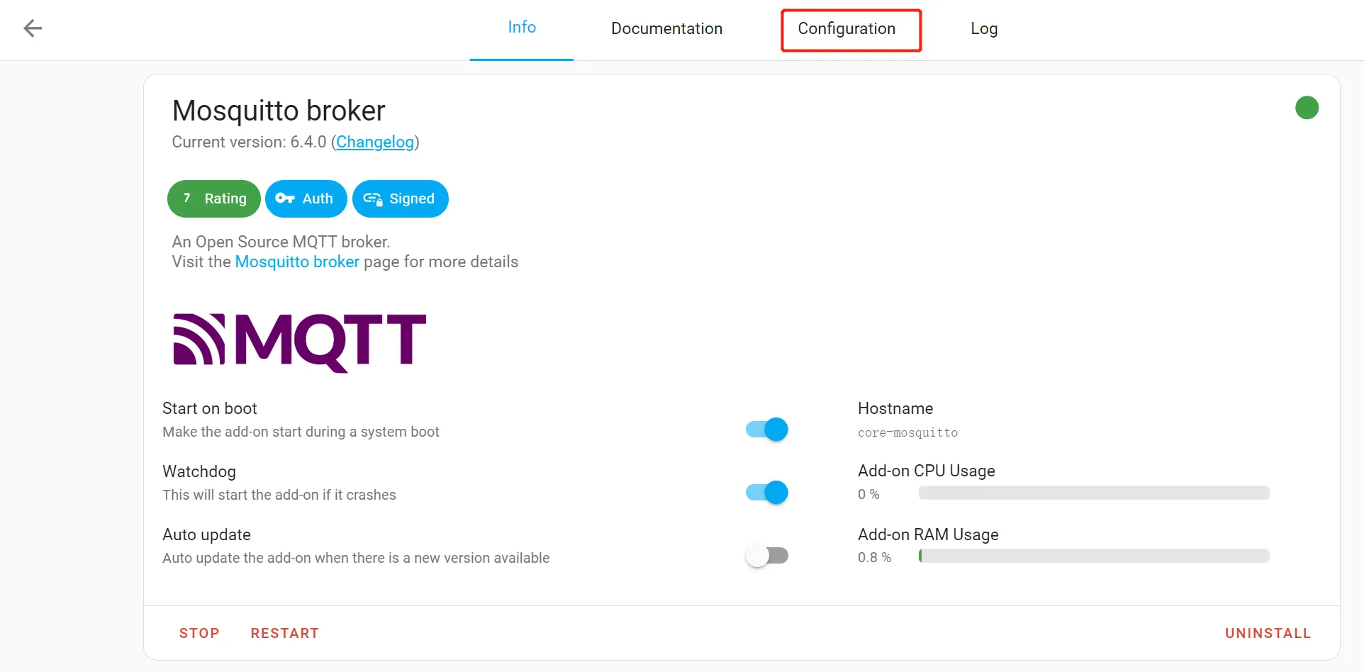

  5. Enable Mosquitto broker

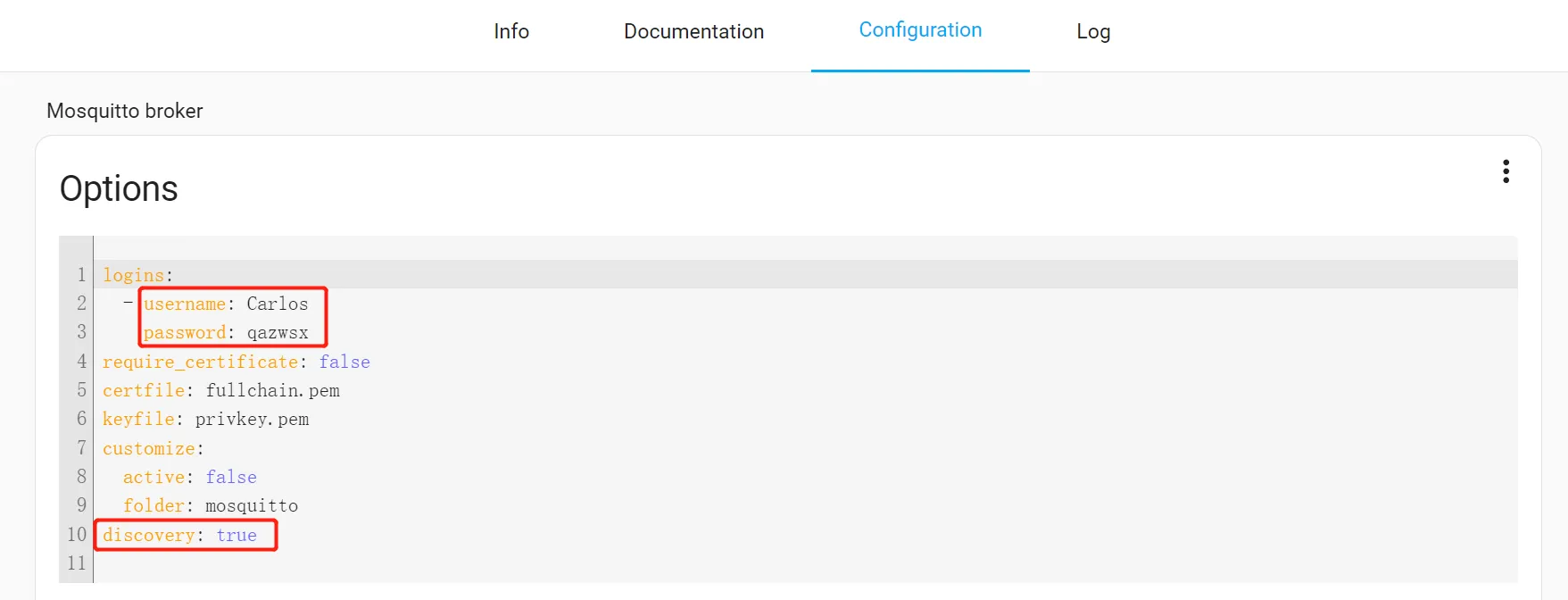

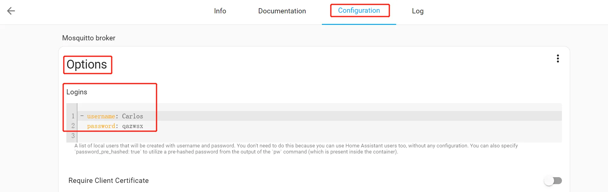

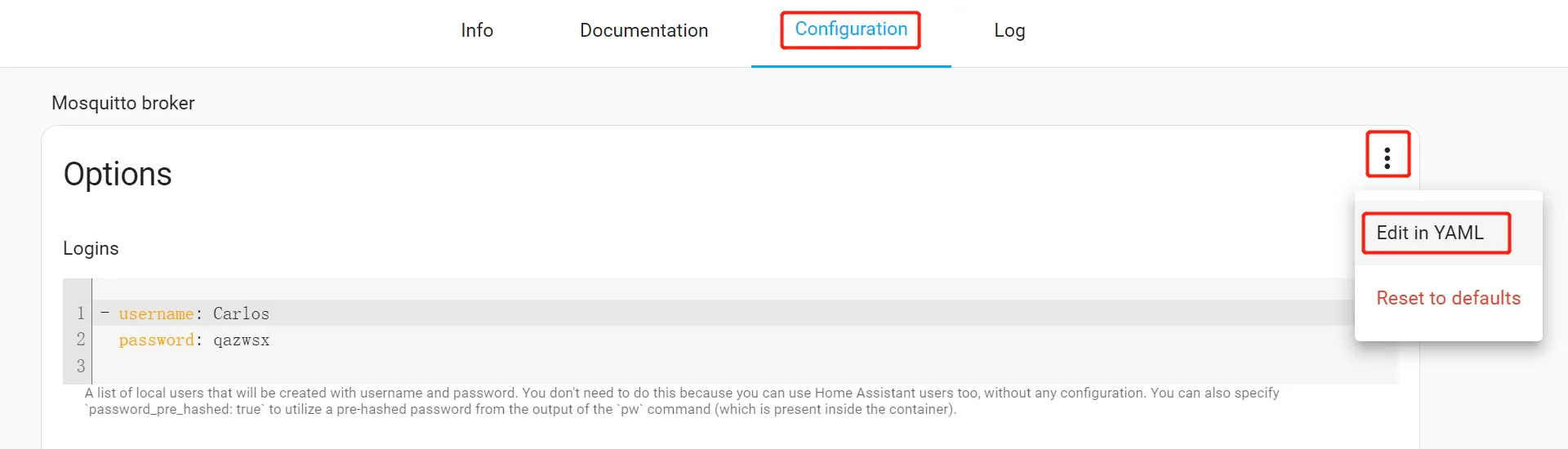

  6. Then click "Configuration" -> "Options" -> "Logins", and set the username and password.
    HA-11
    HA-12
    Click the three-dot icon, then click "Edit in YAML"
    HA-12-1
    Modify the username and password, and set the discovery to "true".
    HA-12-2

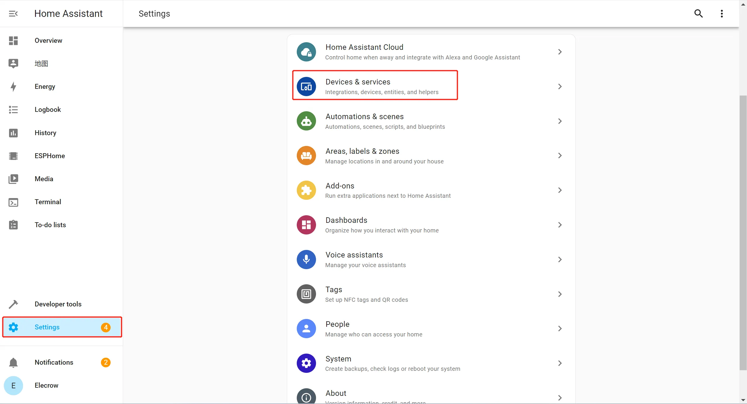

  7. Click "Setting"-> "Devices&Service"
    HA-13

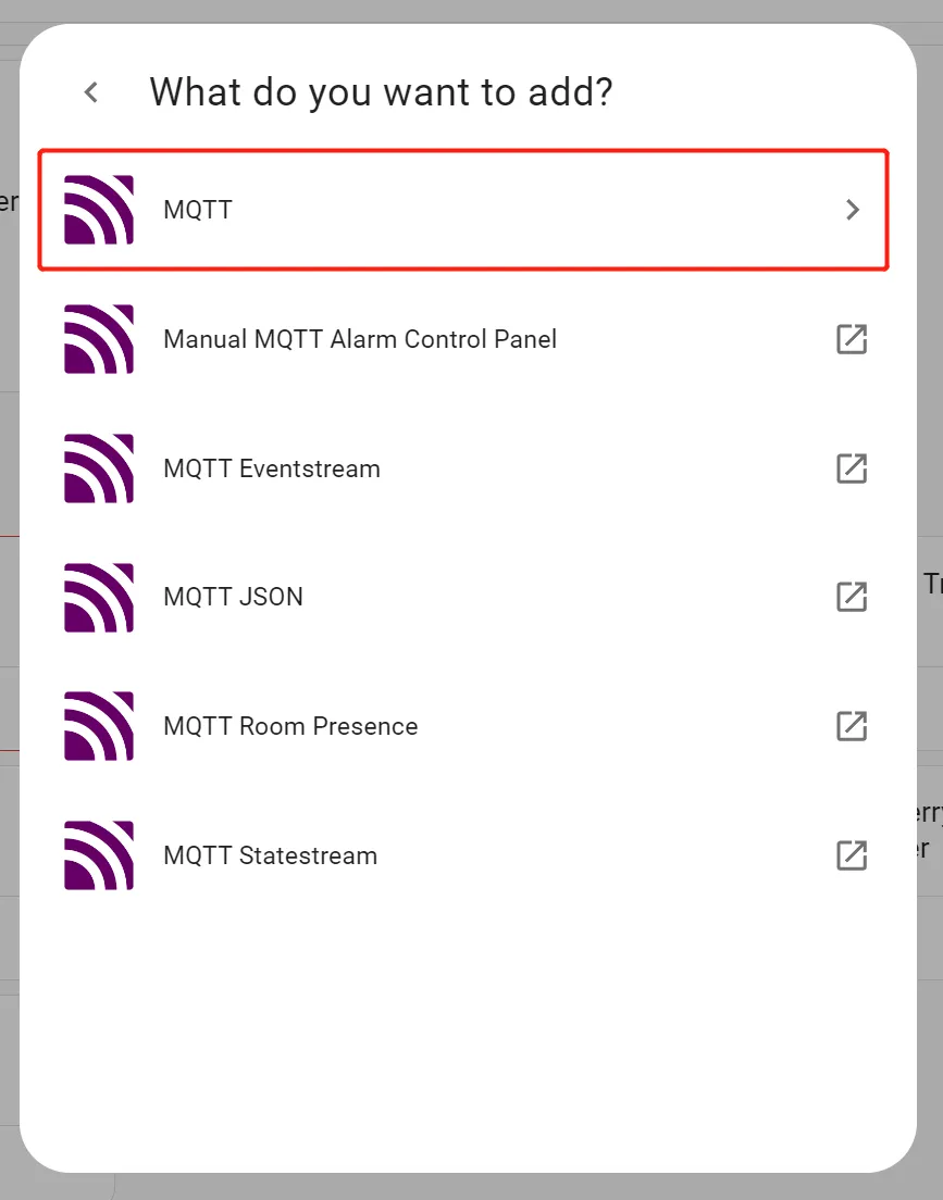

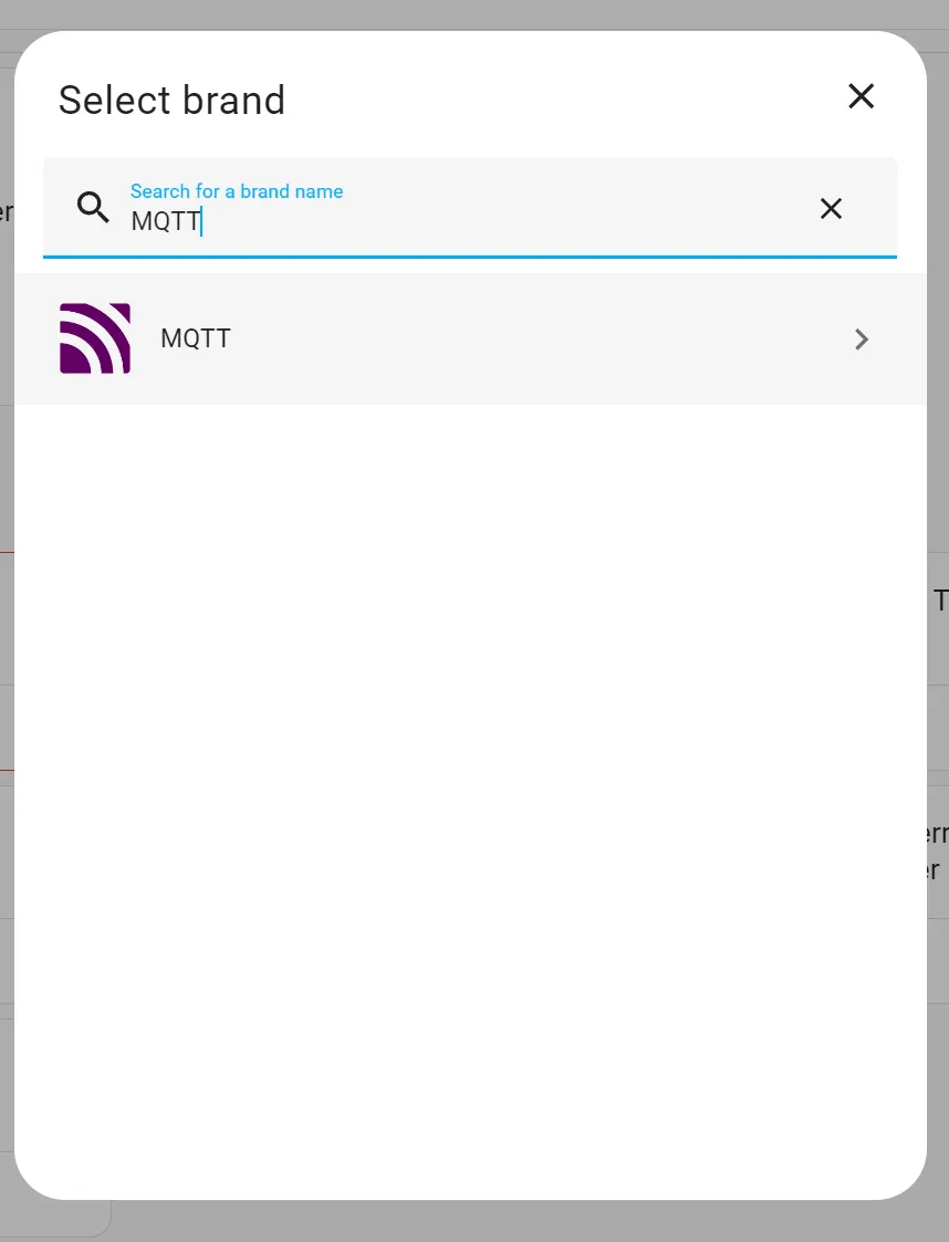

  9. Search for "MQTT"
    HA-14
    HA-16

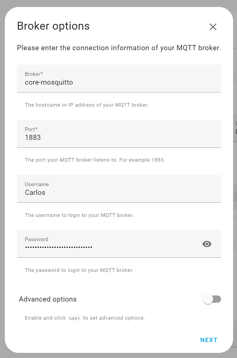

  10. Configure the MQTT server information (the server address is the address and port number of the Raspberry Pi server, and the username and password are the username and password configured in step 6)
    HA-17

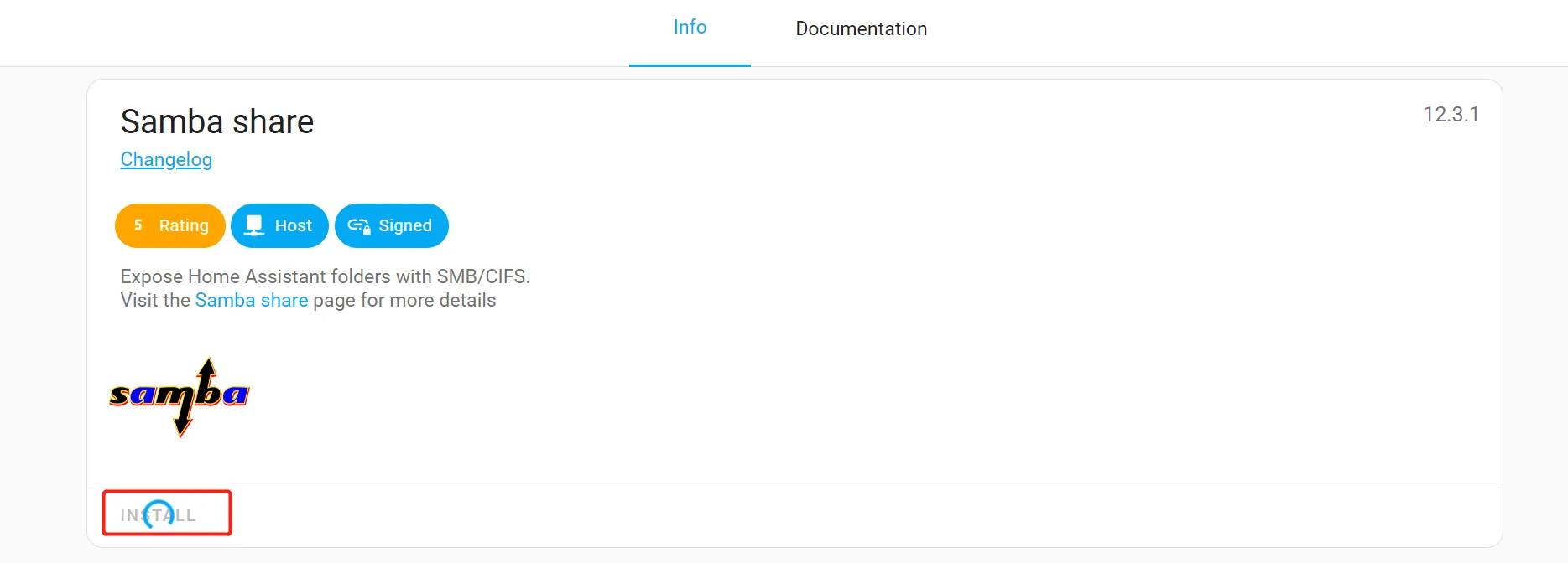

  11. Click "Setting" -> "Add on" -> "ADD-ON STORE", and install Samba share
    HA-18
    HA-19

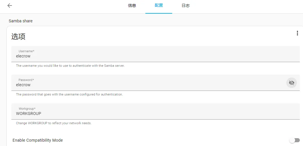

  12. Enter the Samba share Configuration and enter the Username and Password
    HA-20

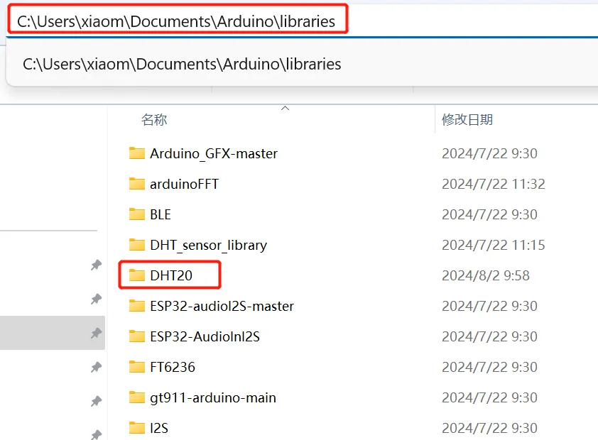

  1. Install "DHT20" library.
    Copy the DHT20 in the libraries folder to the Sketchbook location.
    Arduino-1

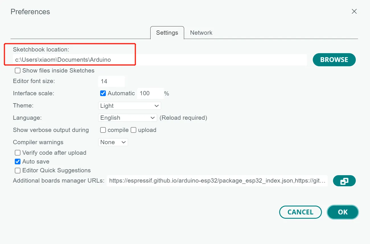

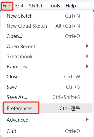

    To find the Sketchbook location, please open the Arduino IDE, click "File"->"Preferences"->"Sketchbook Location".
    arduino-preferences
    sketchbook-location

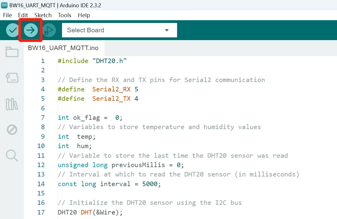

  2. Enter the "HA_MQTT_Demo" folder and open BW16_UART_MQTT.ino

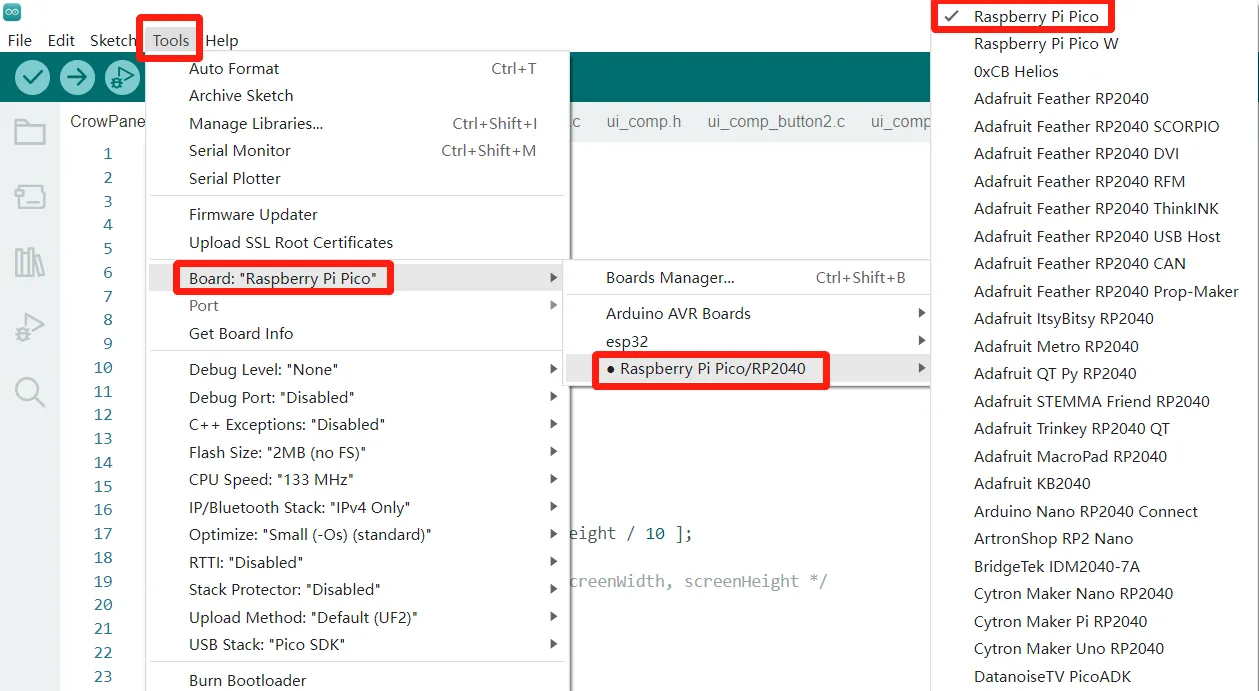

  3. Click "Tool" -> "Board", and select the "Raspberry Pi Pico"
    select-board
  4. Connect the PICO W5 to the computer, and click "Tool"->"Port" to select the corresponding port number.
  5. Click the "Upload" icon to upload the code. After the program is successfully downloaded, it will be prompted that the download is successful.

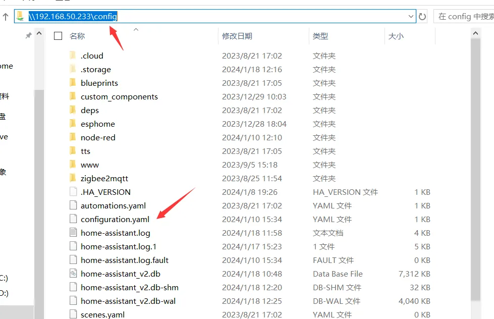

  1. Open "File Explorer" and type in \\192.168.50.233 to enter "config" folder. Open configuration.yaml
    HA-21
  2. Add the following code in configuration.yaml to add the sensors.

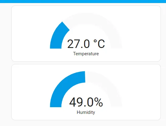

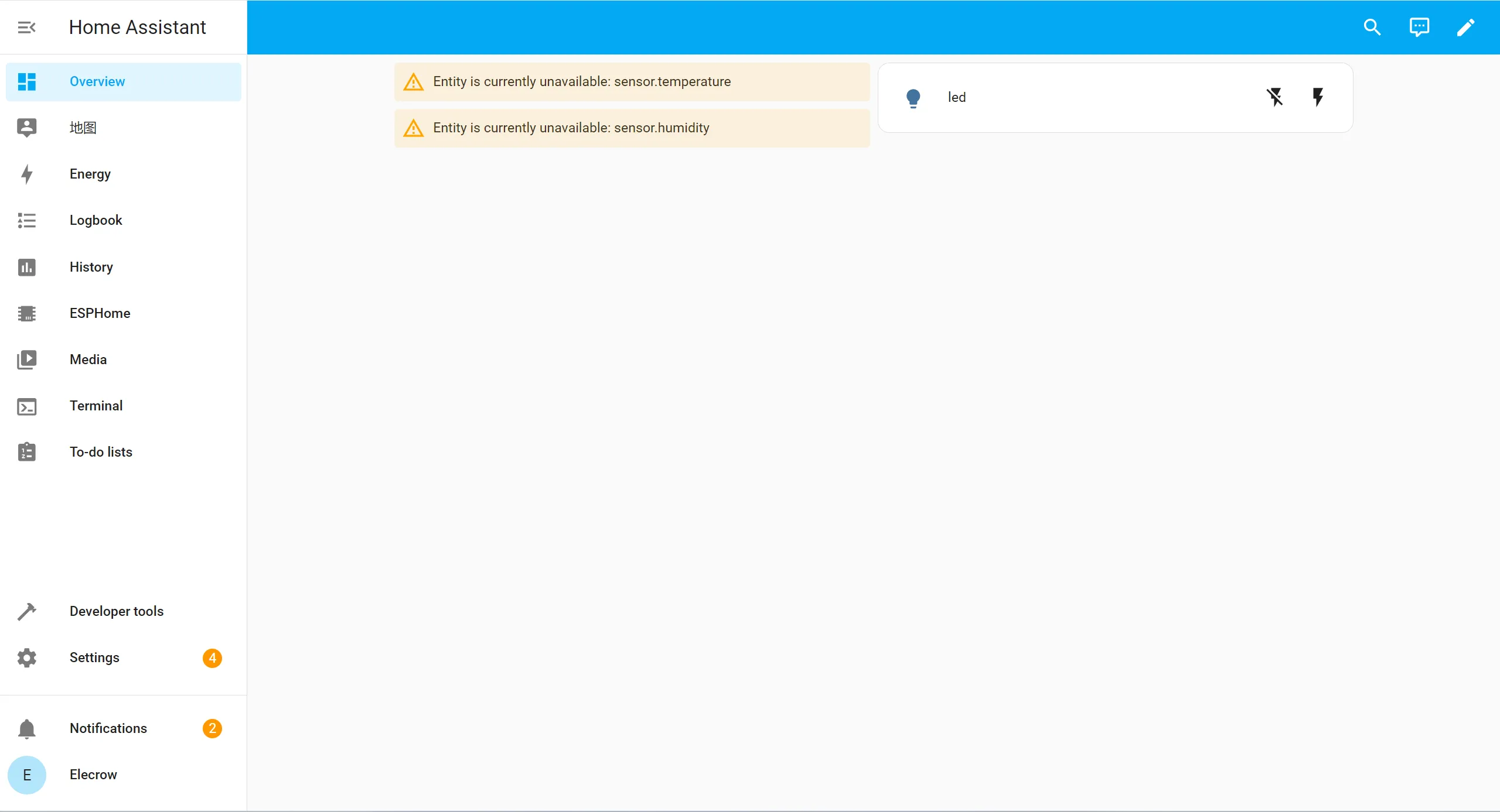

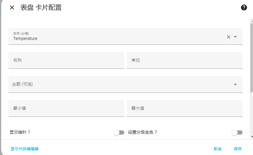

  3. After saving the above code, go to the homepage -> Overview -> Edit Dashboard -> Add Card -> Select the entity just written in configuration.yaml in the card, the save.
  4. Get the temperature and humidity of the environment in real time and display it on the server
    HA-22

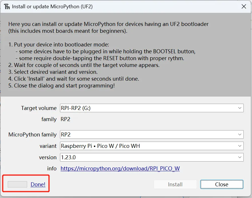

Upload Firmware
Method A
  1. Connect the PICO W5 to the computer. And press BOOT button and REST button at the same time. There will be a U disk
    Thonny-3

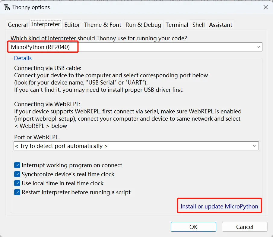

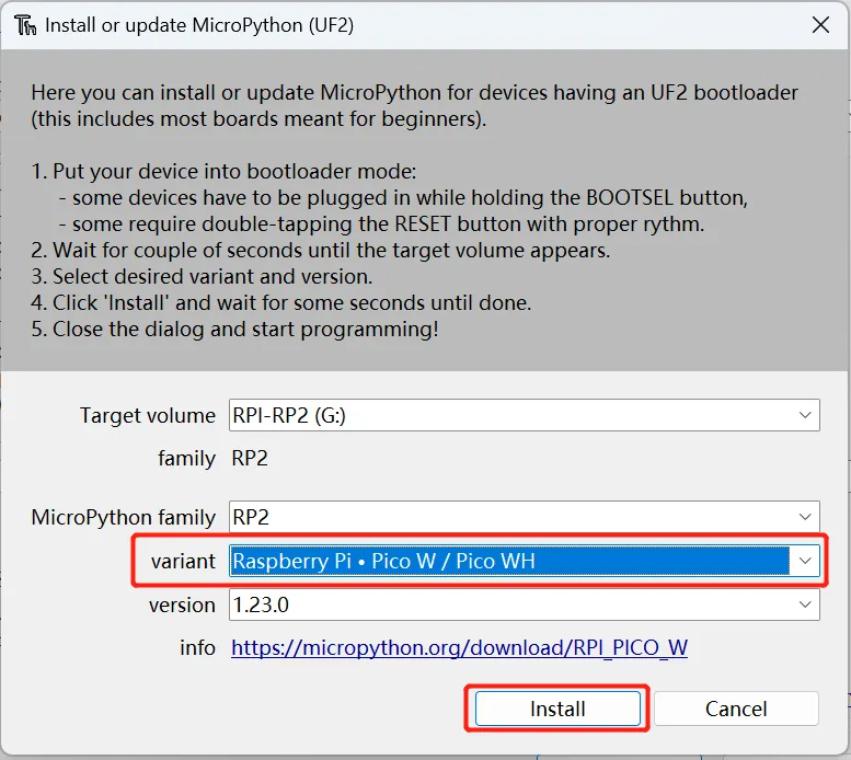

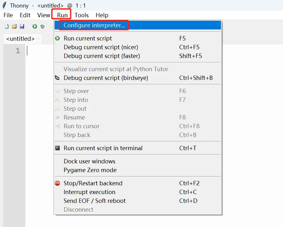

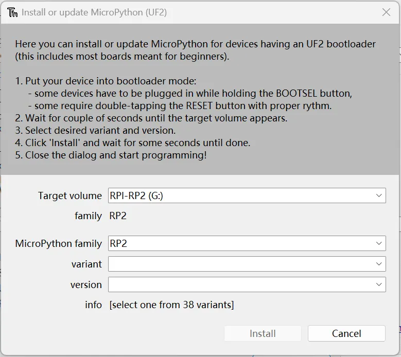

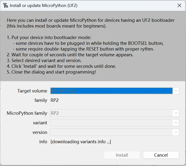

  2. Open Thonny IDE and click "Run"->"Configure interpreter". Select "MicroPython(RP2040)" as the interpreter. Then click "Install and update MicroPython"
    Thonny-6
    Thonny-7
  3. Waiting for the loading the downloading variants info...
    Thonny-8
    After loading is complete, it will show:
    Thonny-9
    Select the variant to and install the firmware.
    Thonny-10
    Installation is done!
    Thonny-11

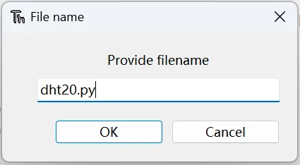

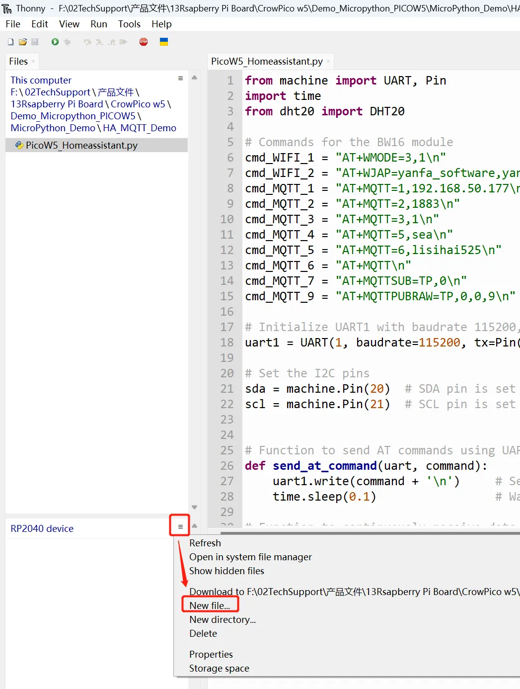

  1. Click the menu icon in the upper right corner of RP2040 device. Select "New file..."
    Thonny-12
  2. Name the file, note to add the file type suffix(.py)
    Thonny-13
  3. Then copy the following to the editor.

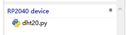

  4. Click run, then the dht20.py will be added to RP2040 device
    dht20-added

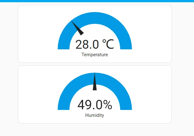

    Thonny-14
  4. Connect the sensor the PICO W5 board. Then open the "PicoW5_Homeassistant.py" on Thonny IDE and run.
    Please click download to download the PICO W5 MicroPython Code.
  5. Get the temperature and humidity of the environment in real time and display it on the server

Examples 5 Read Temperature and Humidity from DHT20 via I2C 0
  1. Plug the DHT20 module to GPIO-20 and GPIO-21.
    Sensor PIN
    SCL GP21
    SDA GP20
  2. Upload the DHT20_test_rp2040_i2c0.ino to CrowPico W5.

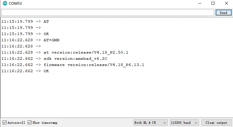

Examples 6 Control BW16 with AT Commands through UART1
  1. The BW16 is soldered on board. The RX is connected with GP5, and the TX is connected with GP4.
  2. Upload the BW16_UART.ino to CrowPico W5.
    // Define the RX and TX pins for the second serial port
    #define Serial2_RX 5  // Set the RX pin
    #define Serial2_TX 4  // Set the TX pin
    // Initialize the second serial port
    void UART1_Init()
    Serial2.setRX(Serial2_RX);  // Set the RX pin for the second serial port
    Serial2.setTX(Serial2_TX);  // Set the TX pin for the second serial port
    Serial2.begin(115200);     // Start the second serial port at a baud rate of 115200
    delay(1000);               // Delay for 1 second to allow the serial port to initialize
    // Setup function to initialize the main serial port and the second serial port
    void setup()
    Serial.begin(115200);      // Start the main serial port at a baud rate of 115200
    UART1_Init();               // Initialize the second serial port
    // Main loop function that prints "loop" and then delays
    void loop()
    UART1_test();
    // Test function for the second serial port
    void UART1_test()
    Serial2.println("AT");
    delay(500);
    while (Serial2.available())  // Check if there is data available to read from the second serial port
       Serial.write(Serial2.read());  // Write the data from the second serial port to the main serial port
    Serial2.println("AT+GMR");
    delay(500);
    Serial.println("");
    delay(500);
  3. After the code is successfully uploaded, open the serial monitor.

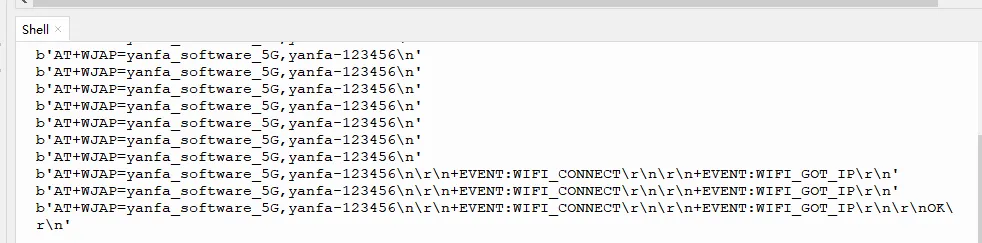

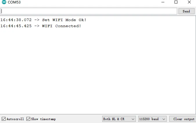

    WIFI

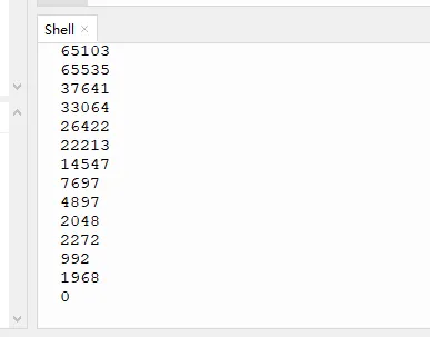

Examples 4 Control the Light Intensity into an Analog Value
  1. Plug the light sensor module to GPIO-27 Port.
    Sensor PIN
    Light Sensor GP27
  2. Run the AnalogRead.py.
    from machine import ADC, Pin
    import time
    # Initialize an ADC object using Pin 27 for analog input
    adc = ADC(Pin(27))
    while True:
       # Read the analog value from the ADC and print it as a 16-bit unsigned integer
       print(adc.read_u16())
       # Delay for 1 second to avoid overwhelming the output with too many readings
       time.sleep(1)
  3. The light intensity will be printed in the shell.

  2. Run the I2C_DHT20.py.

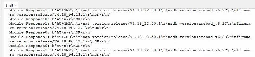

  2. Run the Uart_Test.py
    from machine import UART, Pin
    import time
    # Initialize UART1 with baudrate 115200, transmit on Pin(4), receive on Pin(5)
    uart1 = UART(1, baudrate=115200, tx=Pin(4), rx=Pin(5))
    # Function to send AT commands
    def send_at_command(uart, command):

  3. After the code is successfully uploaded, the AT command will be printed in the shell.
Examples 7 Connect to the 5G band Wi-Fi
  1. Send the command to connect to WiFi to the bw16 module through uart1 and receive the information returned by the bw16 module.
  2. The BW16 is soldered on board. The RX is connected with GP5, and the TX is connected with GP4.
  3. Run the Connect_to_the_5G_band_Wi-Fi.py
    Note: Serial1 is UART0, and Serial2 is UART1
    import time
    # Function to send AT commands using UART1
       uart1.write(command + '\n')     # Send the AT command followed by a newline for the module to process
       time.sleep(0.1)                 # Wait for the module to process the command and send a response
    # Function to continuously receive data from UART1 until a newline character is detected
    def Uart1_receive():
       data = b''          # Initialize an empty bytes object to store incoming data
       succeed = "OK"      # Expected success response from the module
       fail = "ERROR"      # Expected error response from the module
       while True:
          if uart1.any():              # Check if there is data available to read
                data += uart1.read()     # Read all available data into 'data'
          if data.endswith(b'\n'):     # Check if the data ends with a newline character
                if succeed in data:      # If the success response is in the data
                   print(data)          # Print the received data
                   break                # Exit the loop
                if fail in data:         # If the error response is in the data
                print(data)              # Print the data received so far
          time.sleep(0.5)              # Wait for 0.5 seconds before continuing
    # Send an AT command to set the module's working mode
    send_at_command(uart1, 'AT+WMODE=3,1')
    Uart1_receive()
    # Send an AT command to connect the module to a Wi-Fi network with the SSID "yanfa_software_5G" and password "yanfa-123456"
    send_at_command(uart1, 'AT+WJAP=yanfa_software_5G,yanfa-123456')
    Uart1_receive()
