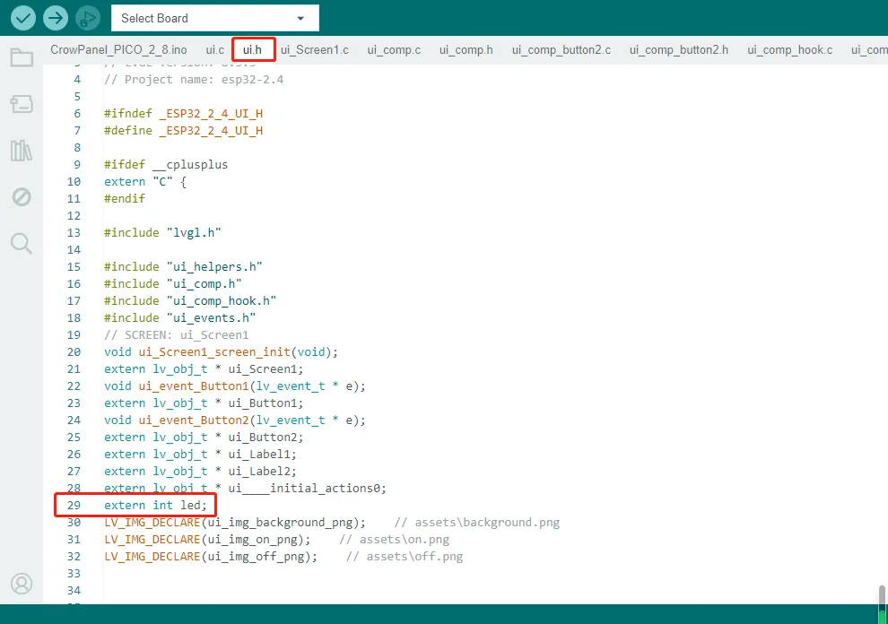

  10. Modify the button event code.
    31
    First, define a variable in the ui.h file to store the status of the LED. In the main program, the LED light is controlled to turn on and off by judging the status of this variable.
    extern int led;
    32
    An integer variable named led is declared, and the declaration is defined externally. This means that the variable led is declared here, but its actual definition (memory allocation) is expected to be found elsewhere in the code.
    SLS-UI-33
    • When button 1 (ON button) is pressed, set the LED value to 1.
    SLS-UI-34
    • When button 2 (OFF button) is pressed, set the LED value to 0.
    SLS-UI-35

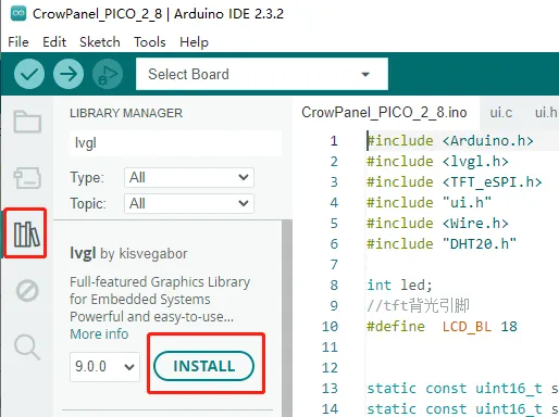

Build the Project with Arduino IDE
Get Started with Arduino IDE
Please click the card below to learn how to install Arduino IDE, and install RP2040 board in the Arduino IDE.
Add Libraries
#include <Arduino.h>
#include <lvgl.h>
#include <TFT_eSPI.h>
#include "ui.h"
#include <Wire.h>
#include "DHT20.h"
  • #include <Arduino.h>: contains the Arduino core library, providing commonly used functions and data types.
  • #include <lvgl.h> and #include <TFT_eSPI.h>: are libraries for graphical interfaces, used for display control and drawing.
  • "ui.h": is a custom header file that contain UI-related functions or definitions.
  • #include <Wire.h>: here we use this library for I2C communication.
  • "DHT20.h": to read data from the DHT20 temperature and humidity sensor.
Please clickdownloadto download the libraries we modified.
Then click "File" -> "Preferences" -> "Setting" to check the sketchbook location. Place the libraries
downloaded to the sketchbook location.

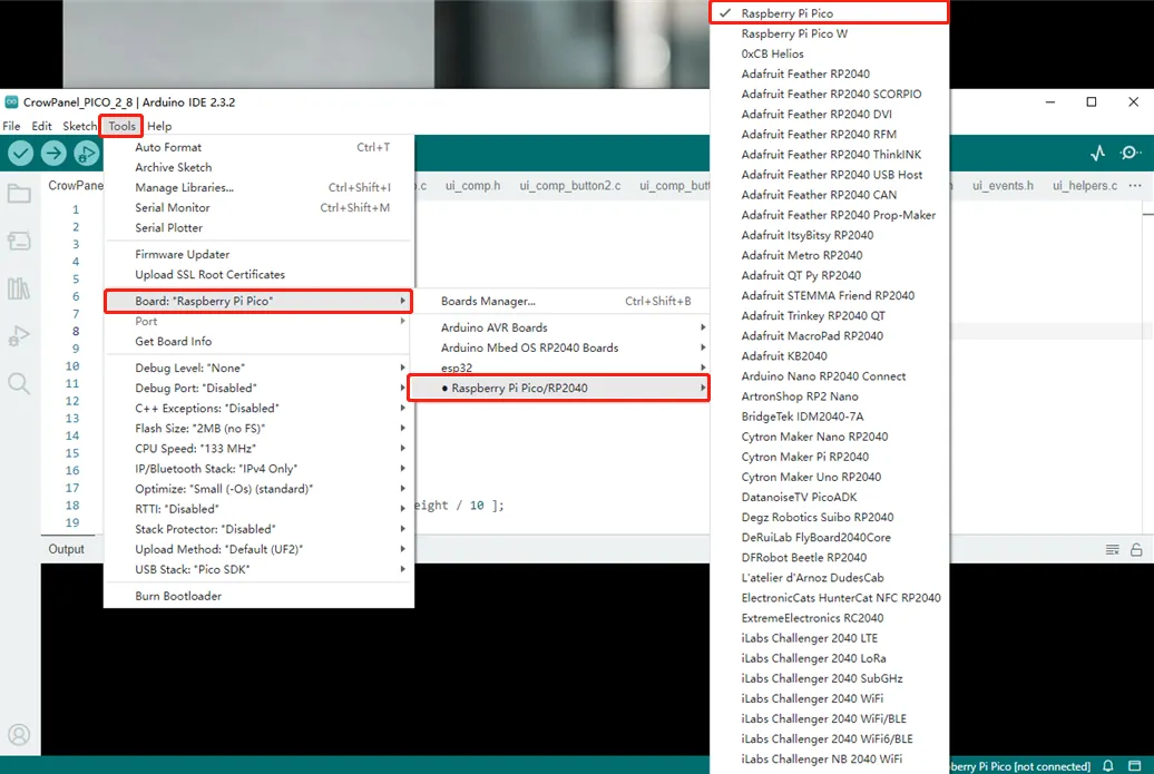

  1. After completing the installation of the RP2040 board according to "Get Started with Arduino IDE" and the installation of the library according to "Add Libraries", open the program and connect the PICO HMI 2.8-inch to the computer via a USB-C cable.
  2. Select Board: click "Tools" -> "Board" -> "Raspberry Pi Pico/RP2040" and select "Raspberry Pi Pico"
    36

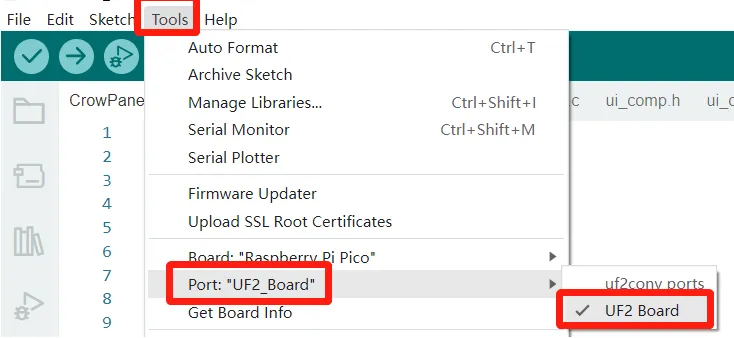

  3. Select Port: Please hold the BOOT button and press the RESET button first, and the PICO HMI board will turn into a U disk. Then click "Tools" -> "Port" and select UF2...(Note: you need to press the button every time you need to connect the board with computer  through serial communication.)
    35

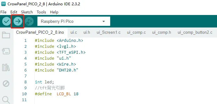

  4. Upload the code
    34

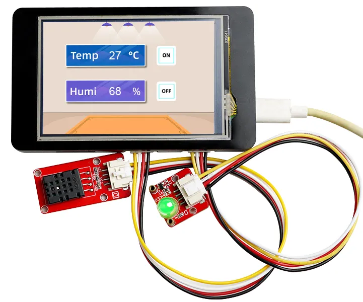

  5. After the program is successfully uploaded, connect the DHT20 sensor to the IIC port and the LED to UART1 (GP5).
Click the RESET button, and the temperature and humidity values will be displayed on the screen. Click the ON button on the screen and the LED will turn on. Click the OFF button and the LED will turn off.
