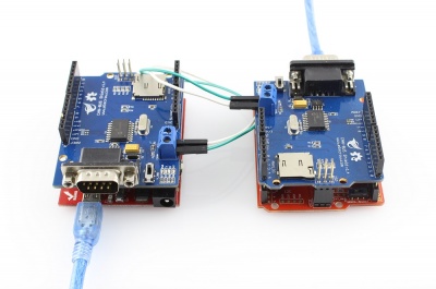

Plug the CAN-BUS Shield onto the Arduino. And then connect the Crowduino to PC with USB cable.

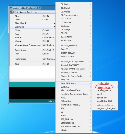

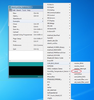

2. Open the Arduino-1.0, and you will find 8 examples: receive_check ,send and receive_interrupt and so on. Here we'll use send and receive_check, open it then you should get two programming windows now.

3. Upload two examples to two boards separately. Choose the board via the path: Tools -->Serial Port-->COMX. Note down which board is assigned as a "send" node and which board is assigned as a "receive" node.
4. Open the "Serial Monitor" on the "receive" COM, you will get message sent from the "send" node. Here we have the preset message "0 1 2 3 4 5 6 7" showing in the following picture.
