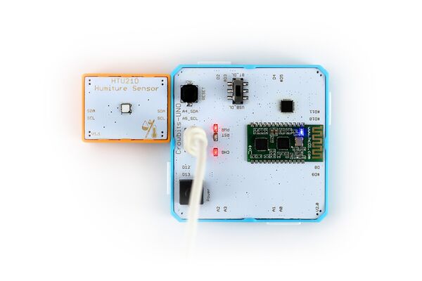

1.You need to prepare a Crowbits motherboard, such as Crowbits-UNO board.
2.Connect the module to the I2C interface of the Crowbits-UNO board, as shown in the figure:

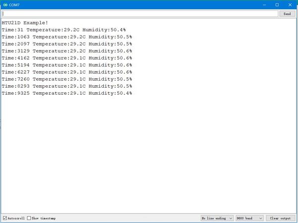

5. After the upload is successful, open the serial port monitor, the baud rate is set to 9600. The serial port will print out the current temperature and humidity values.
