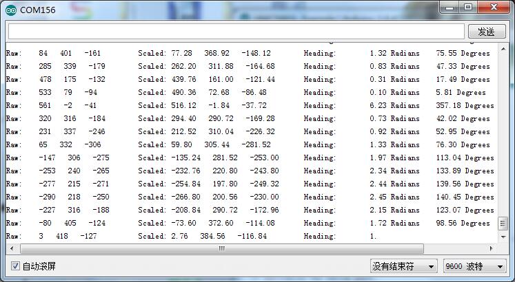

4. Upload the code and open the serial monitor.
