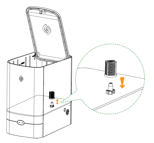

Install the filter, install the filter at the water inlet of the water tank, and insert it vertically as shown in the figure right.
