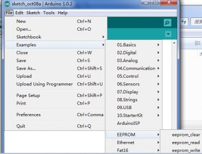

1. Open the demo code in library by path: Files->Examples:

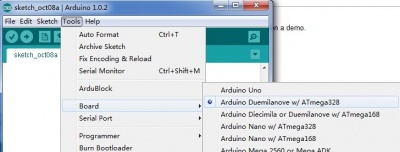

2. Selet the right Arduino board you are using and the Serial Port the board using by the path: Tools -- Board-- you can also get the Serial port using in the computer hardware management.

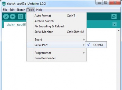

3. Select the correct serial port you are using by the path: Tools -> Serial Port

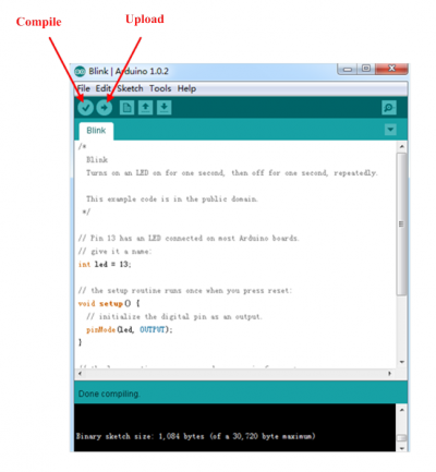

4. Upload the demo code as below show:
When there appears "Done uploading", congratulate you upload successfully.
