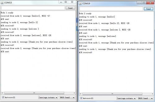

Running the Sketches
You now have two nodes that will send messages to each other, but, to use them, we’ll need to open two serial terminals.
One way to do this is to run two separate Arduino IDEs. You’ll have to actually start Arduino twice - you can’t just open a “new” code window from the first IDE.
Set one IDE to the COM port of the first node and the other to the COM port of the second. Then, open serial monitor windows from both IDEs.
In each serial monitor window, you’ll need to set the baud rate to 9600 and make sure the “line ending” dropdown is set to “carriage return.” (The example code uses carriage returns as a signal to send a packet.)
Once both windows are up, you should be able to type messages in the text entry box at the top of one window and press return to send the message to the other window. Try it!
