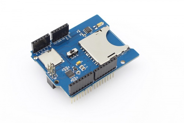

RTC Data Logger Shield v1.1
The RTC Data Logger Shield v1.1 adds storage to your Arduino project. It supports SD, SDHC, or MicroSD TF cards. Use the on-board toggle switch to select the SD card type. The card supports use of one and only one format of SD card, either SD/SDHC, or MicroSD. Before using an SD or MicroSD card, please set the shields "SELECT" switch to the proper setting: toward the SD/SDHC slot, or the MicroSD slot.Also it with a RTC on-board,that make you project more perfect. The RTC Data Logger Shield v1.1 uses the SPI and IIC ports of Arduino. The shield is also stackable, so additional shields can go on top. The RTC Data Logger Shield v1.1 makes use of pin 4 as a chip select. Please be sure other stacked shields do not make use of that same pin.

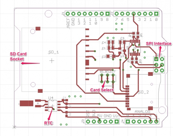

Interface Function
D10 – Used for CS of SPI
D11 – Used for MOSI of SPI
D12 – Used for MISO of SPI
D13 – Used for SCK of SPI

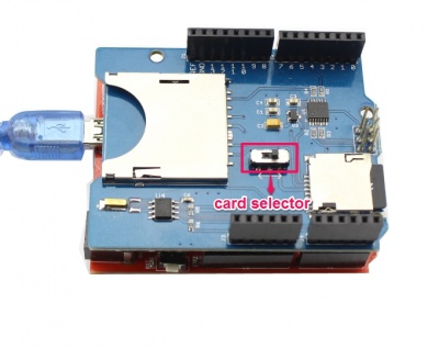

Plug the RTC Data Logger Shield v1.1 onto the Arduino; Insert your SD card into the socket and make sure the card selector pointing to the right way (Standard card or micro).And then connect the Arduino to PC with USB cable.
Warning: Don't insert SD card and microSD card into the shield at the same time.

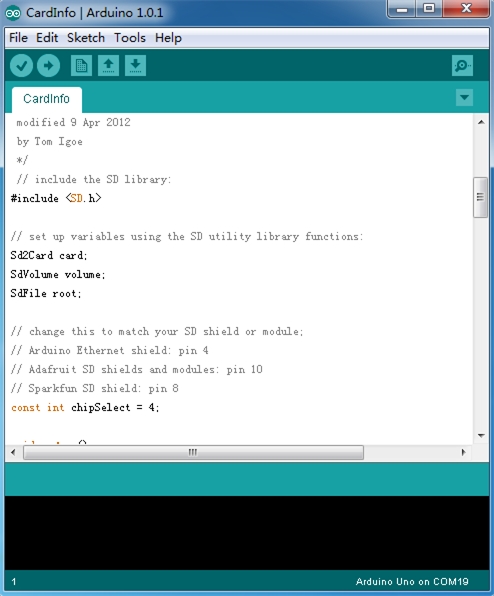

1. Restart the Arduino IDE. Open "CardInfo"example via the path: File --> Examples --> SD --> CardInfo.
This example shows how use the utility libraries on which the SD library is based in order to get info about your SD card.Very useful for testing a card when
you're not sure whether its working or not. There are also many other examples in this library, like “ReadWrite”. You can always try them out.
There has a brief description to above code:
First checks if the card is working. if not, there will output some reasons that may lead to this result.
In the case of the SD card normal work, it will print the SD card type.Then print the type and size of the FAT-type volume.
Finally, get the files information such as name, date and size in bytes that found on the card.

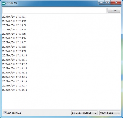

4.Upload the code,then open the serial monitor to see the result.
