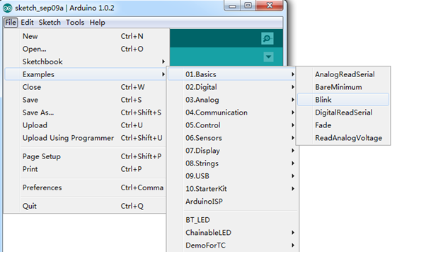

step2: Open the Blink example¶
Open the LED blink example sketch: File->Examples->01.Basics->Blink.

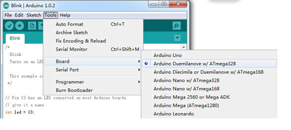

step3: Select your board¶
You'll need to select the entry in the Tools > Board menu that corresponds to your Arduino. 在Here we need to select ATmega328.

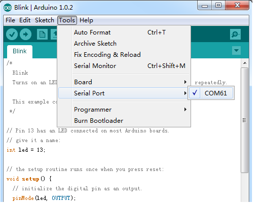

step4: Select your Serial Port¶
Select the serial device of the Arduino board from the Tools | Serial Port menu.

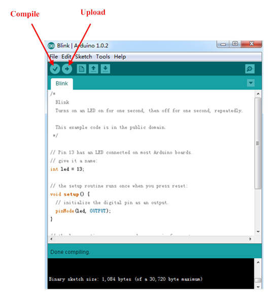

step5: Upload the program¶
Now, simply click the "Upload" button in the environment. Wait a few seconds - you should see the RX and TX leds on the board flashing. If the upload is successful, the message "Done uploading." will appear in the status bar.

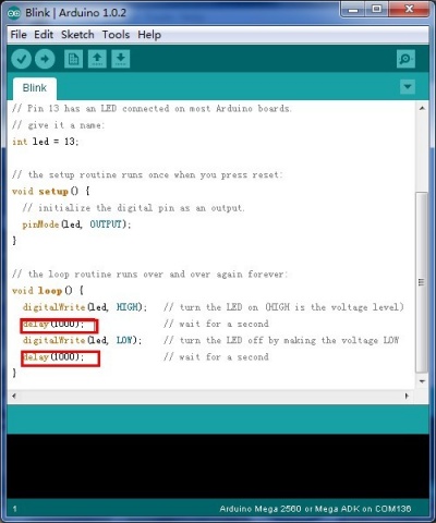

step6: Modify the code as you like¶
As you see the "Uploading Done", it means that the program has been download to your Crowduino. You should see the pin 13 (L) LED on the board start to blink with a interval of 1s. Try to modify the val of delay() , you will see the blink interval changing. ![]()
