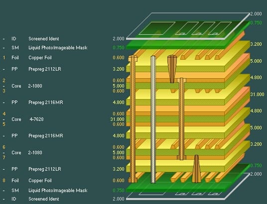

Design of laminated structure
The basic design principles of laminated structure are:
If the customer has a designated structure, it willbe designed according to the customer's requirements.
When the customer has impedance requirements, the laminated structure that meets the customer willbe used.
When the customer does not specify the structure, the design principle is: the thickness of the dielectric layer and the pressing thickness meet the customer's requirements.
The core board with larger thickness is preferred for the inner board.

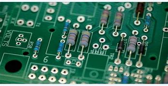

Component hole:
The diameter of the metalized hole is 0.2~0.3mm larger than the diameter of the lead, which is conducive to the solder of wave soldering to climb up and is conducive to exhaust the gas at the same time. If the hole is too small, the gas cannot escape and will be mixed in the solder. The hole is too large, and the element is prone to deflect.

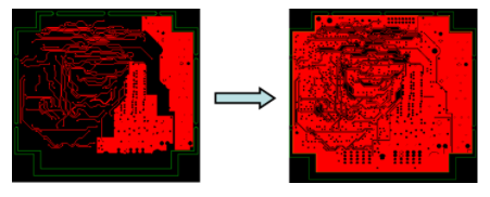

When the wiring of the whole design is completed, try to lay copper on the blank area without wiring to increase the anti-interference power of the circuit. Draw the outline of the copper pouring area, select the pouring method, and connect the ground network with the copper sheet. However, the distance between copper sheet and pad and wire should better be at least8mil.
The uniform distribution of outer copper can make the current distribution and coating thickness uniform during electroplating, which is convenient for production and processing and conducive to product reliability.

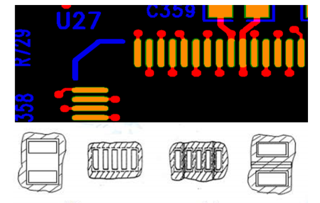

Solder mask design
The Through hole treatment method is to cover the plug hole, but it is best not to put the via that needs to be plugged on the pad of the window, in order to avoid oil generation, resulting in abnormal welding, such holes are covered without plugging the hole treatment.
To prevent short circuits caused by solder bridging, it is often necessary to retain the green oil bridge. When the IC pad spacing < 8mil, the green oil bridge cannot be retained.
The maximumdiameter of the plug hole is 0.6mm, it is recommended that the via bore diameter of the plug hole needed to be designed within 0.6mm, and the best one is between 3-0.4MM. For example, in order to ensure good conduction, a few more holes can be placed with the network.
The viaholes in the BGA area are processed in the form of plug holes without special requirements. When designing test points, it is recommended to identify them with identification numbers on the character layer.

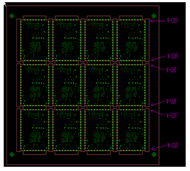

PCB multi-pieces splicing design
When the PCB size is less than the minimum mounting size (<50mm×50mm), it must be designedin the form of a panel, and the special-shaped board also needs to be plated.
The splicing designcan improve production efficiency. When adopted double-sided full surface mounting without using the wave soldering, It can be designed with a double-numbered panel, half of the front and back sides, and the same graphics on both sides. This design can use the same template to save the programming and production preparation time, improving production efficiency and equipment utilization.
Splicing design requirements:
The size of the panel should not be too large, nor too small. It should be determined according to PCB (The maximum panel size of the PCB with a thickness of 1mm is 200mm × 150mm)
The edge of thesplicing boards is generally 5-10mm, and the positioning hole should be
The markpoint is added to the diagonal part of each small board.
The positioning hole is added to the process side, and the distance is 5mm from each side. Asymmetrical 3-4 positioning holes can be added to the process edge.
V-CUT Design
There is no spacing between the process edges and the unit board. When the width of the bridge is small, then we resort to V-CUT design. There are several angles of V-CUT : 20°, 30°, 45°, 60°. The most commonly used is 30°.
