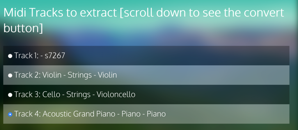

In the track box make sure to check “Piano”, it can be any number but in our example it’s Track

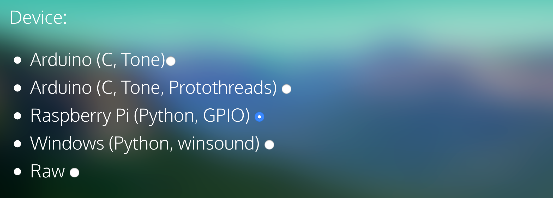

In the bottom of the page you’ll find a form called “Device” make sure to tick “Raspberry Pi (Python, GPIO) as we are going to make it work for our CrowPi.

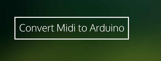

After this step it’s time to convert our midi track into python code using this button:
Even tho the button states “Convert midi to Arduino” it will work just fine with Raspberry Pi if you checked the box states” Raspberry Pi” one step before.

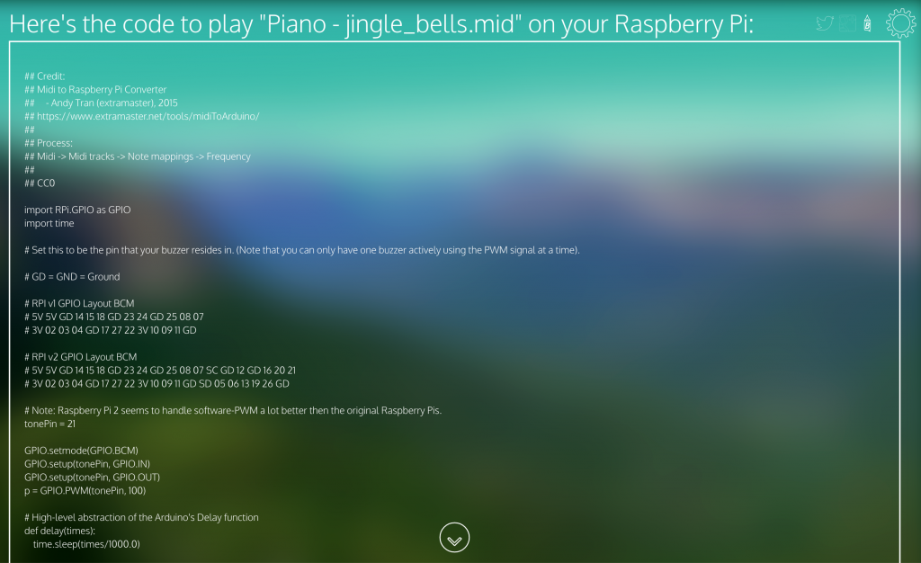

After pressing the button your code will be ready and converted successfully into readable python code. Copy the entire content and save it into .py file.
One last thing will be to change “tonePin = 21” into our buzzer pin, change it to “tonePin = 12”.
