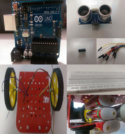

1. Materials Required

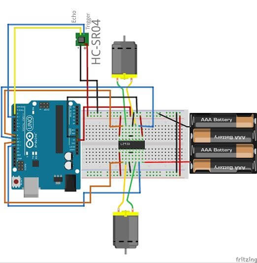

2. Wiring and Schematic

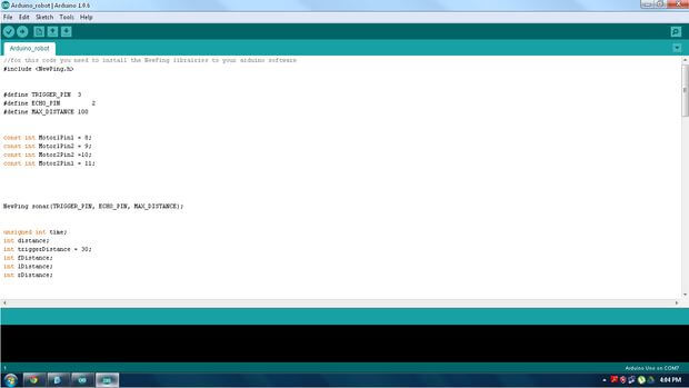

3. Programming

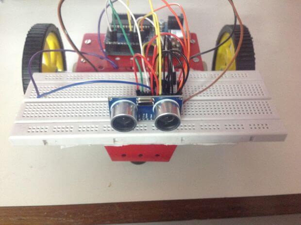

4.Arduino robot
