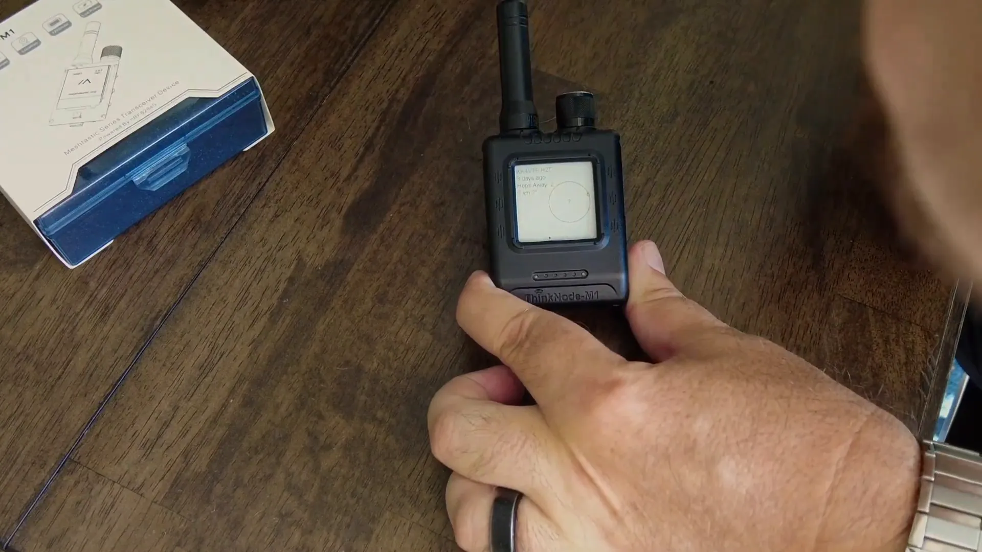

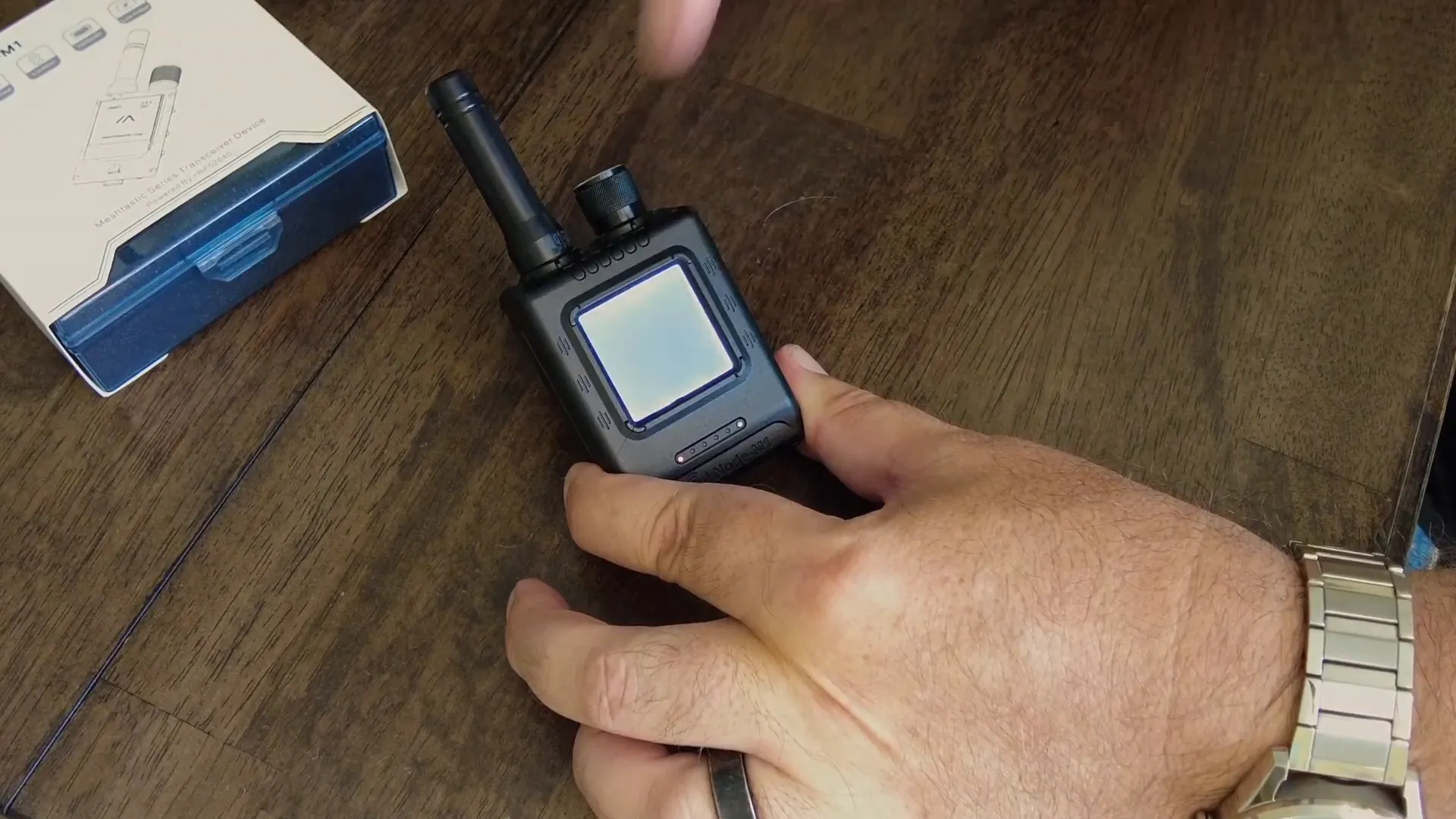

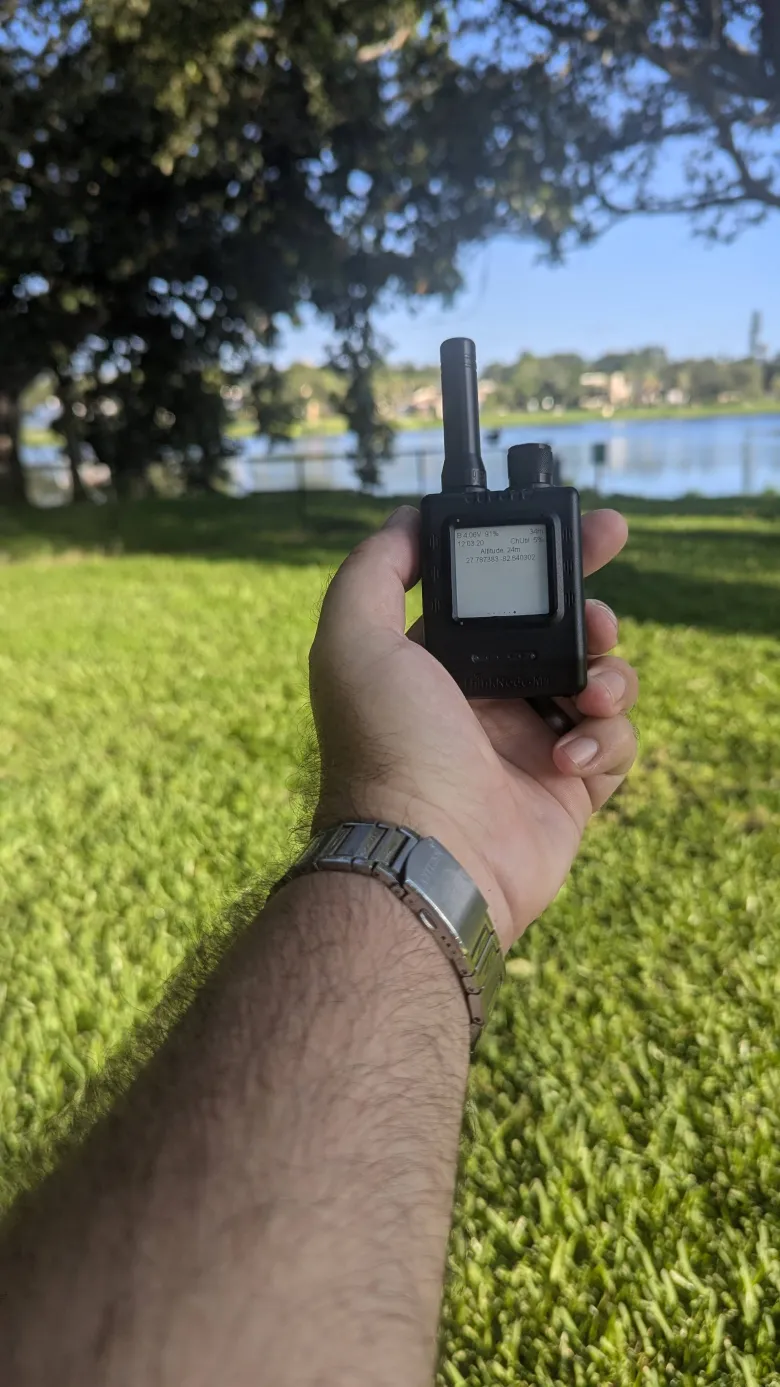

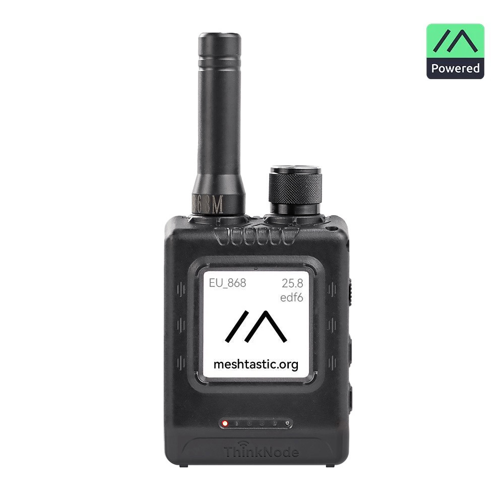

The Elecrow M1 Meshtastic, or ThinkNode M1, comes packaged neatly in a compact case with all the essentials including a USB-C cable for charging. The key highlight of the M1 version is its e-paper display, which sets it apart from many other mesh network nodes on the market. The e-paper screen offers excellent readability even in daylight, and it is backlit with an adjustable rotary dial that controls brightness levels—bright enough to "blind the cat," as I jokingly noted. This makes it very versatile for use outdoors or indoors.
ThinkNode M1 with e-paper display in focus
Under the hood, the M1 uses the nRF52840 chip, a low-power and efficient microcontroller, unlike the M2 version that uses an ESP32-S3 chip known to consume more power. The device includes a 2.4 GHz antenna with a unique SMA connector design where the male part is on the radio and the female part is on the antenna, but it performs surprisingly well given its sturdy build.

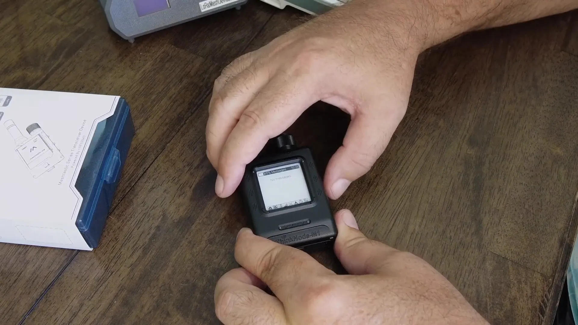

Physical controls on the device include:
  • An ON/OFF switch
  • A function button
  • A paging button to scroll through screens (though this can be unresponsive when the node is busy)
  • A dedicated physical GPS switch, which I found especially useful
On the back, there’s a 2mm mount hole, allowing you to attach the node to other equipment or mounts if needed.

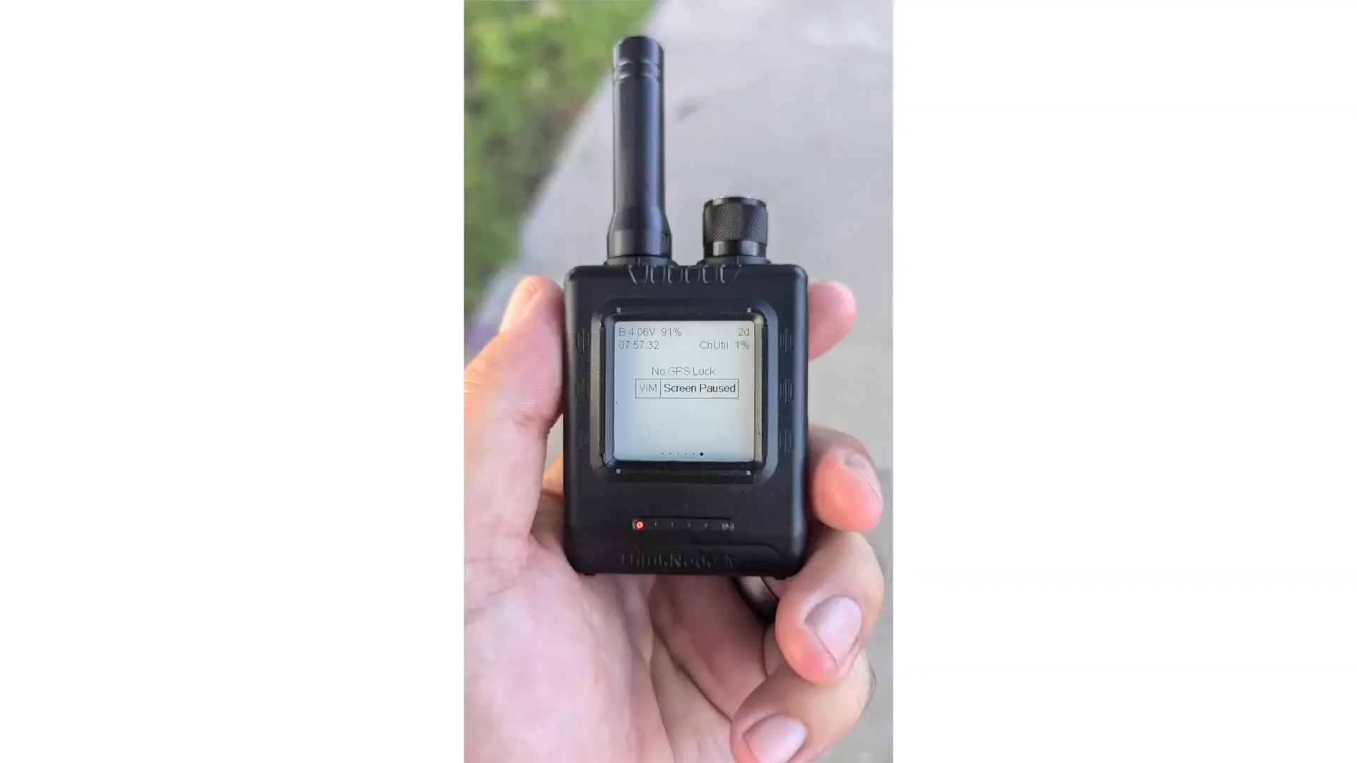

One of the more challenging aspects of the ThinkNode M1 is its GPS functionality. It uses a standard GPS module that requires a solid lock before you can rely on it. I found that if you grab the device and start moving immediately, it struggles to get a GPS fix. The best practice is to place it outside in an open area for 5-10 minutes before heading out. Once locked, the GPS performs reliably and tracks well.
Flipping the GPS switch off and on or rebooting the device helps regain a GPS lock if it’s lost during use.

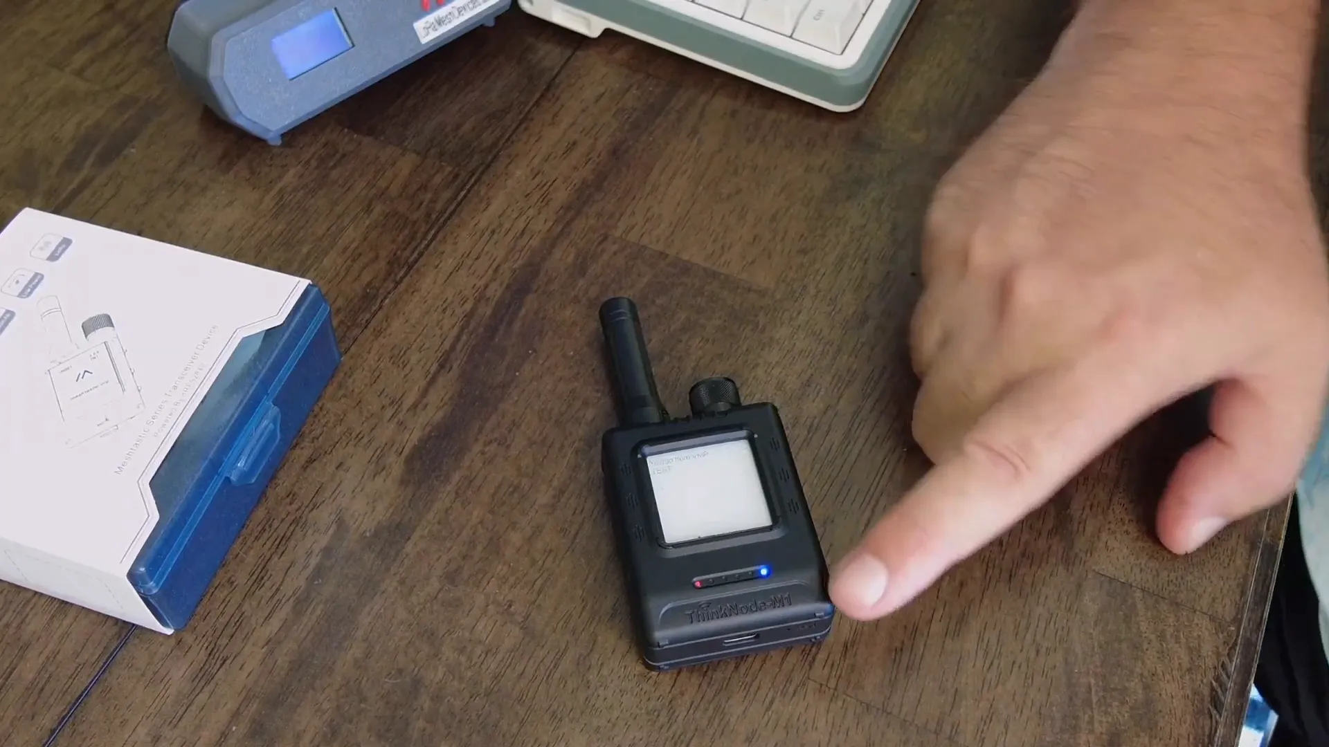

GPS status LED and physical GPS switch on ThinkNode M1

The e-paper display is a delight to use, especially with the backlight control. Double tapping the top button toggles the backlight on and off, and the rotary dial allows fine-tuning the brightness. However, the paging button to scroll through pages on the screen can be sluggish, especially when the node is busy processing data.
Additional features include an SOS mode activated by triple-clicking the function button, which triggers a beeping sound and flashes an LED—useful for emergencies or alerts.

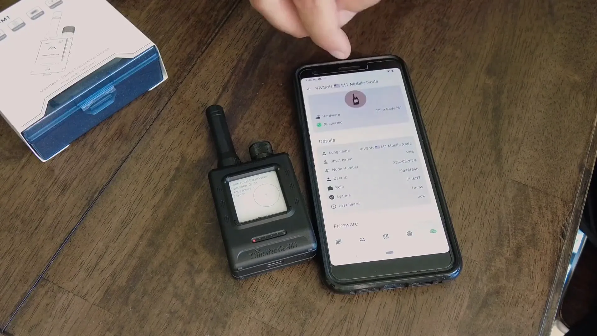

The ThinkNode M1 integrates seamlessly with the Meshtastic mobile app, just like other nodes in the ecosystem. Once connected, you can see GPS coordinates, signal strength, node metrics, and more from the app interface.
Meshtastic app showing ThinkNode M1 GPS coordinates and status

The ThinkNode M1 is equipped with a small speaker and LED indicator that enhance its notification capabilities. When the device receives a message, the LED flashes and the speaker plays a customizable ringtone using RTTTL strings configured in the Meshtastic app.
ThinkNode M1 LED flashing and speaker playing ringtone upon message reception
