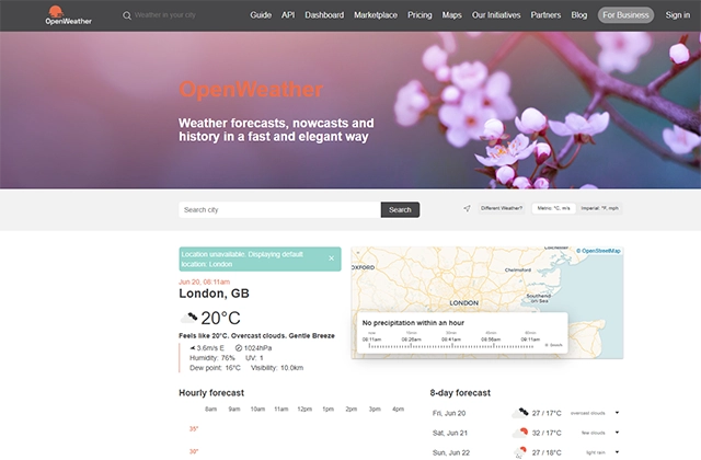

  1. Open the OpenWeatherMap website.
OpenWeatherMap Homepage

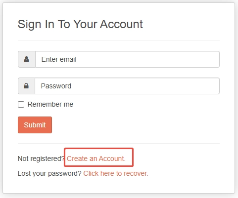

  1. Click "Sign in" at the top right corner.
  2. Click "Create an Account".
Create Account on OpenWeatherMap

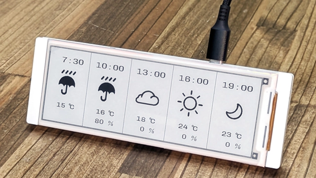

Congratulations! Your custom weather station is now up and running!
Finish Crowpanel 5.79 inch Weather Display
