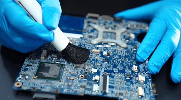

PCB Cleaning
PCB Cleaning Board

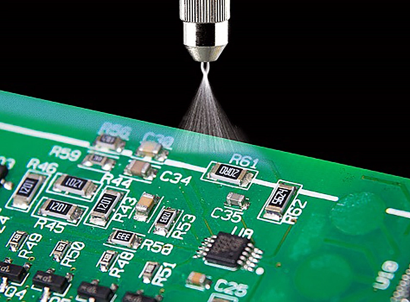

Scenario 2: Medium-Volume Production, Certain Uniformity Requirements – The Balance of Manual Spraying
Necessity Manifestation: When production volume increases and there are requirements for coating appearance and basic protective performance, the efficiency and consistency of brushing become inadequate.
Process Sophistication: Manual spraying (using a spray gun) achieves a more uniform coating and higher efficiency compared to brushing. Skilled operators can effectively cover PCBAs of various shapes. Although detailed masking is still required to protect restricted areas, it strikes a good balance between cost and effectiveness.

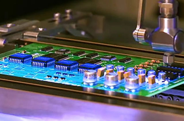

Scenario 3: High-Volume Production, High-Density Complex PCBAs, Numerous Restricted Areas – The Precision and Efficiency of Selective Automated Coating
Necessity Manifestation: PCBAs in modern consumer electronics, automotive electronics, and communication equipment are often densely populated with components, featuring numerous and irregularly shaped restricted areas such as connectors, test points, and thermal interfaces. Traditional manual masking is time-consuming, labor-intensive, and prone to errors, severely impacting production efficiency and quality.
Process Sophistication: Selective coating equipment (e.g., XYZ or multi-axis robotic systems employing precision dispensing valves) represents the pinnacle of this process ingenuity.
  • Precision: Through pre-programmed routines, the dispensing head accurately avoids restricted areas, applying coating only to areas requiring protection. Its edge definition control capability ensures clean coating boundaries.
  • Efficiency: Significantly reduces or even eliminates manual masking and de-masking steps, markedly improving production throughput.
  • Consistency: Automated operation ensures high consistency in coating thickness and coverage for every board, complying with standards like IPC-A-610E regarding coating thickness (typically 25-150 microns, varying by coating type) and coverage.
  • Material Savings: On-demand dispensing minimizes conformal coating wastage.
This "intelligent" application method perfectly addresses the protection challenges of high-density, complex PCBAs and is an inevitable choice for modern large-scale electronic manufacturing.
