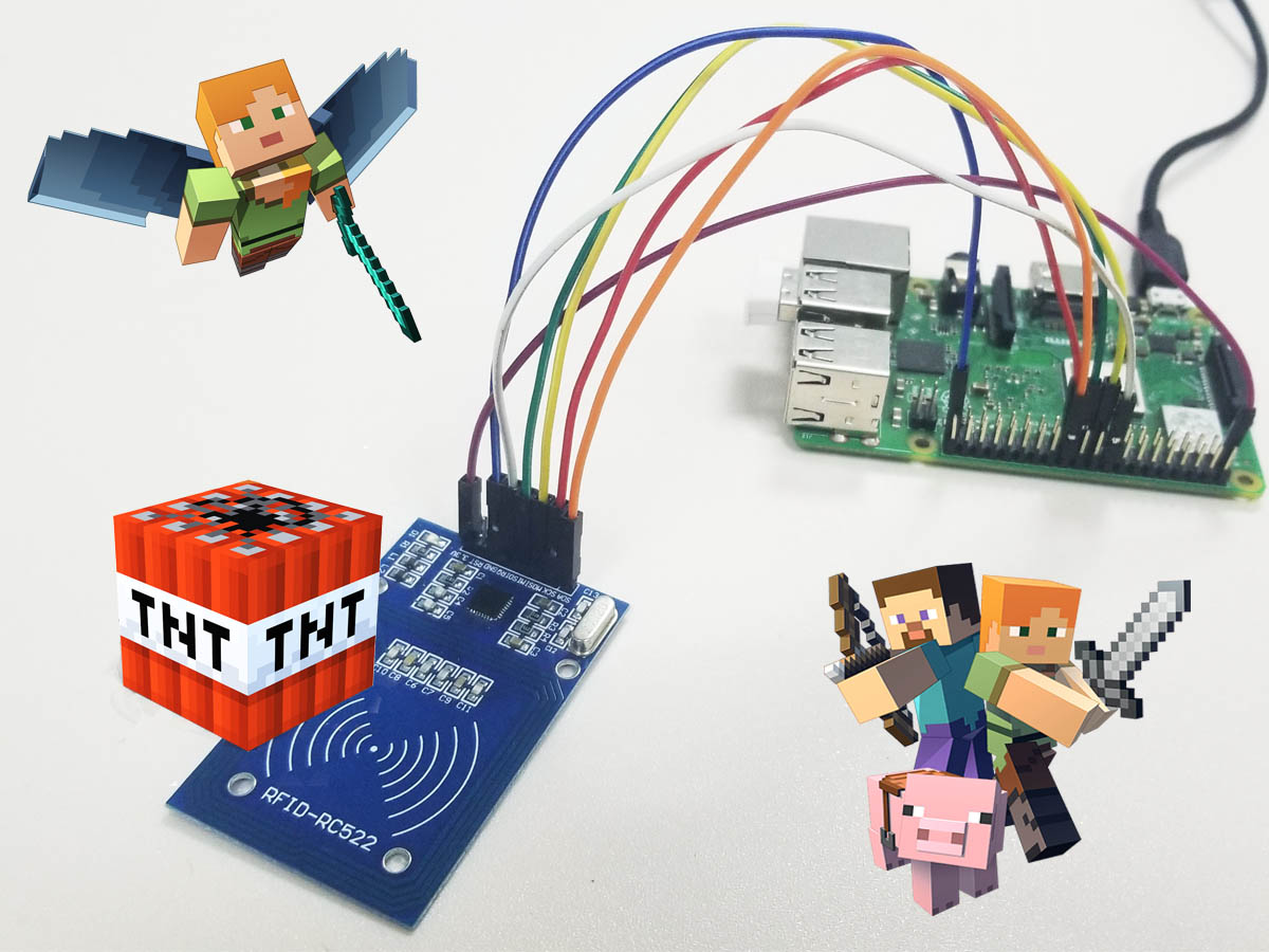

After installing the driver, make sure to connect the RFID module properly to your raspberry pi:
Check the following pins information and connect it by the by the BCM (physical pins) names, make sure you connect everything properly else the project might not work!
MISO => PIN21 (SPI_MISO)
MOSI => PIN19 (SPI_MOSI)
SCK => PIN23 (SPI_CLK)
SDA => PIN24 (CE0)
IRQ => PIN18 (GPIO24)
GND => PIN6 (GND)
3.3V => PIN1 (3.3v)
RST => PIN39 (GND)
After you successfully connected and installed the driver it’s time to test it!
From inside of the CrowPi folder, run the following command: “sudo python RFID_Read.py” now try to touch using one of the NFC tags on top of the RC-522 module, it should be able to read it!
If everything is fine, you can now follow the Minecraft tutorial and lessons and all the functionalities now will work for you exactly as they work on the CrowPi!
