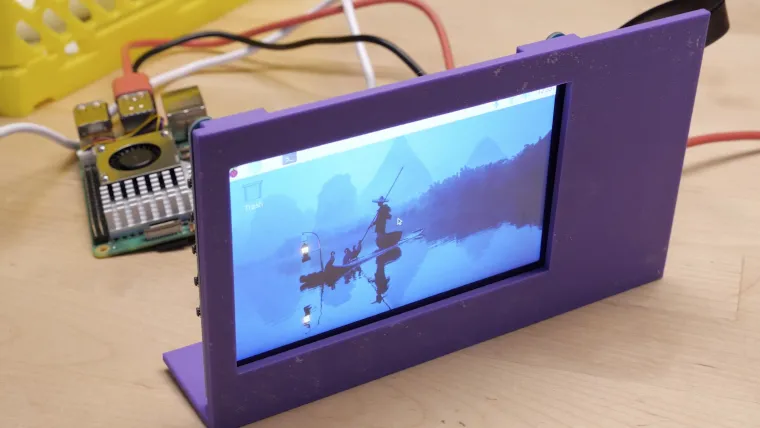

Then I created a first draft of the 3D printed enclosure, which has to fit the screen and speaker next to each other.

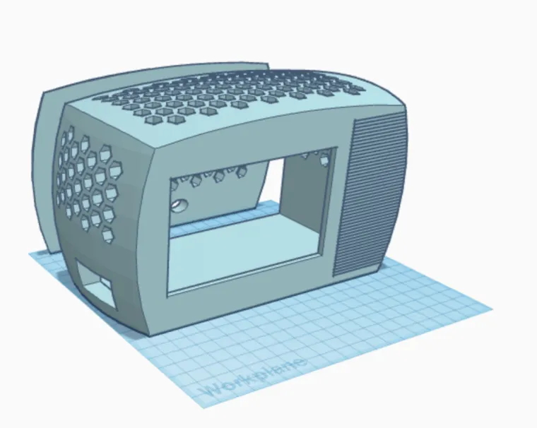

To develop the enclosure a bit further, I played around with speaker grille patterns and settled on this segmented pattern with circles coming partway through. I think it’s giving vintage vibes and this marble-effect PLA is super classy. I test fit the components inside.
I used an HDMI cable that has smaller connectors than usual so it didn’t add bulk to the size of the enclosure.
Once I was confident my basic shape would hold and fit all my components, I started playing around with the exterior shape. Also, I wanted to add some ventilation holes because the Raspberry Pi runs pretty hot. I used the honeycomb shape generator in Tinkercad to make grids of holes that are too small for my cat to reach through. You can find my 3D file on Tinkercad.
I printed this final version of the enclosure in sparkly black PLA on my smooth build plate so the front of the TV would be super flat.
Then I test fit the components once again, holding them in place with tape so I could test it with Benchley to see if any changes were needed.

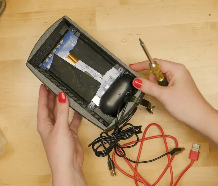

I discovered that the touch screen was a bit of a problem, as the cats would paw the screen and pause the video. So I replaced the screen’s USB cable with a charge-only cable, disabling the data connection for the touch screen.
Then I installed the screen more permanently with some screws and the speaker and Pi with hot glue. You can set up your hot glue fast if you hit it with a little canned air.
