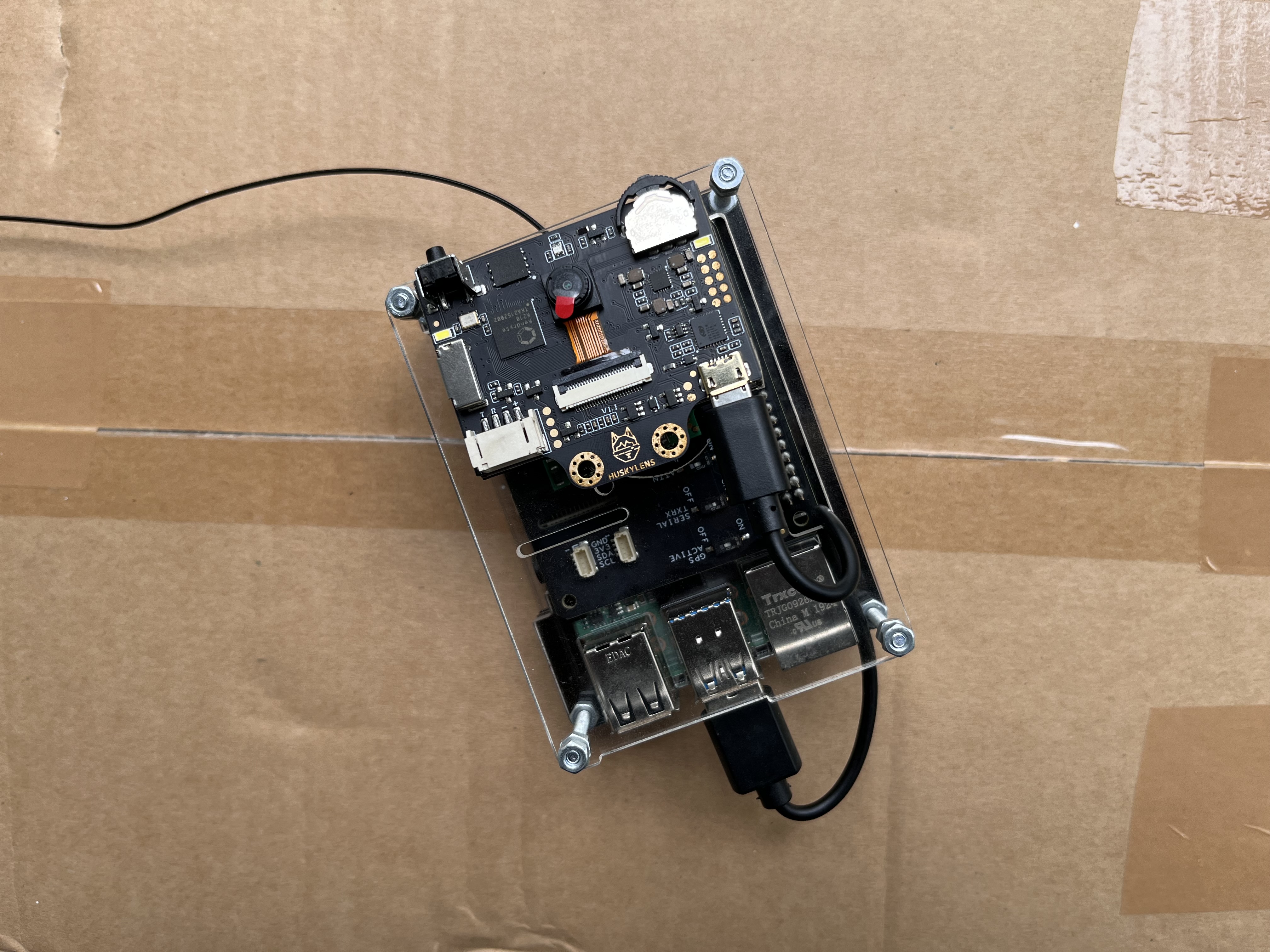

The Notecarrier can be attached to the Raspberry through its headers making it a compact device which can be plugged anywhere.

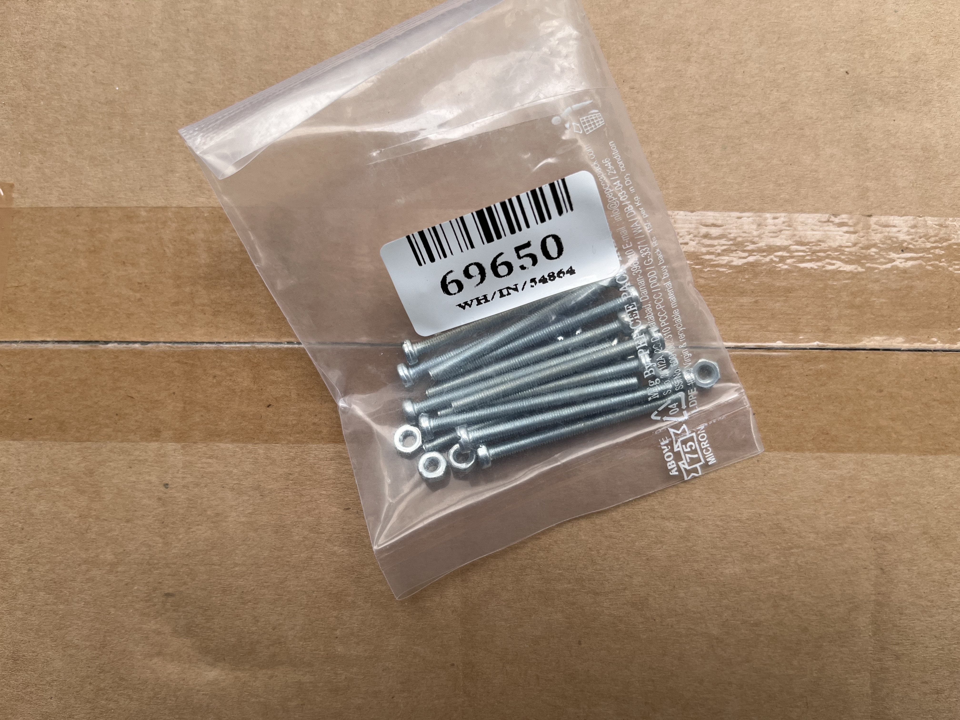

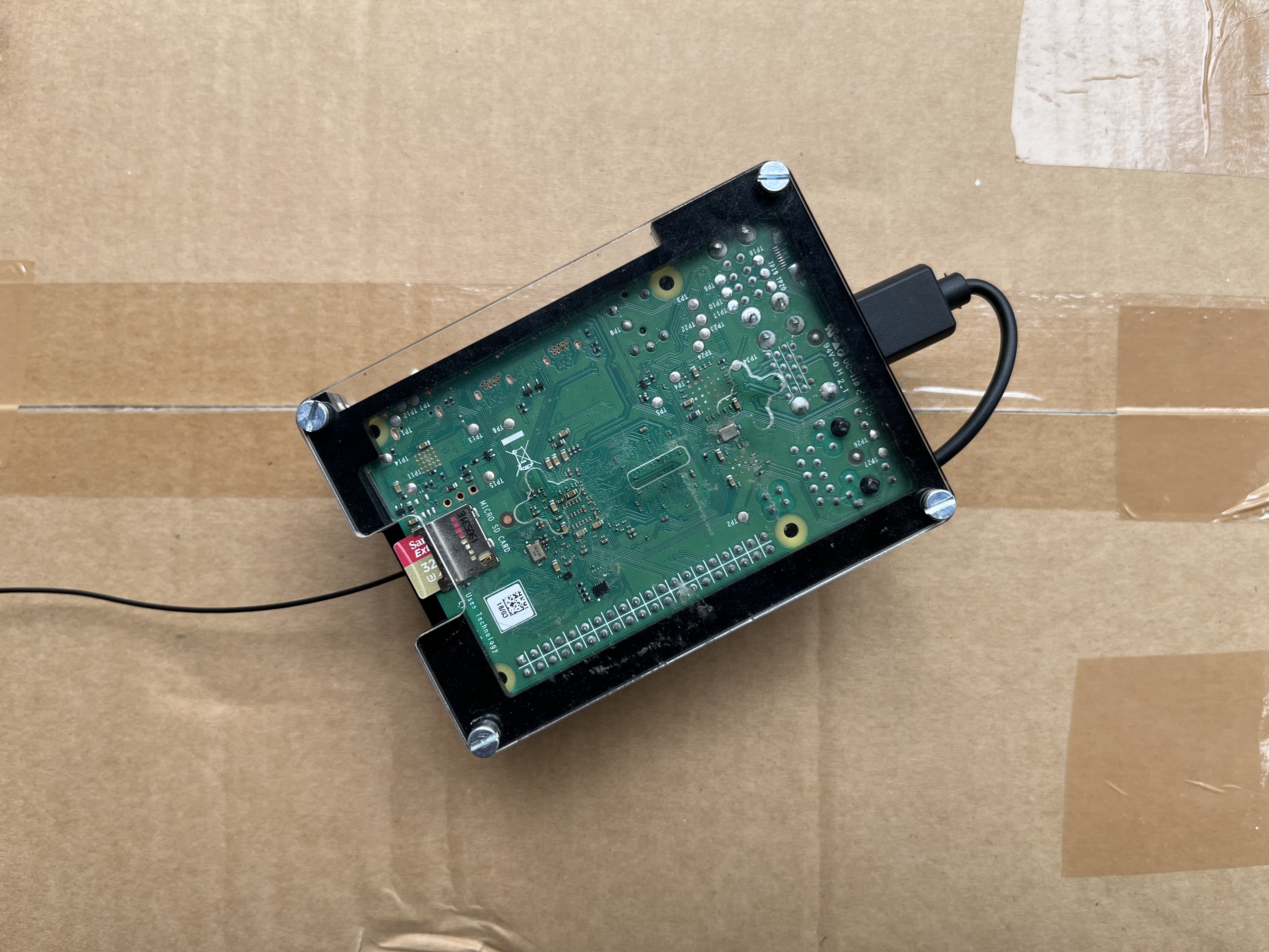

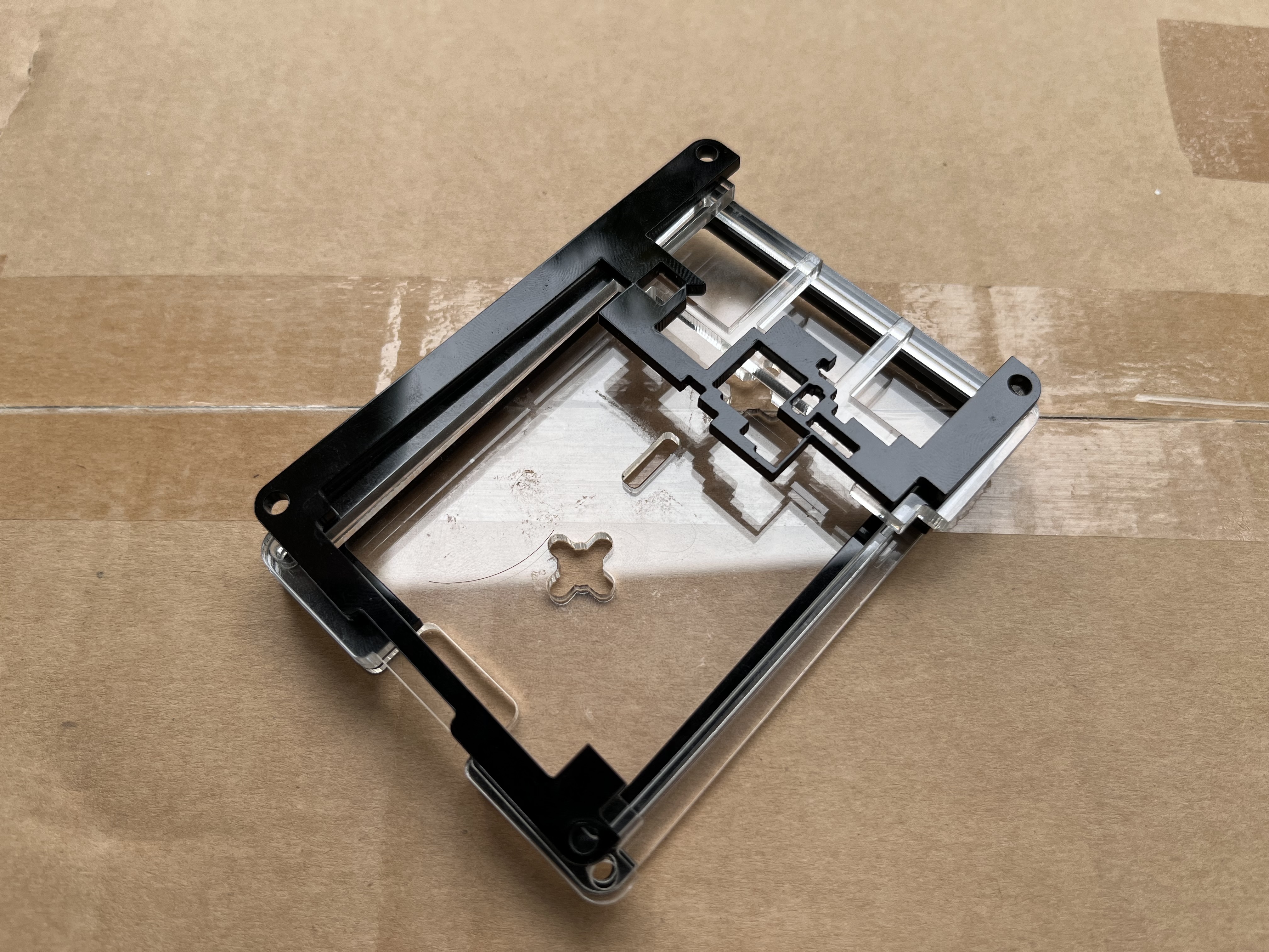

To enclose the device I have used 6 layers of 3mm acrylic pieces which are made stronger using M3 Nuts and bolts. The Husky lens is connected to the Raspberry Pi via a smaller micro USB cable.
