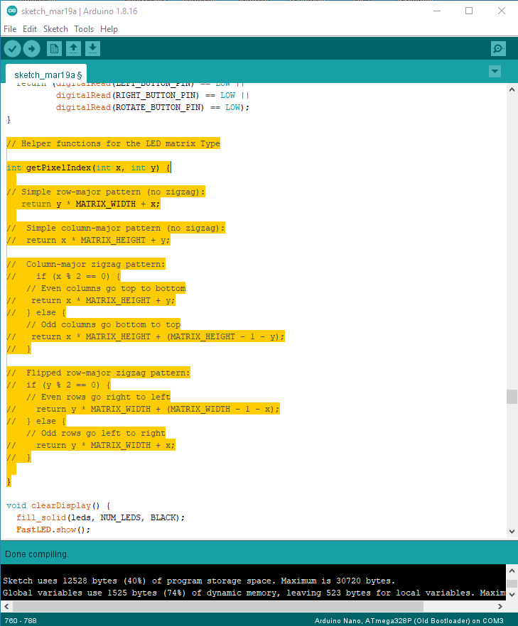

 All components used are standard except the LED matrix which can be found on the market in several versions. They all differ in the way and order of connecting the LEDs in them (zigzag horizontally, then vertically, snake connection, etc.). It is obvious that we cannot make hardware changes, so for this purpose I created a part of the code where any version of these matrices can be selected.
We need to select one by one of these 4 connection methods until we get the correct image on the matrix display.

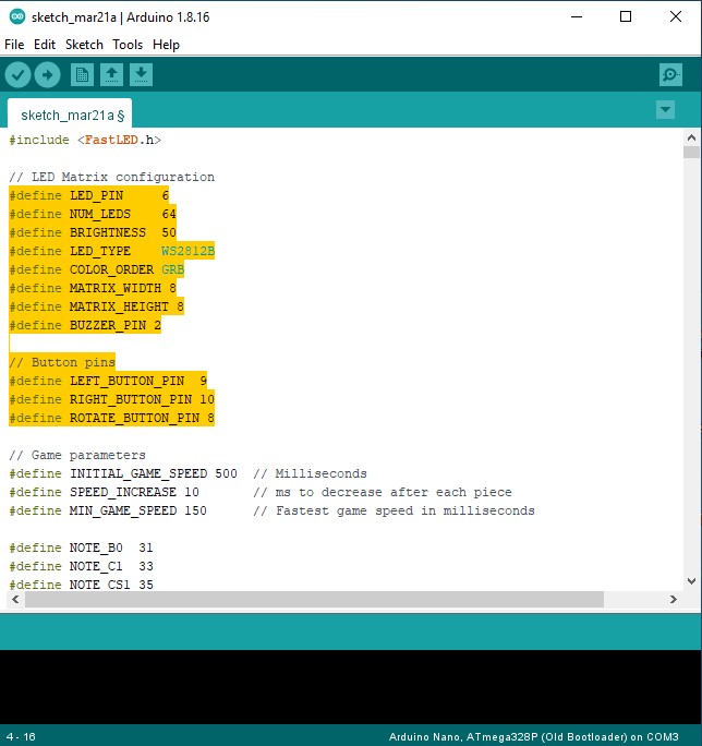

  A few words about the code, as you can see, it is designed in a way that allows you to easily change almost all the parameters of the game, starting from the intensity of the LEDs, changing the colors, the sounds, and probably the most important parameter, which is the initial speed of the tetromino, the degree of acceleration during the game, and the maximum speed limit.

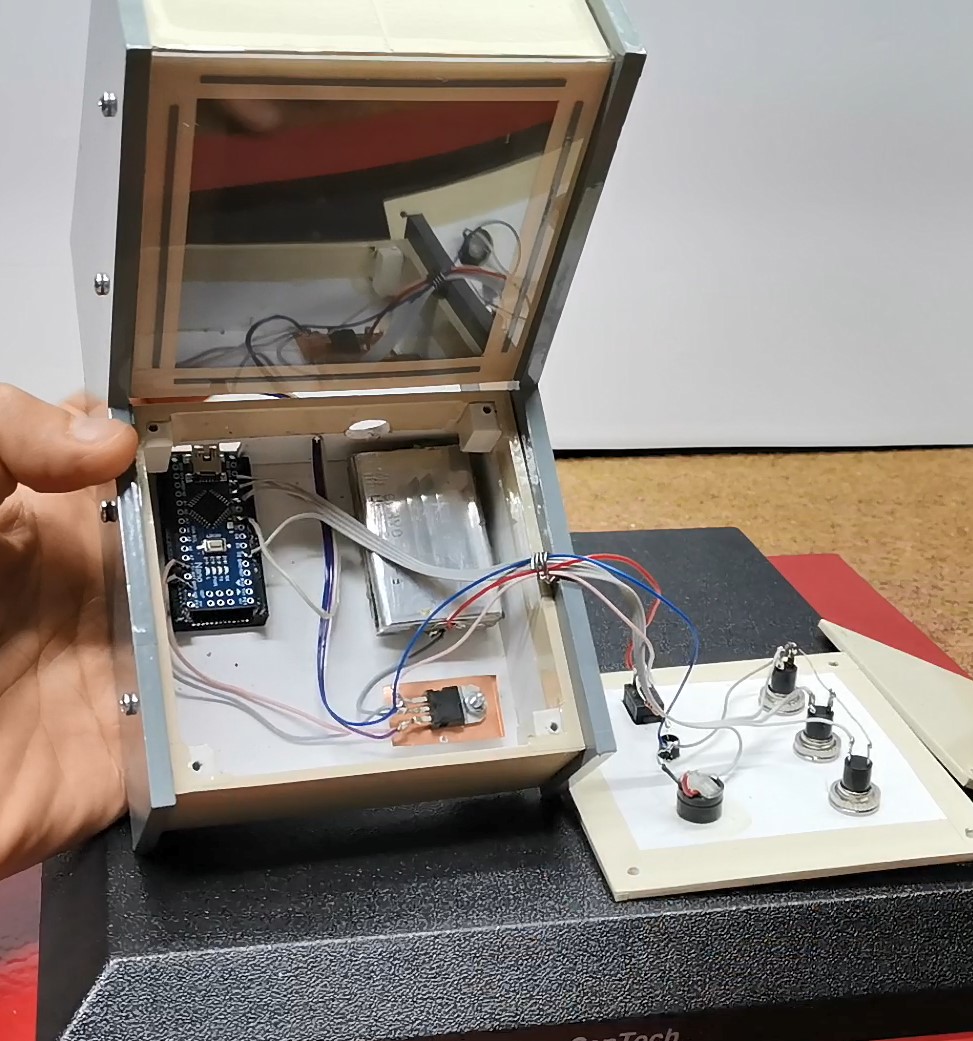

  As for the case, it is from one of my previous projects and is made of 5mm thick PVC material and has the shape of a classic arcade game console where this game was most often played many years ago. It is covered with self-adhesive wallpaper.
