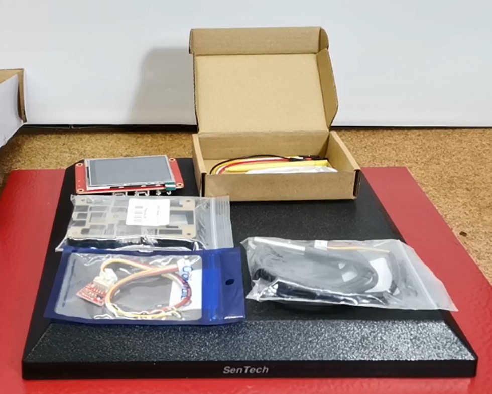

  These days I received a shipment from Elecrow that contains several components that I ordered a week ago. My shipment arrived unexpectedly quickly, and is well packed and protected in a branded box.  It consists of Crow Panel 2.8" HMI 320x240 display SPI TFT LCD Touch screen compatible with Arduino, LVGL Library, and ESP microcontroller onboard with all necessary cables and touch pen.

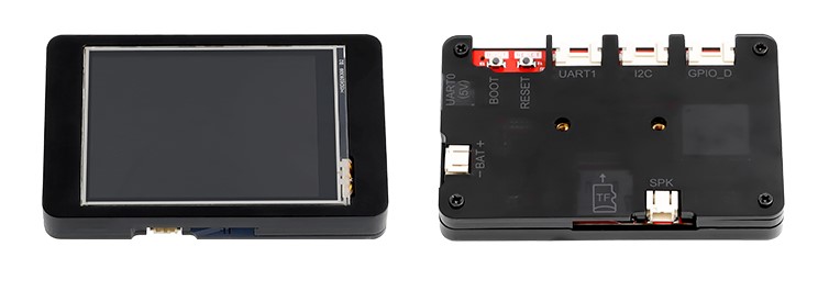

These are laser machined housing parts for this ESP32 Display, then a waterproof temperature sensor and a BME 280 sensor board.  The sensors contain appropriate cables that are compatible with the Display board, so that when making a project there is no need for soldering, and there is also no possibility of wrong connection. When the board is turned on for the first time, a demo application appears on the display to demonstrate some of the capabilities of this small device. After assembling the case, the display looks tidy and is protected from damage.

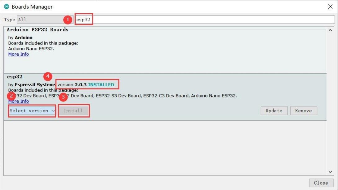

  Now click "Tool-->Board-->Board Manager", and search for "esp32". It is recommended to
install version 2.0.3 ESP32 package.

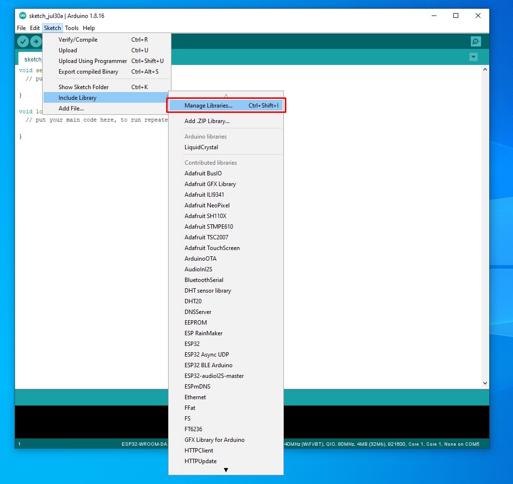

Next we go to Sketch-> Include Library-> Manage Libraries -> TFT_eSPI -> Install

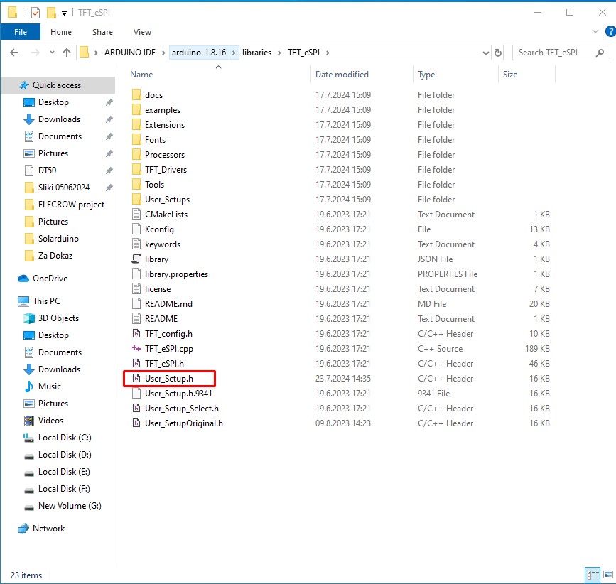

  After that "User_Setup.h" in "" library folder needs to be modified according to their screen drive. For this purpose, we copy the "User-Setup.h" file given below, to the "TFT_eSPI" library folder, replacing the original file.

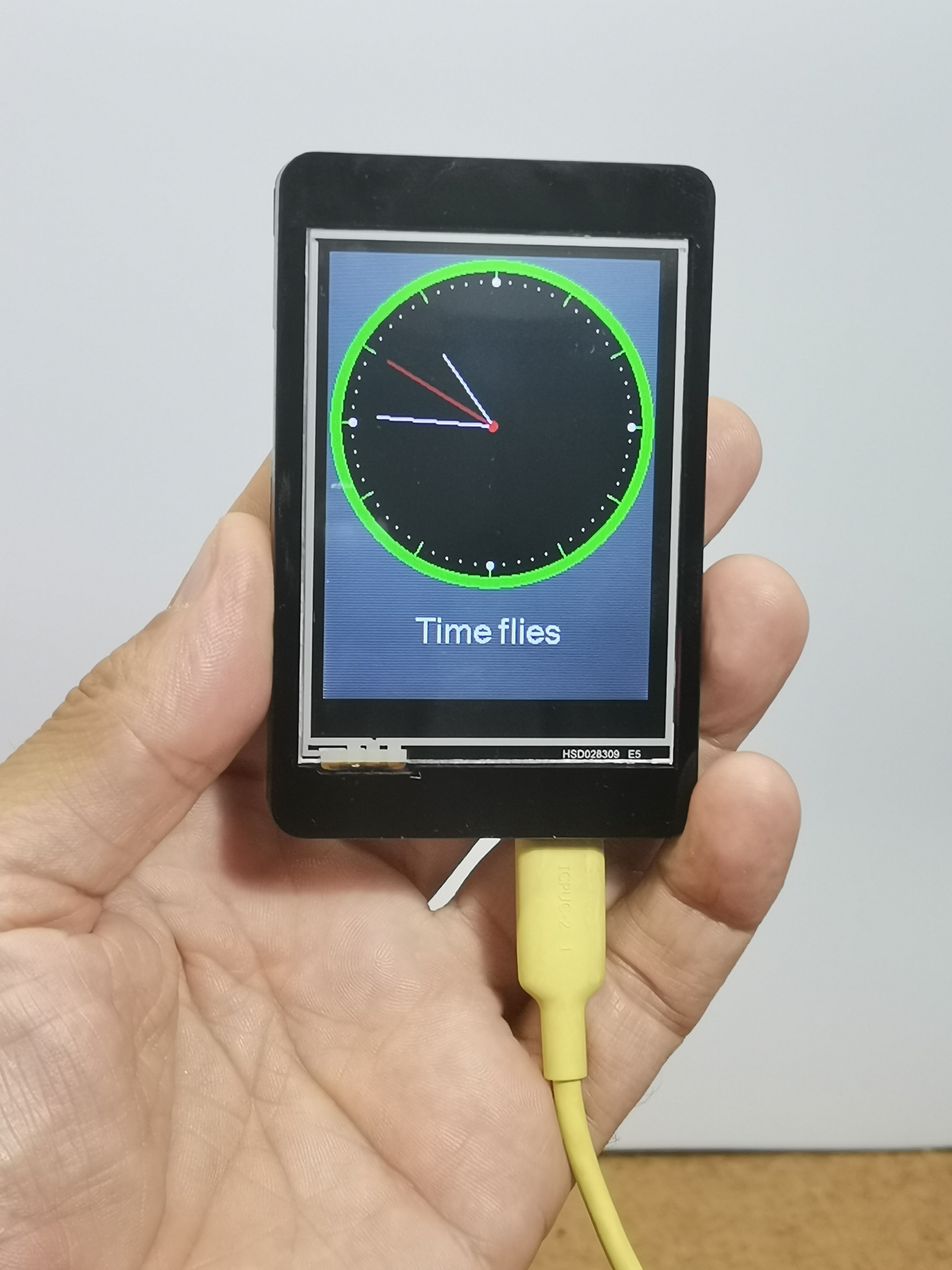

  Since TFT_eSPI library is customized for this display module, we can now successfully upload code from some previous projects that use it. Of course, a huge advantage is that there is no need for any soldering, especially if we use Elecrow sensors and modules, and the display together with the microcontroller is small, compact, and housed in a nice case. First I will test the device with test examples that are provided in the library itself. For this purpose I go to Examples - TFT_eSPI - and select an example. Then select the appropriate port and upload the code.

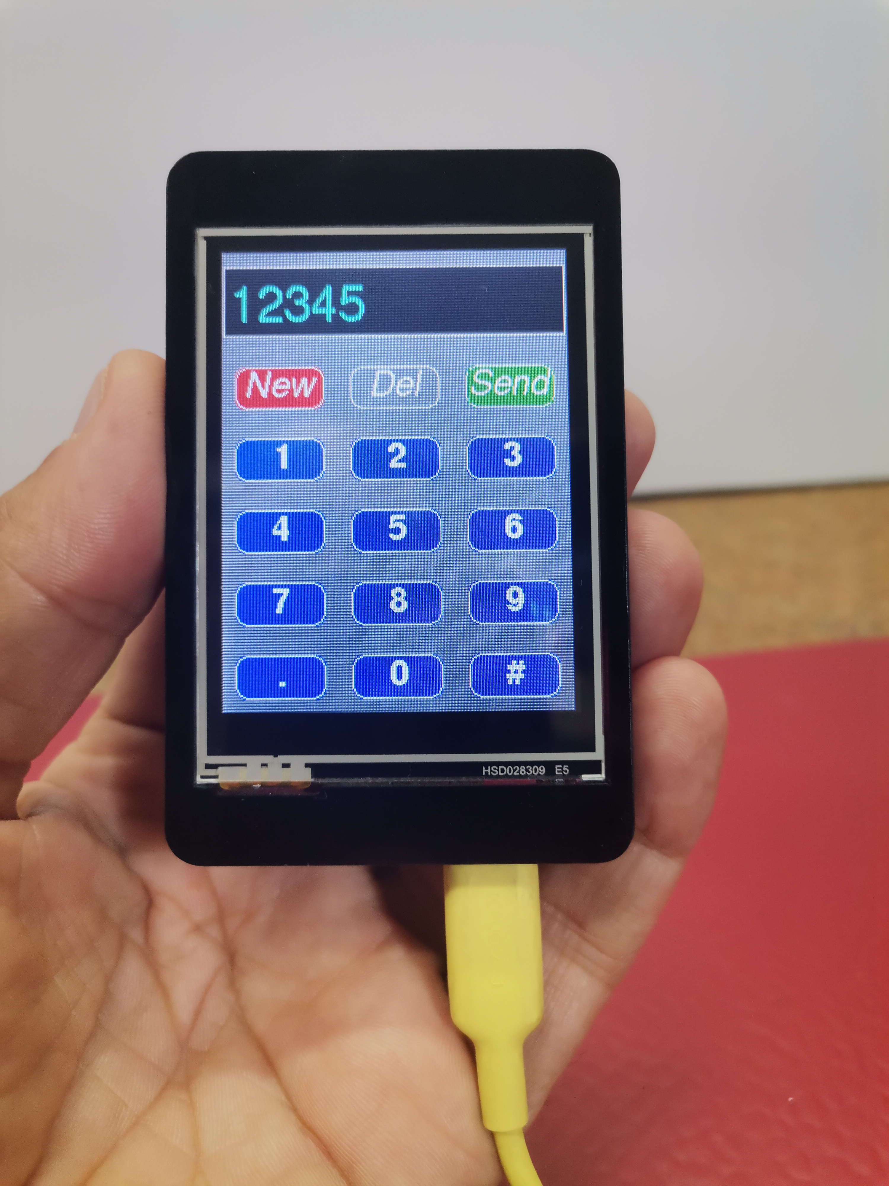

 and now, another example

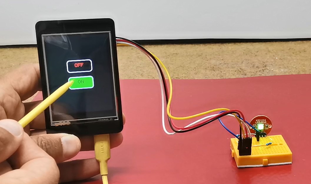

  As I mentioned above in the text, next I will describe to you a simple example of how to control an LED. For this purpose, on the two input-output pins (IO25 and IO32) of the display I will connect two colors from the RGB LED module through 220 Ohm current limiting resistors. To simplify the code, we need to install the TFT_eWidget library which contains ready-made buttons, gauges or graphs, and also tft_setup library.
   Here is what the finished project looks like with the uploaded code, which you can download from the given link. Pressing the buttons turns the LEDs of the corresponding color on and off.
 This is an example where we use ports 25 and 32 as outputs and with them we can control certain processes.

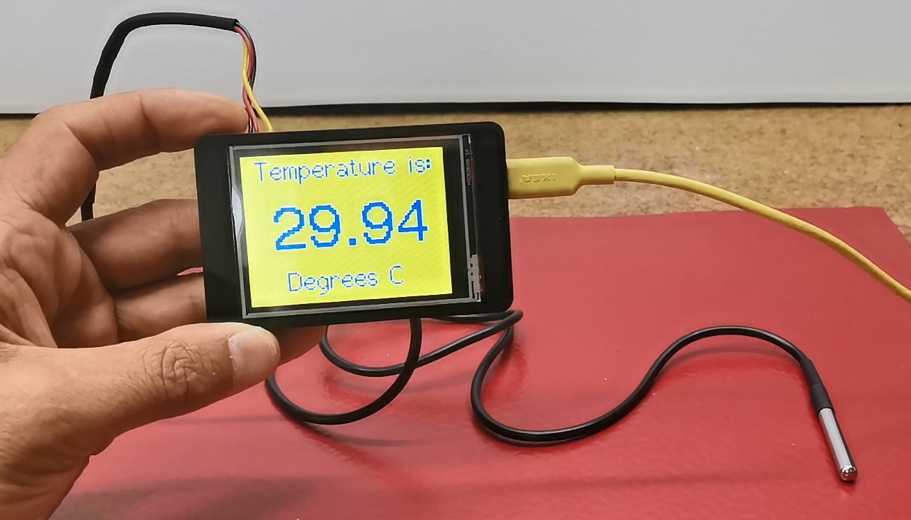

 Next I will present you another simple example where one of these ports (25) is used as an input, and on it we can read the information generated by the temperature sensor. The display shows the current temperature in degrees Celsius.
 You can also download the code and schematic for this project at the link given at the end of the project.
