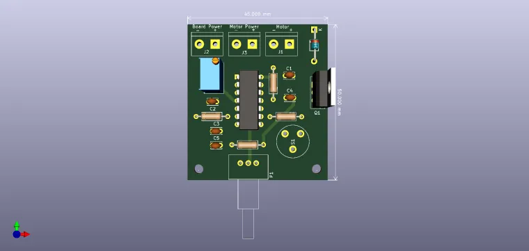

Circuit presentation
With this type of circuit you can control the speed of a
motor from 0 to 100%, keeping the torque constant. In principle
the first astable in the NE556 circuit generates a signal with
the frequency of 400Hz which applies to a monostable whose
period is determined by the value of the potentiometer R9.
From R8 the excess period, called CUTOFF, is fine-tuned.
Both N-channel and transistor transistors can be used
channel P, except that in this case the load is between
source and mass of force (masses do not couple to each other) and
the drain is connected to + 12V where the extra voltage is also connected to
force.

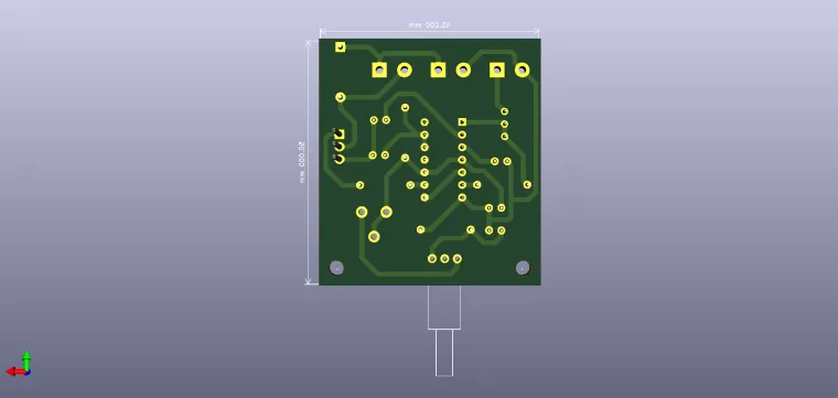

Schematic and Layout
