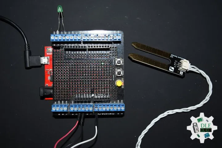

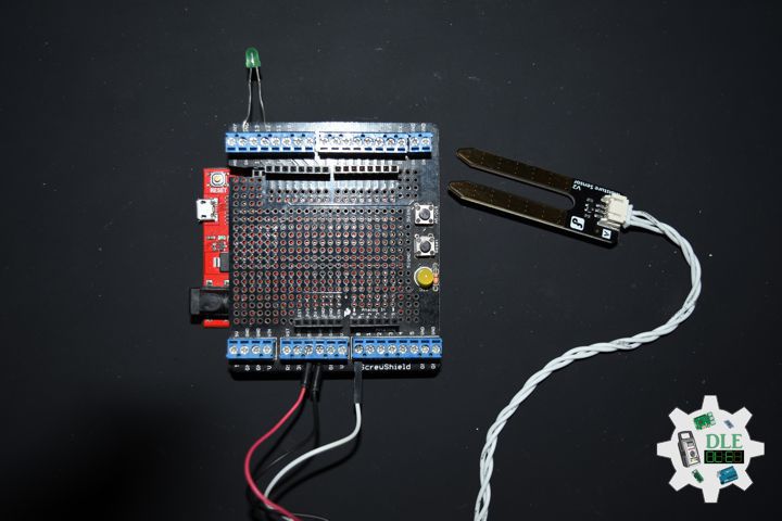

DL2411Mk03
1 x SparkFun RedBoard Qwiic
1 x Gravity: Analog Soil Moisture Sensor
2 x LED
1 x ProtoScrewShield
1 x USB Battery Pack
1 x USB Micro-B Cable

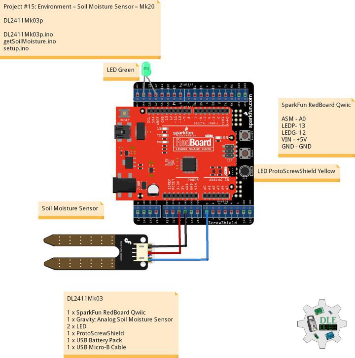

ASM - A0
LEDP- 13
LEDG- 12
VIN - +5V
GND - GND
DL2411Mk03p
DL2411Mk03p.ino
getSoilMoisture.ino
setup.ino
