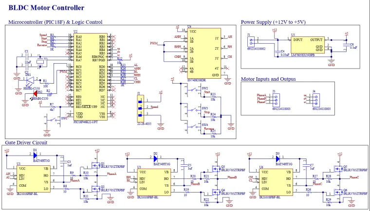

This project implements a 3-phase BLDC motor controller using Hall sensor-based 6-step commutation with PWM speed control. The system uses a PIC18F46K22 microcontroller and IR2101 gate drivers for driving the MOSFET bridge.

  • Microcontroller: PIC18F46K22
  • Gate Driver: IR2101
  • MOSFETs: IRF540N or IRFZ44N
  • Sensors: Hall sensors for rotor position

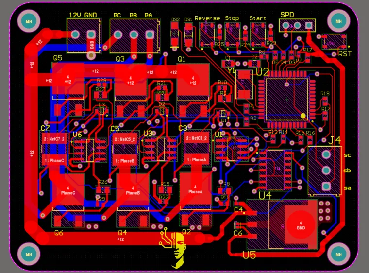

  • PCB: 4-layer (2 signal, 2 GND planes)
  • Simulation: Proteus for pre-validation
  • CAD: Altium Designer for schematic and layout
