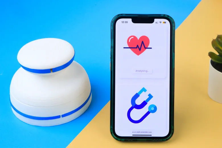

Companion App
We have designed a companion app for the AI stethoscope. The companion app uses MQTT to communicate between the device and the app. Currently, we have 2 modes - Analysis mode in which the heartbeat is analyzed by AI to find any potential diseases, and Stream mode in which the heartbeat sound is streamed to the doctor using the dashboard.
The dashboard is designed using HTML, CSS, and JS and uses the MQTT JS library to give MQTT capabilities to the dashboard.
Final Product
