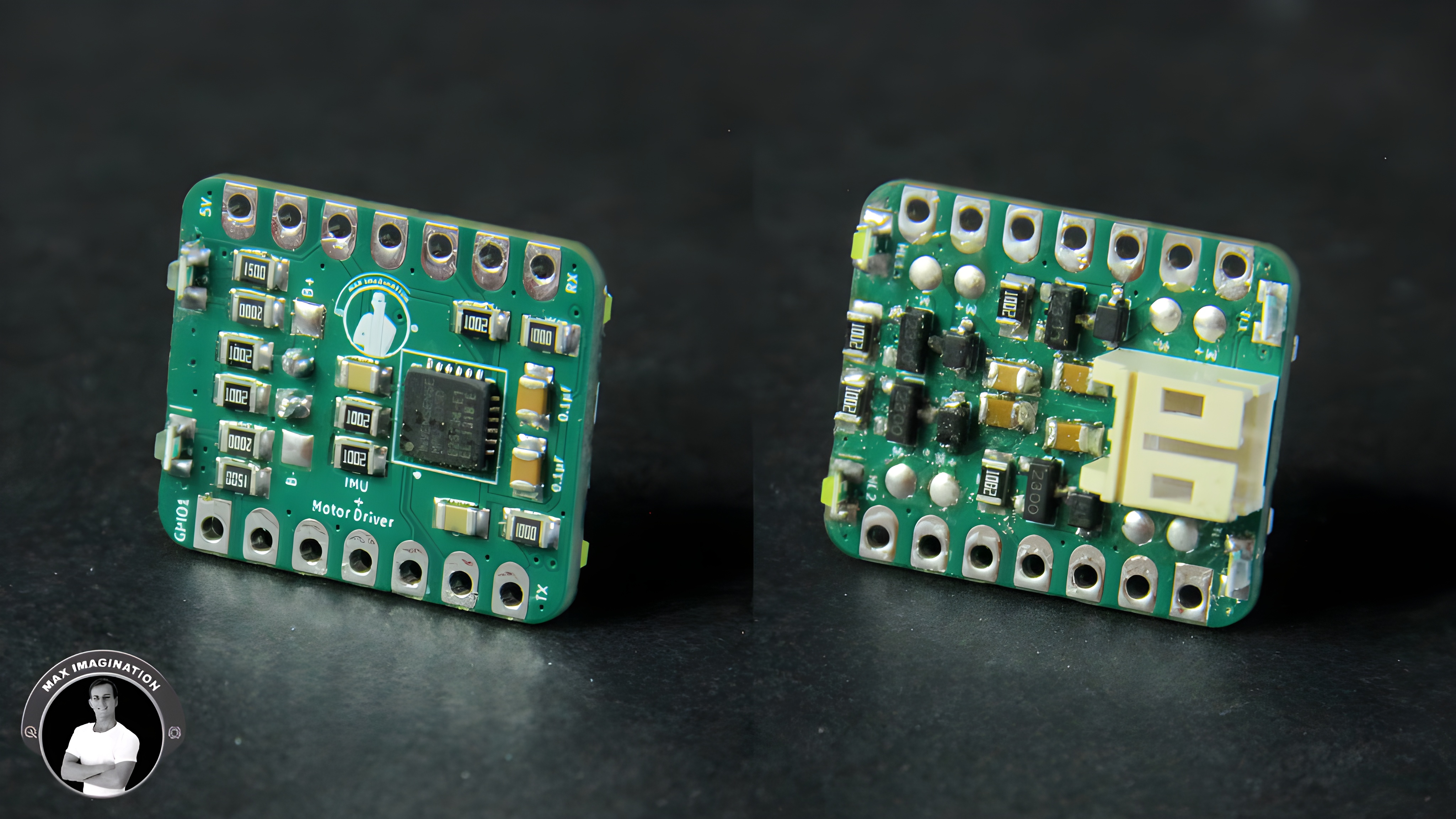

5. Designing & Ordering the PCB
Using Flux PCB design software, I integrated the motion sensor, motor drivers, and LED indicators into a compact 4-layer PCB.
Upload the Gerber file to JLCPCB and select your board specs:
Set the layers to 4, choose your desired quantity, select 1.2mm thickness, and pick a board color - green is the fastest and most cost-effective option. Don’t forget to select "Remove Mark", and that’s it! Add it to your cart, choose shipping and payment options, and place your order - it’s as simple as online shopping.
JLCPCB offers high-quality PCBs as low as $2! https://jlcpcb.com/?from=MaxImagination

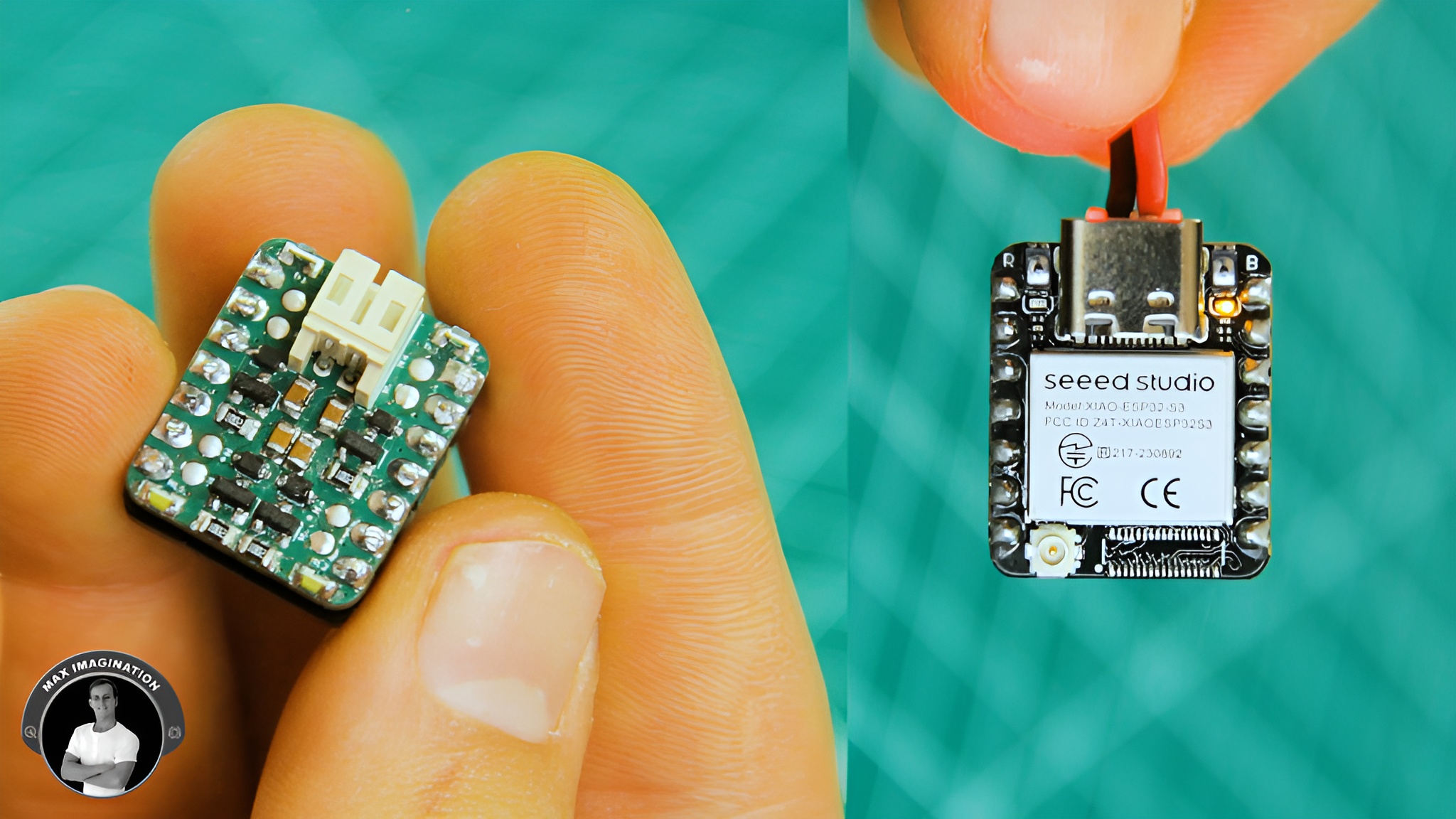

6. PCB Assembly - Soldering Components
Using an SMD stencil ordered along with the PCBs, apply solder paste to one side of the PCB, then place resistors, capacitors, indicator LEDs, and the MPU6050 IMU for the top side which is reflow soldered using a hot plate. For the motor driver side, add some solder paste to those pads, hand-solder the components such as the resistors, diodes, capacitors, MOSFETs, and JST battery connector.
When it comes to placing the MPU6050 motion tracking IC, it’s crucial you align the dot on the chip with the dot on the PCB for correct orientation. The chip and other SMD components can be bought in tape reels or salvaged from modules and other boards.
With the IMU or Inertial Measurement Unit + motor driver module complete, it weighs only one gram (1g)!
7. Installing the ESP32 Flight Controller
Now that the IMU/motor driver module is assembled, it’s time to give the quadcopter its brain.
Seeed Studio’s XIAO ESP32-S3: https://www.seeedstudio.com/XIAO-ESP32S3-p-5627.html?utm_source=youtube&utm_medium=MaxImagination&utm_campaign=ESP32drone
Mount the microcontroller onto the custom module with orientation in mind using short wires to bridge battery lines and pin headers for connecting the board’s pins.
This tiny yet powerful board handles low-latency (7-25ms), WiFi-based control and direct battery charging via USB-C, making it perfect for micro drones.

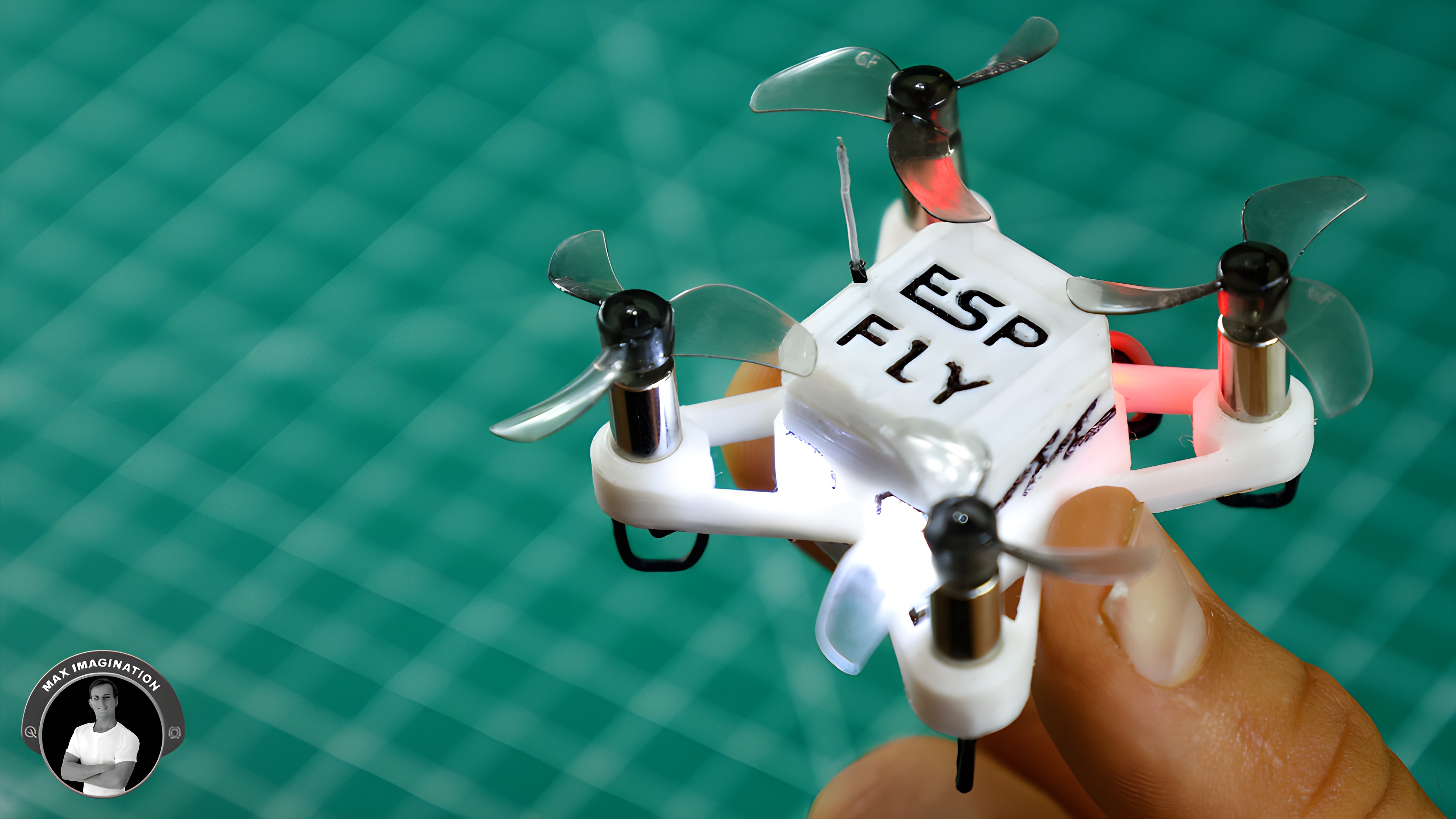

8. Main Assembly
To make it stand out, you may color the debossed areas with a pen such as the drone’s name, decorative details, and branding.
Secure the flight controller inside the frame, add a zip-tie battery strap, and insert the 6x15mm coreless motors into the arms. When you buy these motors, check you get two clockwise (CW) and two counter-clockwise (CCW) motors which can be told apart by wire color. This is crucial because each motor needs to rotate in a specific direction, requiring some to have reversed brushes to ensure proper operation and minimize wear.
Route and solder the motor wires, ensuring the correct CW and CCW motor order:
  • Front Right = CCW (Black & White wires)
  • Rear Right = CW (Blue & Red wires)
  • Rear Left = CCW (Black & White wires)
  • Front Left = CW (Blue & Red wires)
Use a tiny amount of superglue to fix the motors in place.

10. Installing Propellers & Battery
Use GEMFAN tri-blade props for 0.8mm shafts, ensuring the correct spin direction. Any other 30mm Bi, Tri, Quad, or more bladed propellers with a 0.8mm shaft diameter will work.
The motors shall spin the props inward in relation to the front and rear of the drone and be able to produce downward thrust. Be careful when attaching these so that the rotor does not pop through the motor bottom part.
Replacing these propellers can be easily done with the included prop-removal tool.
To easily differentiate the drone’s front and rear side when in the air, I suggest using different colored props for the rear motors.
For the battery, a 150-450mAh (Recommended) LiPo with at least 25C discharge rate will work. I am using a 250mAh LiPo with a 30C discharge rate - it’s the perfect size. Charging can be done via USB-C or a multi-charger.

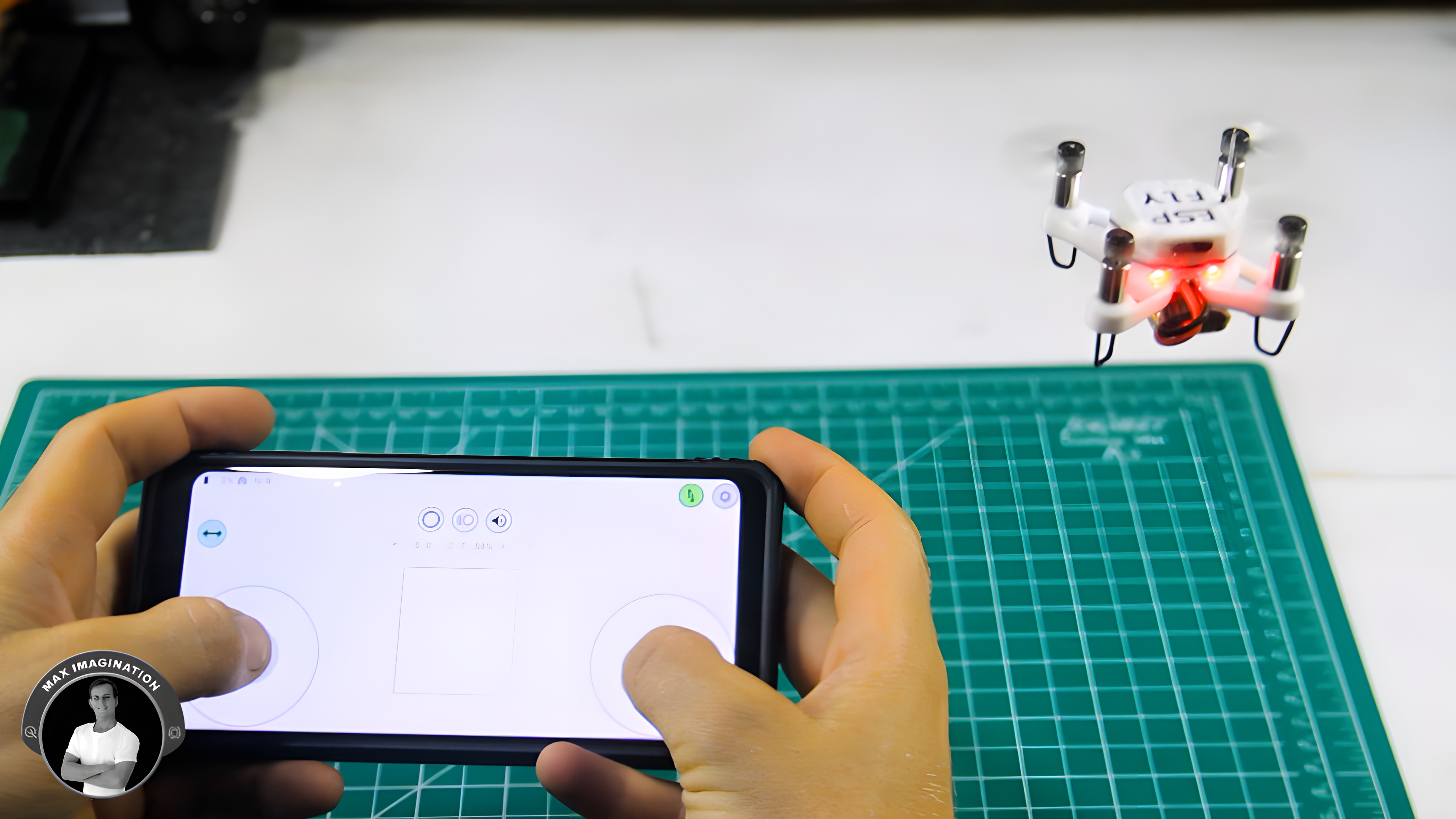

12. Installing App & Configuring Drone Controls
To control the drone, you’ll use your phone. Follow these steps:
  1. Download the ESP-Drone app:
  • Power on the drone and place it on a flat surface for calibration (motors will briefly spin to confirm success).
  • On your phone, go to WiFi settings and connect to the drone’s access point (Password: 12345678).
  • Open the app and tap the connect button - the drone’s green LED should light up, confirming a successful connection.
  • Optimizing Flight Controls:
    Before flying, tweak these settings in the app for better stability and control:
    • Adjust joystick mode, Pitch/Roll trim to stabilize flight.
    • Enable Advanced Mode for increased angles and thrust values.
    • Select control type: Use either on-screen joysticks or tilt-to-control.
    • Customize joystick size for comfort.
    • Keep the Yaw Lock button enabled to maintain full maneuverability.
    Mastering Drone Controls:
    If you're new to flying drones, here’s how it works:
    • Left joystick (Throttle & Yaw): Move up to increase power, left/right to rotate.
    • Right joystick (Pitch & Roll): Move in any direction - forward, backward, left, or right.
    Once set up, you’re ready to fly the ESP-FLY!

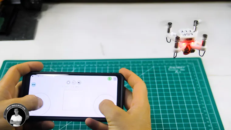

    13. Flight Test & Performance
    Throttle up and get airborne! The ESP-FLY has a 2.7:1 thrust-to-weight ratio (68g over 25g), enabling smooth, stable flight even in moderate wind conditions and lasts 5 ½ minutes in the air with a 250mAh battery.
    I took mine up to 50 meters before losing sight - so the range is more than enough!
    Another element complimenting its performance is its weight of 18g alone and 25g (grams) with the battery, the ESP-FLY is lighter than my 2024 Mini Arduino FPV drone. Its thrust-to-weight ratio ensures agile flight, while WiFi control removes the need for a dedicated transmitter like on my Arduino drone.

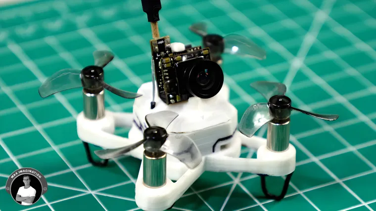

    14. Adding an FPV Camera
    For immersive FPV flying, install a WT07 3g micro FPV camera with the extra 3D-printed camera mount cover. Wire it directly to the battery connector at the bottom of the board, then bind it to FPV goggles using an auto-search. The 100m+ video range makes it perfect for indoor and outdoor flights!

    • FPV Camera: Add a WT07 micro FPV camera for first-person view flying or OV2640-style camera connected to microcontroller (when firmware gets an update to support one).
    • Larger Battery: Upgrade to a higher capacity 300-450mAh LiPo for longer flight times.
    • Improved Antenna: Swap out the short, modified WiFi antenna for a high-gain external antenna to extend control range.
    • Custom Tuning: Adjust flight parameters in the Crazyflie Client for better handling.
    • Alternative Motors & Propellers: Experiment with different coreless motors and prop sizes to optimize performance.
    • RGB LEDs: Add addressable LEDs for custom lighting effects during flight.
    All of these modifications can be implemented within the existing firmware, making the ESP-FLY even more capable.
