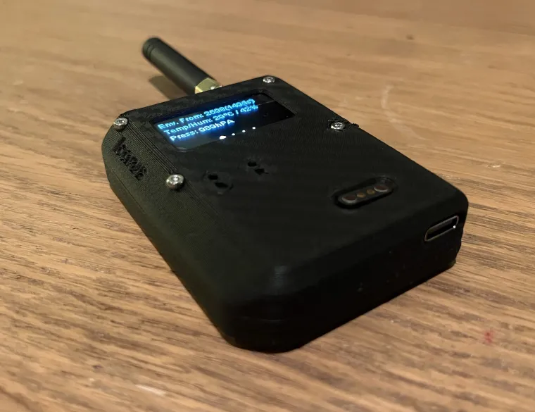

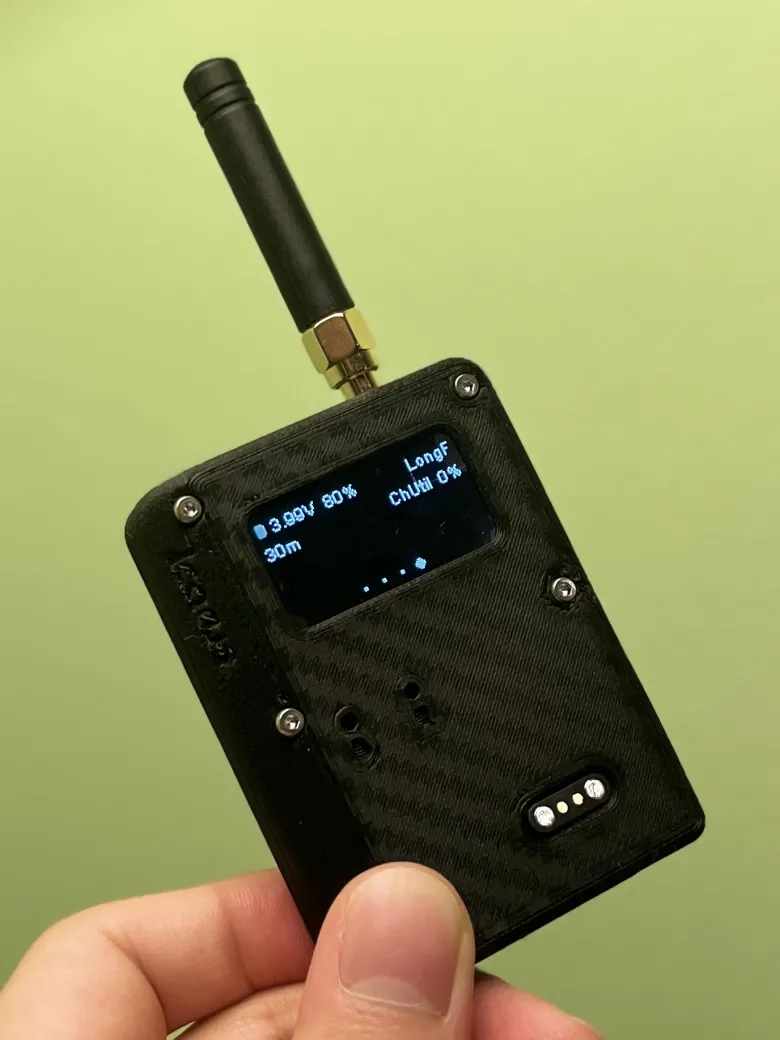

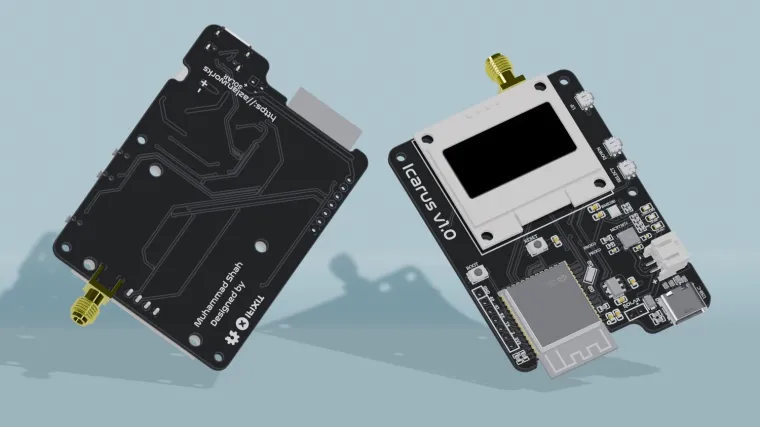

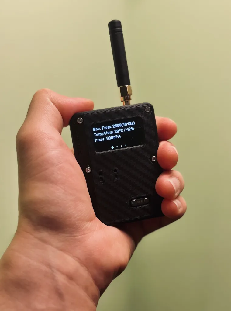

This project aims to produce a fully assembled Meshtastic node based on the ESP32-S3 and RA-01SH, both of which are avaliable for assembly by JLCPCB. The only components to be bought outside are the antenna and LiPo battery. The PCB will include battery charging and SMA connector.

Board Features:
- ESP32-S3 N8R8 MCU (Bluetooth and Wi-Fi)
- MCP78731 Battery Charging, Load sharing and Battery protection
- BME280 Environment sensor (temperature, humidity and barometric pressure)
- RA-01SH LoRa module with SMA connector and 868mHz antenna
- SSD106 1.3" OLED
- Up, Down and Select buttons + BOOT and RESET
- USB-C
- Additional exposed GPIO for expansion e.g. GPS module.
Version 2:
- Replaces MCP73871 for BQ24074
- Adds on/off switch whilst allowing charging when off.
Schematic and Layout
  • OSHWLab
    https://oshwlab.com/azlan777/icarus-v1
    View
  • Version 2
    https://oshwlab.com/azlan777/icarus-v2
    View
