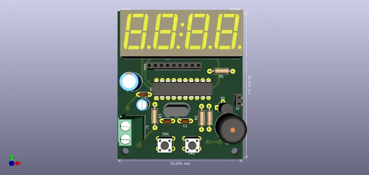

Digital Clock with AT89C2051
AT89C2051-based of 4 digits 7 segments display electronic clock kit

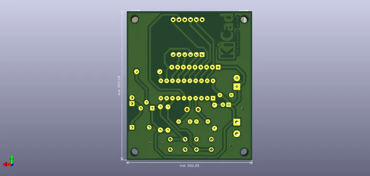

Circuit diagram and bill of materials available in the download section.

Schematic and Layout
