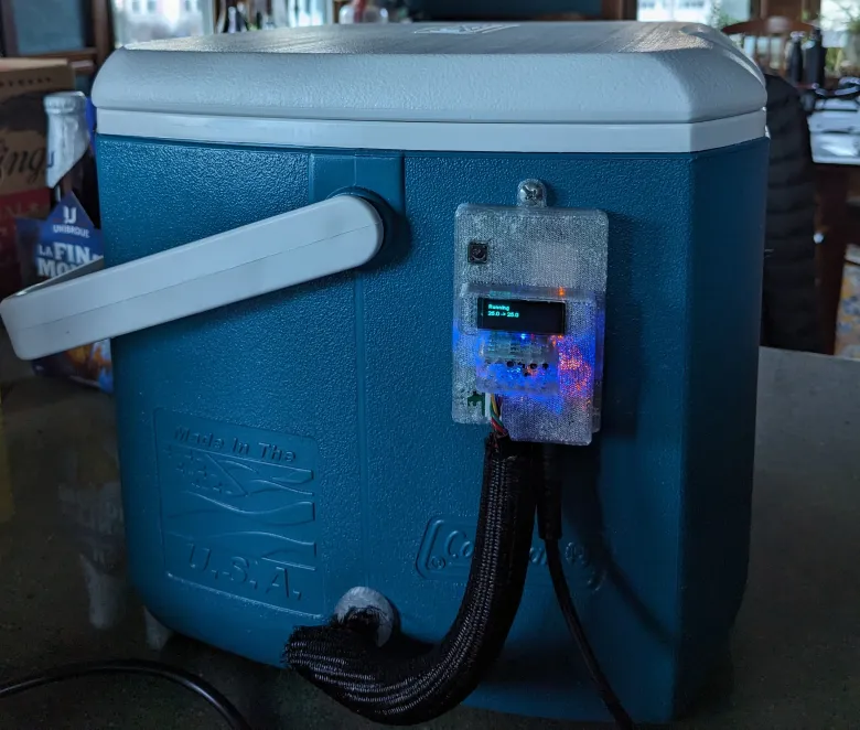

Dough133 is an intelligent heated enclosure, with a custom controller board using an ESP32 and Home Assistant integration, for fermenting and proofing sourdough.

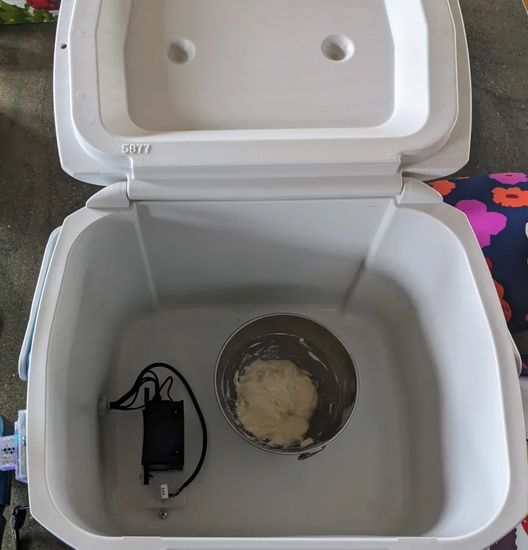

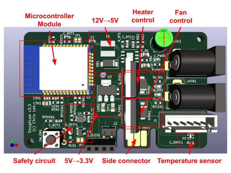

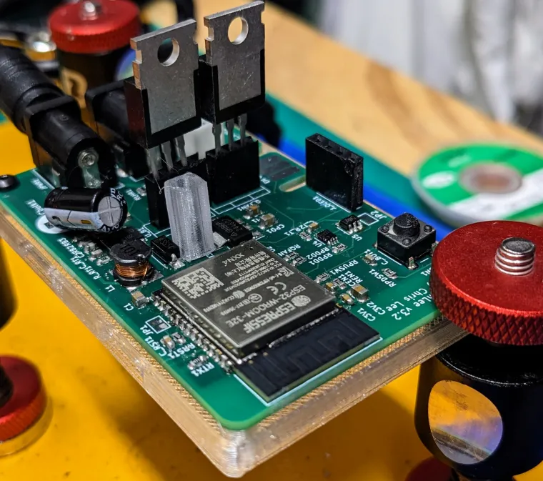

Dough133 is an intelligent heated enclosure for fermenting and proofing sourdough.  It uses a small Coleman cooler as the container for the dough, a PTC heater, a simple temperature/humidity sensor in the cooler to monitor conditions, and my own microcontroller board mounted on the outside of the cooler for control.
It consists of these basic elements:
  • Enclosure: An insulated space for the dough,
  • Heater: Heats the air in the enclosure,
  • Temperature/humidity sensor: Allows the controller to react to the conditions inside the enclosure,
  • User interface: Used for enabling and disabling temperature control, setting the goal temperature, and monitoring the device,
  • Microprocessor board: Implements the user interface and controls the conditions in the enclosure,
  • Power supply: Powers the heater, sensors, and microprocessor board,

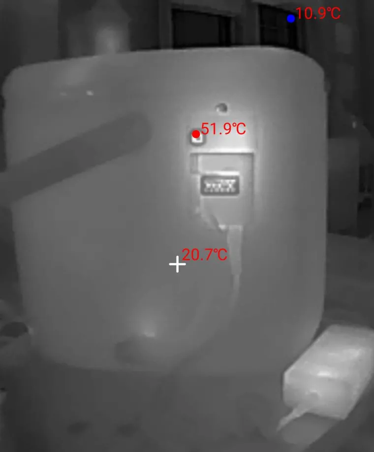

  • Safety system: Ensures that problems with the overall system will not lead to overheating.

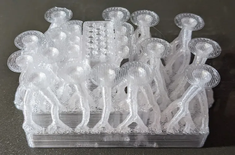

The C++ firmware, KiCAD design for the PCBA, and OpenSCAD sources for all 3D-printed components are available with the MIT license at GitHub Dough133.
