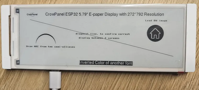

I have prepared Micropython library for Elecrow 5.79" screen for easy display management. Challenge was to make both SSD1683 chips work in sync.
Elecrow 5.79
This is a framework for future project- I have prepared Micropython library for controling your CrowPanel 5.79" screen (based on two SSD1683 chips). Library is based on FrameBuffer- allowing you for easy manipulation and wide tools created.

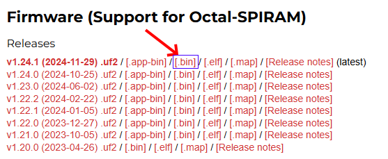

Download newest Micropython firmware for ESP32-S3 from official website
Choose Bin release from "Firmware (Support for Octal-SPIRAM)"

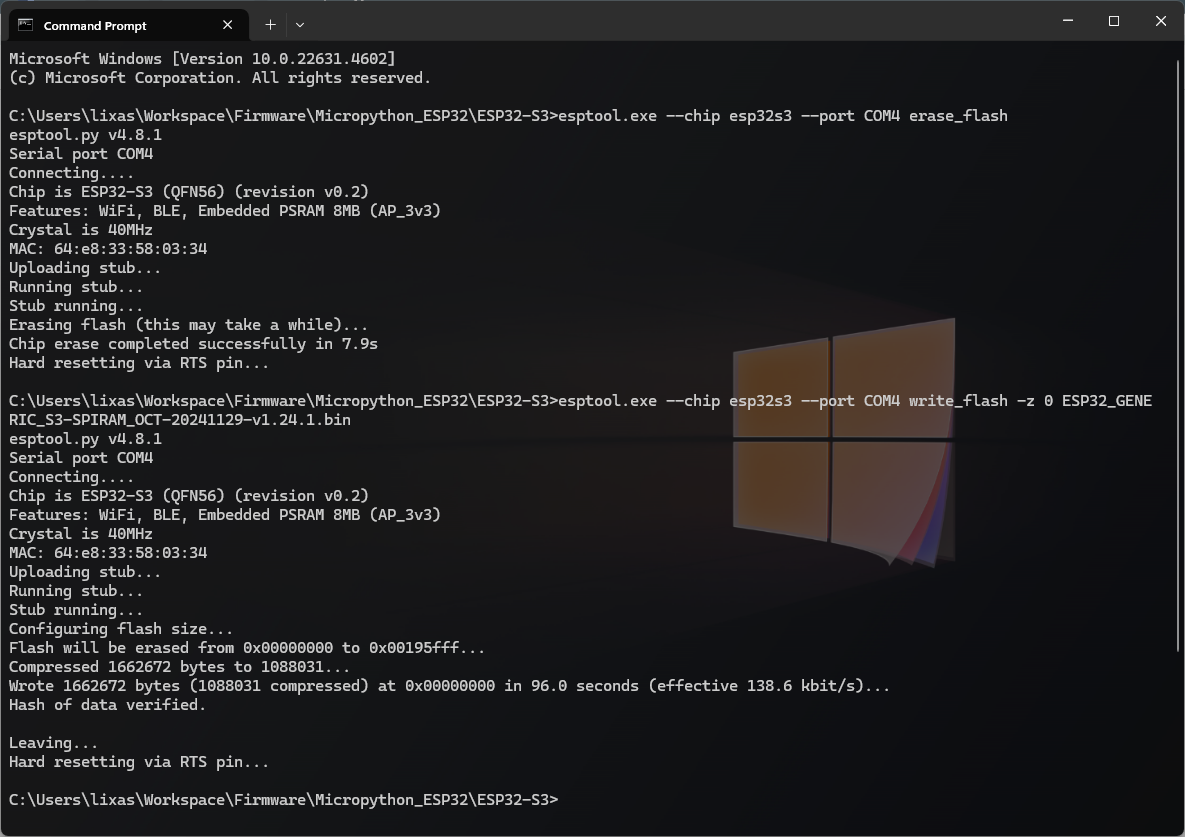

Before burning new firmware- you need to clear you chip from any previous software. Use following command on your command prompt
esptool.exe --chip esp32s3 --port COM4 erase_flash

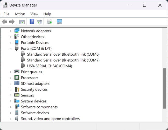

* COM port may have different number. Easiest way to discover what COM port is used, open Device manager from start menu and expand section "Ports (COM & LPT)"
Device Manager
After cleaning chip, You need to flash downloaded firmware with following command:
esptool.exe --chip esp32s3 --port COM4 write_flash -z 0 ESP32_GENERIC_S3-SPIRAM_OCT-20241129-v1.24.1.bin
* Make sure file name is correct according to what version you have downloaded
Command prompt window
You should get something similar as screenshot above.

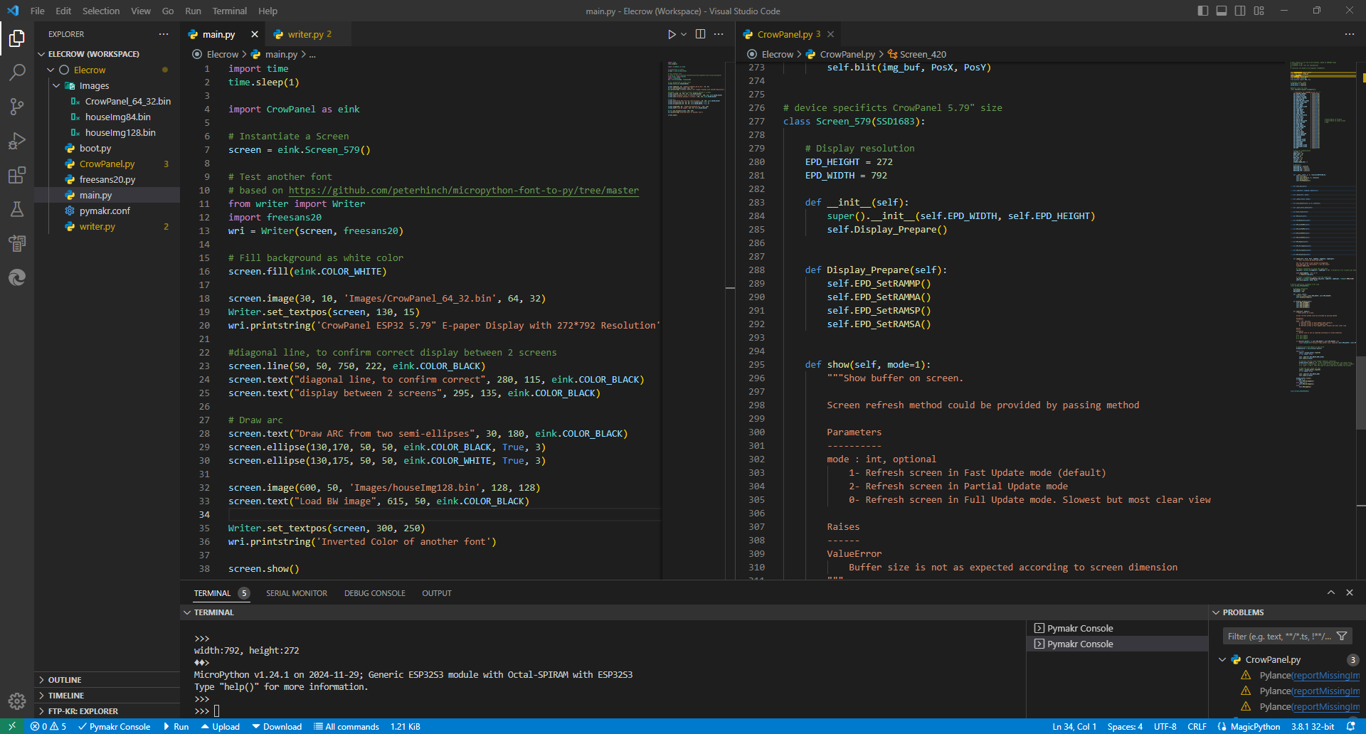

I've set up Micosoft VS Code as my micropython development environment. Plugin for to work with board is Pymakr
If you like working with other tools (Thonny, Arduino IDE, etc) its up to you.
